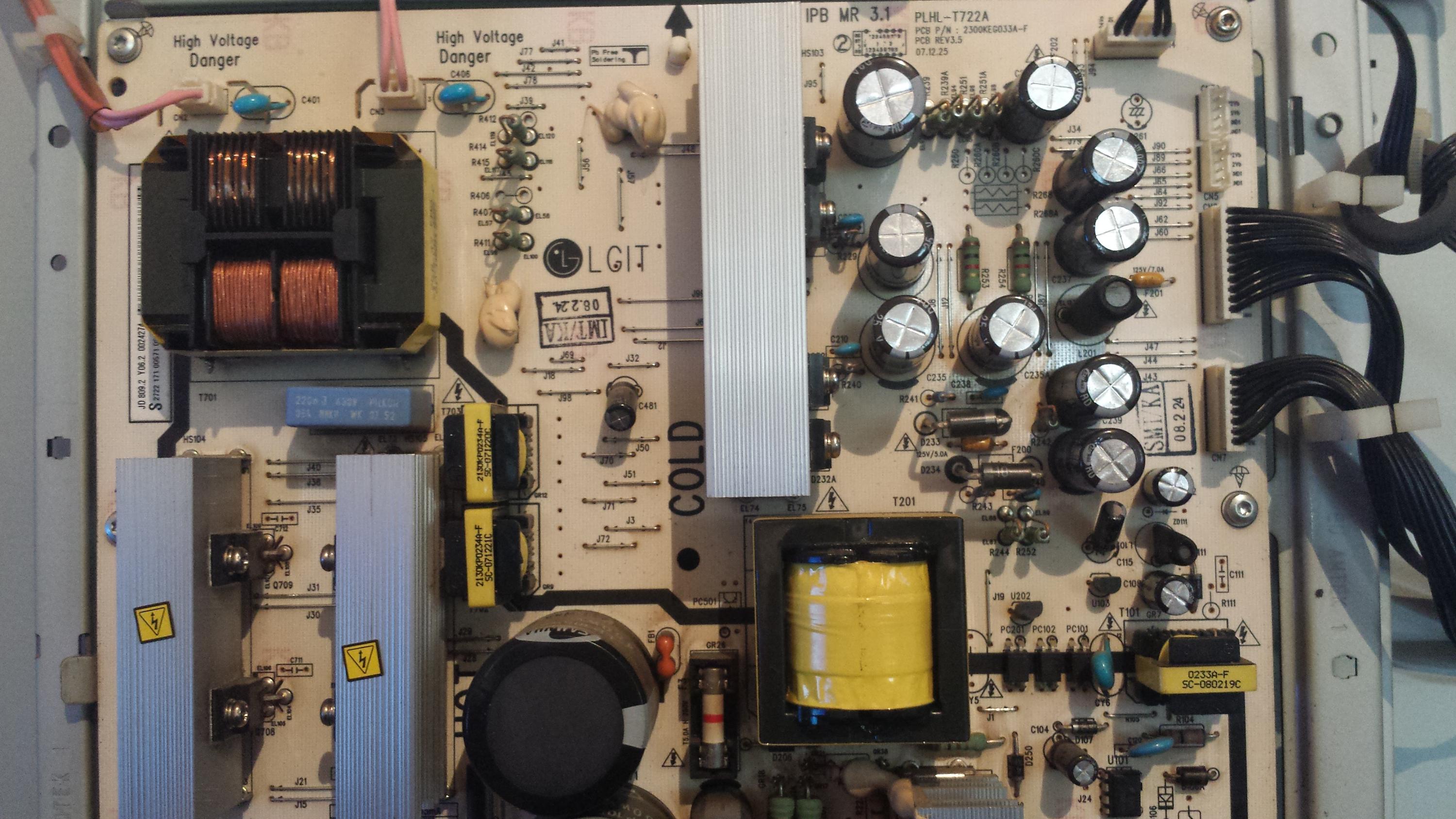

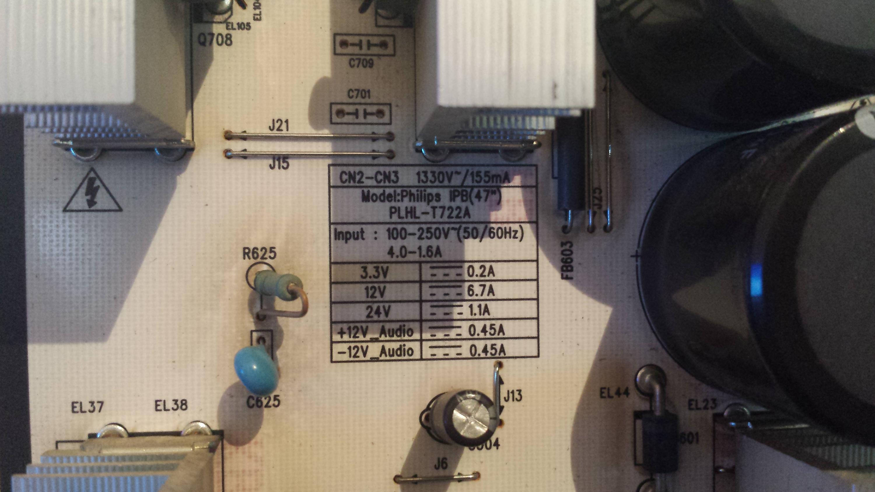

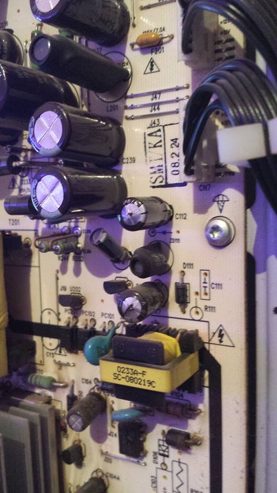

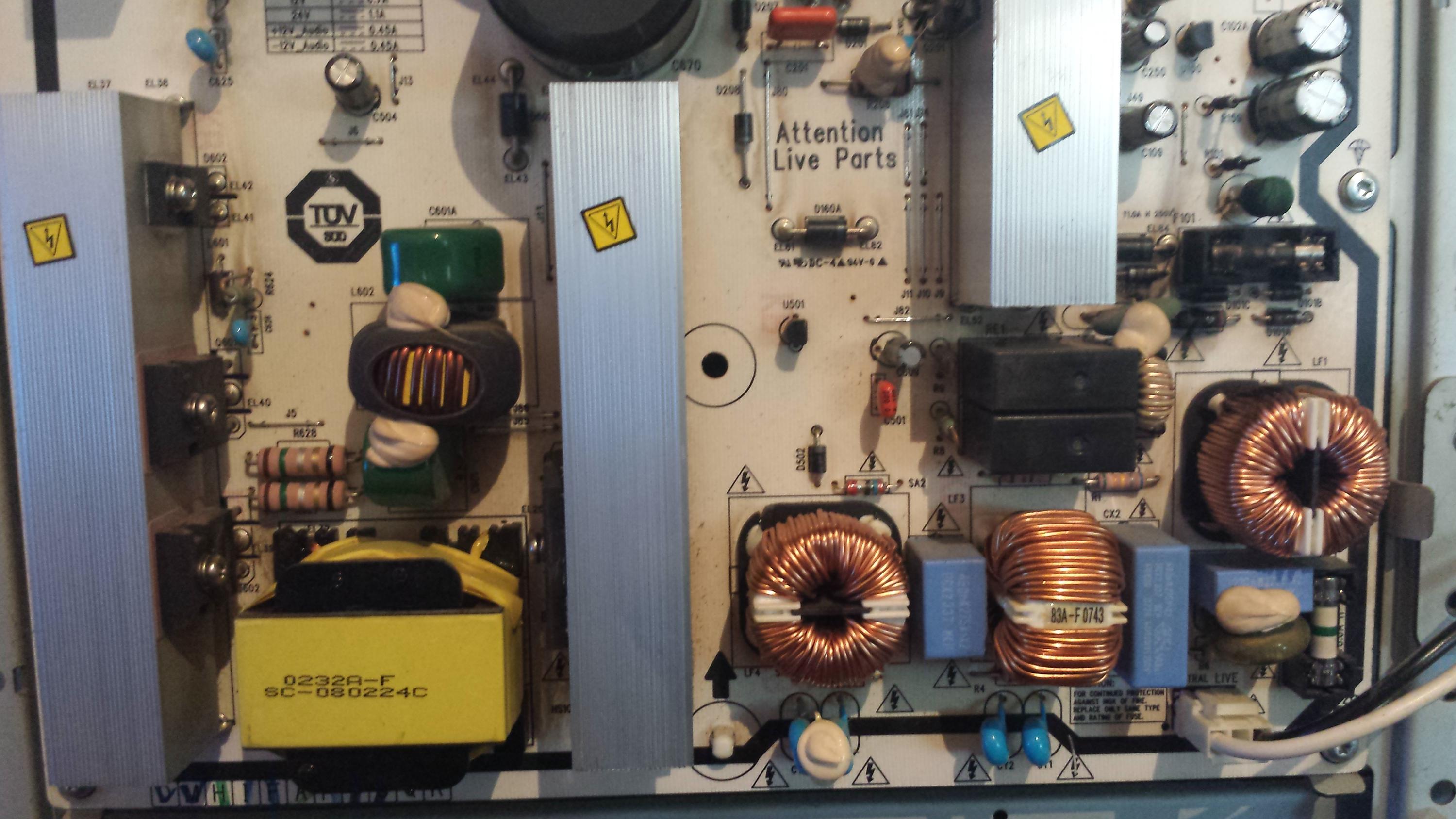

    hi huys a friend asked me to have a pop at repairing his 47" philips tv, i took off the back and noticed 6 caps where leaking so replaced them, tried switching on and still no standby LED so tested the 3 fuses on the PSU of which one had blown (ceramic fuse) i then replaced with a time delay 1A Glass fuse and as soon as i plugged tv back in the fuse popped but has also burnt something out under the fuse aswell, can anyone tell me what could be the problem ?
    Re: help with a Philips 47" LCD power fault
    May be a fusible resistor - would need some more detail of the board to be sure.
    Part #s, detailed images of top and bottom of board, etc.
      Does this help Tom ?

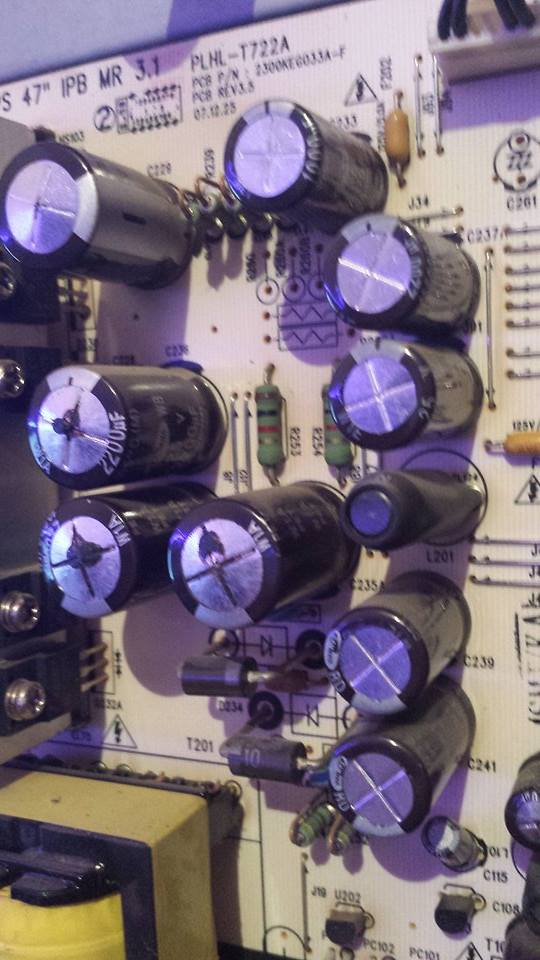

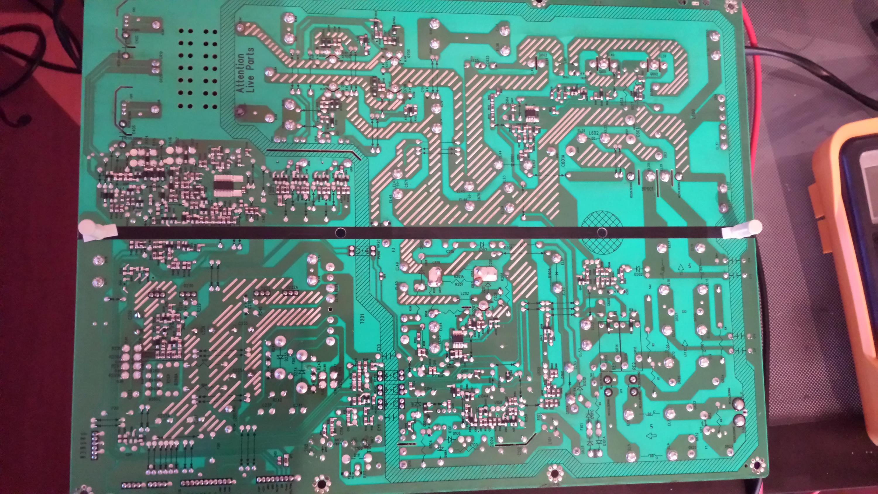

        Need one for the bottom side of the board (green side)
        Also did you use Samwha capacitors in a re-cap job...? Were they original or salvaged?
          Sorry whats Samwah capacitors ? And i just replaced original caps with new ones.
            Hi tom 4 of the caps replaced where samwha and the 2 470uf ones cant see a brand just says C7E but there is also a logo that looks like the samwha logo. These are the pictures of the green side and a close up of the green side of the board where the fuse blew.
              So they aren't causing your problem but they could do in a month's time, why use such rubbish when you can buy genuine Panasonic/Rubycon from CPC with only £5 min order (that bunch of caps would meet that order) with 3 days delivery.

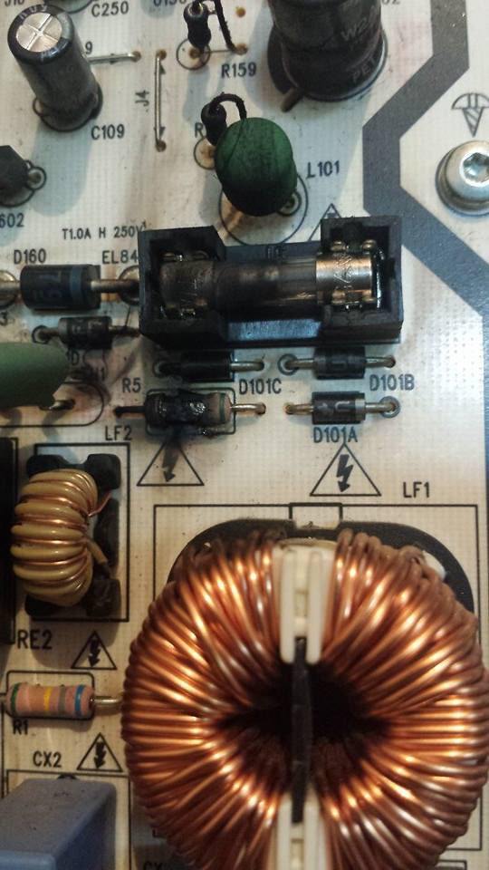

                Check each of the diodes D101A thru D for shorts. check D160.
                Odd fault, can't see what R5 exactly does - maybe some kind of supply for the relays - but if so why is it burnt.
                    That fuse is for feeding B+ to the STBY power supply SMPS IC U101, more likely there is shorted circuit in the IC or related parts. Check to see if R101 is also open circuit. Check the resistance on the two legs of cap C102A to see if it shows really low resistance.
                    That R5 is the fusible resistor for the feeding the rectifier diodes 101A~101C (check these dioded to make sure they are not damaged also) to run the SMPS IC in STANDBY mode, once the board get the PSON then the PFC Voltage booster will kick in then the B+ will be fed from D160 to run the STBY power supply.
                    Get the P/N of U101.
                    http://www.shopjimmy.com/philips-272...pply-unit.htm#
                    What is the model and chassis numbers of this TV?
                        Tom, checked D101A thru D for shorts and all are fine. im unsure why R5 has burnt out think this may have happened after caps where replaced and tv was switched on as fuse blew 2-3 seconds after tv was plugged in.
                          Tom, IC U101 looks like it has a leg burnt right at the top just before going into the IC itself, im not sure how to check if R101 is open circuit maybe you can advise ? i tried and was giving me all different readings from 2 pins on one side to 4 on the other side. two legs of cap C102A show 283 both ways,
                            The SMPS IC is bad. Can you still read numbers as printed on top of the IC.
                            You just check the resistance between the two leg of the resistor R101, no power to the unit of course.
                            When fuse is blackened like that, it has really shorted circuit, by now the short circuit is probably almost blew open/ resistance went up by now that is why you are reading 280 Ohms.
