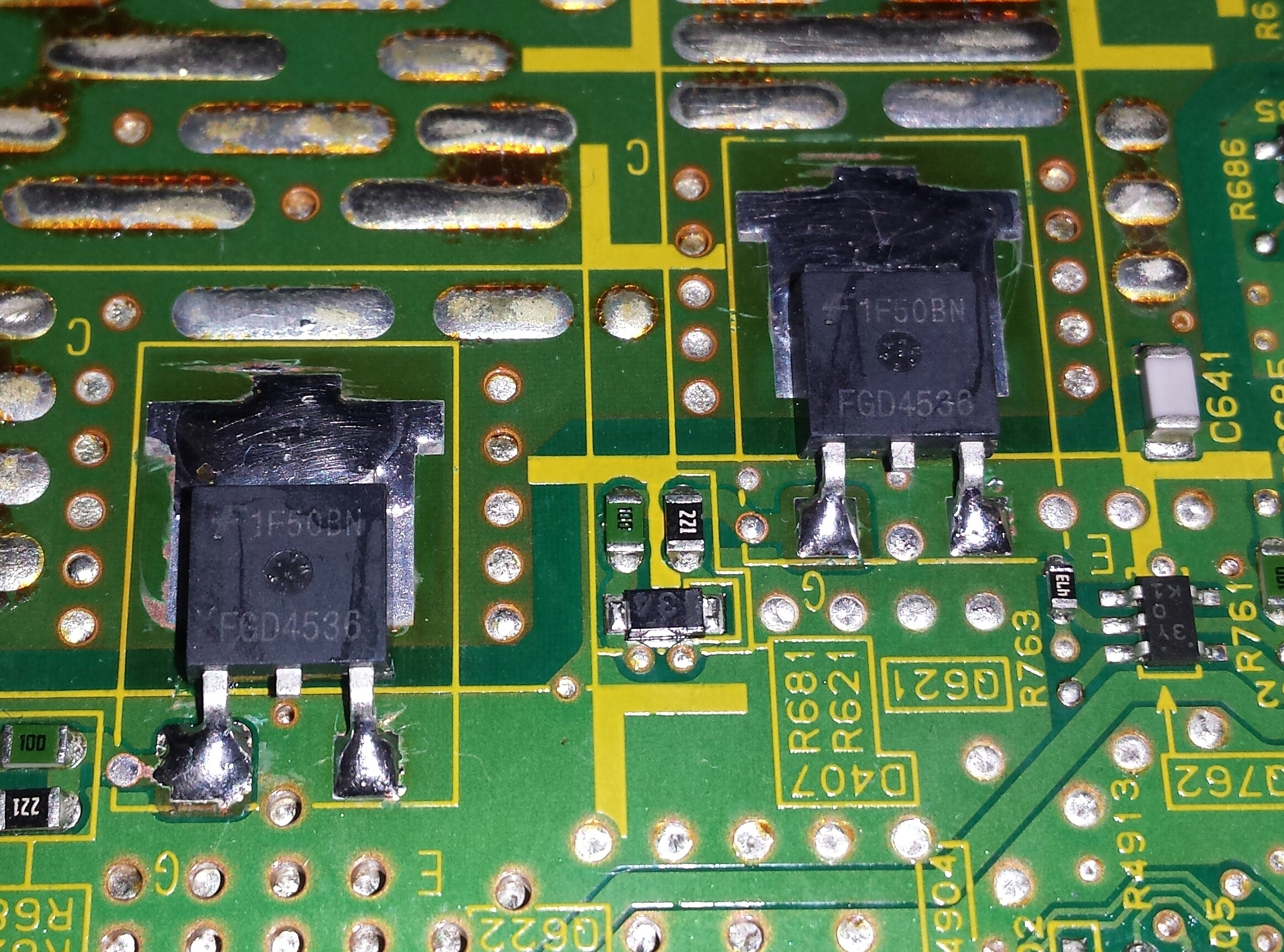

                                  Not sure if anyone is still taking part in this thread but I've just started work on a TNPA5349 from a TX-P42S30B and so far not had much luck...
                                  SN2 was short and Q401, 402, 421, 422 were blown, so I replaced them along with D401 and 421, which appears to be the 'general' failure mode for this board.
                                  On power up, all 4 x IGBTs blew again, so clearly I missed something else.
                                  Next attempt I removed Q441 and 451, which although not shorted came up as just as capacitors on my Transistor tester.
                                  Replaced those and the other 4 but this time I fitted all new driver transistors and buffer chips too, so about 16 components in total. Checked all around Q621, 622, 601, 660 and 661 and no sign of damage in those areas either.
                                  Powered up and bang, back to square one again!
                                  I've checked the buffer output chips by probing between TPVFG and all the connector pins but no shorts were found there, so its not a blown buffer taking out the IGBTs.
                                  Is there anything else on this board I need to check as I can't find anymore blown parts and I'm reluctant to rebuild it again until I can figure out why it keeps failing.
                                  Replacement boards are available on eBay but at £75 they are about what the set is worth now, so I'd rather repair then replace.

                                    Send a pic of your replacement igbt's. Where did you scorce them? Also, send a pic of your transistor tester.

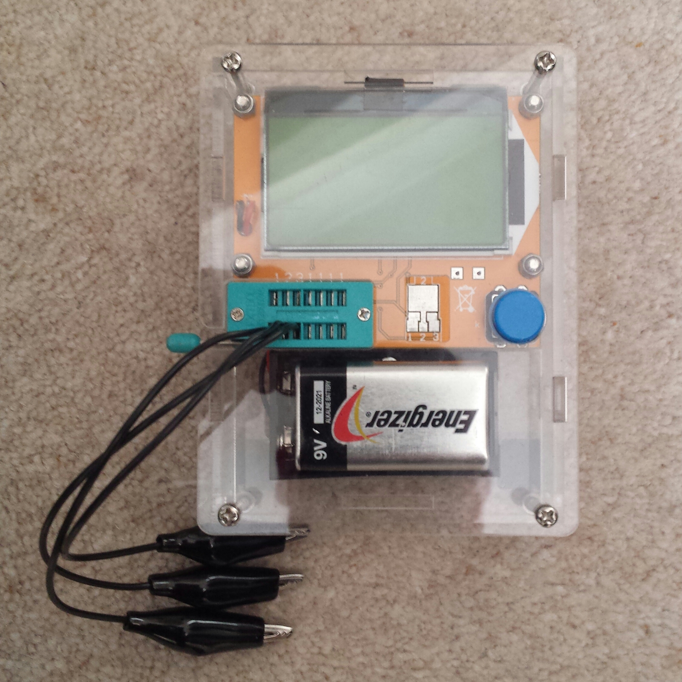

                                      Thanks for the reply.
                                      My first attempt used genuine Panasonic 30F131s salvaged from a working x-sus board. I went this route as I figured better than the risk of fake parts as these are hard to get now.
                                      Second attempt used FGD4536 devices to replace all the 30F131s and both DG302s.
                                      The 4 x in place of the 30F131s went short again.
                                      My source for the FGDs was a Chinese eBay seller called e-best_trade. I've been using them a while now and all the parts received look genuine, with no signs of numbers being sanded and remarked etc. I've sucessfully fixed a few other y-sus boards with their parts and they've been ok.
                                      Pics attached of 2 surviving FGDs in place and my transistor tester.

                                        Re: Panasonic tc-p42s30 TNPA5349 SN board
                                        Check Q600. Also resolder the screw holes top and bottom of SN.
                                          I will check and replace the remaining power devices as necessary.
                                          I prefer to remove solder from the bolt holes both sides rather than add any. I then fit new screws with split locking washers and flat washers.
                                          Later Panasonic sets had no solder around the fixing points and used machine screws with split locking washers and flat washers, which don't come loose with time and heat cycling.
                                          This set has 8 fixings and I could have removed 4 by hand they were so loose!
