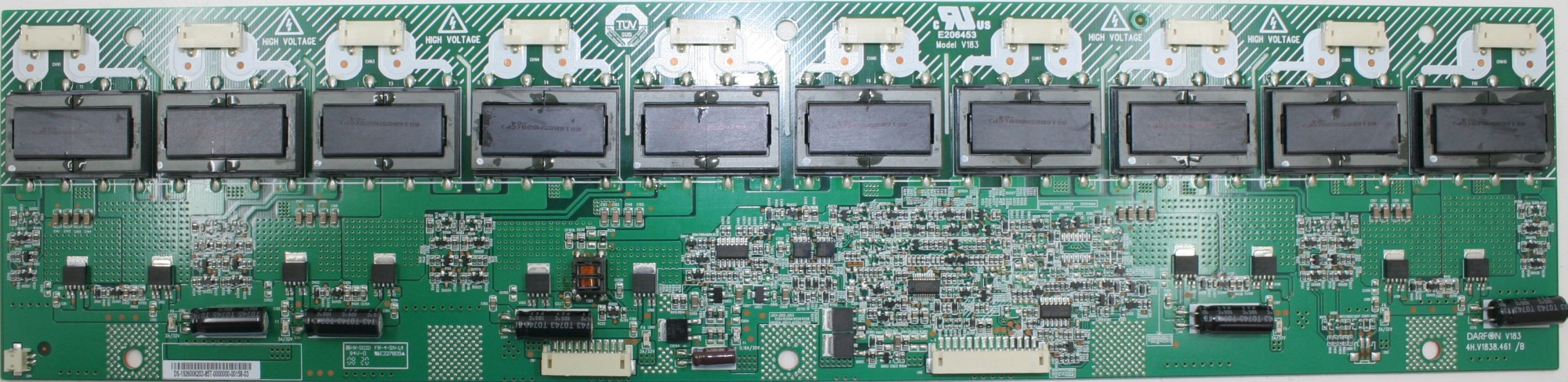

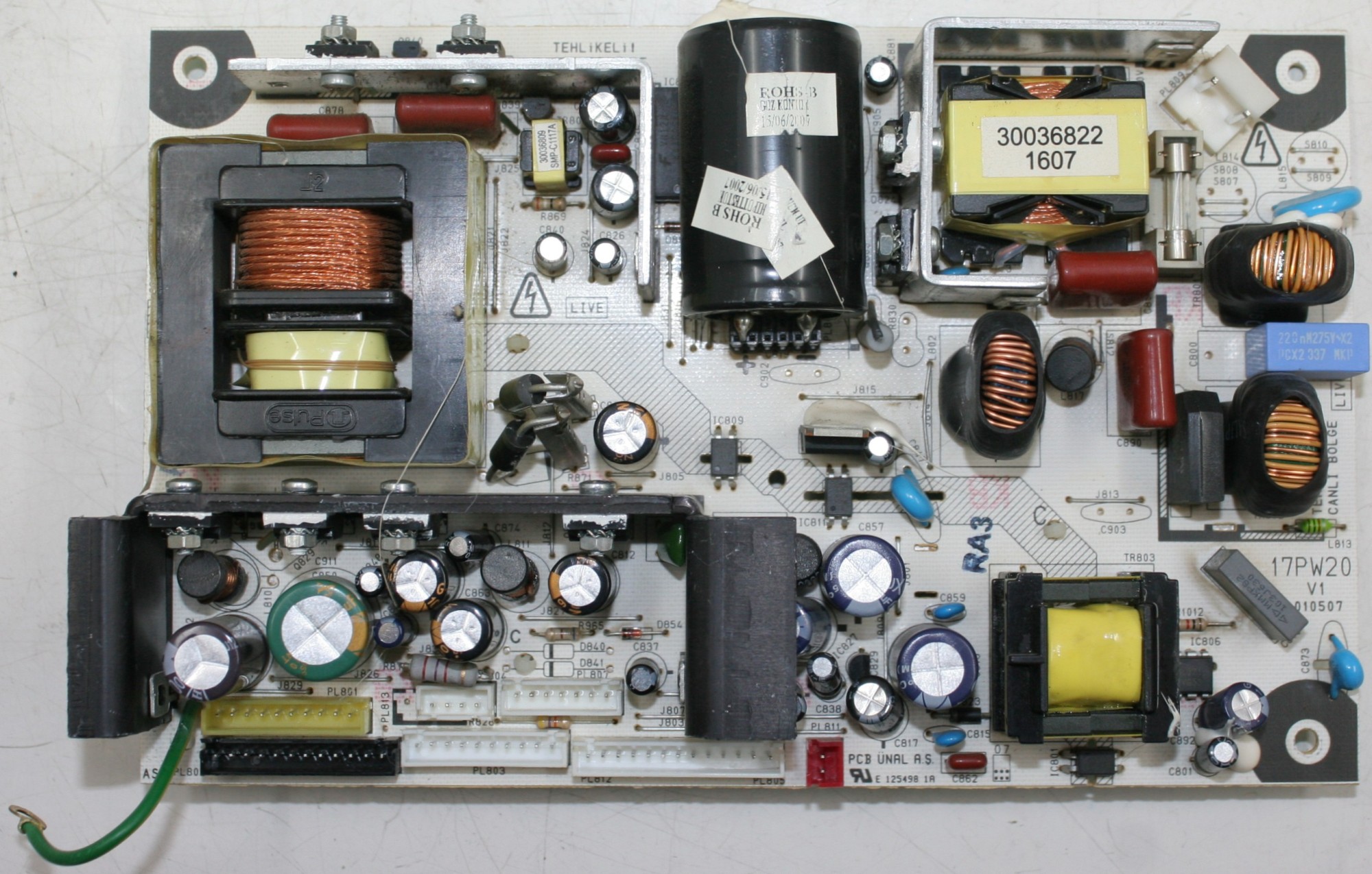

    hi all I have just bought a whalfdale lcd sorry I do not know model number but my problem is when turned on the screen flashs and the set goes into stand by It does this everytime I have had the back off and no blown caps I have unplugged the invertor board and the set will power up and apart from the lack of light it does not turn off as soon as the invertor board is connected it shuts off could someone tell me if it is the power board or invertor board it is a uk model 240 volts thanks

    can you upload good clear pictures of the boards in your tv so we can see what were dealing with what the part numbers from the power supply board.

      I will upload some tomorrow the power board is a 17pw20 v2 and inverto board is 4h.v1838.461/b it will power up until I plug in the back lights once I plug just on in it goes back into stand by

          The 17PW20 has a few common problems that should be dealt with before looking any further, there is a cheap kit of parts available for this which might be the best option for sake of reliability. You may find this solves the problem.

            all voltages are fine until I plug in the ccfl

                  pictures of power and invertor

                    replaced most caps and I have notices a humming sound coming from somewhere but cant seem to pinpoint it

                      now checked all ccfl with a battery and they apper fine

                              yes a new power board it saved all the messing around and only £15 off ebay
