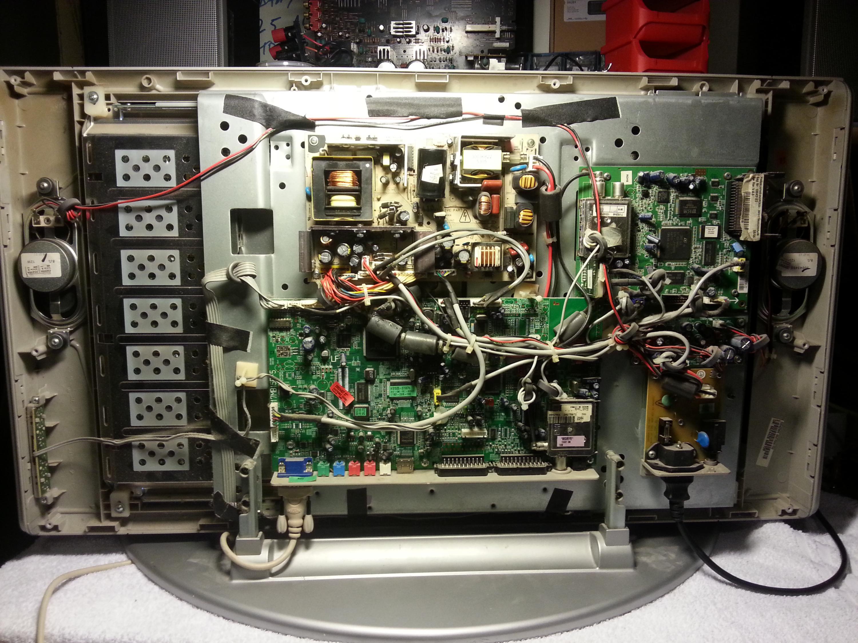

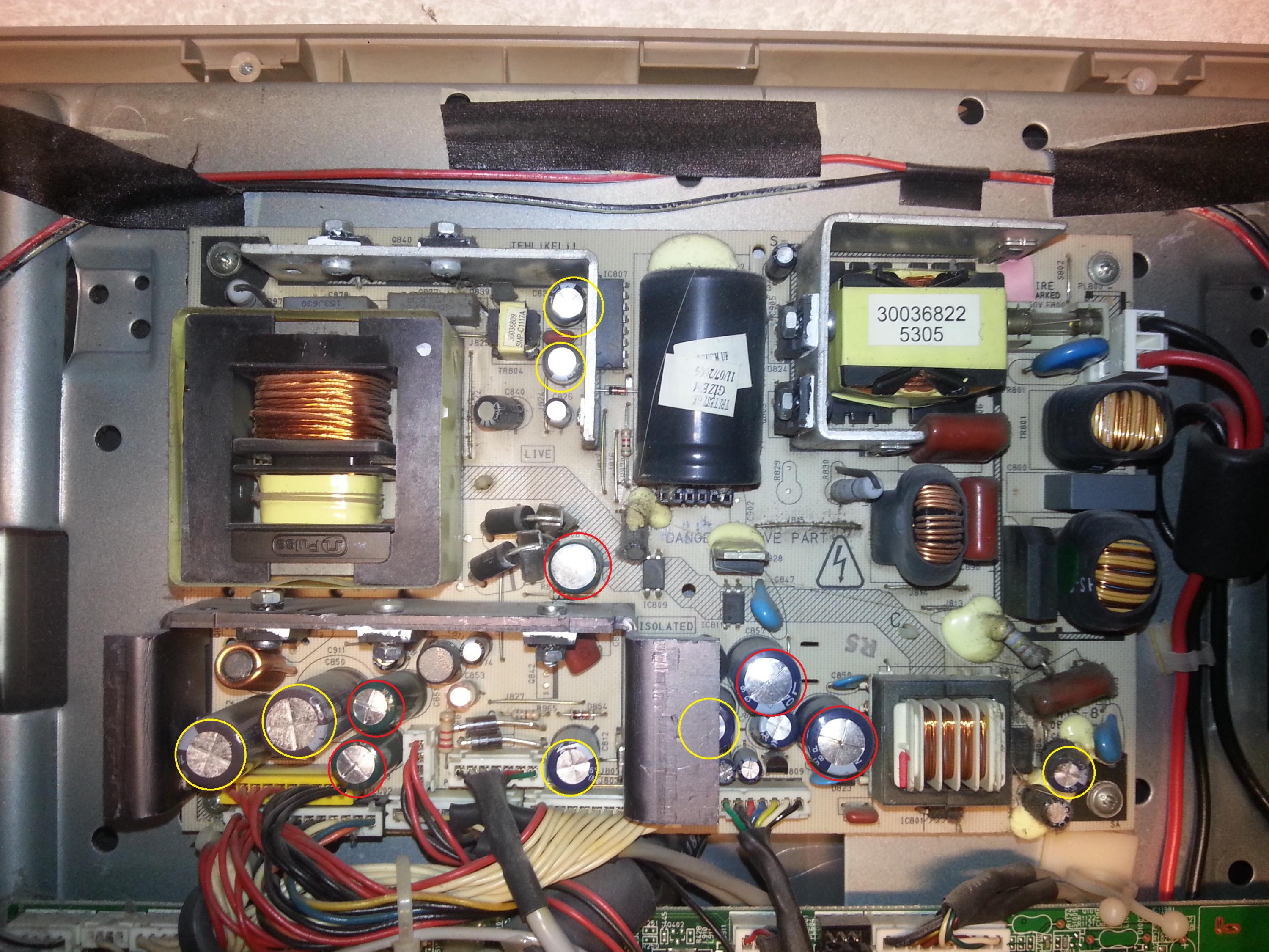

    Hello,a Wharfdale LCD2710HDAF. It had no power originally and after removing the back i discovered 5 bloated caps (circled in red).
    I replaced those and all of the other big caps (circled in yellow).
    The blue standby LED now comes on when i press the power button, however it takes 2 or 3 presses on the power button on the right before the tv powers on, and when it does there is a high pitched whine that seems to be coming from the inverter board on the left.

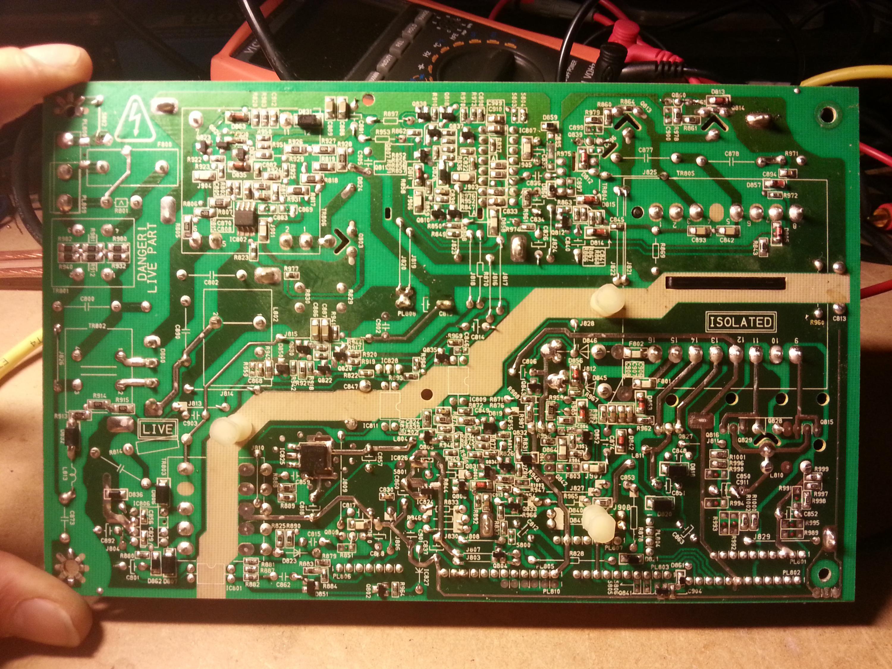

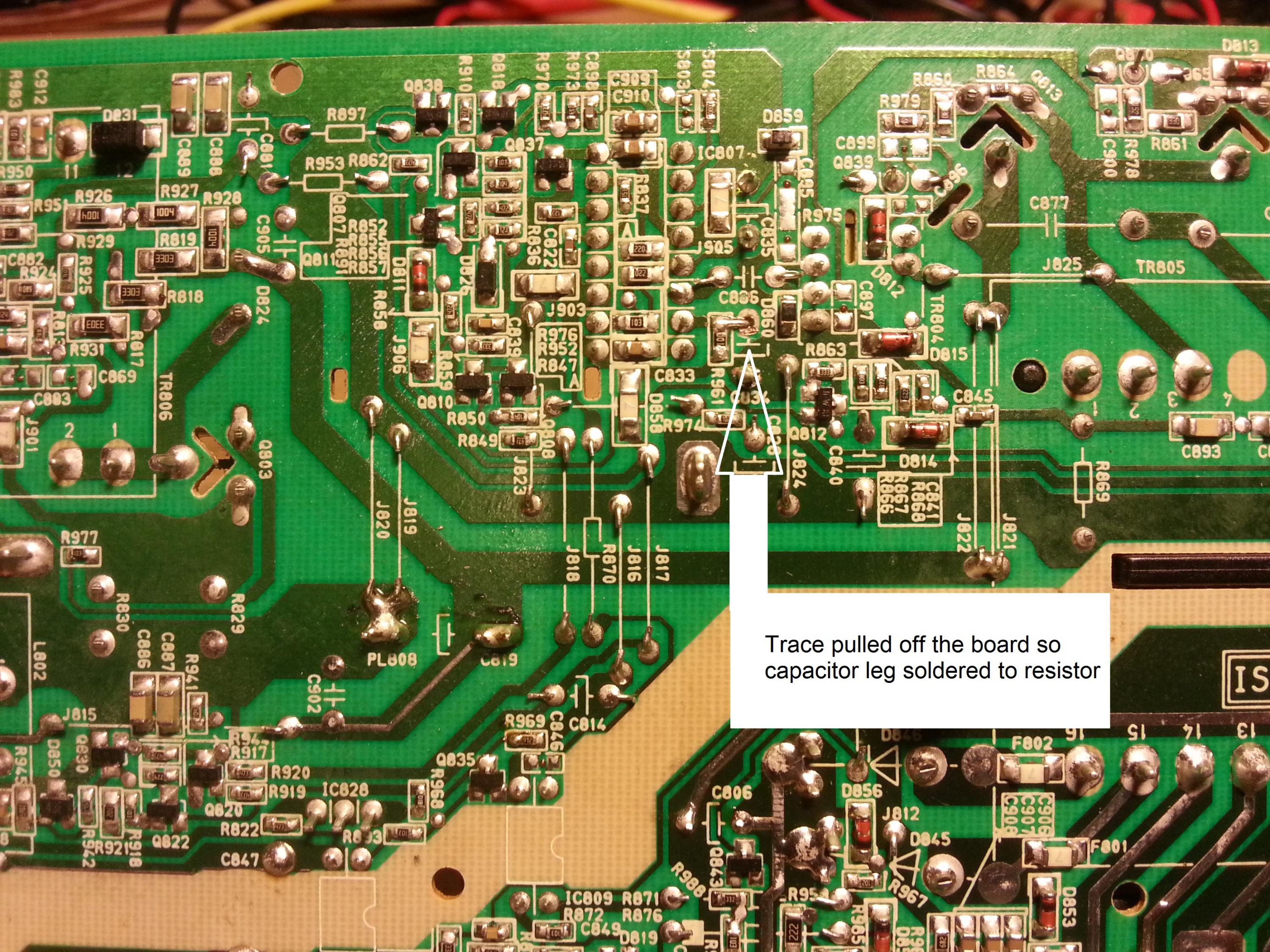

    I did manage to pull a trace off the board but i think i soldered it into the correct position, maybe i haven't or is there something else i have missed and should be checking ?
    thanks.

    Re: Wharfdale LCD2710HDAF replaced caps but still an issue.
    you should have changed all the caps.
    specially the small ones up against heatsinks.
    whoever designed that supply with a small cap right up aganist a part bolted to the left sink needs a good beating!!!
    what make&series of cap did you use btw?
      Thanks stj, I used Panasonic FM, I'll, replace the little ones tomorrow.
        Cheers stj, I finally replaced all of the remaining little caps and the noise has gone.
        I shall know for next time.
