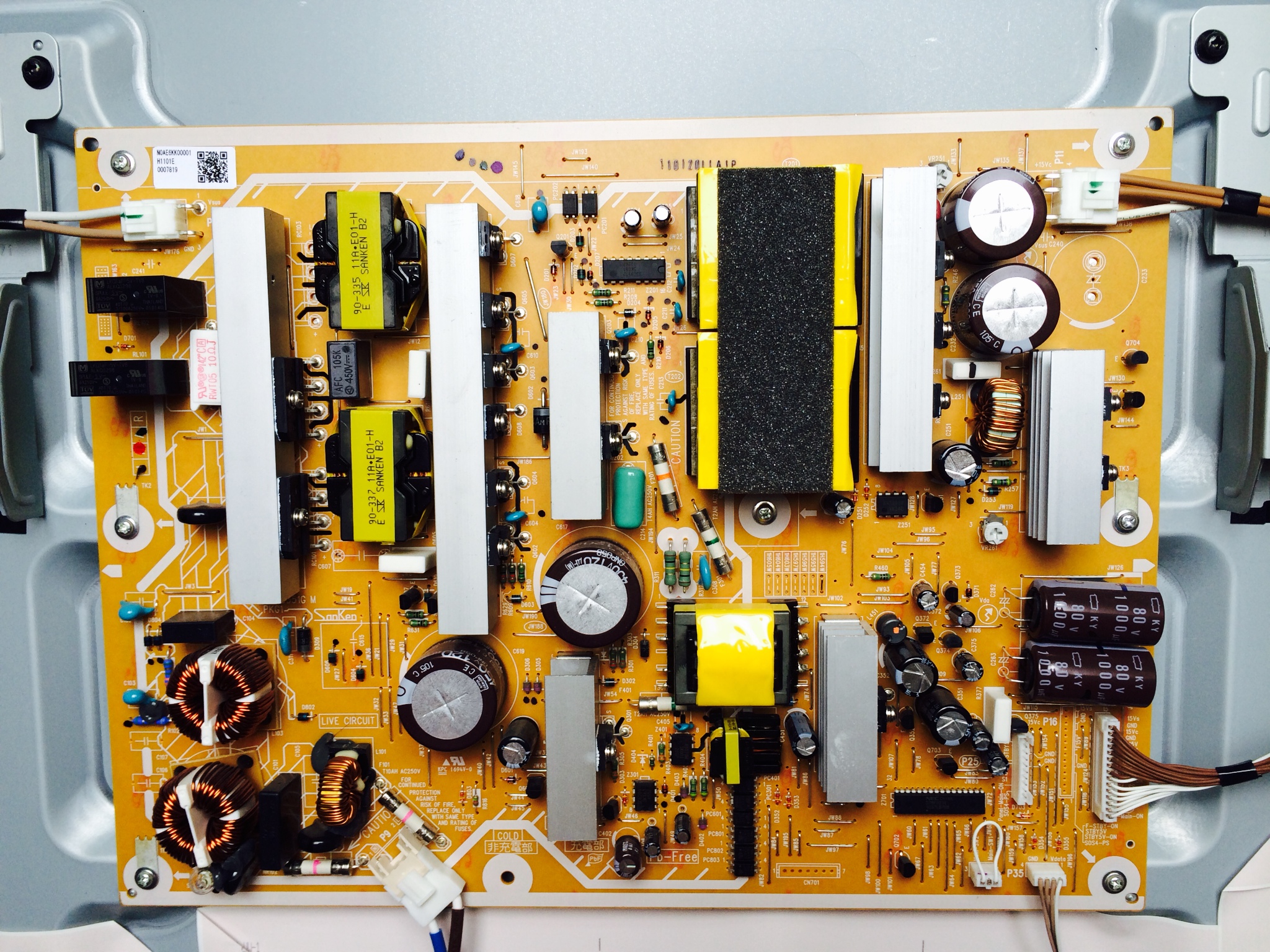

I have a Panasonic TC-P42S30 that will not do anything. No standby lights, no clicking, nothing.
Lightning hit the satellite dish and blew out both DTV receivers and our cable modem. The hit apparently came in over the coax cables, must have fried the DTV box and possibly went for the TV through the HDMI? We did have several circuits in the house blown, but PS3, Xbox and other devices in the same power strip are ok.

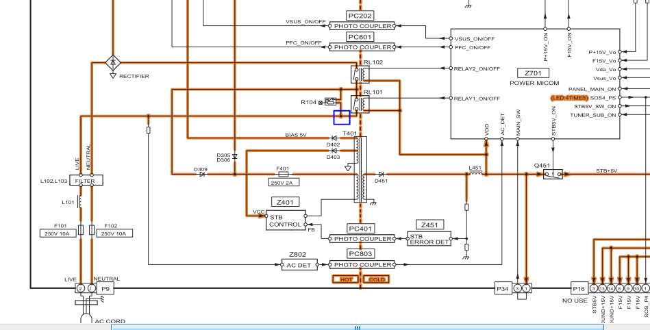

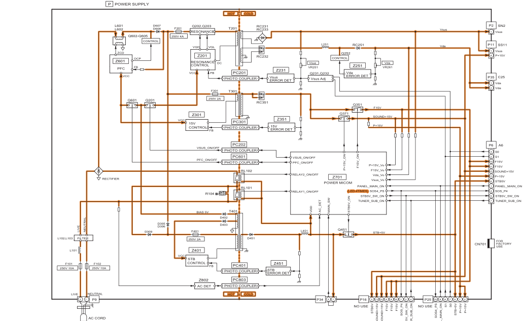

I opened the back of the set and checked the 5 fuses on the power supply board and they all show in tact using a ohm meter. I am getting voltage to the board at the AC plug and P9.
I would appreciate a couple of troubleshooting steps to take to make sure it is the power board. I did some preliminary checking and it seems that shopjimmy.com looks to be a preferred spot to buy boards, but they are out. So is encompass.com. Anyone else have any suggestions? Any luck repairing the power boards? I know Panasonic says no repair, replace.
