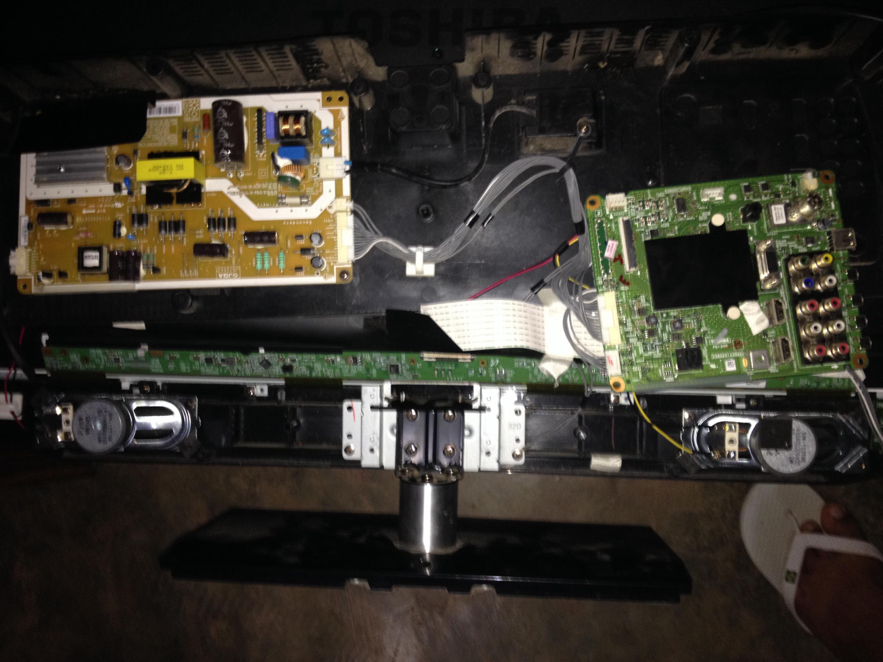

                  Re: Toshiba LED tv 32pu200 no display with sound
                  Need to see the pictures of all the boards.

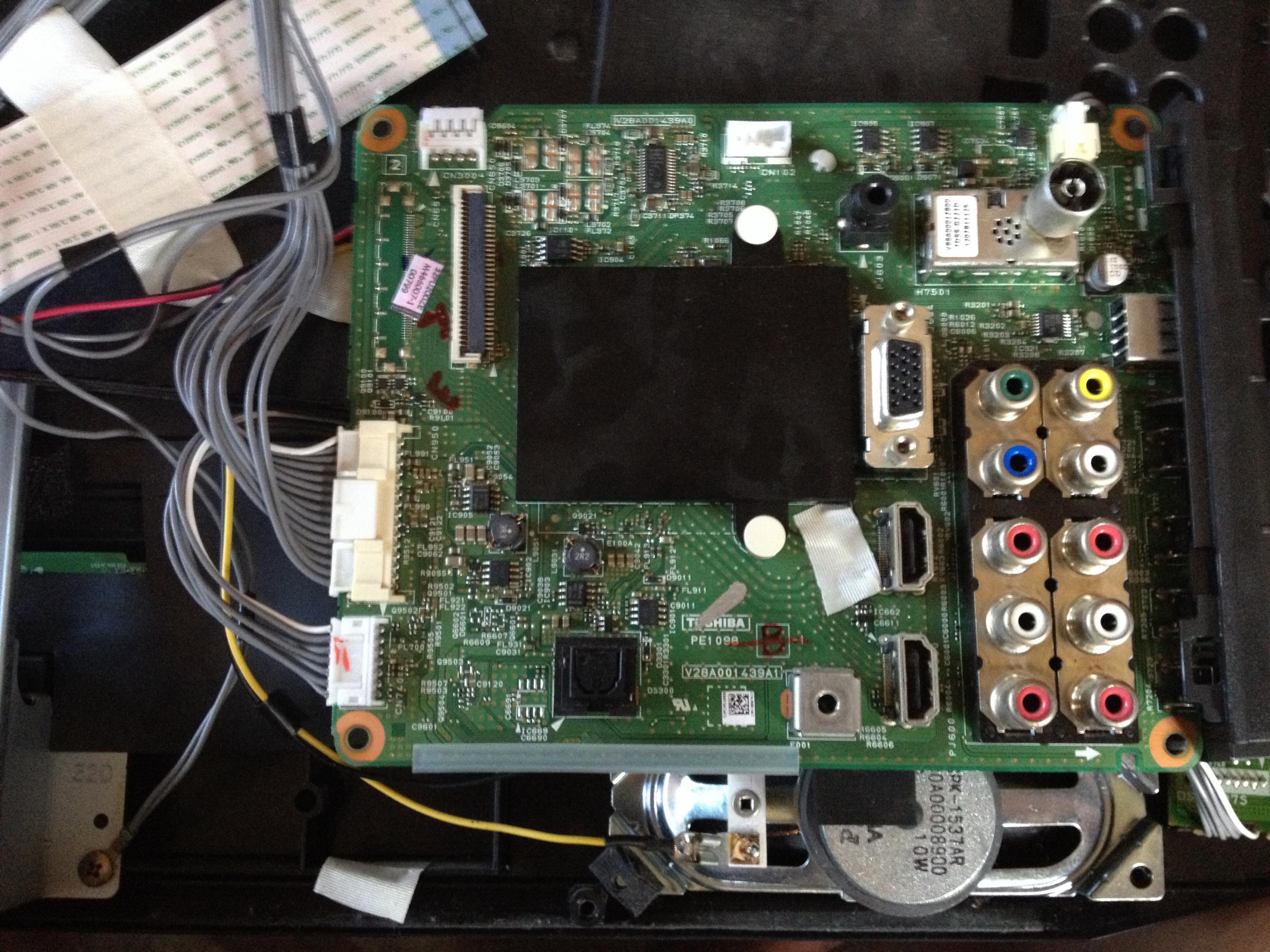

                    board of toshiba 32" led tv

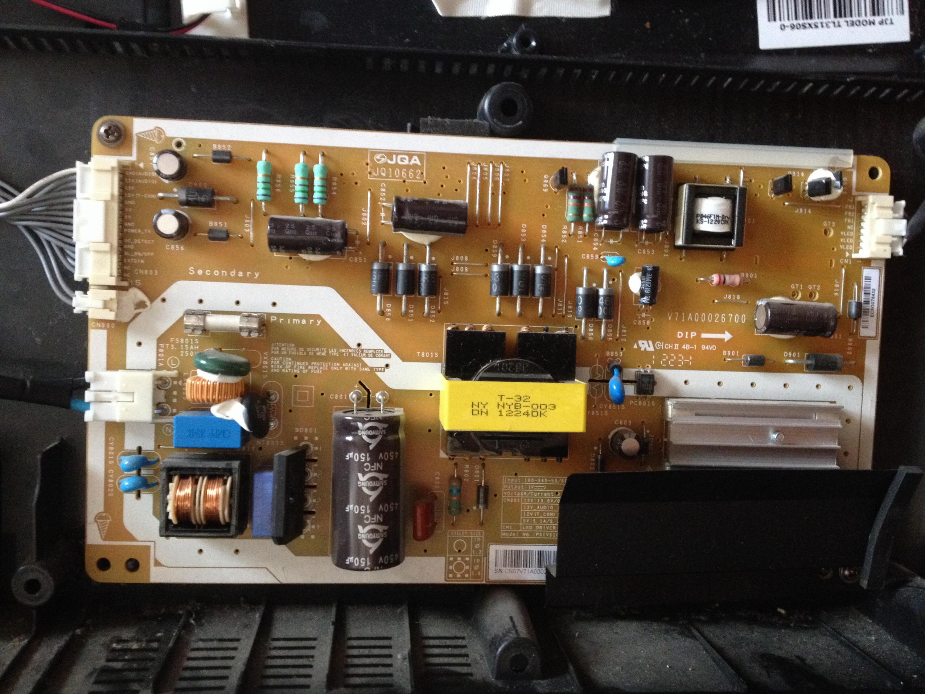

                      that one 15a fuse.
                      F= Fuse
                        there is still one board missing so far you have posted the main board and the power supply unit were looking for the t con board if you cant locate it please up load a picture showing the whole back of the tv so we can point out where it is as sometimes the tcon is under a sheild.

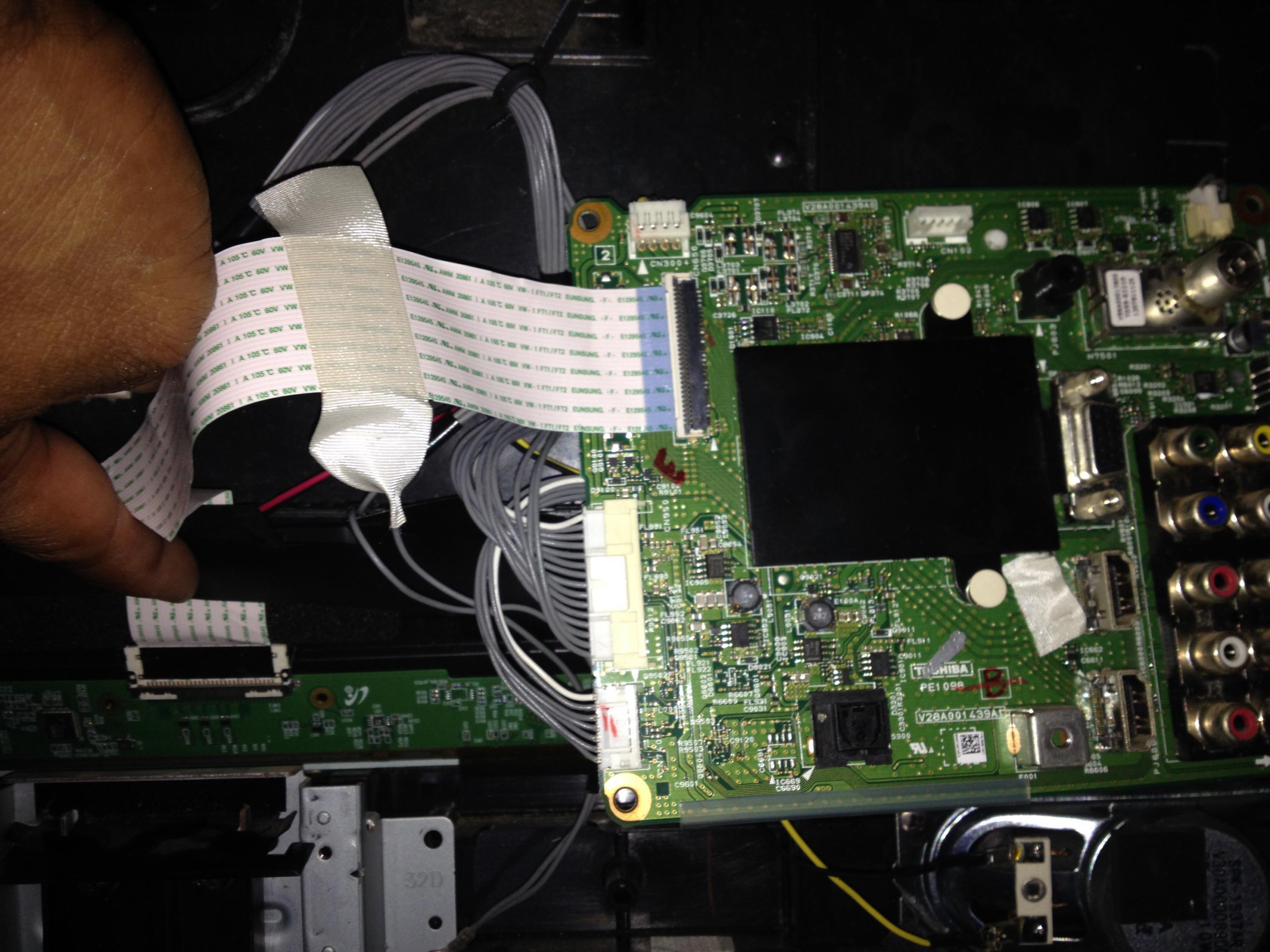

                          toshiba
                          • vinceroger69
                            • Mar 2012
                            • 6714
                            • uk
                            white wide flat ribbon is going to the board we need a picture of the area where the ribbon connects to it (bottom centre of picture)
                                  Vince - he has a picture - just no back light
                                  Suggests to me power supply , Back light driver chip, or led strip torn or a couple of leds out
