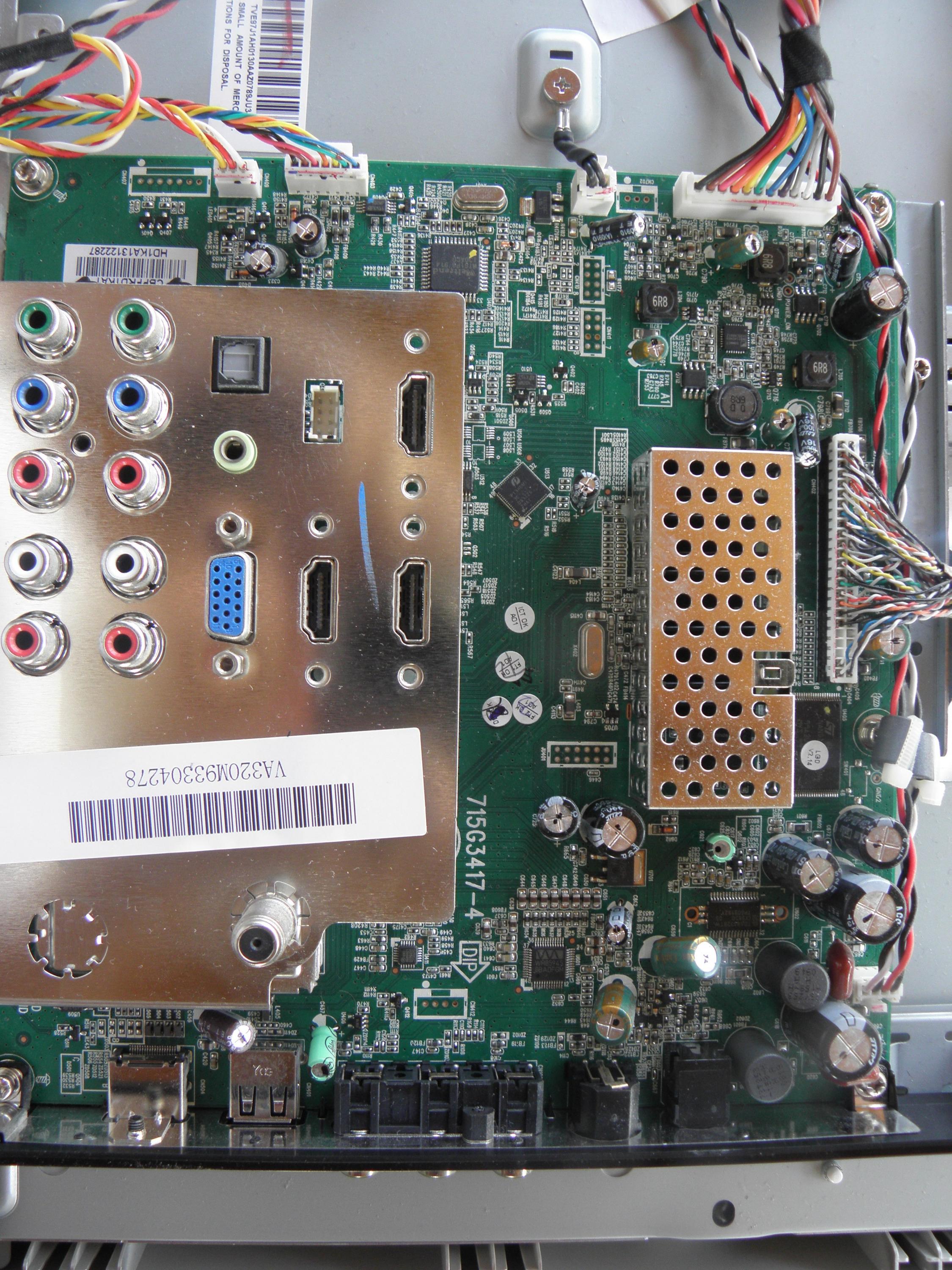

    I have a 32 inch TV Vizio VA320M turns on to logo screen and won't change.
    Soft boot did not work
    Any idea would be appreciated

    Based on Vizio's main board reputation and this particular fault, the main is most certainly the problem. You may get by with simply replacing the eeprom on it, but in my experience that's about a 50/50 shot. Shopjimmy and other places offer pre-programmed eeproms if you are comfortable with trying to change it. If you do buy a replacement main be sure to match all of the numbers on it. Most of these Vizio TVs can contain several different board versions.

      .Can you tell me which one is the eeprom ?
      I see a U407 and U513 and some others chips...
