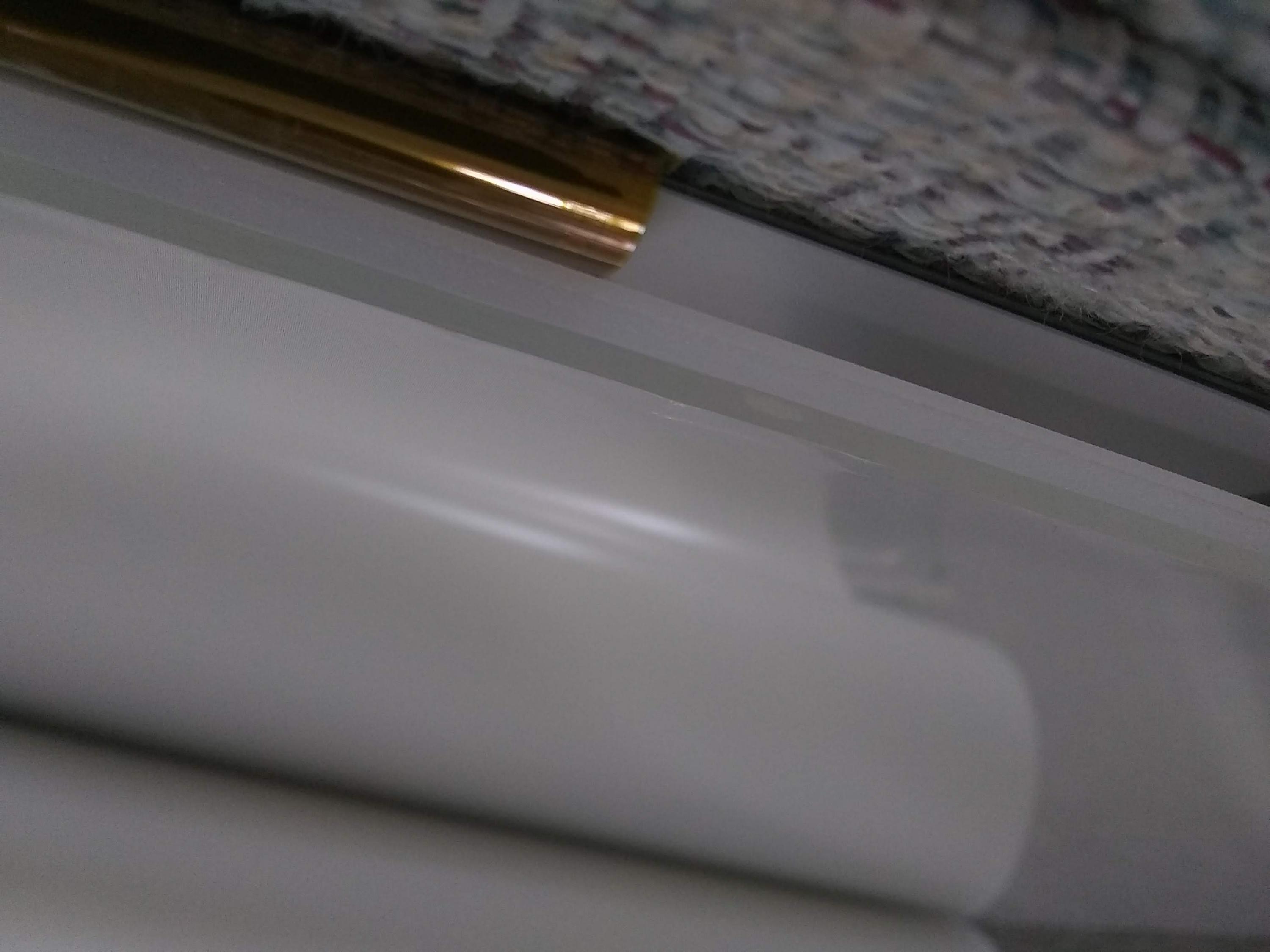

    Busted/cracked Light diffuser plate Samsung UN55NU7100
    I was attempting to replace the LED lights on an Edge-lit Samsung UN55NU7100...While removing the sheets and the light diffuser plate which already had cracks at the bottom. The plate bent(more than I'd like) and broken in half.
    1) Is it still usable if I can put in back into place
    2) or Do I have to find a replacement diffuser plate and can it be any diffuser plate from a 55" Samsung LED TV or specific to my model?
    3) can a new plate be purchased from Samsung?

    Re: Busted/cracked Light diffuser plate Samsung UN55NU7100
    early Tv manufacture brands.. they used for 55 size and above the first hard plastic light for edge or direct LED BL a reflector from 2 pieces glued with transparent double side type. later as new model all are one pieces even for 75 size..
    if this case the crack you have.. you can use ultra transparent glue which used as glass glue by Fish aquarium .. other wise the answer to question 2 you can use any from other edge BL TV 55 size

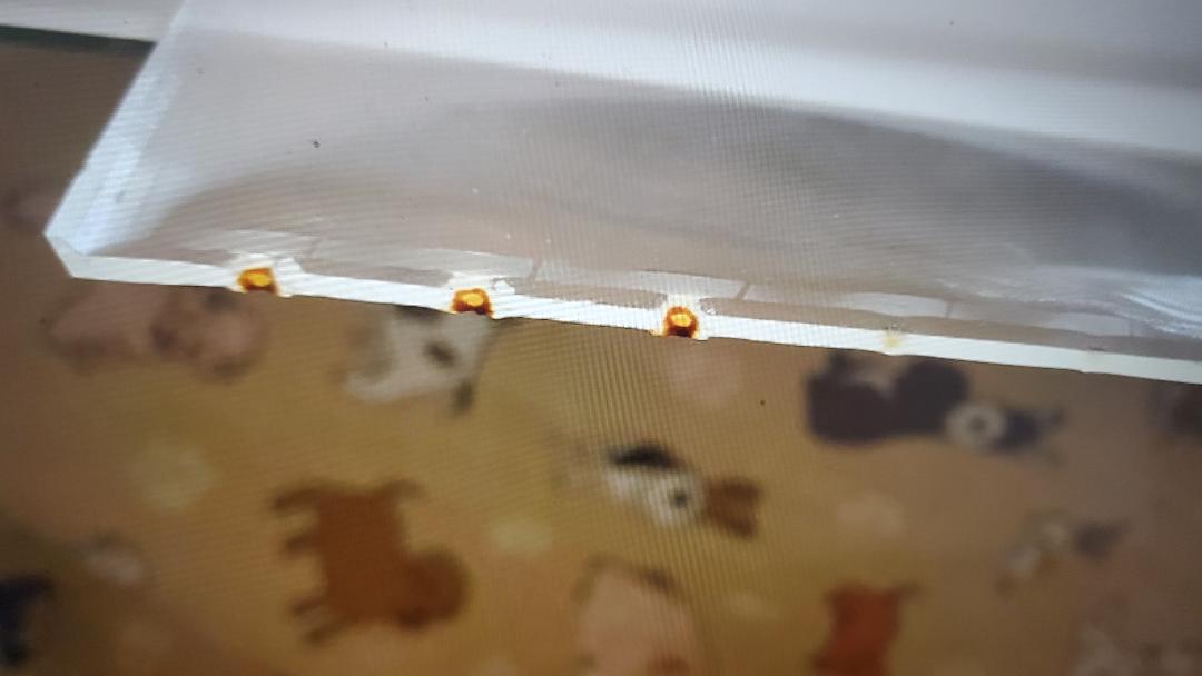

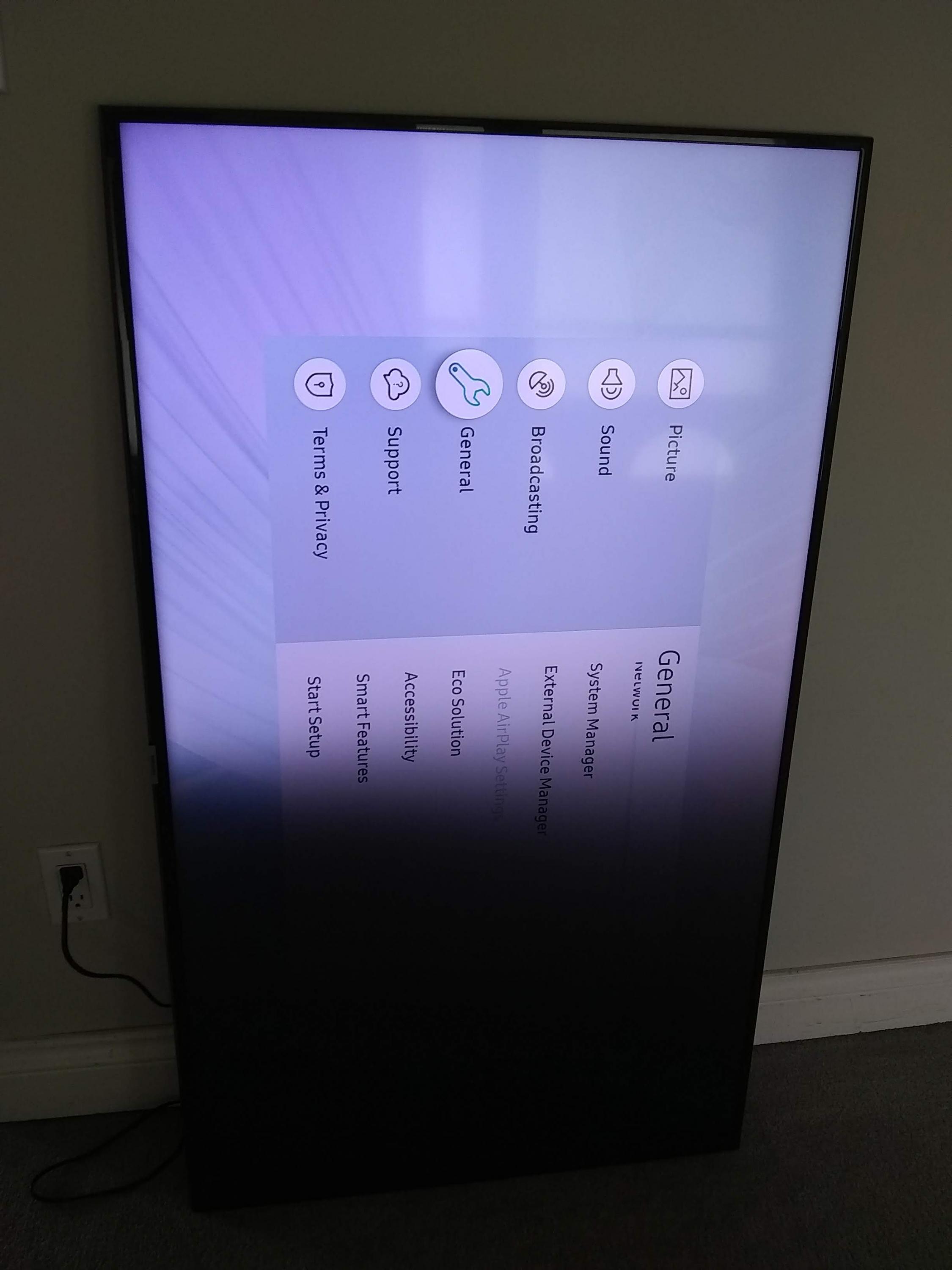

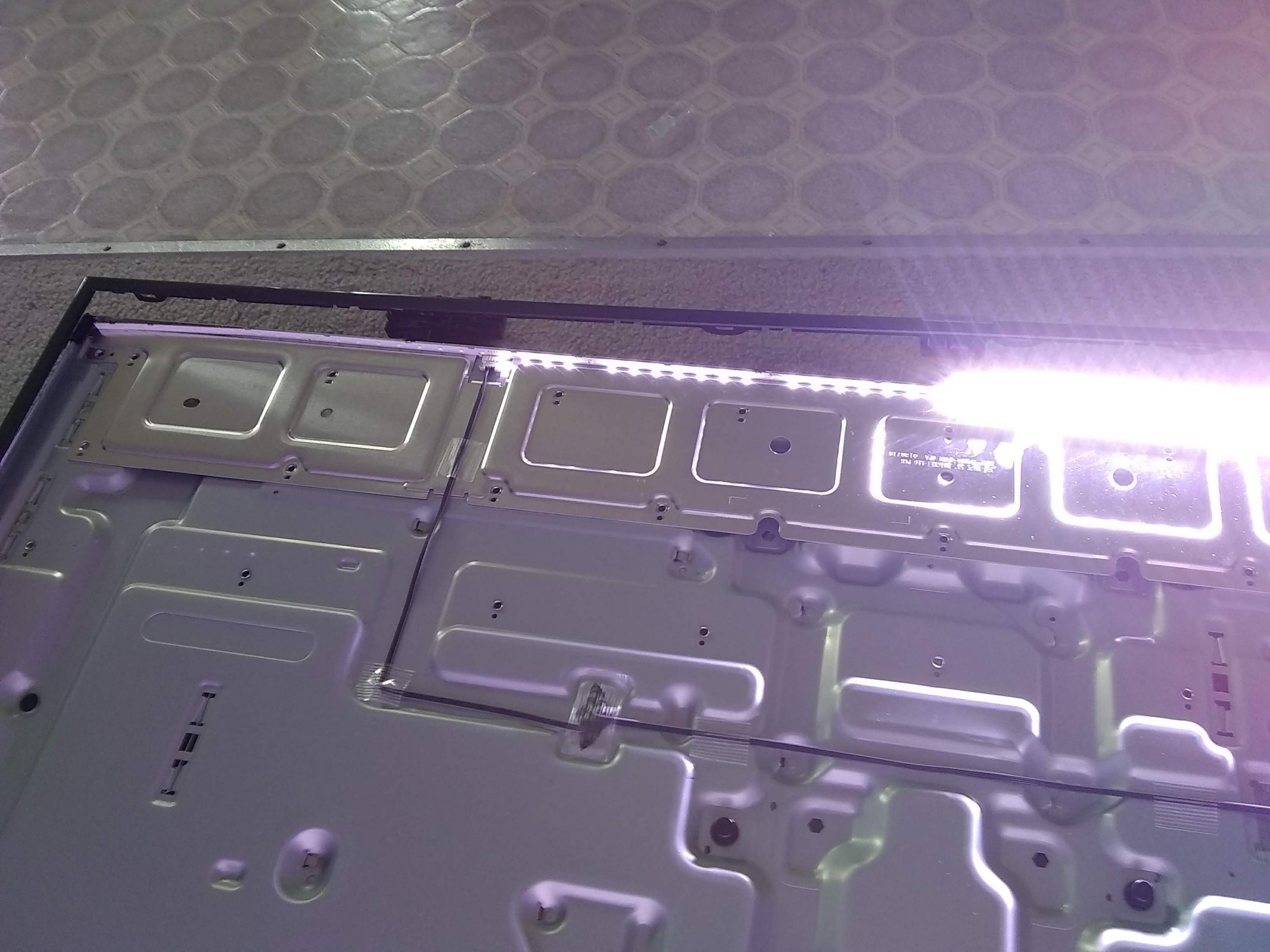

      This is a piece of shit edge lit Tv and the led bars get so hot they can melt and even crack the diffusers. If you own a Samsung Tv with edge lit backlighting turn the backlights down to at least 10 and turn off ECO settings before this happens to you. The thick clear diffuser gets melted and leaves light bleed on the bottom. Sucks Samsung. It sits on top of the led bars to direct the light up into the diffuser. Here is a picture of how hot these get. If it is cracked it will likely show the crack when you turn it on.
            Originally posted by simbaisaboy
            Can a new diffuser be bought anywhere? If so where? I have 3 Samsung TV's that have this issue. Replaced all LED light strips successfully. But can't use any of them until I locate new diffusers!
            Even with ultra-transparent adhesive the crack WILL SHOW. The main diffuser panel is not available individually as it is part of the "panel assembly".
            This is a very common problem with the NU model series. I have a 40" NU7100 and a 65" NU7100 with the same problem and have disassembled several of this model with melted and cracked diffusers. As a result when I get a busted screen NU model Samsung with a good diffuser I keep the main diffuser and label it with the panel part number.
            You might try contacting some electronics recycling facilities in your area and see if they have a busted screen TV with working backlights and with the SAME model AND version number. If you get one, make sure the PANEL PART NUMBER is identical to yours and that the diffuser isn't melted before you install it in your TV.

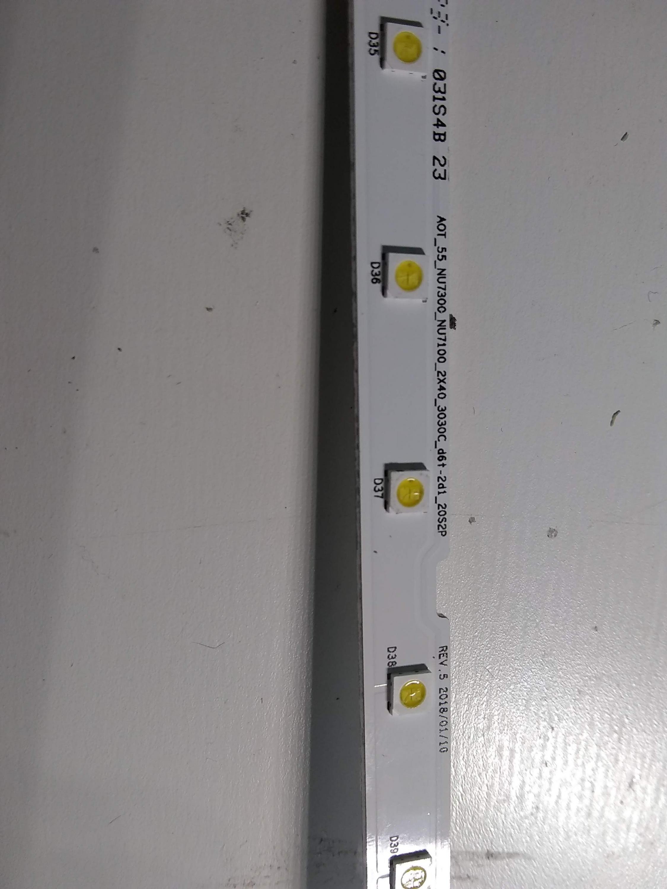

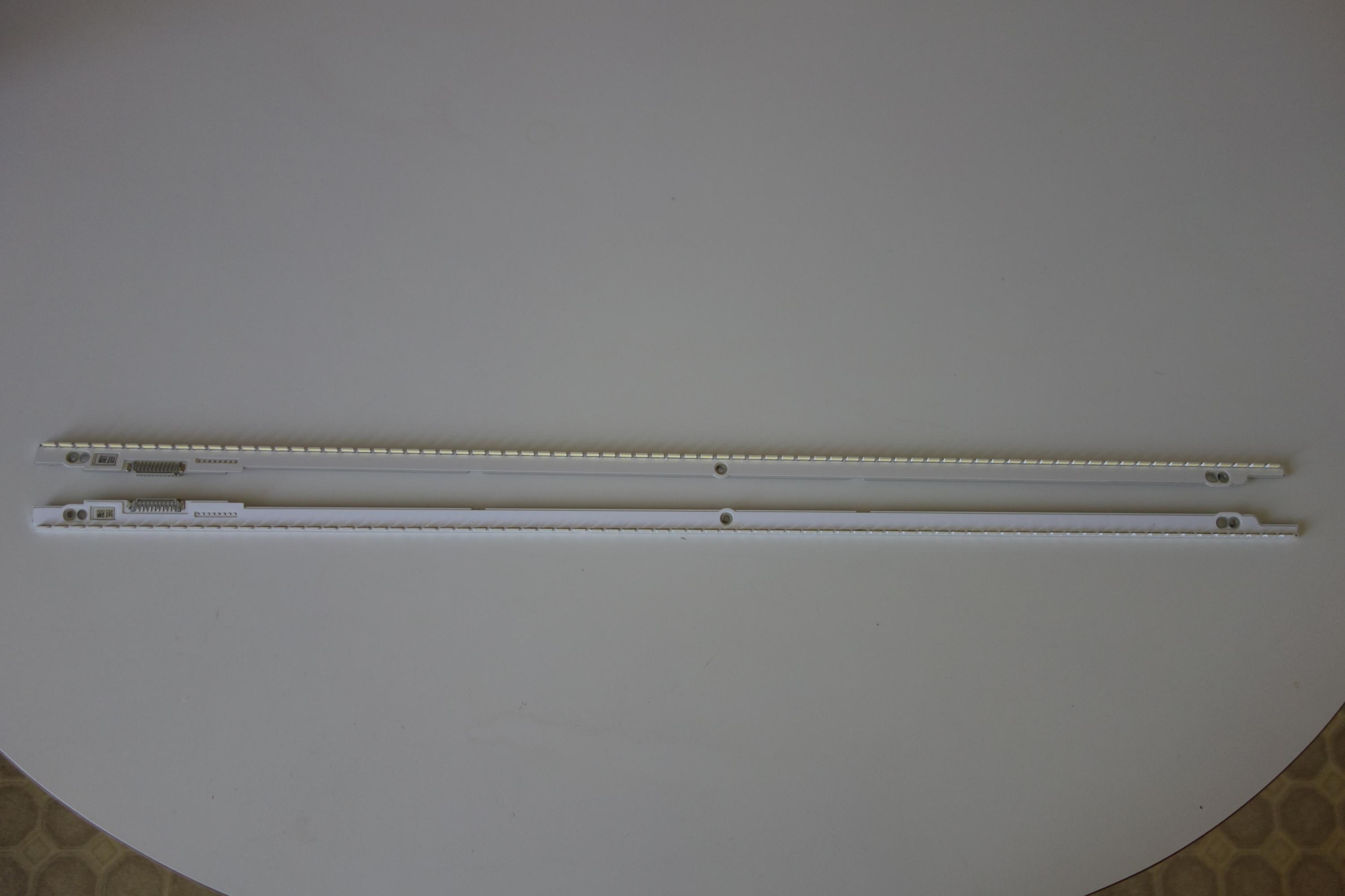

              That panel is typically a part that doesn't get salvaged since this model is the first edge lit model that exhibits melting along the edge. The NU design has the LEDs spaced further apart, along one edge only and they run both brighter and hotter. Probably saved Samsung $2 per TV reducing the number of LEDs in the strip. Pic 1 55NU strip. Pic 2 55ES strip (left and right)
