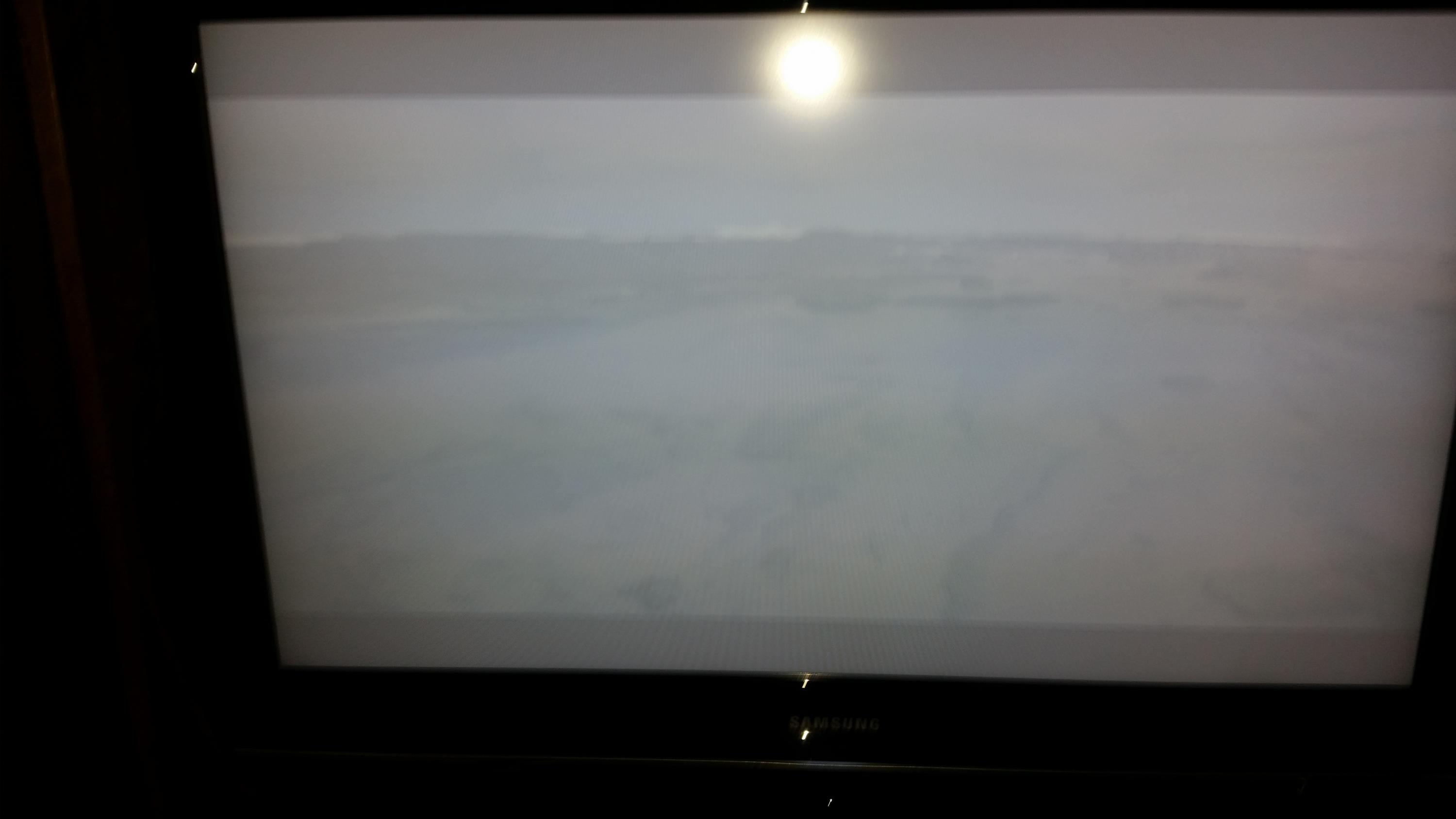

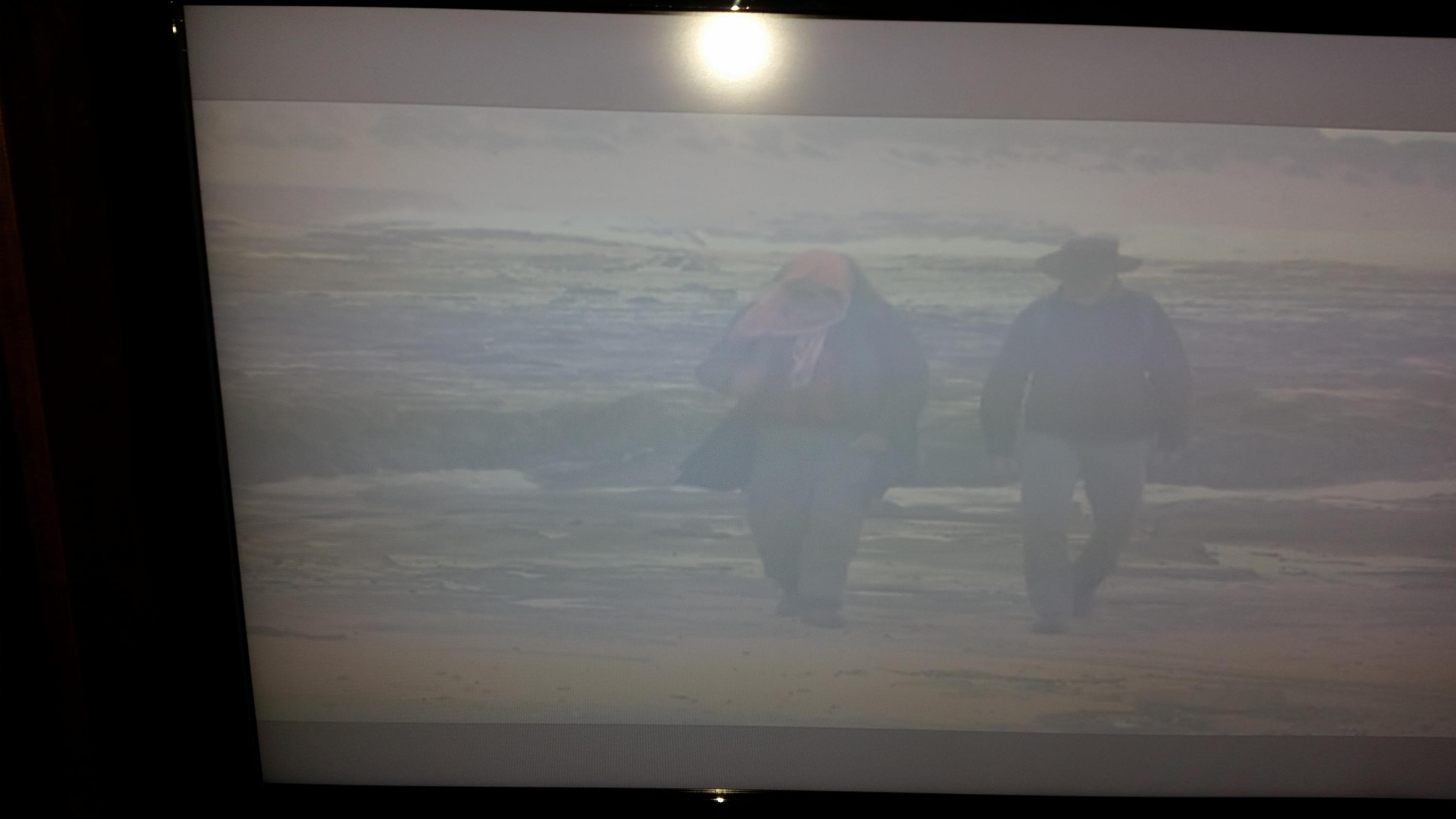

    Recently my Smsung LN37A550 has developed a problem where the picture starts to fade to white and I am hoping one of the forum members can kindly help me make a preliminary diagnosis. The tv starts normal and the picture is fine for several minutes before the picture starts to fade as if a heavy fog came in. You can still see the picture but it is now obscured by this white haze. Sometimes the picture goes back to normal after a while but always reverts back to the white haze. Turning it of and then on again it will start normal but soon the problem will come back. The only other symptom is that the TV has been difficult to turn on using the remote in the weeks proceeding this problem. This weekend I plan to start taking it apart to check if I can diagnose the problem. I would greatly appreciate any advise your forum members can provide to help me solve this problem.

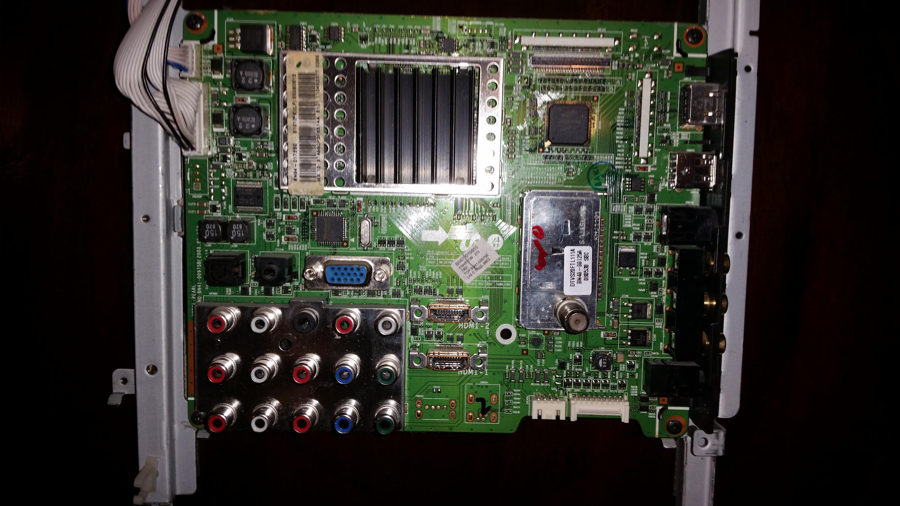

    Re: Samsung LN37A550 Repair
    open it, take good foto's of all the circuit boards.

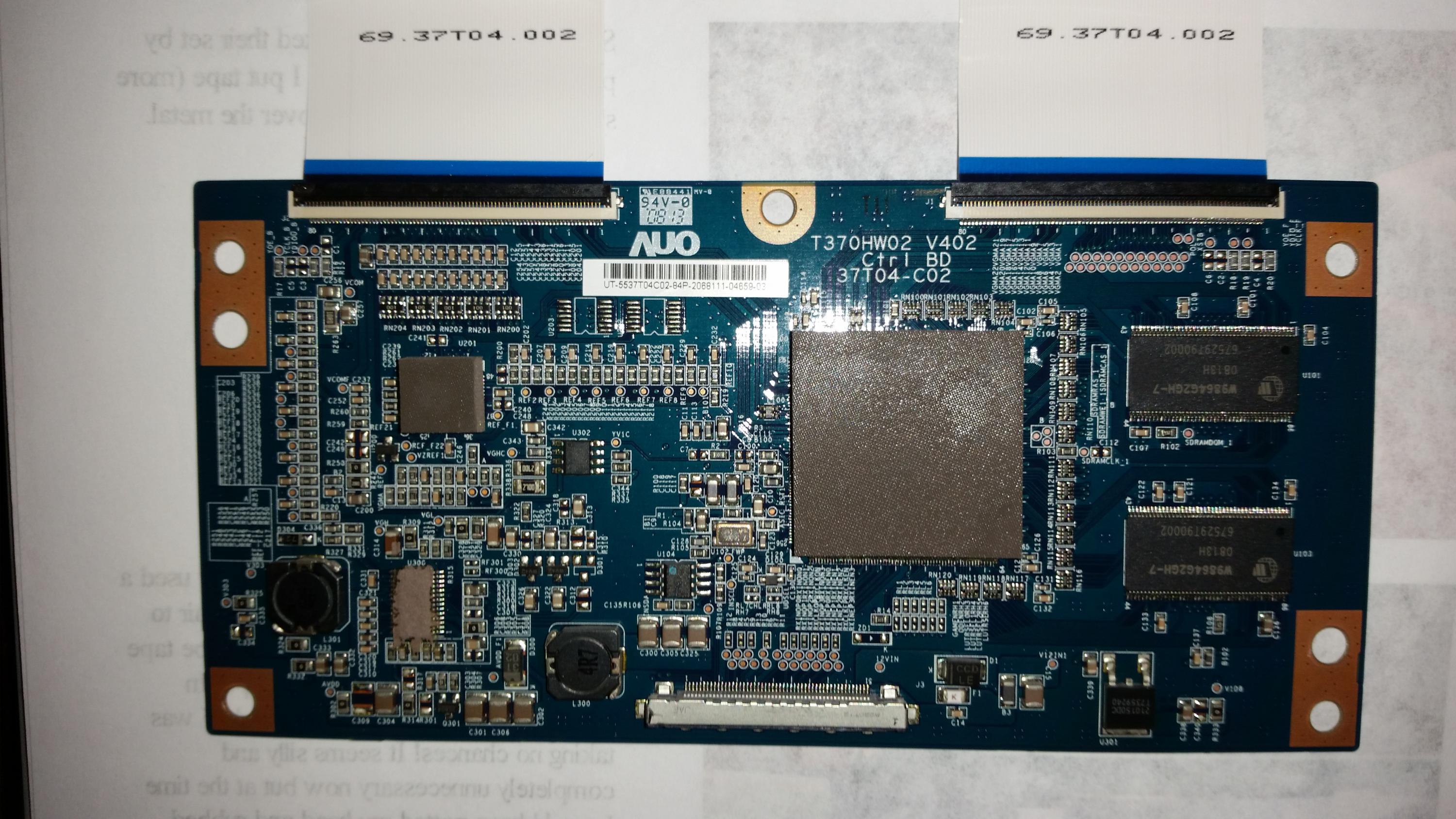

      This looks like it could be a gamma IC fault, can you supply a picture of the T-con board? The difficult to turn on problem could be unrelated and caused by bad capacitors.

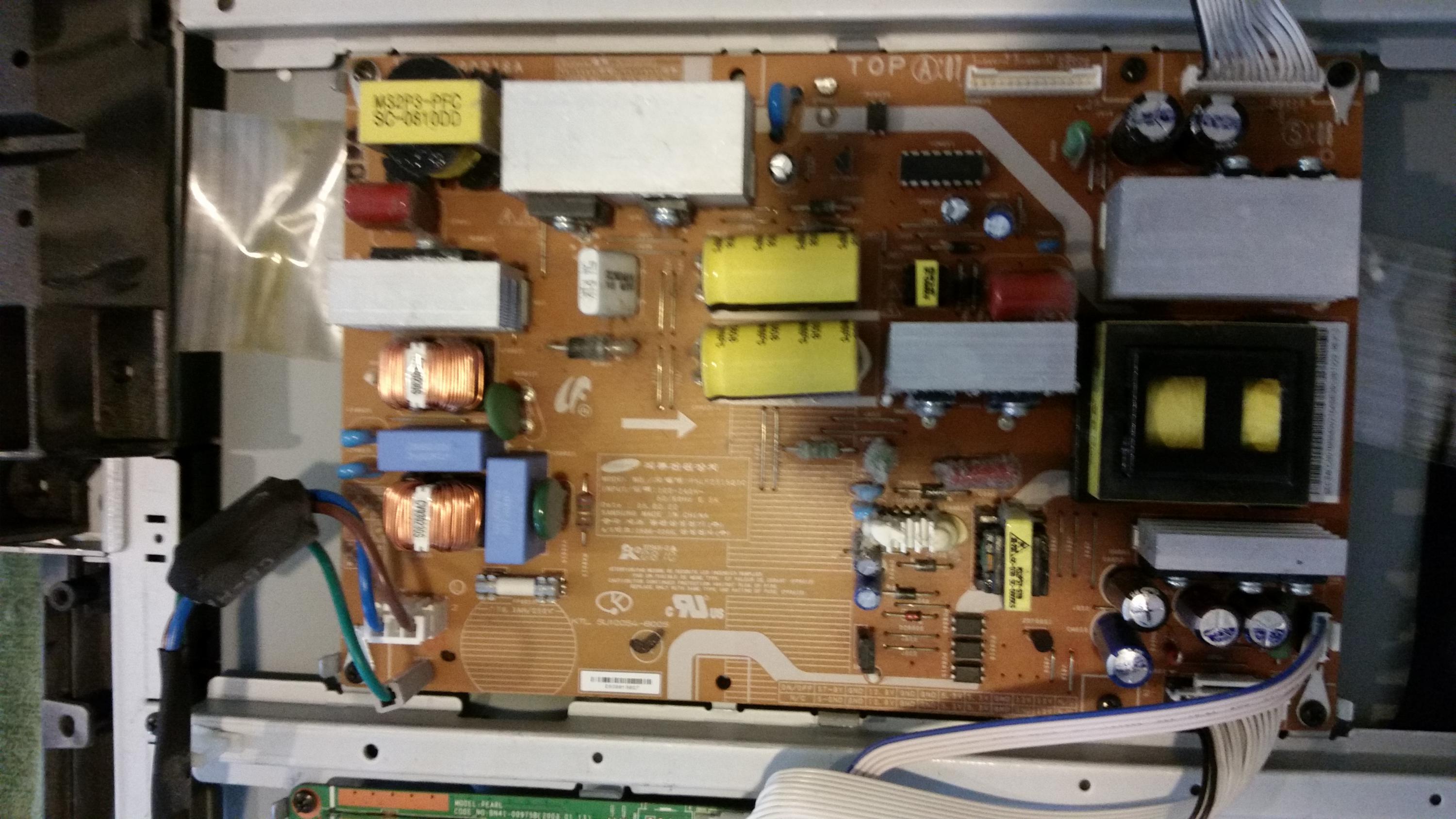

        Tonight I opened the TV up and all I see is two bad capacitors on the power board CB852 1000 uf ans CM859 470 uf. I also took pictures of the boards for the board members to review. I was not able to detect any damage to the boards but I am not an expert. Any advice on how to proceed would be greatly appreciated.
          OK, on the top right of the T-CON board by the connector, there are test pads for testing the GAMMA Voltages: VGMA1~22. Please take the DC voltage and list each readings for us to see. I suspect U201.
            Thanks for your reply. As requested by budm Below are the voltage readings for the VGMA test pads.
              It does appear that the gamma IC is bad i.e. U201 as budm said. If you are good at surface mount rework, replacing the IC is easy. Otherwise, you will have to get your T-con repaired, or replace the T-con with a new/used part.
              I would also replace the bad capacitors as while they are unrelated to the image fault, they will eventually fail completely stopping the TV from powering on at all.
                    You will first have to remove the pad over it, then clean the top adhesive with a little isopropanol. Typically, the part number is something like AS15-F, and all AS15 chips will interchange with each other. You can buy them on eBay for a couple $ each.
