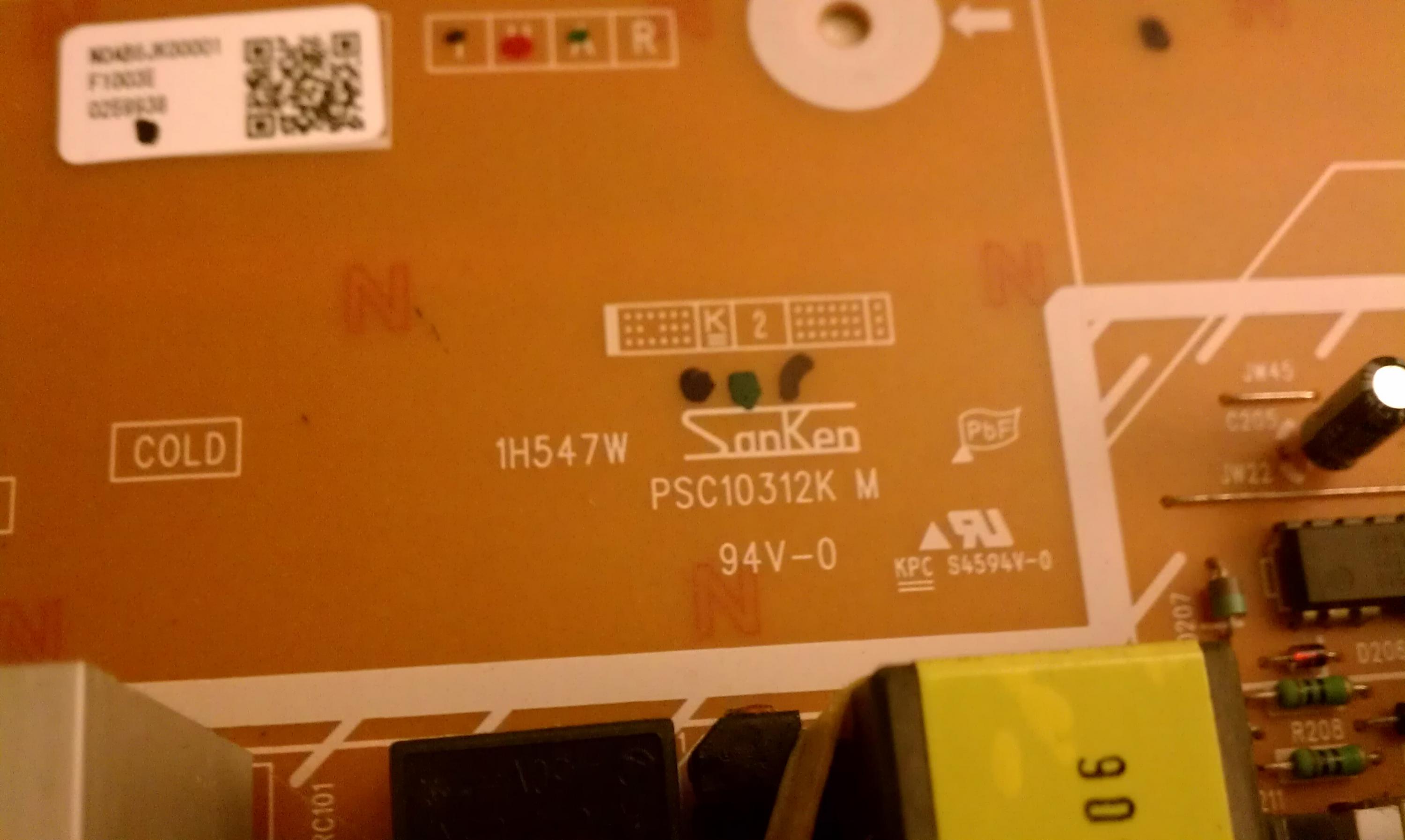

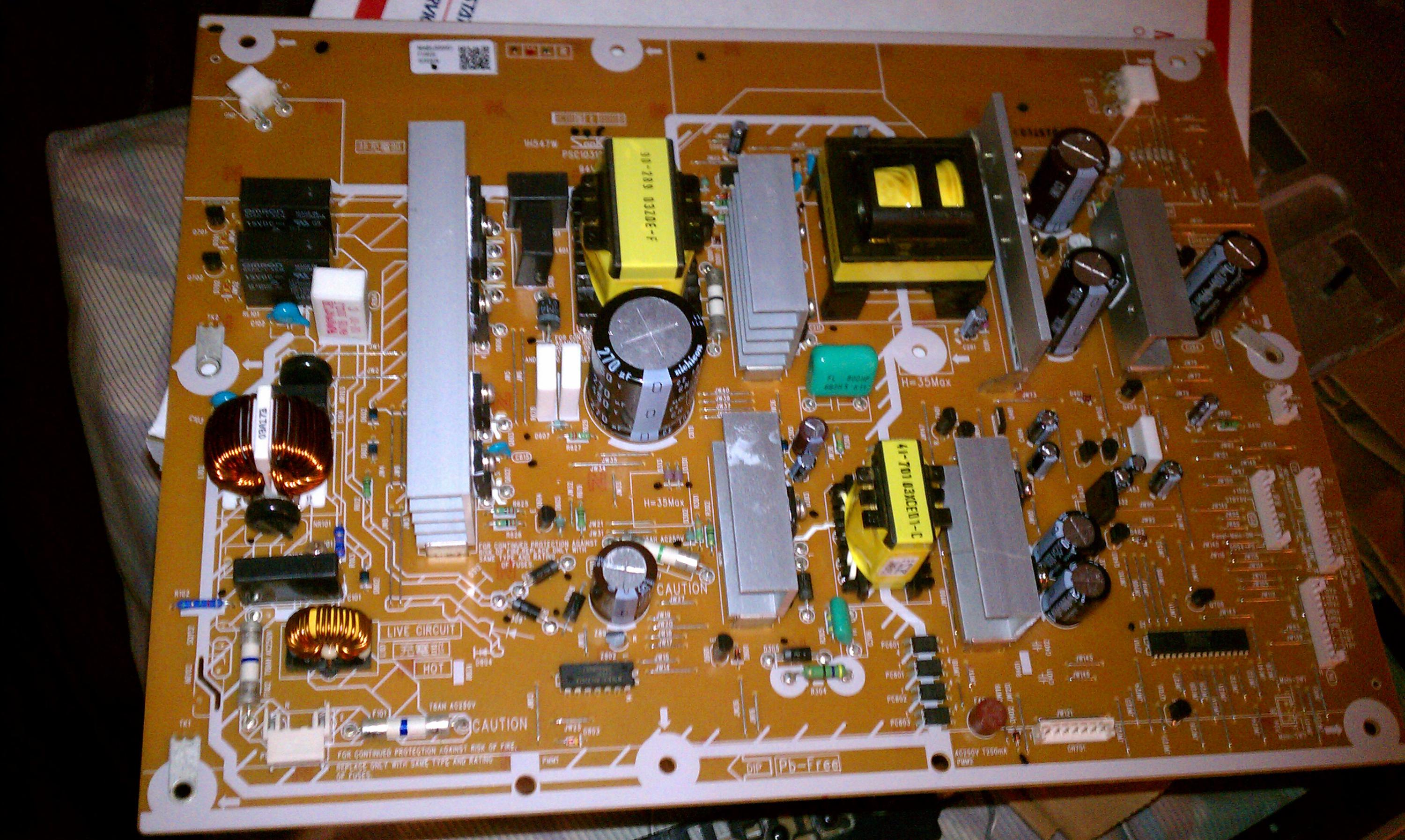

                            tv is still running strong a few months later. my friend loves his "new" tv, hes in front of it for hours every day! anyway so i found another one of these at the recycle place...or so i thought...turns out the chassis number is slightly different. the one i started this post with is chassis 04, the new one i found recently is chassis 00.
                            when we first got it, it worked for a whole day, then turned off. i was able to turn it back on, but then it turned off again after a few minutes. you could hear the relay switch inside keep trying to click over and over but nothing was happening. so i pushed power to turn it off, and it turned off. now today i look at it again, and it turns on just fine and stays on, and the backlight lights up but the picture only flashes for an instant every 10 seconds or so. i dont know much about how the plasmas work exactly yet but i figured i'd open it up and swap power supplies with the one i had fixed before since i know its good.
                            but then i got stopped.
                            they look the same on the outside but on the inside the parts are different.
                            different but similar. the PSU board still has all the same connections but the 00 chassis PSU is much bigger than the 04 chassis, i just might have to stretch a wire to reach.
                            but i am worried about just trying this power supply since if it blows then my friend will be really bummed. how can i know if these PSU are compatible?

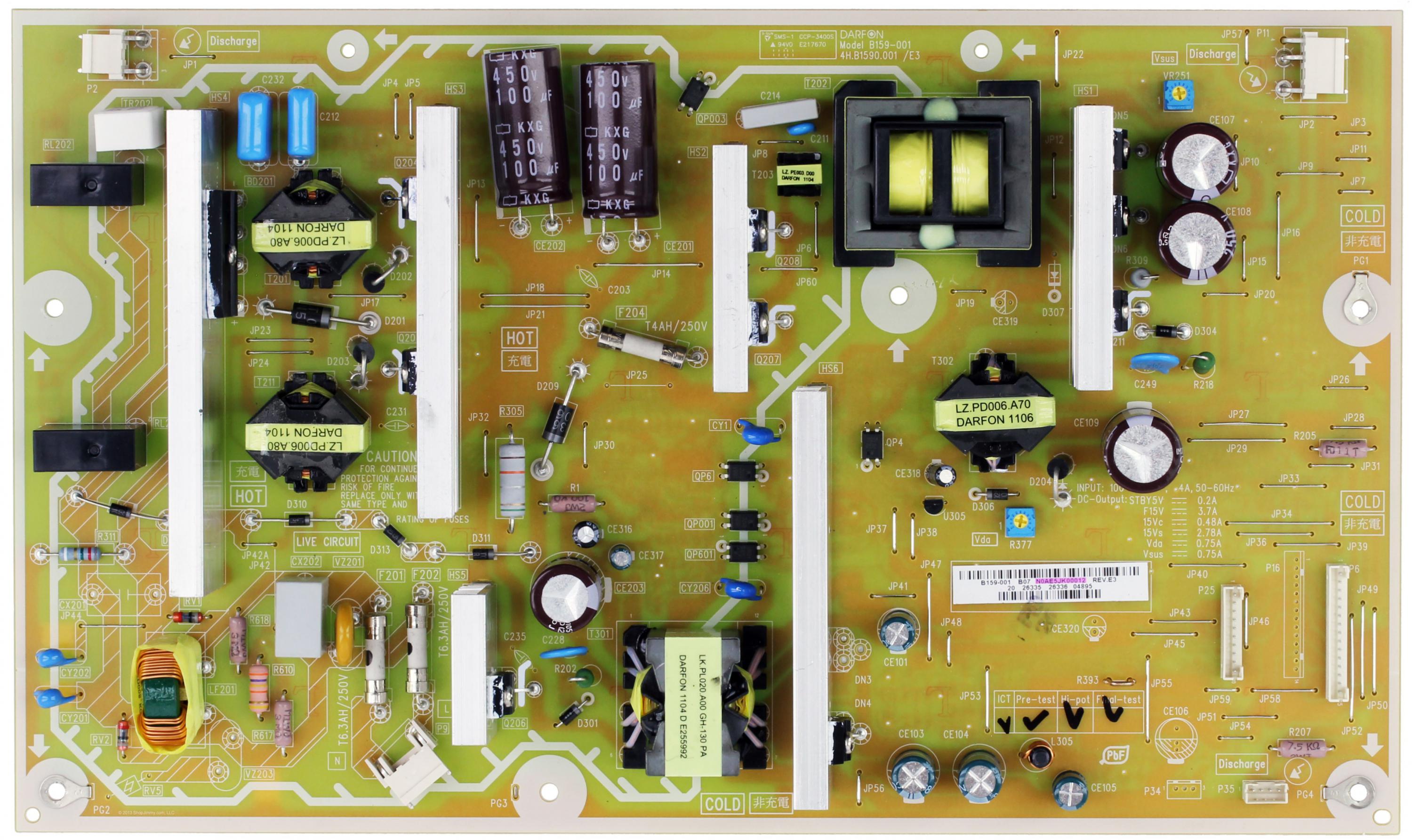

                              heres the psu from chassis04

                                Check with shopjimmy to see if they are compatible.
                                  #56
                                  Re: Sanyo DP42740 no power
                                  thanks bud. i was able to see on shopjimmy that the two boards 1AV4U20C52300 and N0AB6JK00001 are indeed compatible. i wonder if the mainboards could be as well...
                                  Don't fear the repair...
                                    #57
                                    well according to shopjimmy they are compatible and maybe they are, but the connectors arent and i would have to disassemble and reassemble connectors to make the wiring correct... big pain that i just dont have the patience for at the moment. im pretty sure it is the power supply anyway. it seems like its an overheating issue since it turns off after a while (a few hours or maybe all day) and then wont turn on again until it cools down. is this only capacitors that cause this kind of behavior or could it be another part?
