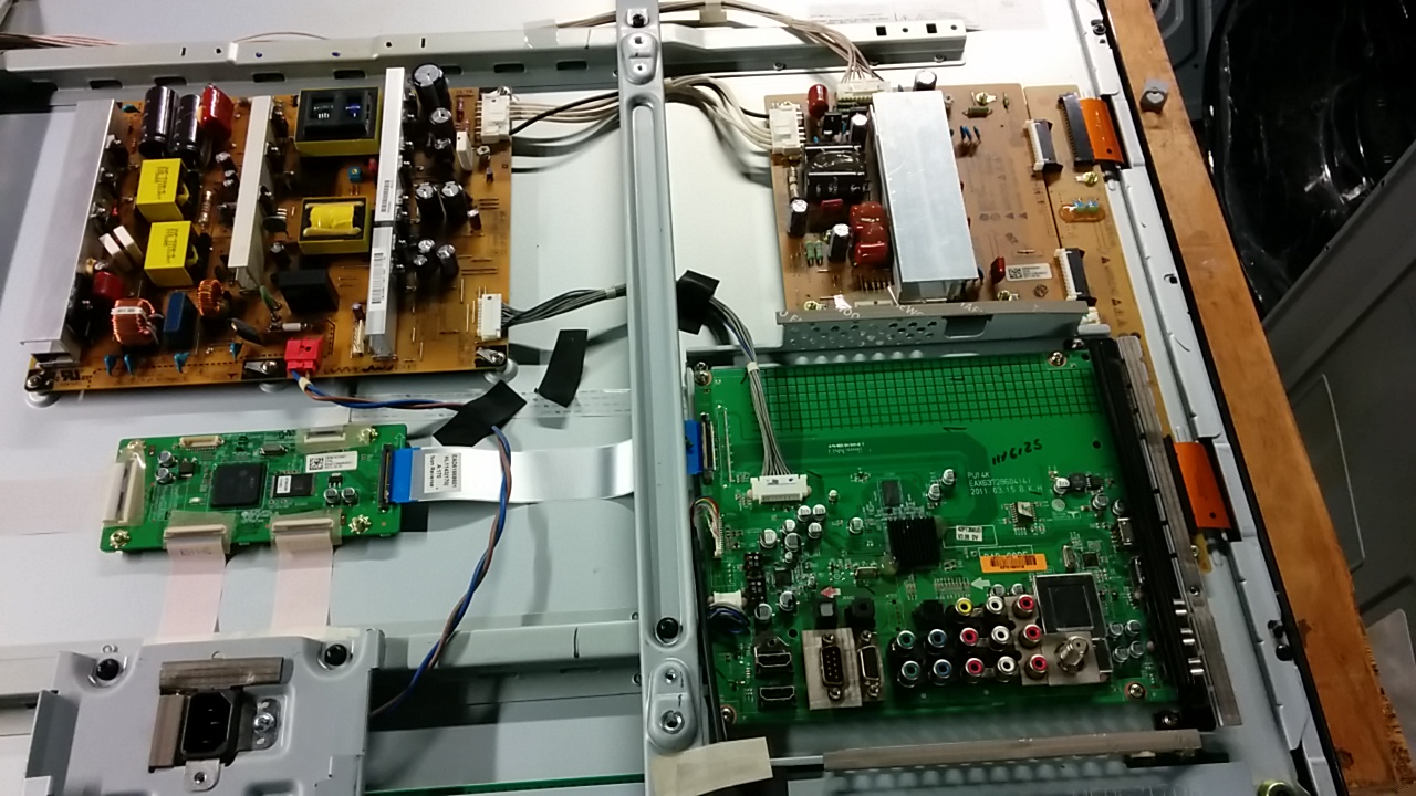

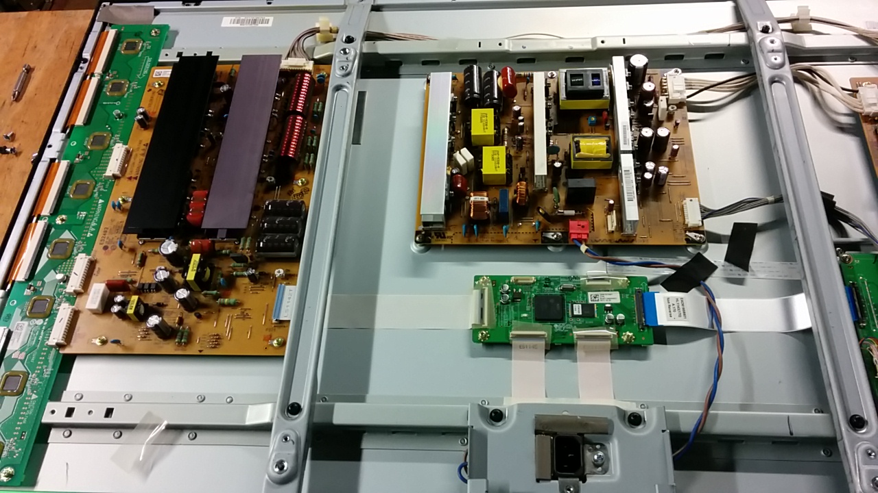

Ok so i unplugged z sus and ysus. And power supply will turn on and stay on with va and vs power voltages at correct readings. So as soon as i plug in zsus it will cut off, and i cant plug ysus in or out direct cause it runs from zsus. So is it bad zsus?Comment
Re: how to fix plama lg 42pt350 help?
That is a possibility, if you remove it, you can check it for shorts. But I am confused, you said you had brief Vs/Va. If it were shorted you could not have that.Please do not PM me with questions! Questions via PM will not be answered. Post on the forums instead!

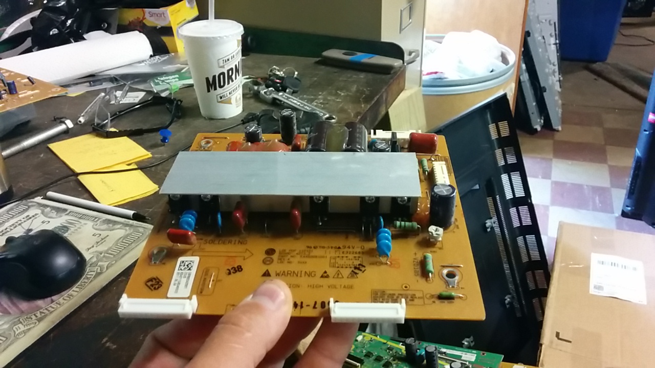

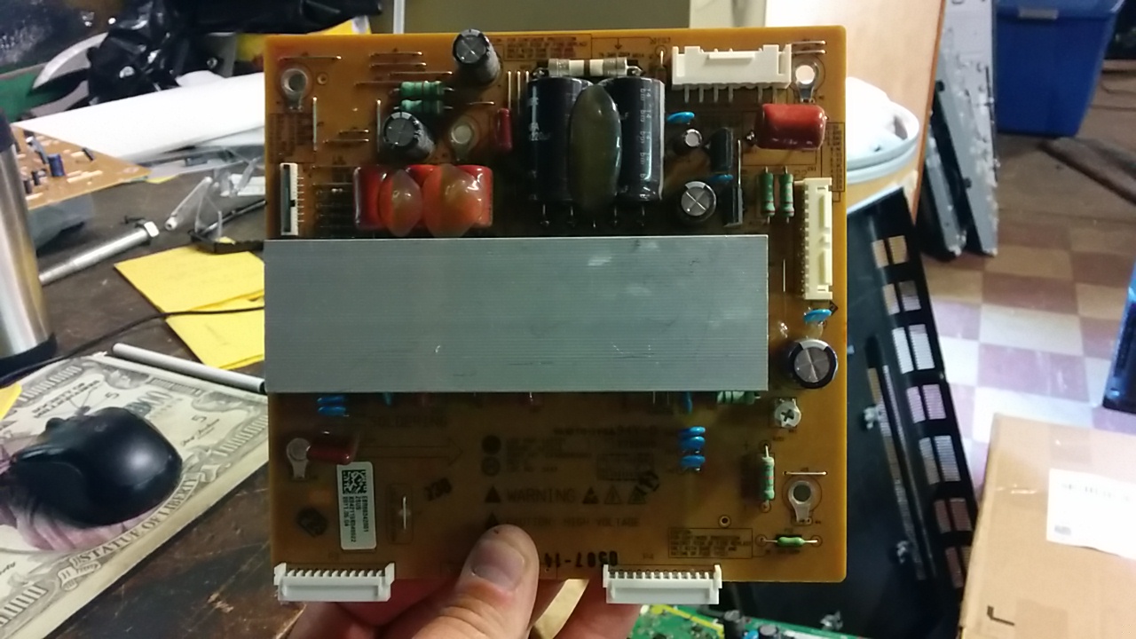

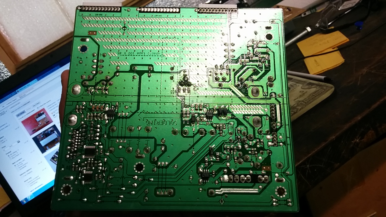

ok well regardless though tom it works without any of that hooked up, so when I hook vsus back up then it doesn't work, so what else can I check? but it looks like zsus right?Comment
It is a definite possibility. If you remove the board, it can be tested, if you supply good clear photos of the top and bottom sides of the board.Please do not PM me with questions! Questions via PM will not be answered. Post on the forums instead!
For service manual, schematic, boardview (board view), datasheet, cad - use our search.Comment
Board looks fine to me, You need to check the MOSFETS etc for shorts....TELEFIX
PLEASE DO NOT EMAIL ME PRIVATELY FOR REPAIR ADVICE. QUESTIONS BELONG ON THE FORUM!Comment
MOSFETs/IGBTs are the three legged devices on the heatsink marked Qxxx.
Diodes are usually two legged. In some cases there are three legged diodes with two pins tied together on the board, these are marked Dxxx.
For Qxxx, you want to put your meter across all three combinations of pins (both ways, 6 per device) on diode test and look for a reading less than about 30. In all cases, leave the reading to settle for a few seconds. A low reading indicates a possible short which requires investigation - it should ideally be removed to confirm.
For Dxxx just test both ways across it and look for about 300 to 700 one way, open circuit the other way, note a shorted transistor can make a nearby diode look bad. It is very rare for diodes to fail in a plasma TV.Please do not PM me with questions! Questions via PM will not be answered. Post on the forums instead!
