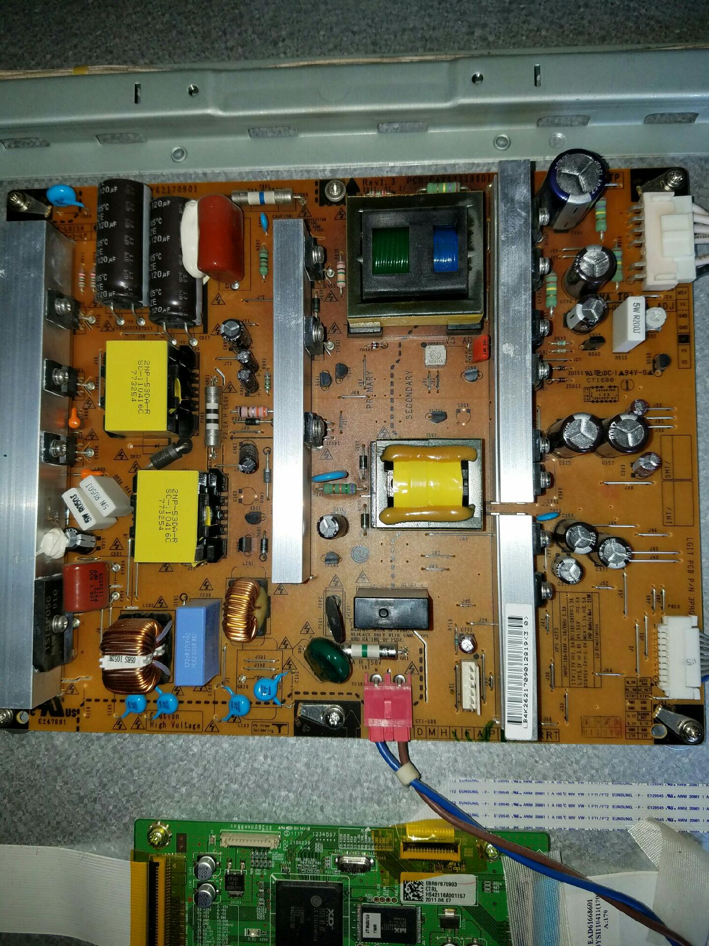

                  Alright here is my photoset covering all of the boards getting as good of pictures as I can with what is at my disposal. I can attempt to retake some of the pictures if needed.

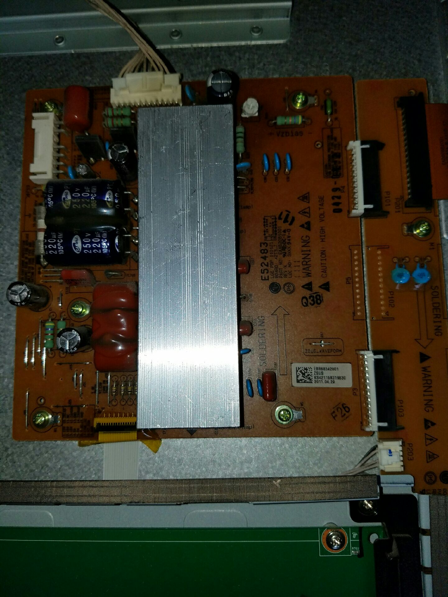

                        Re: Two LG TVs having issues. 50pc5d and 42pt350.
                        So that helps but not alot at all, remove Zsus on 42" and see if it has cold solder joints.
                        • Lavitz
                          • Mar 2017
                          • 14
                          • United states
                          Board removed, I don't really see anything that looks cracked in the soldering. Some of it looks a bit bubbly around the edges but it still seems like the solders should be fine.

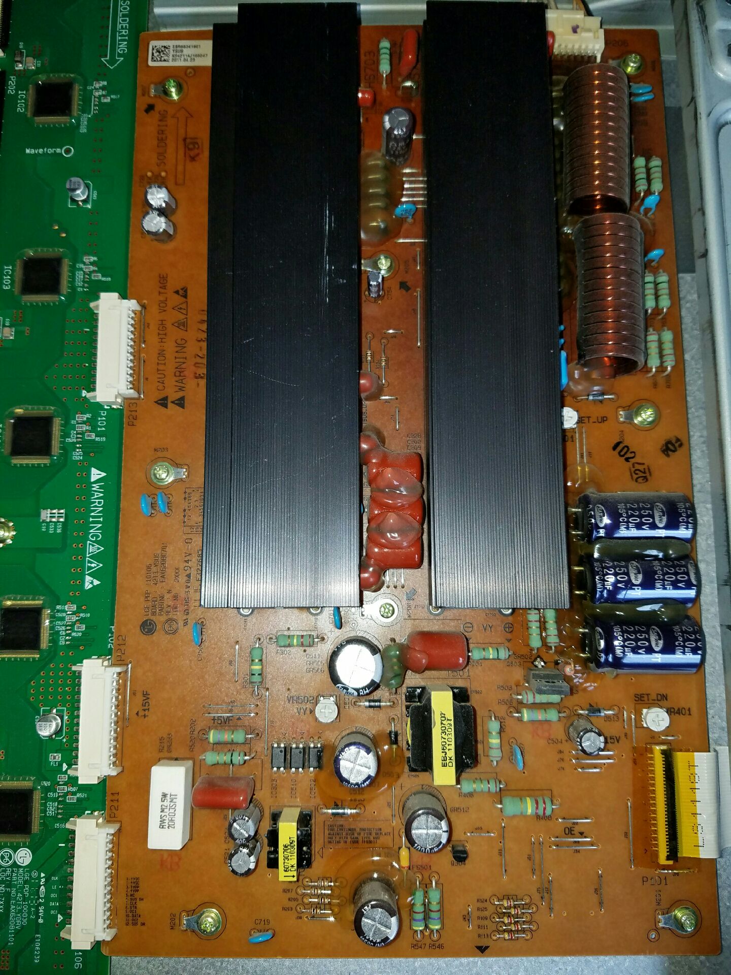

                              Ok have you a picture please ? On your PT350 the Ysus has all the ERC parts and coils so Id check there.
                              • Lavitz
                                • Mar 2017
                                • 14
                                • United states
                                Here are two pictures for a bit better clarity since it is a relatively big board.
                                  Welp, I feel kind of blind for not seeing it before, but I decided to try checking the vs and va on the TV as per suggested in an alternate thread. When I plugged my tv in I heard a very light buzzing that I apparently just didn't pick up on previously. I didn't get a chance to see what the voltages were since I came straight here after seeing the resistors at the top look burned. I checked the picture I posted and sure enough the board is blackened in the picture too. I just apparently straight up missed it. So does that mean something on the power supply is shorted out?
                                    Hard to tell dark image but this damaged? marked in pic.
                                    • Lavitz
                                      • Mar 2017
                                      • 14
                                      • United states
                                      Sorry about how dark some of the pictures have been. My lighting kind of sucks. I just took some of the bottom of the power supply and of the area you were questioning. I don't see any damage in the area you pointed out, the only damage I have found myself have been on the power supply. I will upload those pictures when I get them transferred
                                      • Lavitz
                                        • Mar 2017
                                        • 14
                                        • United states
                                        Alright pictures of the bottom of the power supply and the section you asked about.
