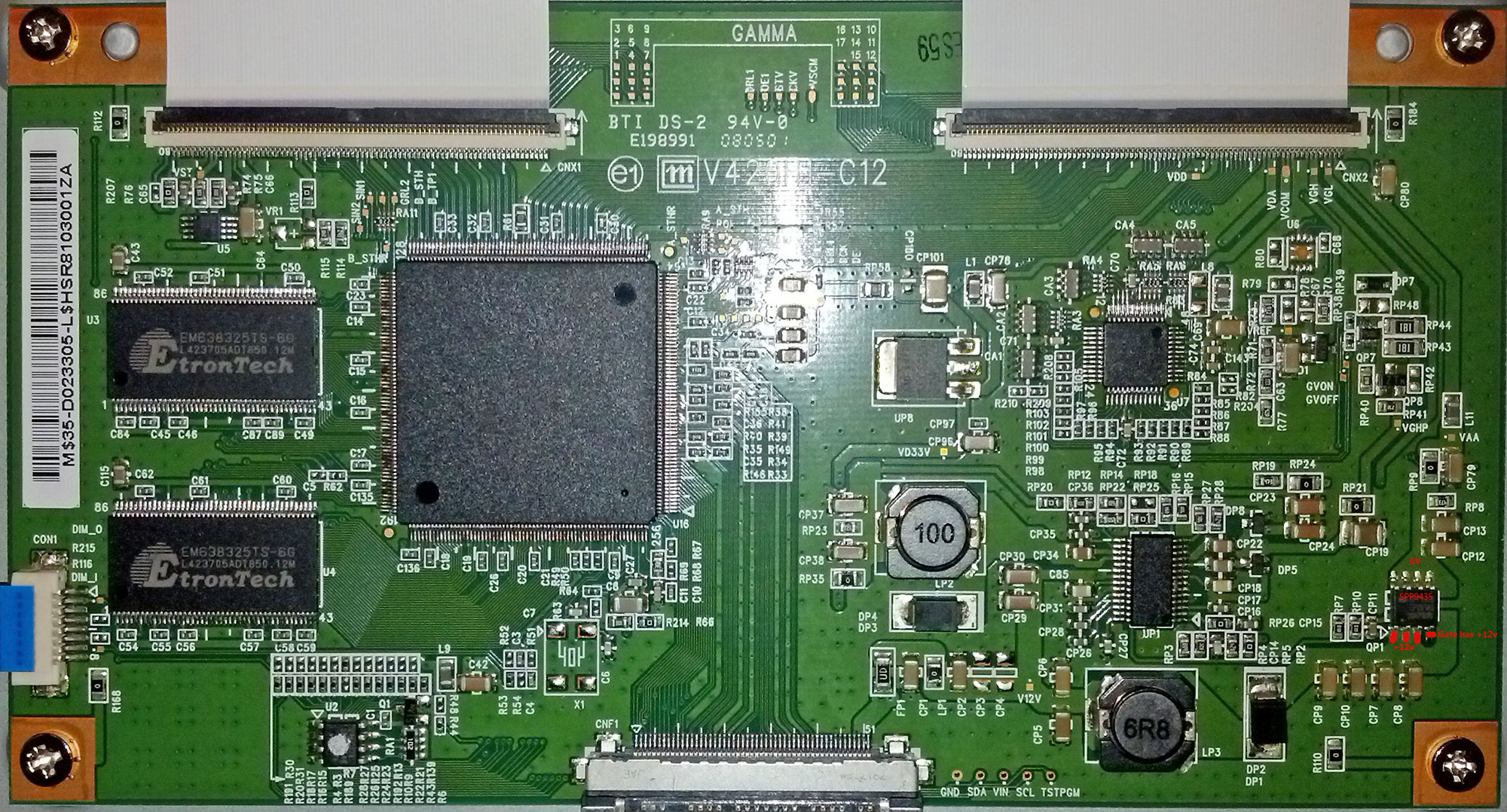

    T-Con Voltage Measurments
    I took some reading off of the T-con with my DVD player that was playing a movie and I got the following readings in no particular order:
    Gamma
    1-9 ~.32V
    10-16 .75V
    17 .3V
    18 0V
    SDA 3.2 V
    VIN 12.3 V
    SCL 3.27 V
    TST PGM 0 V
    POL 1.62 V
    ASTH .003 V
    ATP1 .2 V
    SIN2 1.63 V
    A_STHR .001 V
    B_STHR .006 V
    VST .4 V
    VGL -5 .56 V
    VDD 3.2 V
    VCOM 5.36V
    VGH 17.49 V
    VGHP 19.68 V
    V33V 3.23 V
    V12V 12.3 V
    V506V 5.42 V
    Pin 192 0 V
    DRL1 3.2 V
    0E1 . 87 V
    STV .003 V
    CKV 1.82 V
    VSCM 5.35V
    From what I was gathering in like postings this looks like a bad T-con, yes?
    Thanx again for the help!
    Bud

      #42
      Re: Need Some Repair Advice LG 47LG50
      Yeah. Looks bad to me.

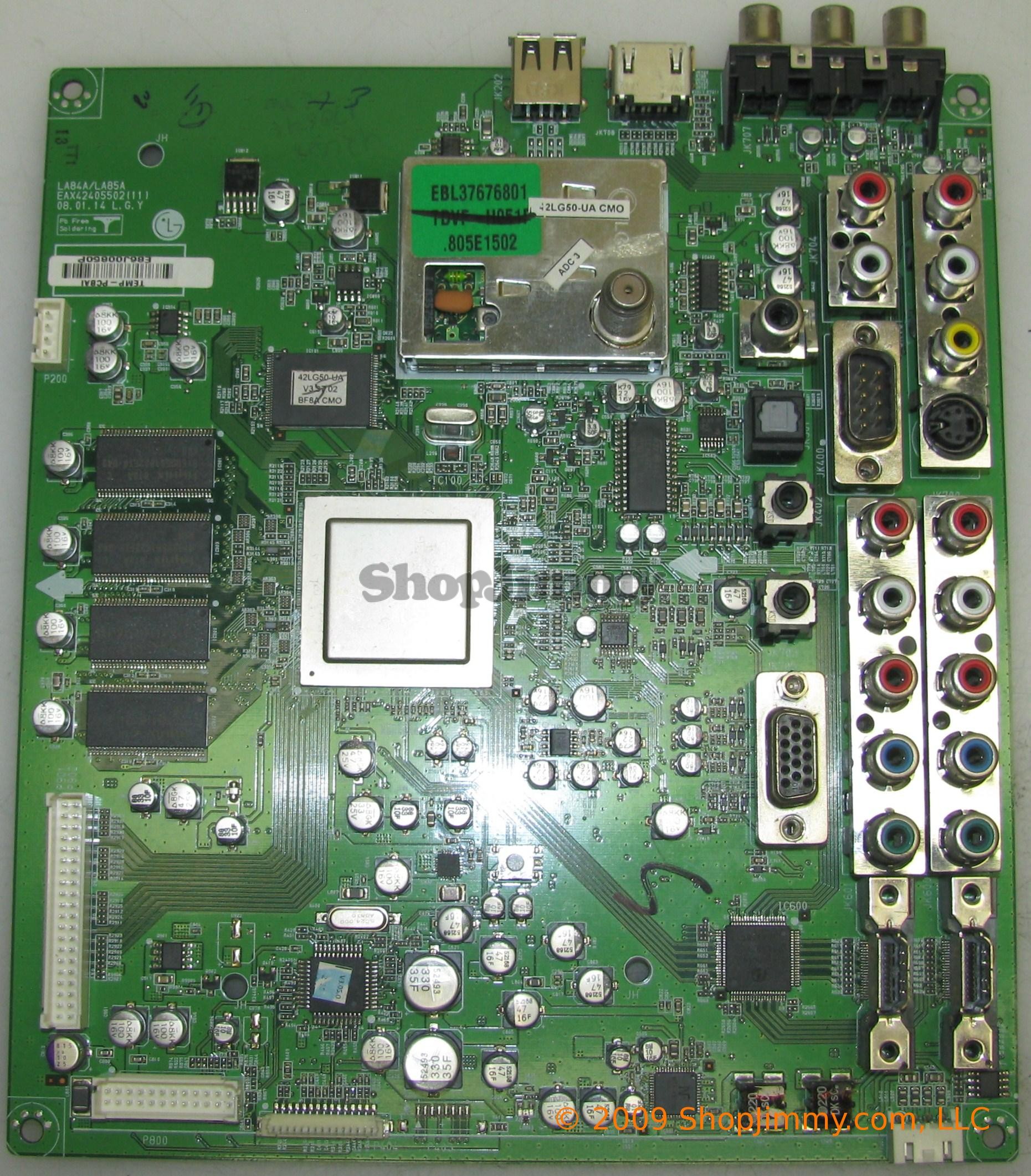

          #44
          It's alive!!! Got the new T-con board and that was it. I had to replace the main board and the T-con both. Thanx again to all of the knowledgeable folks who lent a hand from this great forum!
          BTW, I took a chance and got a replacement main board that although was for the exact same model set, the part number was slightly different and it works just fine my main board was an EAX42405502(5) and I put in one with the same # but with a suffix number (11) and it works just peachy.
          For a $75.00 investment I've got a pretty nice 47-incher!
          Thanx again,
          Bud

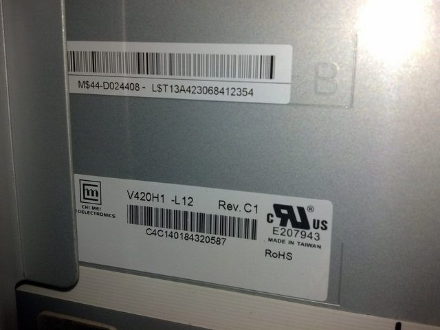

                                      #58
                                      Here's a picture of the sticker
                                      Liberating magic smoke one part at a time
                                        #59
                                        Well I am running of idea, I looked at the spec sheet and it does not seem to have control signal pins.
                                        New main board?

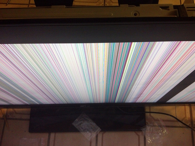

                                          #60
                                          I was thinking it was likely a scan driver failure, I am seeing main board sending out lvds voltages, cant really test them without a good panel though. If i unhook the left ribbon to the panel I get half white half lines, if I unhook the right ribbon I get half black and half lines. I guess I will have to take a look at the panel drivers to see if there is anything amiss.
                                          pulled the top cover and dont see any scorching or burnt ics, since this has the same tcon as the toshiba if I lined them up back to back would it be safe to tie in the lvds from toshiba to the lg? that should tell me if the panel is ok or not.
