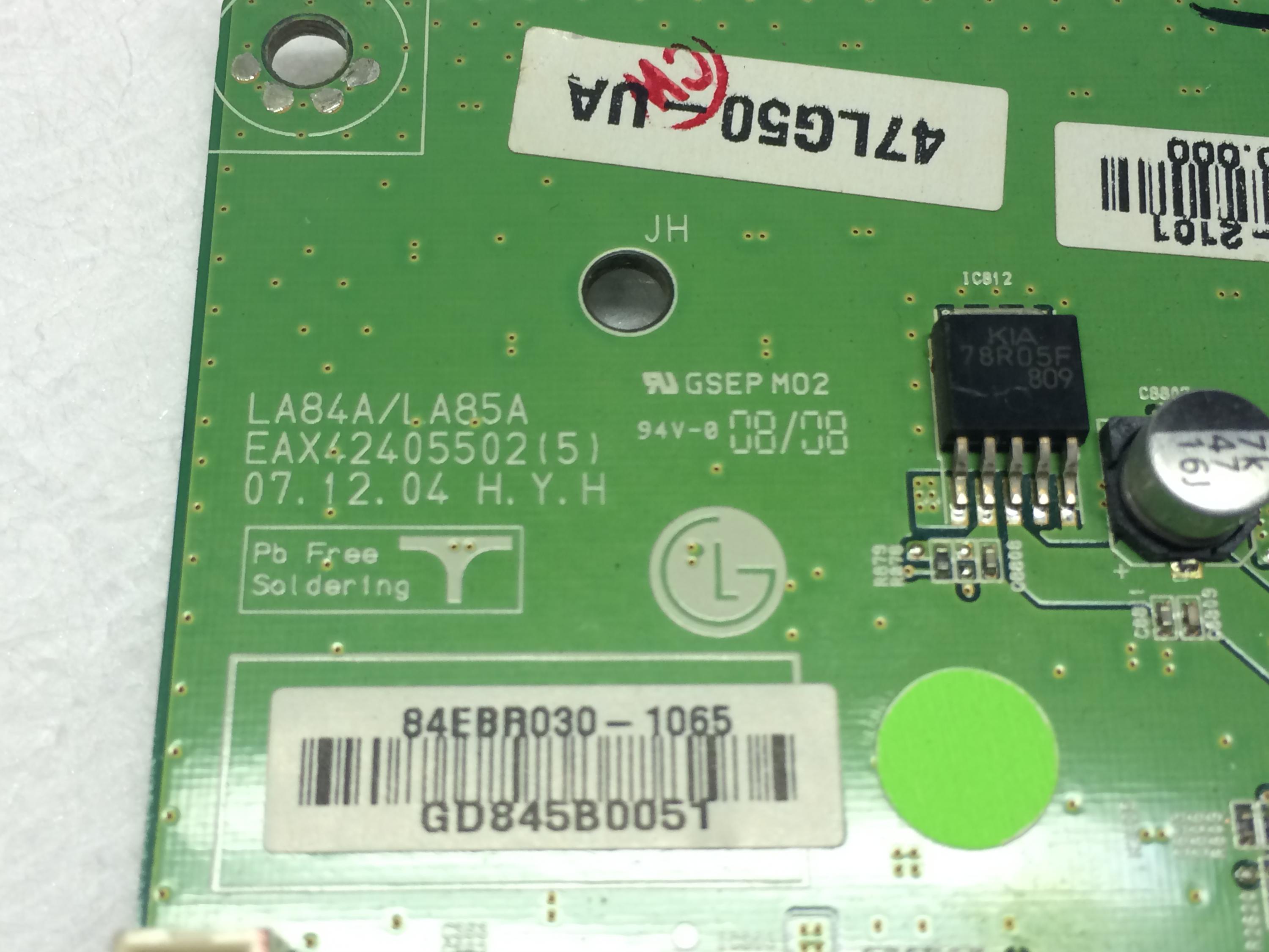

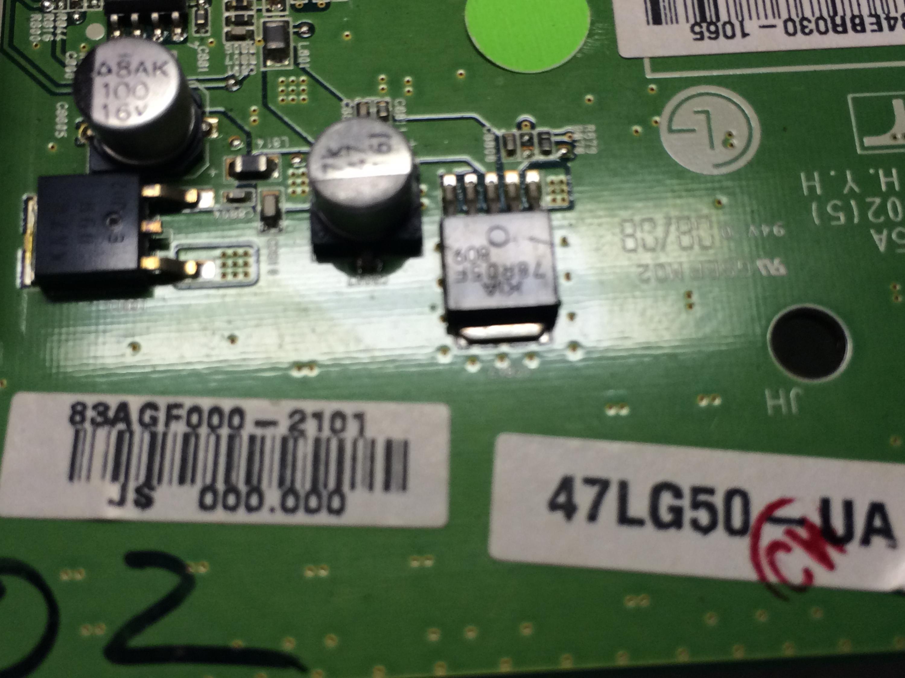

                                      Okay, guys...here's an update on this PITA TV.
                                      I got another main board and plugged it in and, Viola! everything came on. That's the good news...of course it has to be followed by the bad news, right?
                                      The picture is so bright that I can barely see anything displayed on the screen. All of the remote functions work as do the side buttons. I can go through the menu functions and I can make adjustments. I went into the picture sub menu and set the backlighting all the way to zero and while the screen did dim quite a bit the images were barely visible.
                                      All of the audio and everything elseis fine except the picture is just a big fluorescent lamp.
                                      Now what?
                                      Thanx,
                                      Bud
                                        #39
                                        Re: Need Some Repair Advice LG 47LG50
                                        The pictures look washed out? Can we see the screen shot? It sounds like the GAMMA Voltages are not right, it is either the new main board needs to be setup or something in the T-CON Gamma voltage problem.
                                        • 69sixpackbee
                                          • Jul 2014
                                          • 39
                                          #40
                                          Okay...
                                          I attached the screen shots. I took some voltage readings on the header at the PSU that goes to the master inverter cable. I took two consecutive readings. One at 100% backlight and the other at 0%
                                          100% readings:
                                          BR1 = 1.739V
                                          ON/OFF = 3.412V
                                          PWM DIM = 5.09V
                                          ERROR = 3.287V
                                          and at 0%:
                                          BR1 = 1.736V
                                          ON/OFF = .847V
                                          PWM DIM = 5.05V
                                          ERROR = 3.285V
                                          Interesting swing on the ON/OFF voltage
                                          I got a board from a (he seemed anyway) knowledgeable TV guy and he said it *should* work. My board had a different suffix number than the one he supplied me even though they look identical with the exact same chipset and from the same model of TV. Maybe this is the issue?
                                          My original board is an EAX42405502(5) and the one I received is an EAX4205502(11).
                                          I have included pics of the orig. and the replacement.
                                          Thanx again for the help! I am getting closer *fingers tightly crossed*
                                          Bud
