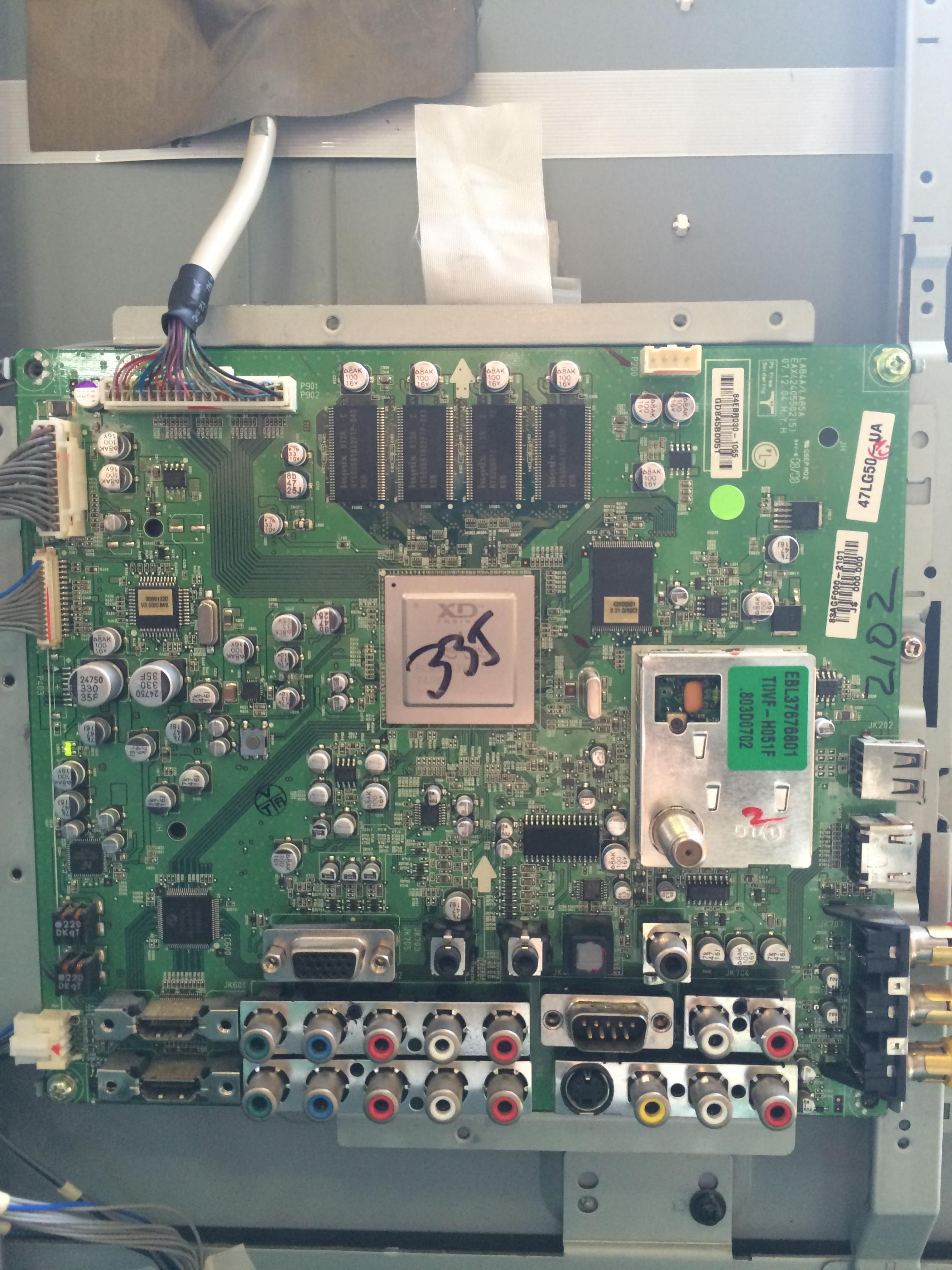

            Can we see the whole backside of the TV so we can see how all the boards are connected?

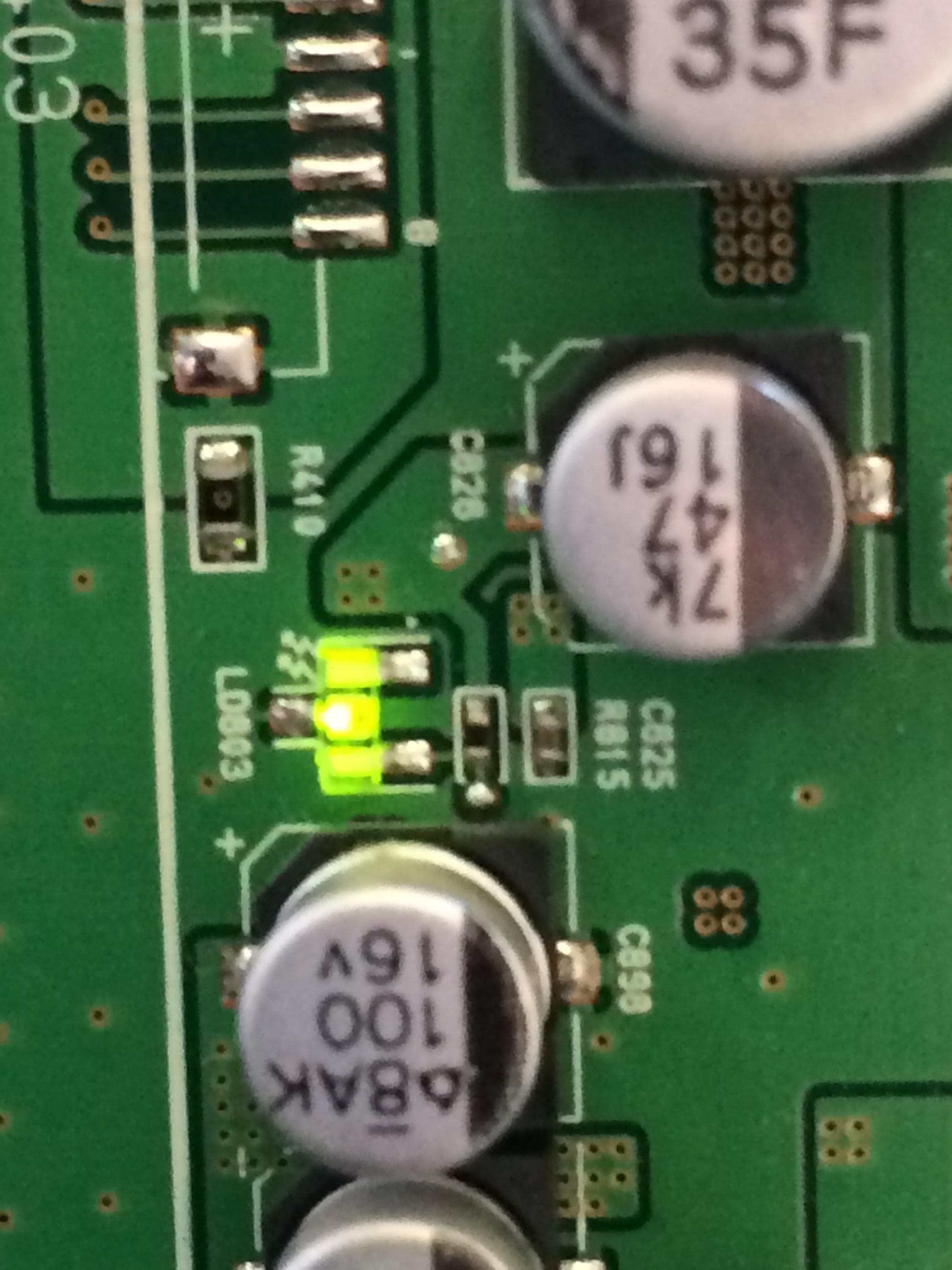

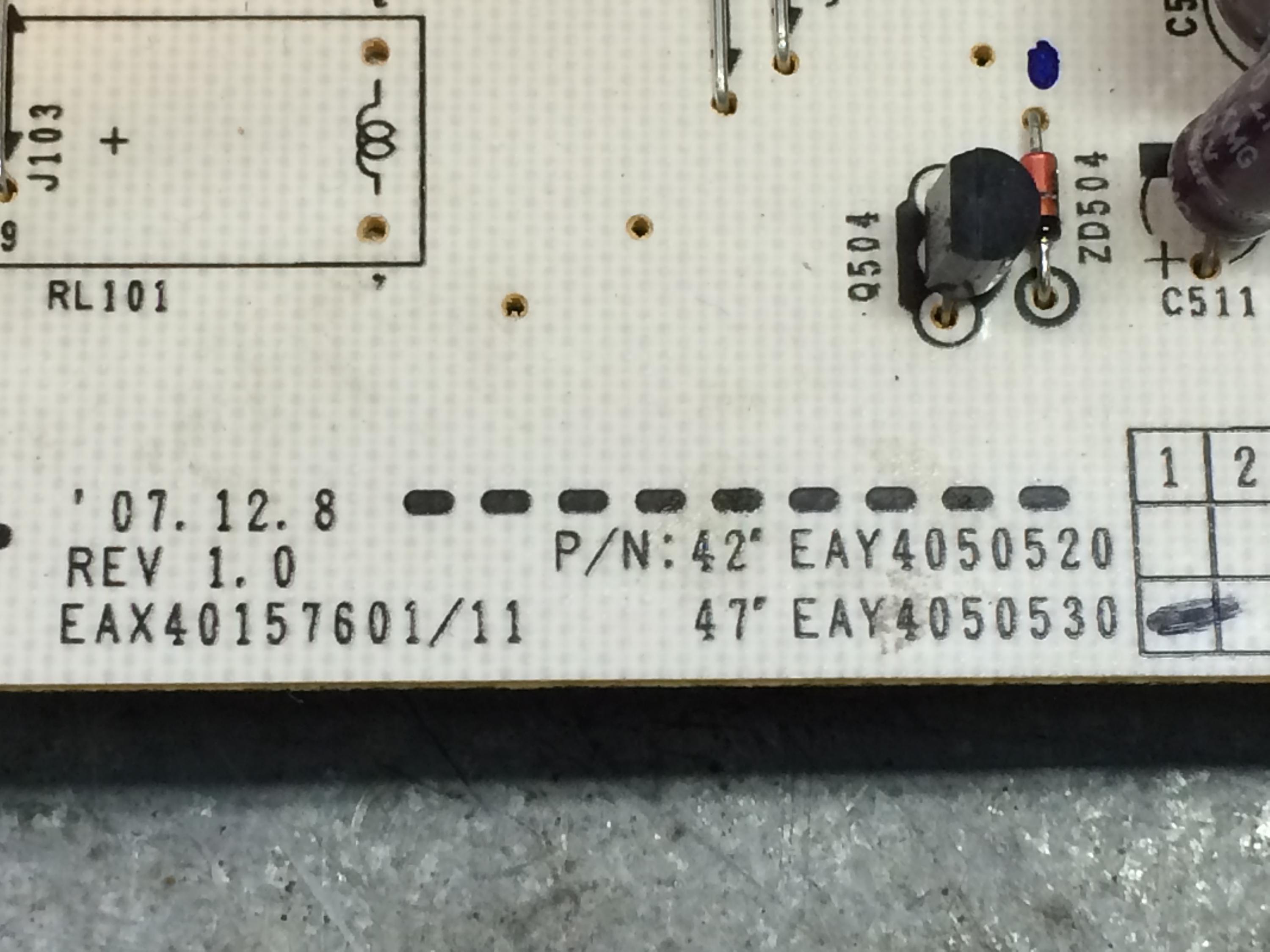

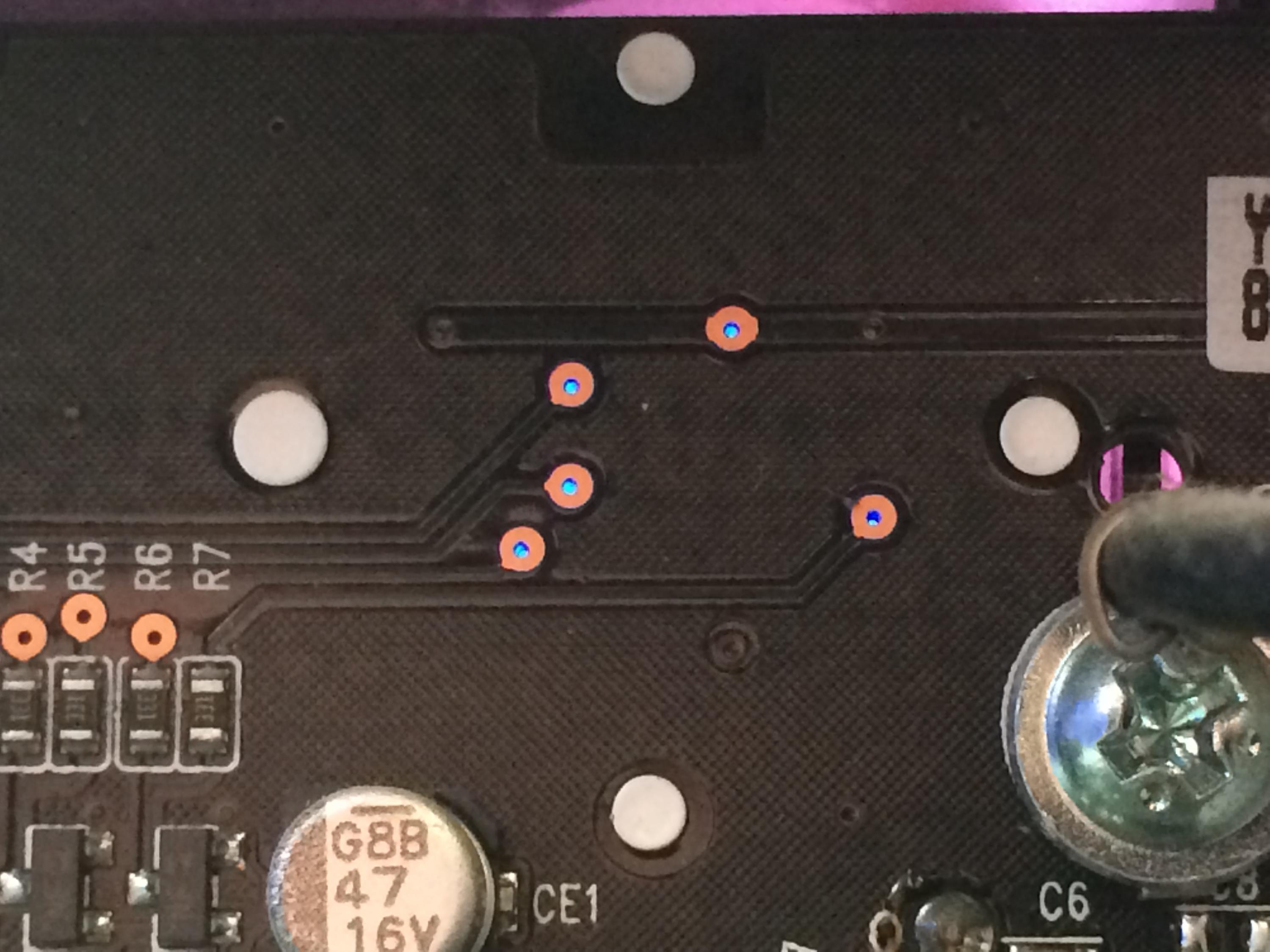

                Here are some updated images:
                When it is on I cannot hear any HV raster that I would be familiar with (think CRT sets) and I'm sure by the twin XFRMR's on the P/S board would lead me to believe that this should be the case to fire the bulbs. Not sure what the arraingement is on this set (I am kinda in the dark still) but I would think it is some sort of EEFL. The service manual is pretty vague and the lack of any and all schematics makes it even worse!
                I do not have the "proper" equipment to diagnose these LCD's
                The one image shows the blue "ON" LED as viewed from the back. It is so dim you cannot see it from the front through the bezel surround even in a very dark environment. The "Stand By" and "Powering On" indicators are pretty noticeable, however.

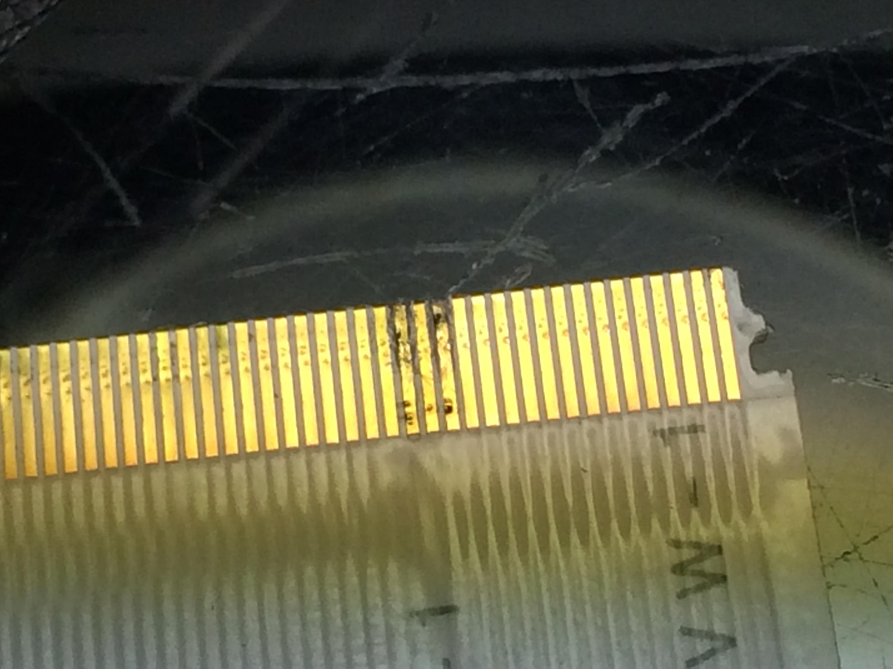

                BTW, those suspect looking traces on the ribbon cables running up from the T-con are okay. I rang them out for continuity and adjacent shorting and they are okay.
                Thanx!
                Bud

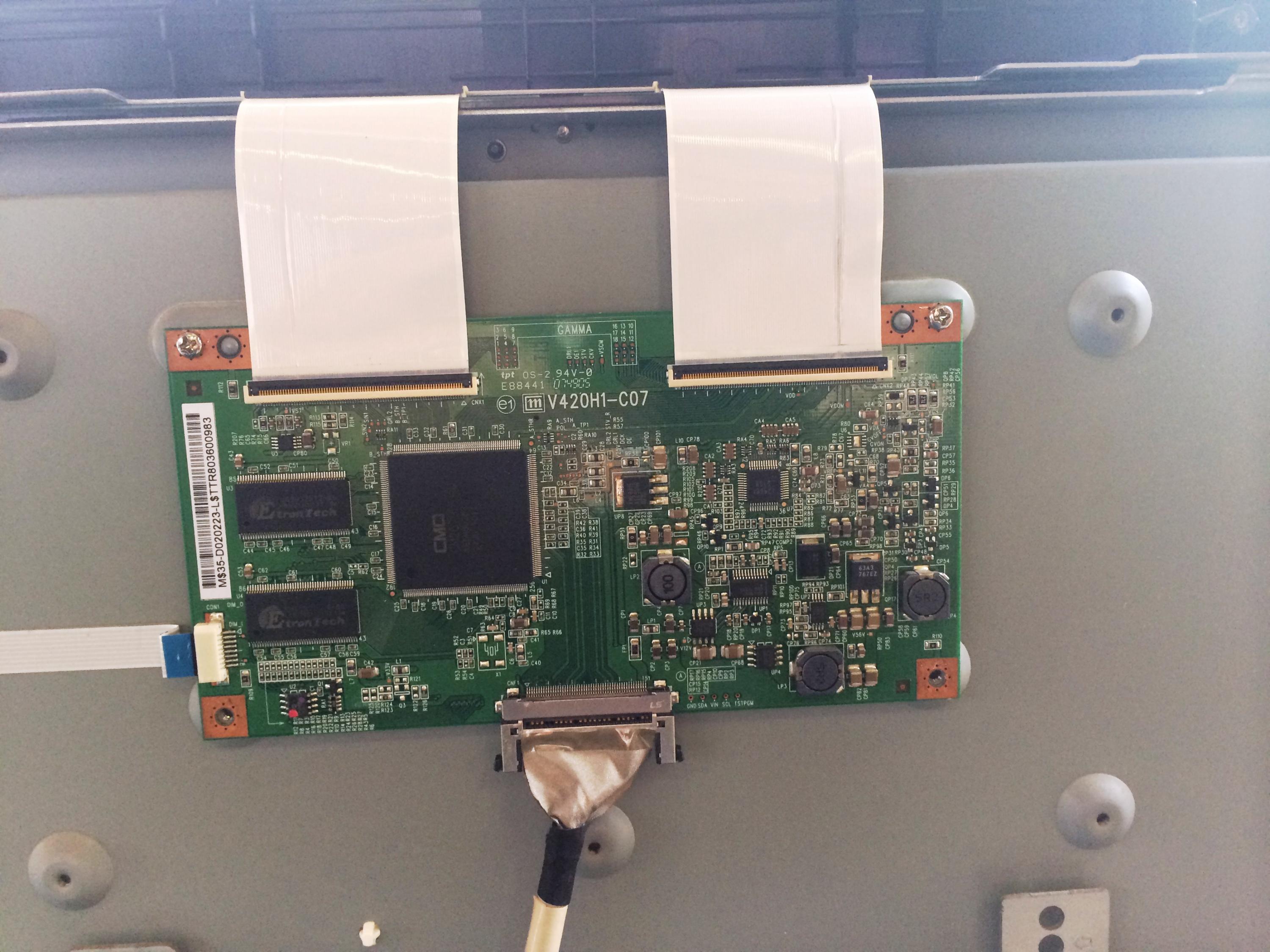

                  OK, TV unplugged, then disconnect the white flat ribbon cable between the T-CON and the MASTER INVERTER board (left board), then power up the TV to see if the backlights will come on.

                      Okay, I popped the ribbon cable from the header on the T-con and the screen is still dead.
                      .....Bud

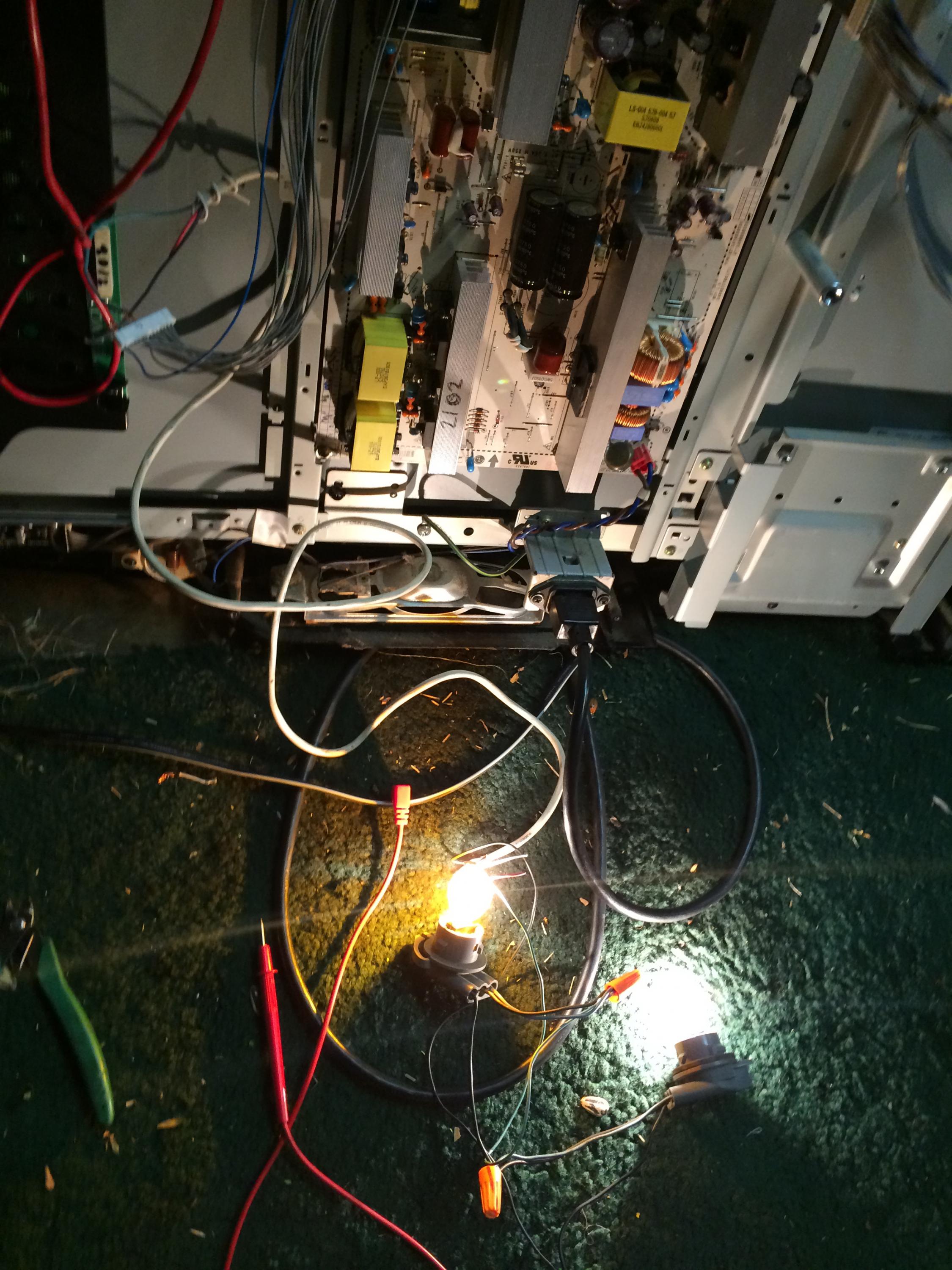

                        I dove into this a bit more and I am sure it is not getting the signal to fire the bulbs. The power supply voltages are all good coming from the PSU.
                        I tried the CFL test with a good curly-que bulb soldered onto one of the headers and it was silent. I took a closer look at the ribbon cables that ran from the T-con up to the board on the top and on each one there were some very warm traces at one time as evidenced by the melted insulation on the ribbon cables. I did measure 12VDC B+ on two separate conductors going up to the T-con so it looks like the main board is switching the power up to it. Just a thought. I checked the 4 SMD fuses on each of the inverter boards and they are fine. The +24 is there but whatever circuit is "pulling it down" is not working to fire the XFRMR's from what I can tell. I checked the +24 right at the cables going to them with my "automotive" series-connected test lamps and the voltage is rock steady as is the +12 measured at the cable going to the main board.

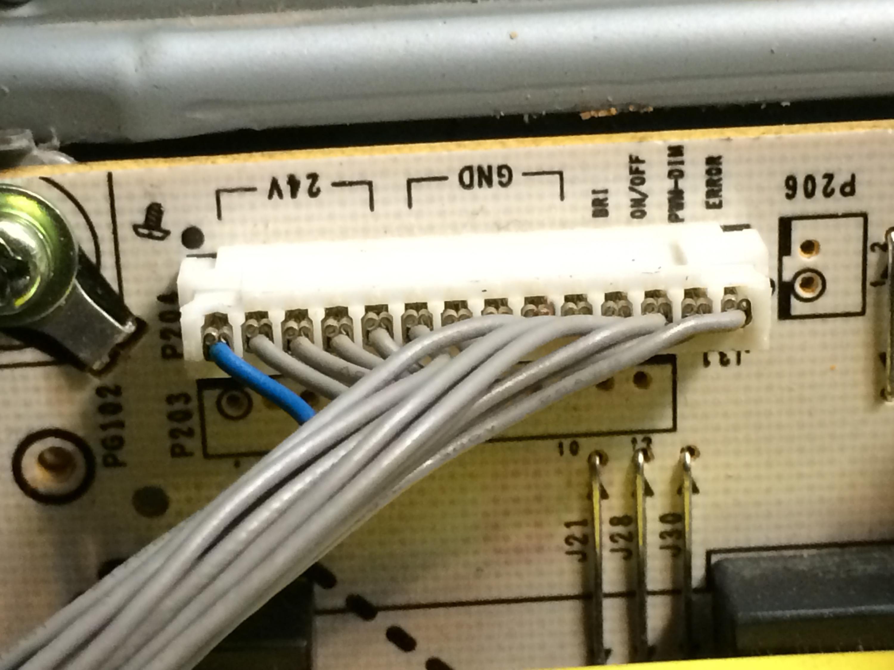

                          What DC Voltage do you get at that ON/OFF (Inverter ON/OFF same as BL_ON) pin? It should be > 2VDC for backlights ON, and <1VDC for backlights OFF.

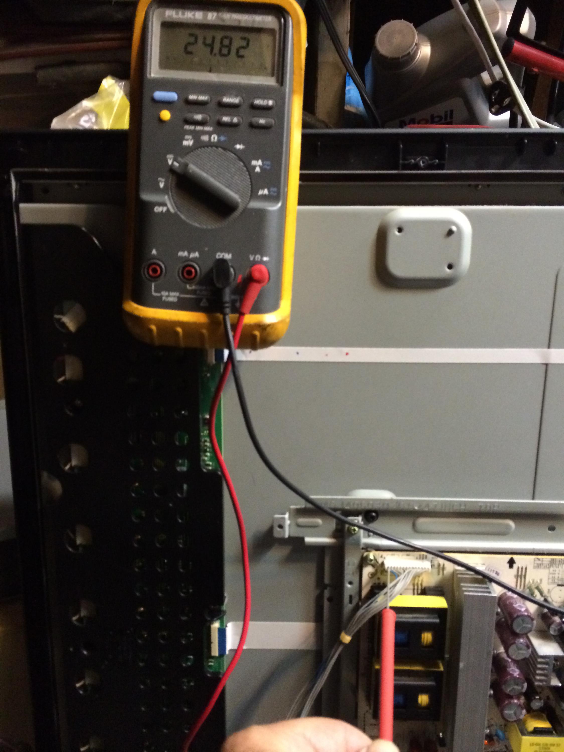

                              Okay, I made some more DMM measurements at lunch.
                              I took these readings from both of the cables that go to each inverter board.
                              BR1 = 1.1V
                              ON/OFF = fluctuates between 1.4V & 2.1V
                              PWM-DIM = Full 5.04V
                              ERROR = 3.2V

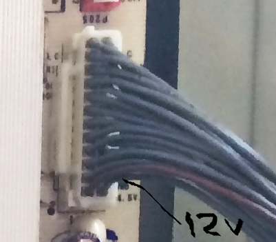

                              I also checked the 12V power again coming from the PSU. I snipped the one lead marked "12V" that goes between the PSU and the main board and attached the auto lamp with the bright filament only. I got a reading of 10.4V. The lamp would pulsate a bit and the reading would vary between 10.1-10.4V. There was voltage coming back up through the same lead from the main board so I must assume that there is possibly more than one lead supplying 12V to the main from the PSU ?
                              This portion of the PSU is supposed to be able to supply 2.25A and it seems pretty paltry in as that it is starting to puke powering a bulb and whatever else is was. Maybe this part of the PSU is weak?
                              Thanx!
                              Bud

                                Originally posted by selldoor View Post
                                So is the 24v on each inverter board - can we have pictures of them?
                                It is also a worry that you say there is NO sound? Have you got a sound source
                                dvd playing or something?
                                I had a DVD player attached to the input in the back of the set with a movie playing and was pressing the "INPUT" buttons slowly and repeatedly in hopes of finding the correct input but to no avail.
                                The attached image is on the connector that runs down to the inverter board.
                                There are four 24V leads and they were all identical readings.
                                Thanx,
                                Bud

                                      Re: Need Some Repair Advice LG 47LG50
                                      Okay, here's an update.
                                      I checked all 20 of the transformers and they all ring out at 1.06K Ohms between legs 1-5 & 4-8. Couldn't see anything awry on either board. Measured the voltages at the headers on the inverter boards and I am getting identical readings as stated before but, here's the kicker. After about 10 minutes of warm up the control voltages change! I then get the following readings:
                                      BR1 = 2.05V
                                      ON/OFF = 3.83V and steady
                                      PWM-DIM = still 5.05V
                                      ERROR = still 3.3V
                                      When I first start it up the voltage at ON/OFF remains near 0V and soon after the CPU is done booting(around 5 sec.)it starts to fluctuate from 1.4-2v thereabouts. The voltage on the ERROR terminal remains at 0V until approx 10sec after boot up and then it locks into 3.3V.
                                      Is it possible that the ON/OFF control voltage is not being input to the inverter within the given timeframe and therefore it gets locked into error mode?
                                      Then, regardless if the correct start voltage is met later on, because it is in Error, it prevents the bulbs from being lit?

                                        Do you have the LCD panel model number? I can look up the spec and it should give info on the T-CON and the Inverter board signals info.
