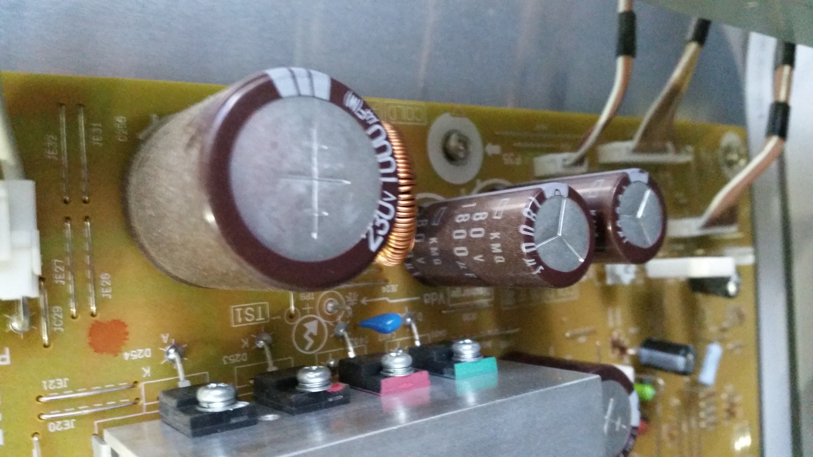

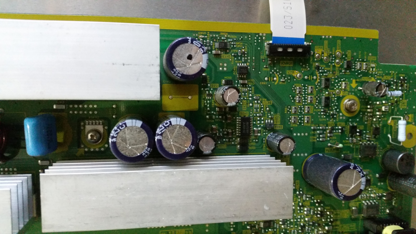

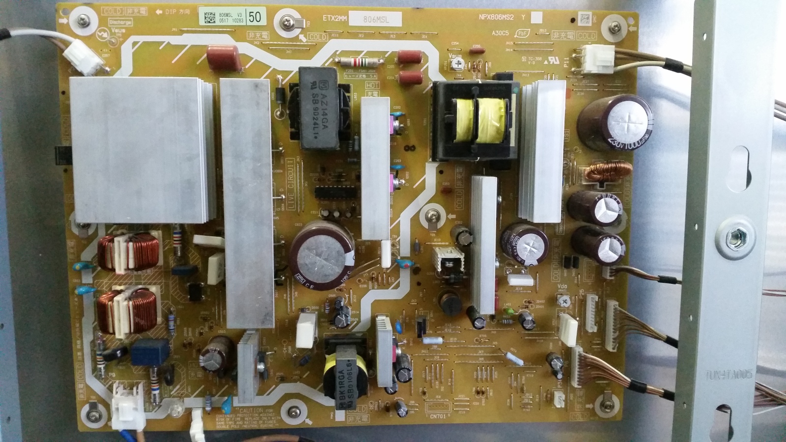

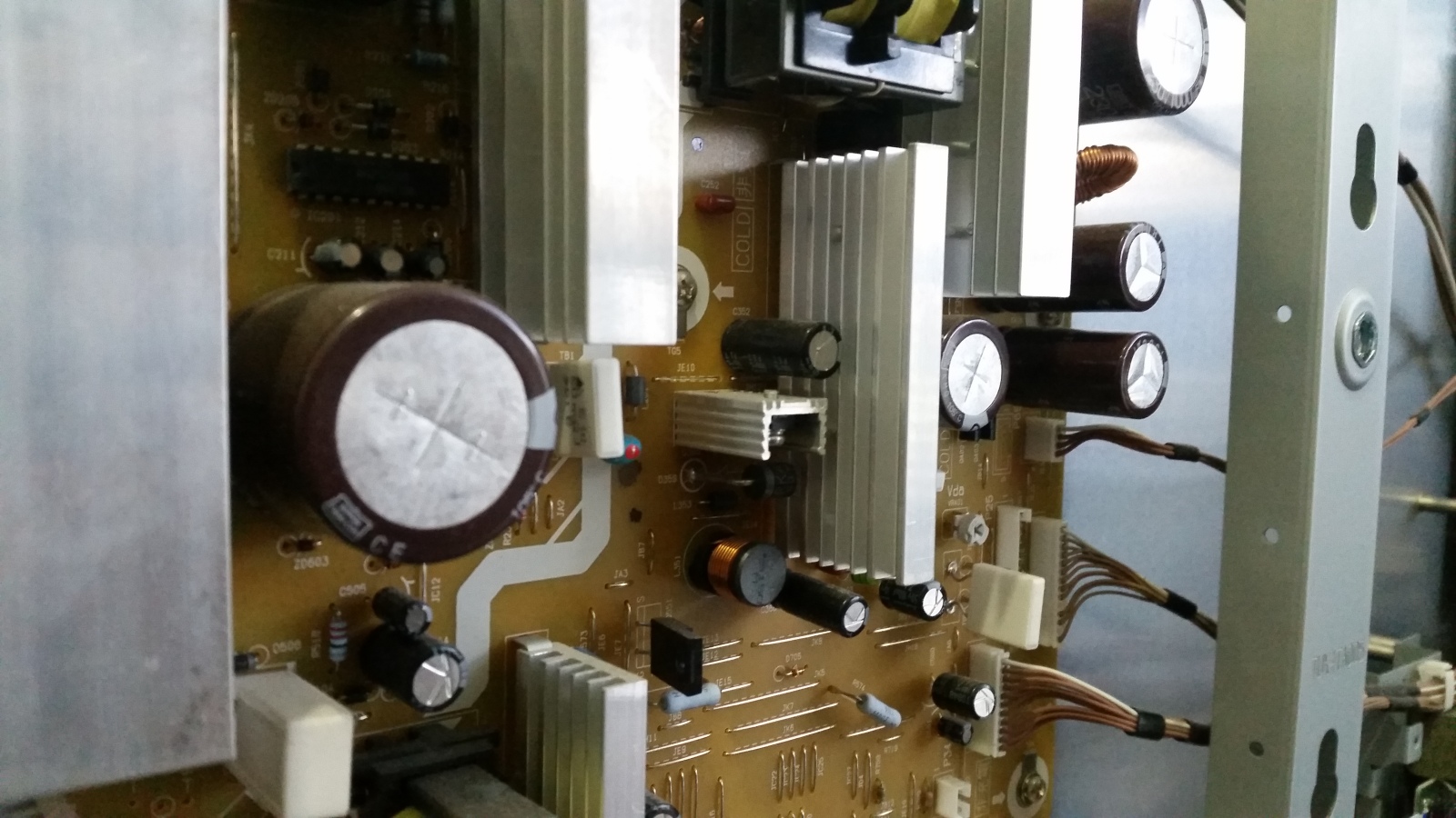

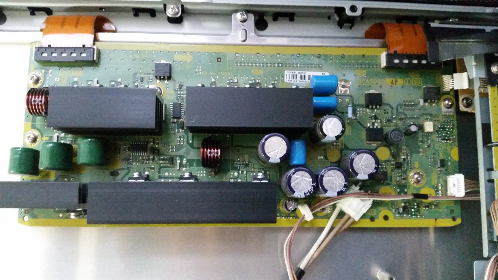

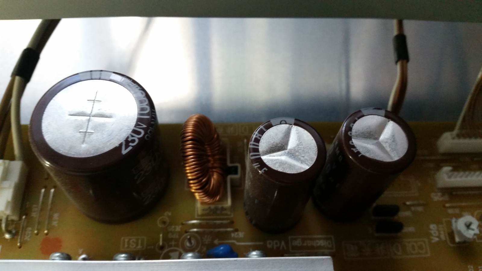

    I picked up this tv for $50 not working.
    When the power button is pressed the led blinks green then i get 7 blinking red.
    I have the service manual and it says check the sc/su boards.
    Does that mean i need a replacement? Or can i replace some components? (caps)
    I have done plenty of soldering etc so thats not an issue.
    I have some pics of the boards.
    Thank you for you help

          Re: Panasonic TH-P50V20A no screen
          It's a Panasonic, likelihood of badcaps is much lower than say majority of other brands as the brands inside there are nichicon or rubycon.
          Any way this series has a common fault of SC boards but since this is 7 blink you may be lucky that it's just the SD/SU boards.
          Here's the test to be sure. Disconnect the 3 white connectors on the buffer boards, they're tight but be gentle you don't want to break them.
          then remove the 4 gnd screws that mount those boards.
          Then on the SC board there is a small 2 pin white connector near bottom left SC50. Those pins need to be jumpered together.
          Then turn the TV on, if it goes green LED no SOS blinks then the SC has passed and you need to then test the buffers.
          Other wise it's a bad SC and you still need to test the buffers.

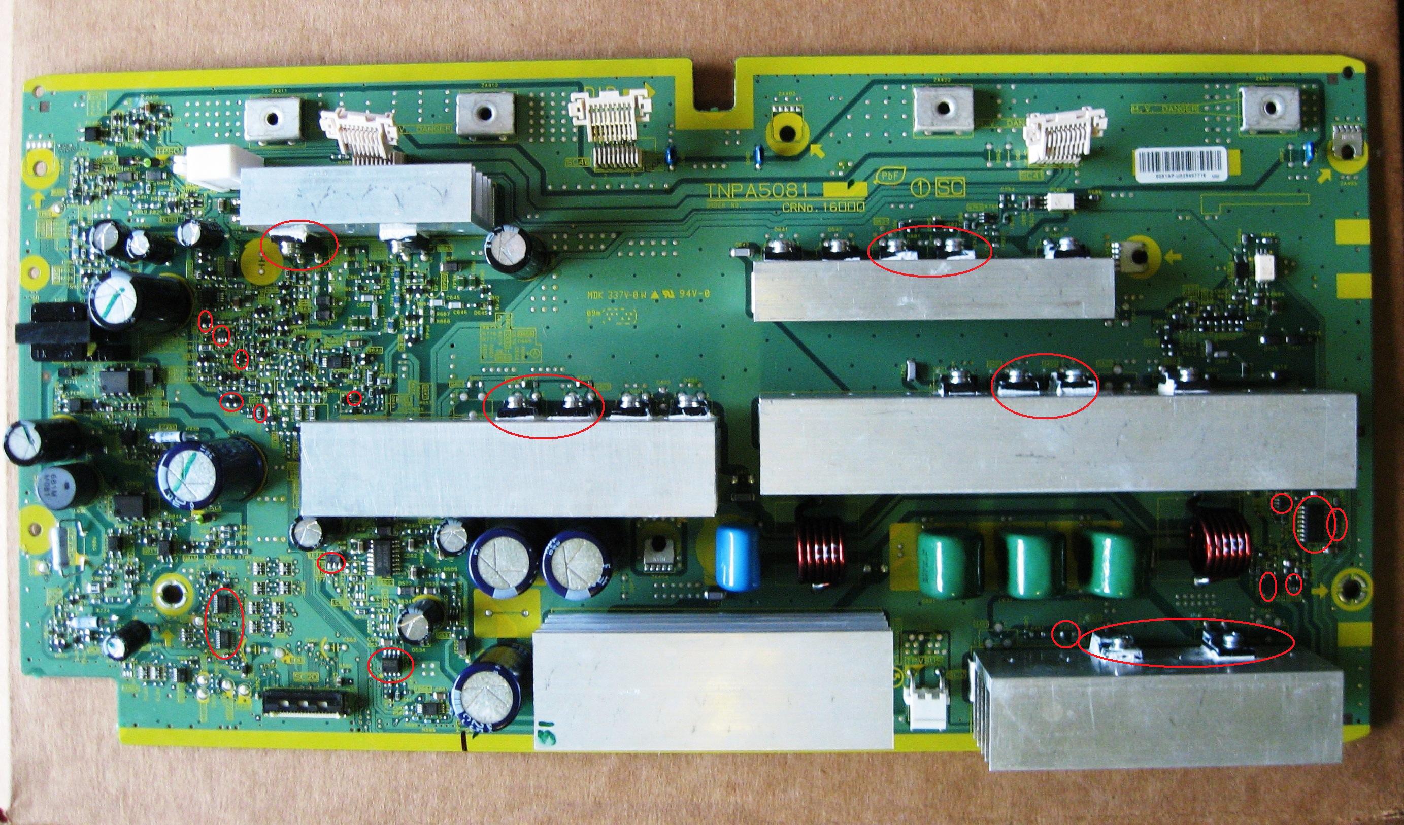

                ok removed 3 white connectors, ground screws and jumpered sc50.
                still have the flashing green then the 7 red blinks.
                • tw2005
                  • Oct 2011
                  • 6458
                  Ok, so look like bad SC. Normally they fail with the SC2 pins going short cct.
                  Here's a guide you can use for this generation. In there you'll find a buffer board resistance test. As a quick check set the meter in continuity or diode test with buzzer/beep and put one probe on one of those gnd plates the bolts go through and then slide the other slowly across all the output connectors where the ribbons go.
                  you don't want to see anything shorted there, also in the table for resistance check for shorts and then also set meter to appropriate resistance range to check those values.
                  post all results and measurements.
                  on the SC check sc2 resistance and all the transistors and see if dead short across any 2 of the 3 pins. Q661 is a common one that shorts and transistors part numbers, DG502,DG402, 30F125 also commonly short.
                  post results.

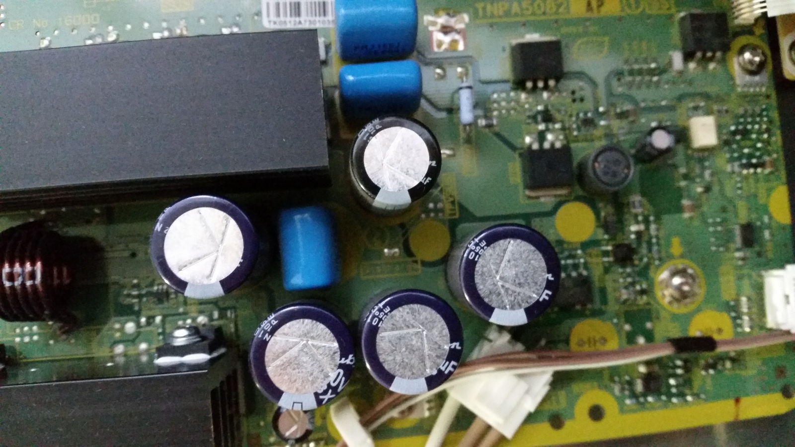

                    ok so ive got the sc card out on the bench now.
                    the sc2 pins are the power coming in? one short one fine, + and -
                    ok not sure if this is correct but getting shorts on
                    q662, q621, q642, q641 all 3 pins
                    D482, Q452 all 3
                    D401, D402 short on 2
                    D462, D422 short on 2
                    Q661 all 3
                    im seeing quite a few shorts where the ribon cable goes (sc20)

                      Ok, so you're using gnd and then testing pins. Not quite what I wanted but there's a couple of obvious ones there
                      Q661 all 3, D482, Q452 all 3
                      These will be ok, diodes with 2 legs being the same ref point
                      This info is confusing, some of these don't exist so I think you have the location numbers wrong.
                      SC2 i just wanted the probes put across them but sounds like not showing short which is why you got 7 blink. When this shorts causes PSU short and 4 blink, can be 10 blink.
                      At least that's a definite yes for SC board failure.
                      see if you can follow that guide for SD/SU resistance, should be able to do it with them installed.

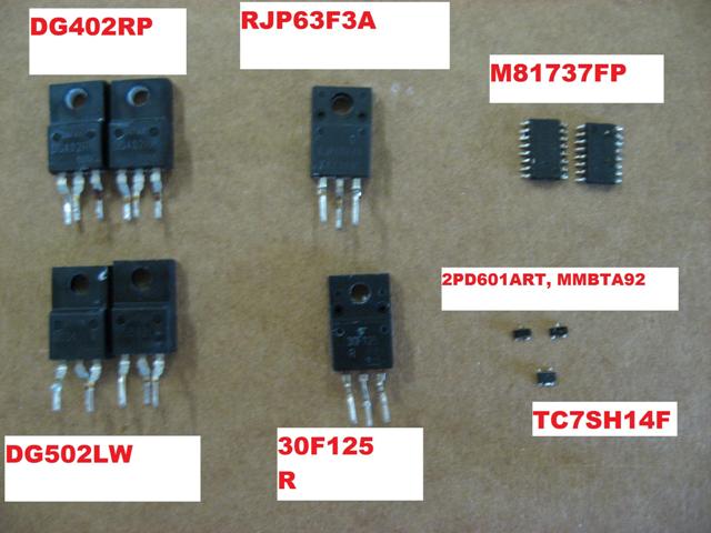

                          example of some of the parts.

                              there are some pretty small components there!
                              would any of them need to be replaced?
                              • tw2005
                                • Oct 2011
                                • 6458
                                Was that tiny ribbon that connects the 2 boards disconnected?
                                Given your meter is not really good enough I'm going to say most likely they're ok.
                                first reading they say 2.2m but from memory I got 1.9m.
                                221k is good and the last is higher than your meter can handle so high resistance, no short which is good.
                                Usually you'll find shorts there if bad. i have to duck out for a bit but SC should get this going providing the panel is not cracked which only you can tell.
                                • tw2005
                                  • Oct 2011
                                  • 6458
                                  yeah, what do you reckon. there's a reason i'm showing you these,
                                      hehe uh oh, the c541 for example.
                                      is that soldered on top of the board or is it plug unplug?
                                      • bradm
                                        • Jul 2014
                                        • 30
                                        they are soldered. ive done quite a bit of soldering but nothing that small. would need a tiny tip and a steady hand
