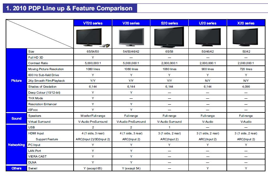

                              Can you confirm what the sticker on the back panel says.
                              I'm afraid V20 is not 3D. VT20 is! I need to know because the boards are different again in the VT 3D model.
                                #35
                                Re: Panasonic TH-P50V20A no screen
                                Oh, if the 5081 board has AF stamped on it, then it's 2D and a V20.
                                If it's AY or maybe AK then that's a 3D board. Buffers boards are also different.

                                      Funny, I did the same thing 2 years ago and got all excited then dug deeper and discovered 2D. Must be the same article.
                                      100% 2D, article is wrong.
                                      It's only worth $25 now,
                                        #39
                                        Here's the range, only VT is FHD 3D
