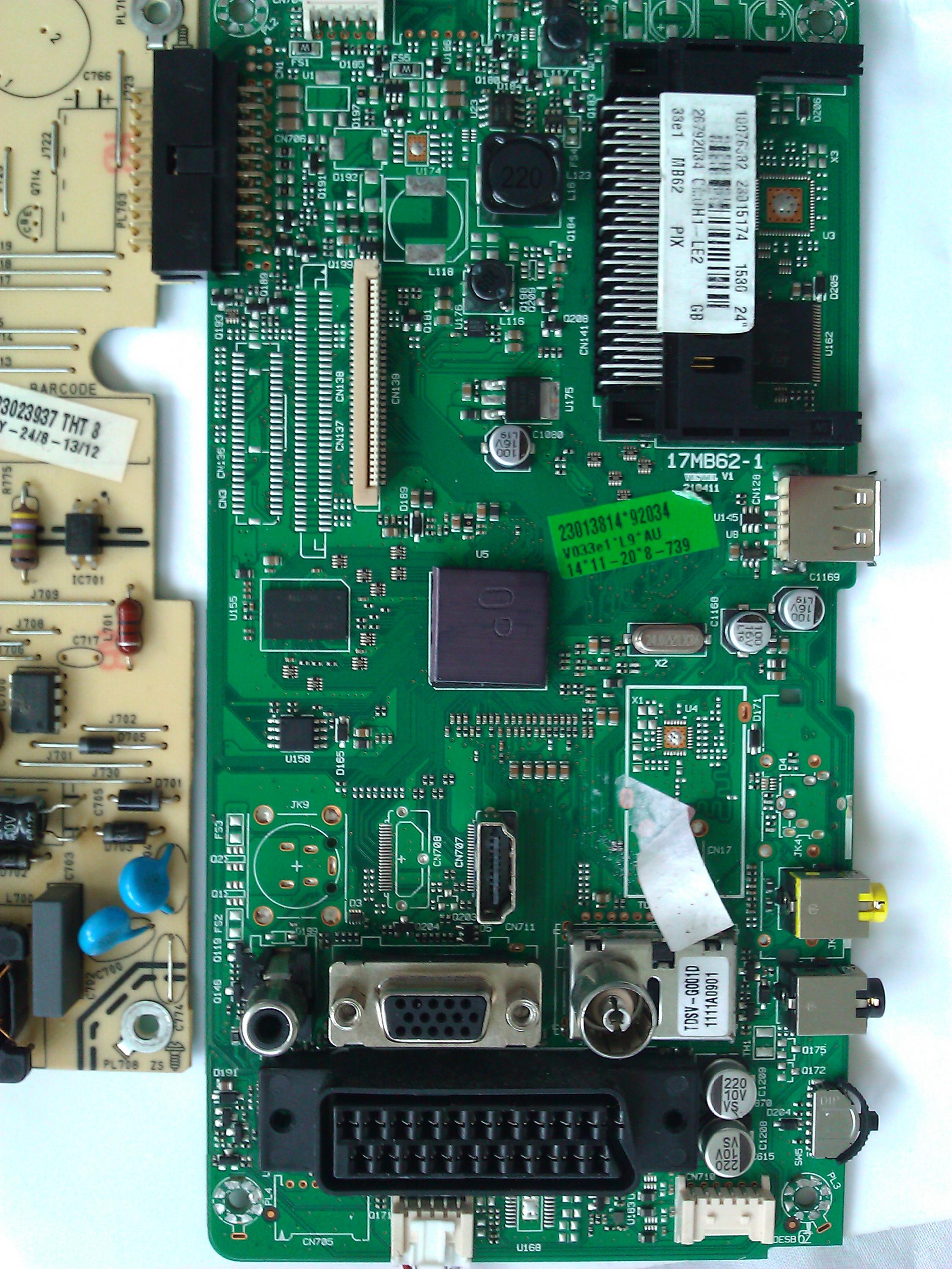

    Hi, I've bought this tv to repair and hoping for a little help. When I bought the tv the owner said it just goes into standby. When I got home and tried turning it on I got the flashing light no pattern just flashes steadily.
    The owner as now told me they had it looked at and said they was told it needs a new mainboard (vestel_17mb62-1)...
    Anyways I checked tp202 on the mainboard and it is reading 0v and from the manual it seems it should be reading 3.3v to be good. I have checked the voltages going into to mainboard from CN1 and they read as follows
    Pins 1 to 8 read 0v
    9. 4.88-4.92 was fluctuating
    10. 11.25
    11. 0.69v
    12. 0.69
    13. 11.25v
    14. 11.25
    15. 3.4v
    16. 0.69
    17. 3.4v
    18. 0.69
    19. 3.4v
    20. 0.69
    Test was done with mainboard attached. I also probed U175 (UTC ld1117al) adjustable voltage reg see attached pic, the first pin furthest away from the cap that sits next to reg reads 0v as does the second and the third reads 0.69v??
    What should my next step be?
    Thanks in advance

    Next step is to get some better pictures - more light required but not flash then we can see what your talking about.
      Re: bush led24970dvdfhd (vestel_17mb62-1) flashing red led
      Put some better pics up. Thanks

                  Just had a look at the v.reg and the pin that measured 0.69v is Vin...So I presume the problem is before the reg?
                  Just checked pin to pin ohms to ground on the reg. Pin1 (ground). 0.97ohms Pin2 (Vout) 197ohms Pin3 Vin 506ohms?
                    Well the V.reg seems to be ok. I'm thinking about buying a replacement board but before I do, does anyone know if I can use a 17MB62-1 v2 in place of my 17MB62-1 v1?
                    The boards look identical. Thanks

                                  I have been looking again at U175 - If I read the schematic right which is unlikely
                                  the pin nearest the C1080 is the 5v Vin and the black component is F303 ???60R???
                                  Is that a fuse? then or a Ferrite bead?? or fusible resistor??? either way it may be worth checking it. Maybe also check the voltage on that C1080

                                      I checked the voltage on the cap and reads 0.69. I have also tried removing the cap and the pad reads the same.

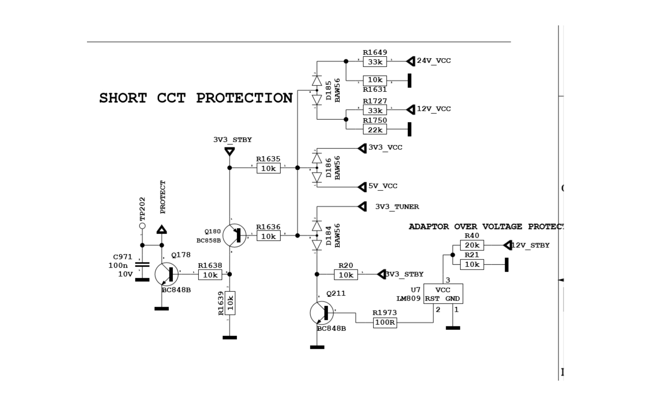

                                        Does anyone know how I could disable the short circuit protection on this board?
