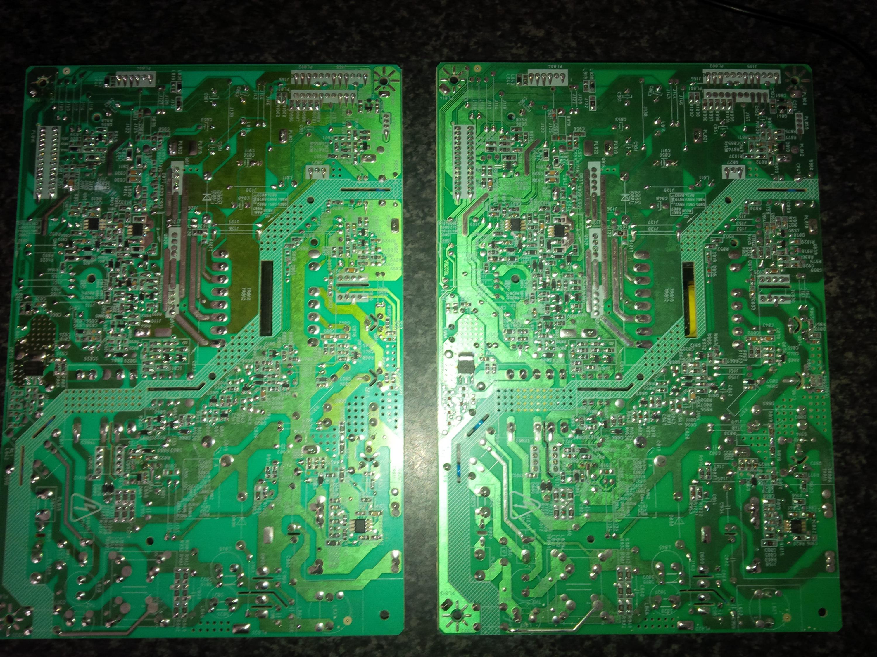

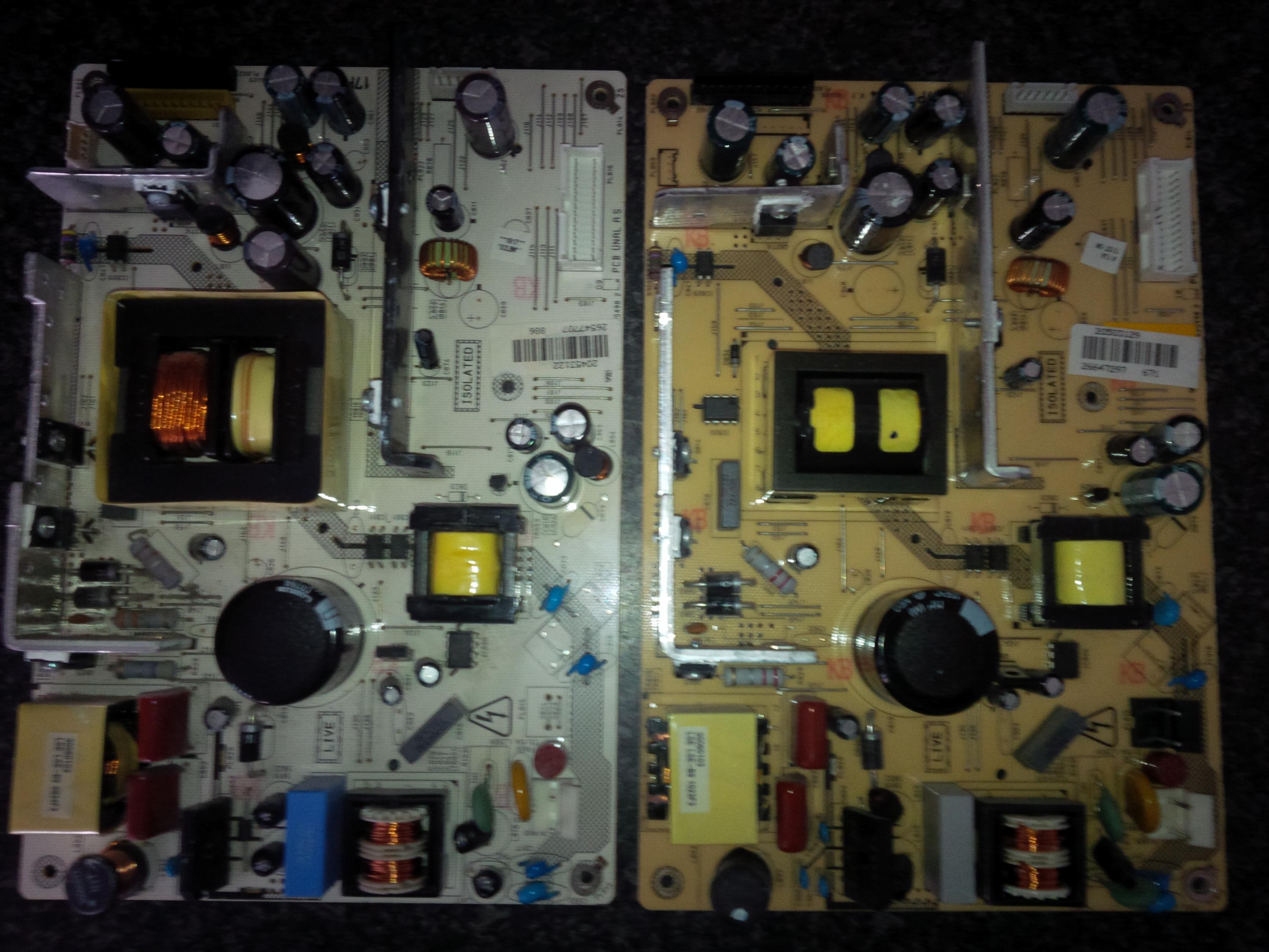

      Re: Sanyo CE42FD90-B new PSU Board Confusion
      Can you supply a picture of the top and bottom of your old and new power board. In your case I think one of the connectors needs to be jumpered for it to work but that is all. Most 17PW26-4s are interchangeable.
        Hi - This will be a Vestel board and they rarely seem to produce 2 boards alike
        even when they have the same part number.
        We will need good clear pictures of both sides of the 2 boards.
        If you do not to do any soldering/unsoldering it is probable that we cannot help you. - If you search that board number you will see that there are repair kits readily available which is an indication that the often break down.

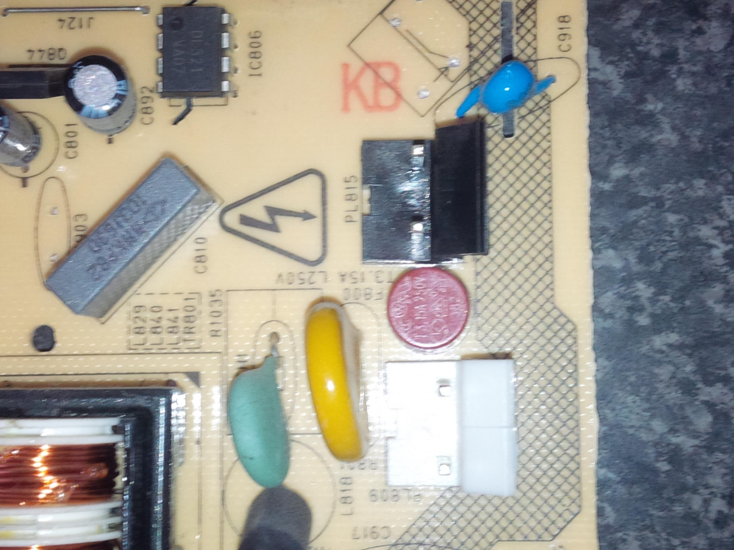

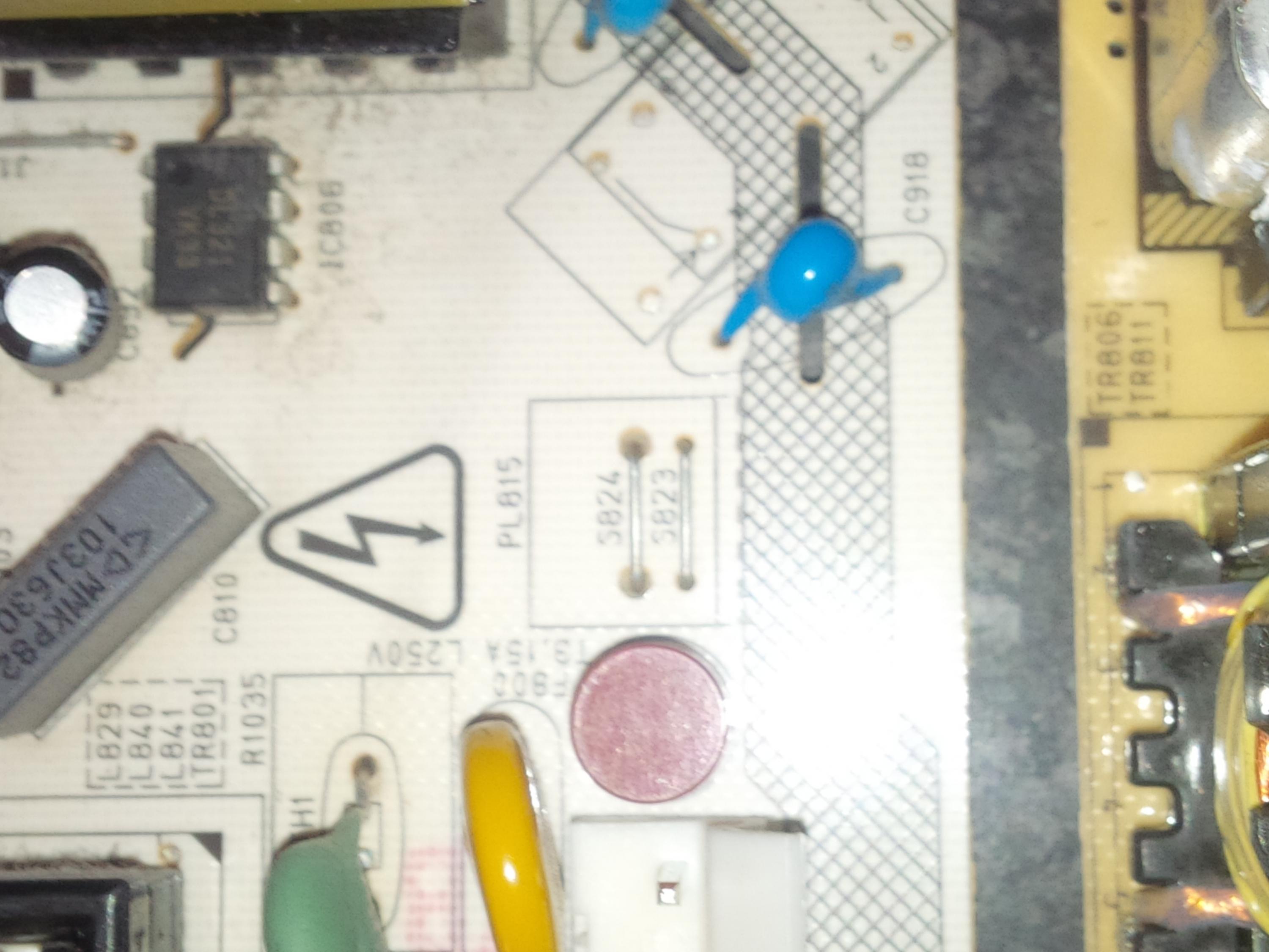

          Thanks for the response
          I have attached pictures, the new board is the yellow coloured one, as you can see from the pictures the new board has a second black power socket (PL815).
          Does PL815 have to be jumpered in order for the board to work?
          if so, can it be done without soldering or by another means.
          the boards seem identical besides this extra PL815 2 pin socket.
          Thanks again
          Neil
            You do need to solder. The connector pins of PL815 need to be joined together. I suppose it would be possible without soldering but I would be cautious with something like wire wrap. It could overheat and start a fire (unlikely but it's still mains voltage so it's good to be cautious)
            • immolation
              • Jul 2014
              • 7
              Thanks tom66
              So if i just solder a piece of wire across the two pins on the black plug, it will work fine?
              Thanks Again
              Neil
                Yes. You should put it on the bottom of the board though.
                • immolation
                  • Jul 2014
                  • 7
                  Thanks Tom66
                  Worked a treat
                  Neil
