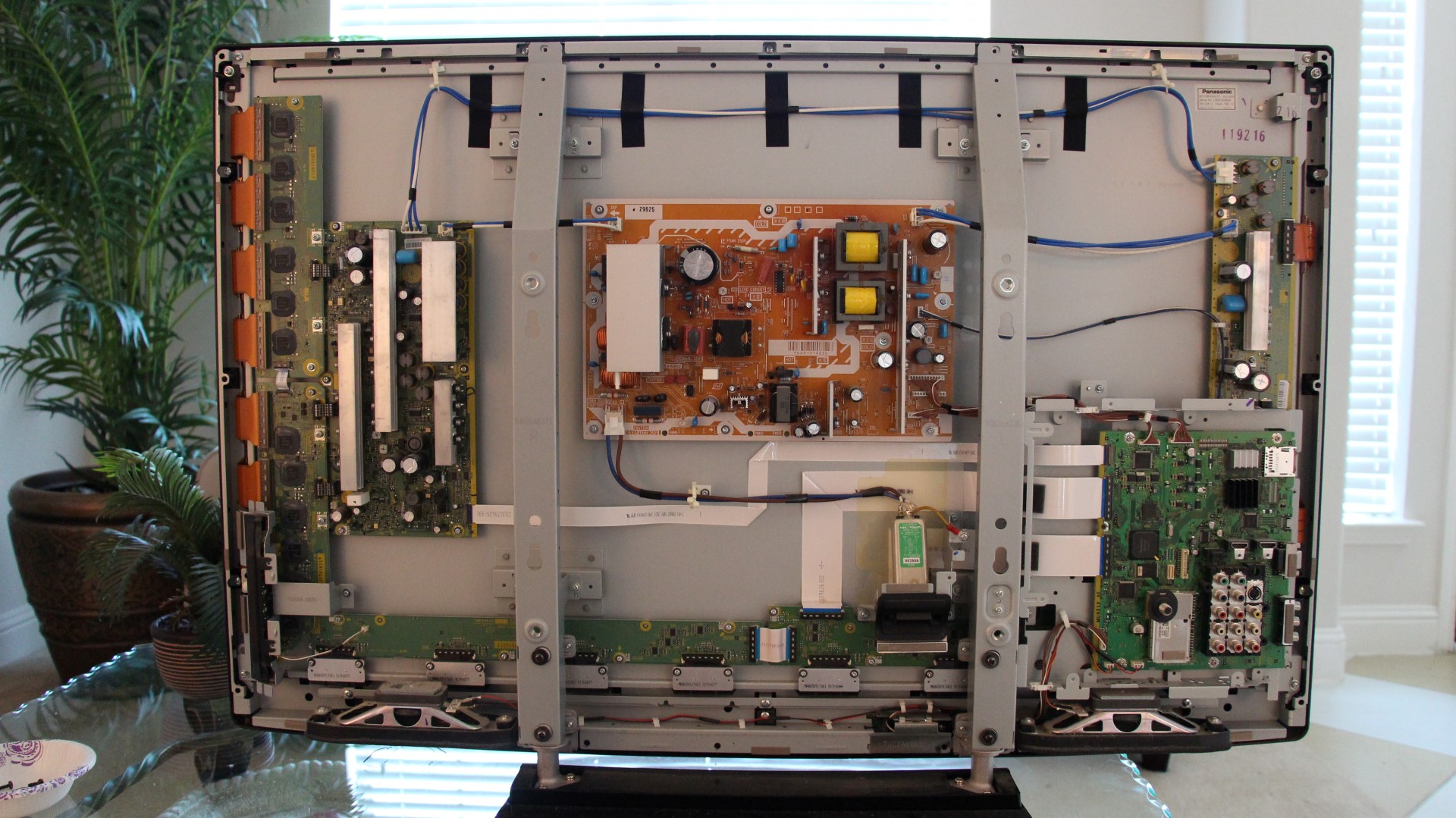

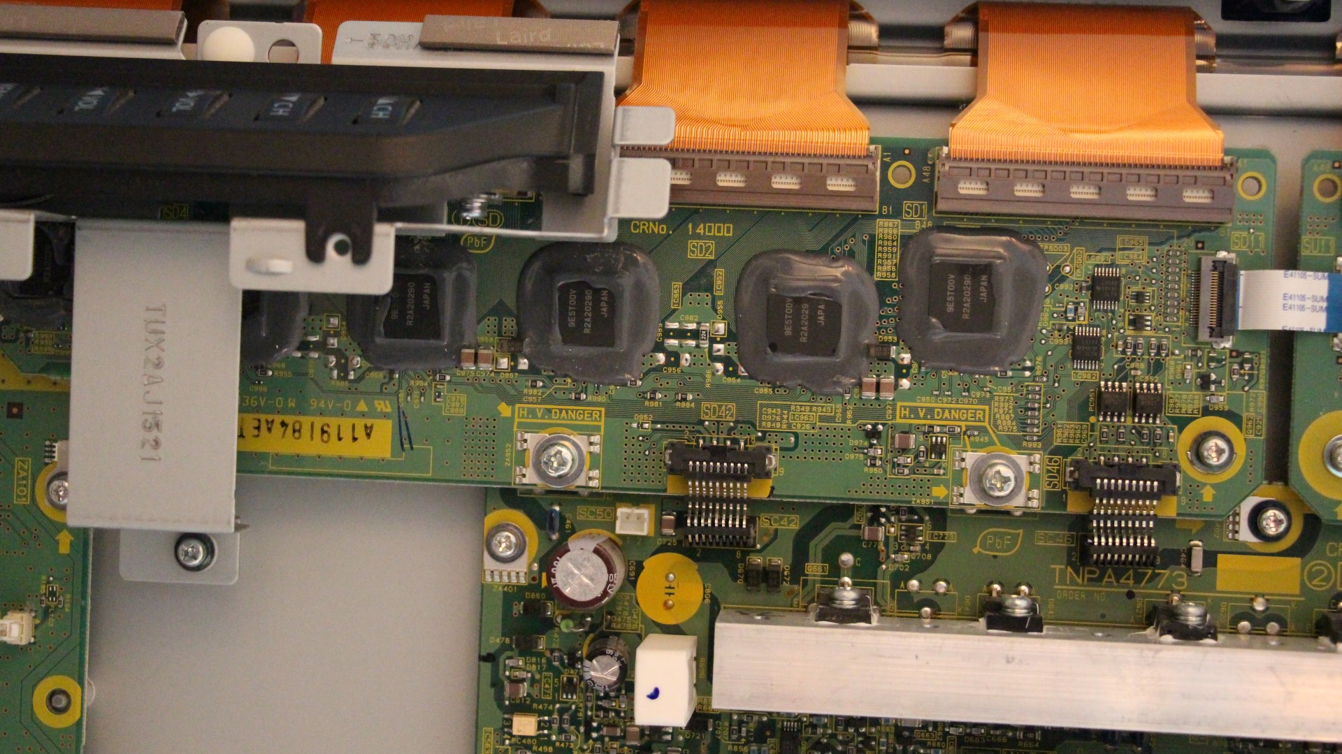

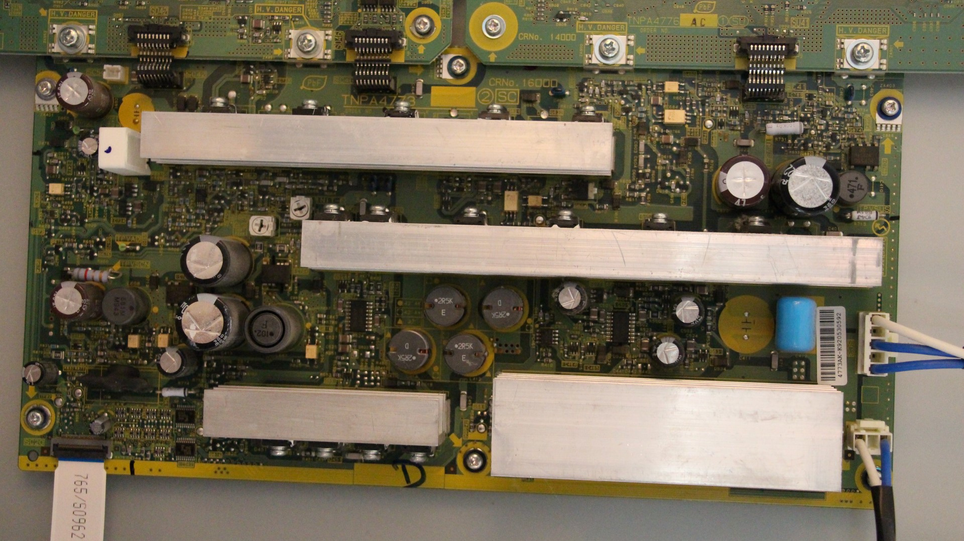

    I have two of these 2009 Panasonic plasmas - a 50" and a 42". The 50 inch is great, but the 42" now gives the 10 blink sos code. The service manual claims this to be a fault in the A board, but I think otherwise. When I plug in the TV, it's silent and I get the 5v standby. When I hit the power button, I get 2 quick clicks and a 3rd no more than a second later. If I unplug power going to the SC board, it changes to an SOS7 and the 3rd click takes about 5 seconds instead of nearly immediately.

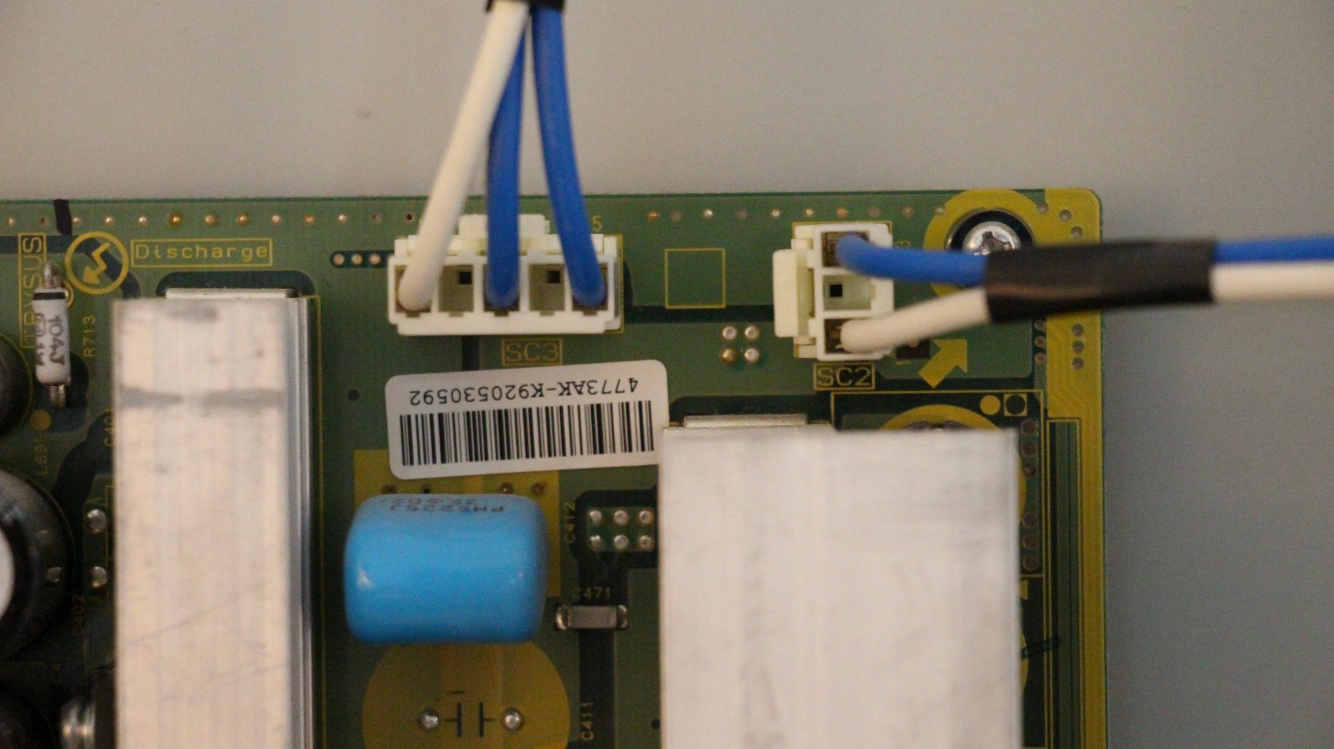

    Connector SC2 on the SC board shows the Vsus and ground to be shorted together. I isolated the buffers from the board, and it's still shorted (see pic). Testing one voltage at a time due to the short window, I see the following:

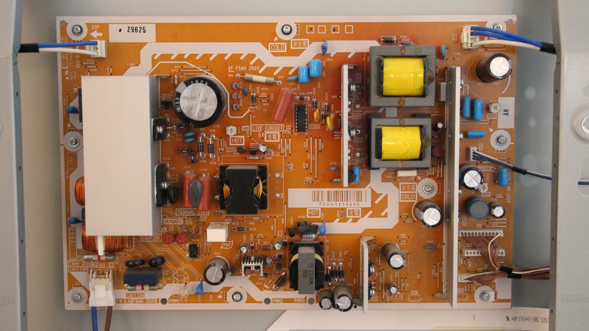

    On the power board
    Connector P6 - 15vs is good
    Connector P7 - stby5v is good
    Connector P25 - stby5v, 5vc, 15vc are good
    Connector P2 - Vsus is good (shows 191v and panel sticker shows 192v)
    Connector P11 - 15v is good
    So I'm thinking it's the shorted SC, not the A board. Thoughts and other input?

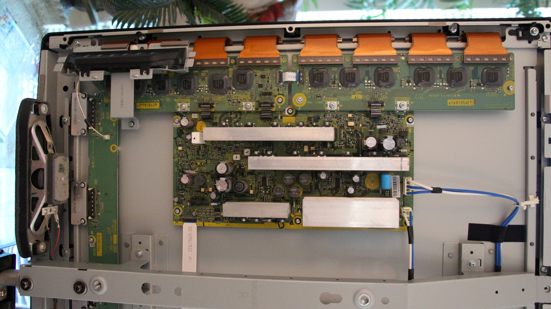

    I'd go SC board. The fact it drops the 10 blink after it's disconnetced. besides, you know the Sc is bad and needs replacing so you might as well replace it.
    If you disconnected SC2 SC20, SS11, P35 and the 3 white ribbons at the A board the set should turn on and hopefully no blinks which would prove the A board.
    Just make sure there's no residual power on any of the power cables before you hook them back up so nothing gets spiked especially P35.

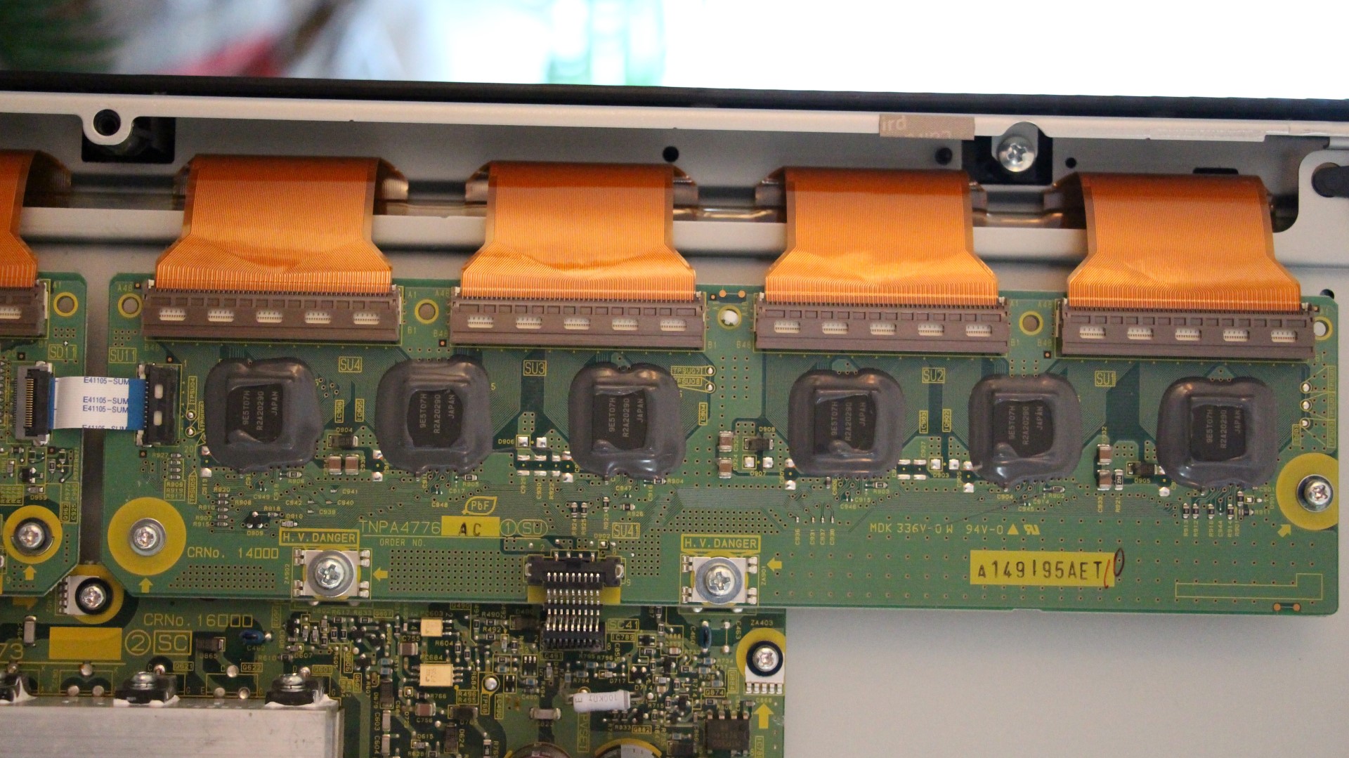

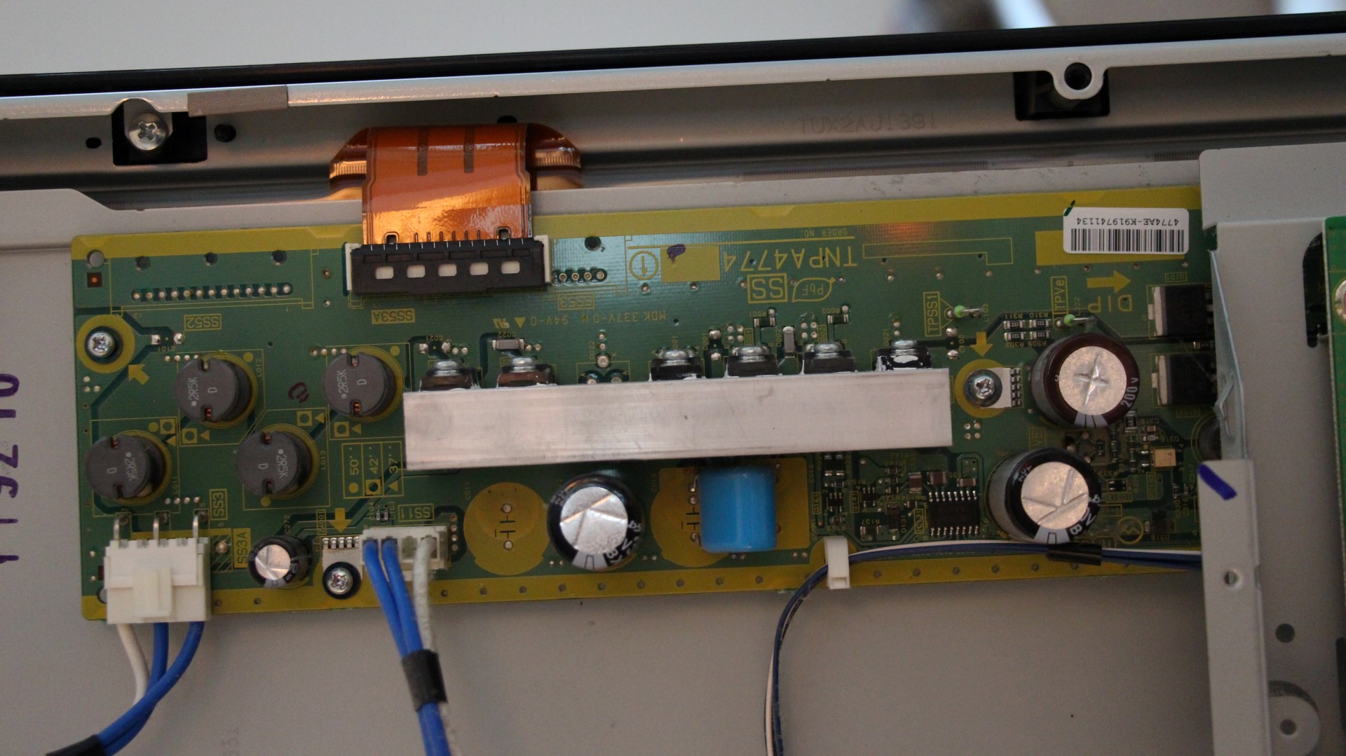

      Yep, I'm going to grab the buffers, too. Is there a good way to test the A board without actually replacing, considering the rarity and price of it?

        I don't think its a buffer SU/SD based on what I went through on my Panasonic. I used this guide to troubleshoot mine: http://tvrepairtips.org/files/tip/29..._pdf_11669.pdf
        I found like you the SC to be shorted and 4 31F131 blown.

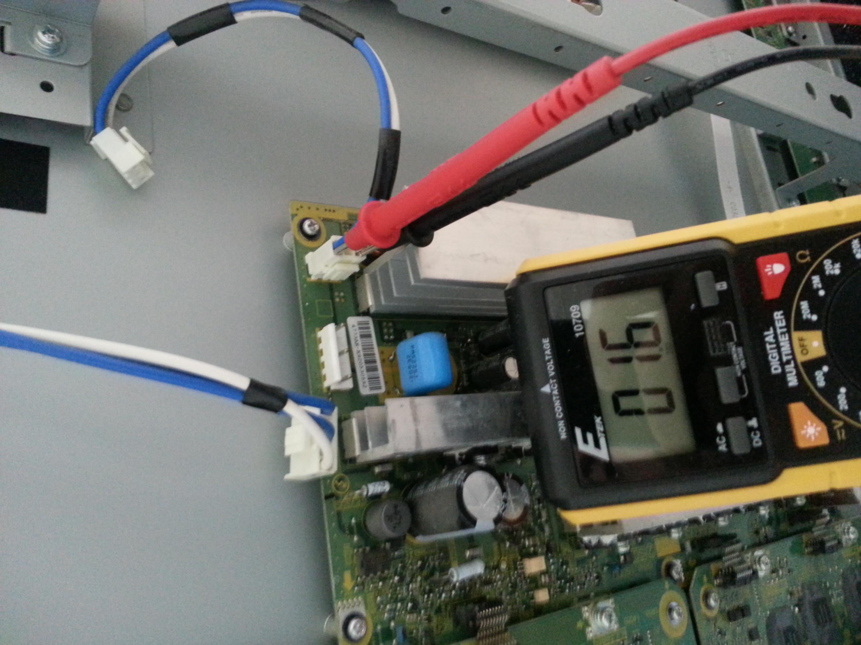

            I'm a new user to this forum and have found some very helpful information. Thank you.
            I have a Panasonic 3D Plasma TC-P54VT25 which is throwing the 10 blink code at power on. I do not have the 10 blink code when power is connected to the set.
            I found a manual on another posting and ran the diagnostics. I found that I have a short to ground on P11 pins 1 and 4. Manual indicated this is a VSUS and P15V issue. Vda checked out good.
            I ran the diagnostics for the VSUS and determined that the SC board is suspect.
            I ran the diagnostics for the P15V and found a short on Pin 1 of connector P6. Which makes the P board suspect also. I noticed that the SC board is also part of the P15V troubleshooting but because Pin 1 of connector P6 is shorted the troubleshooting ends at the P board.
            I imagine I could have two bad boards, SC and P. Is that common or likely? If I replace the SC board only to start with is there risk in damaging SC board due to a bad P board?

                I have not read a lot of VT series with this fault but certainly the V or G20/25 series have an issue with the SC board failing and shorting. can produce 10 blink. TNPA5081 sc board, quite often SC2 will be shorted also. would be better to start a separate thread for your fault.
                I would disconnect SS11 and Sc2, SC20. recheck Vsus at p11, p2, and your 15v again and see if still shorted. Then check Sc2 see if shorted and also SS11 vsus for short. I'm thinking SC will be the cause. you will also have to check the SD/SU for shorts before you replace the SC as they can fail too at the same time. generally they survive but not always but if they are short then they can/will blow the Sc again.

                  You can test the buffer board, like so:
                  https://www.youtube.com/watch?v=51SZsfH60EY

                      So I pulled the cables you listed, tw2005, and the TV is up and running and I can hear the audio via HDMI 1. No video, obviously, but I think that pretty much confirms the fault. Again, thanks!

                          New SC board was delivered today, and the TV is now up and running. Moral of the story - don't always believe the service manual! A $19 SC board versus the $100+ mainboard (according to the manual's definition of a 10 blink SOS).
