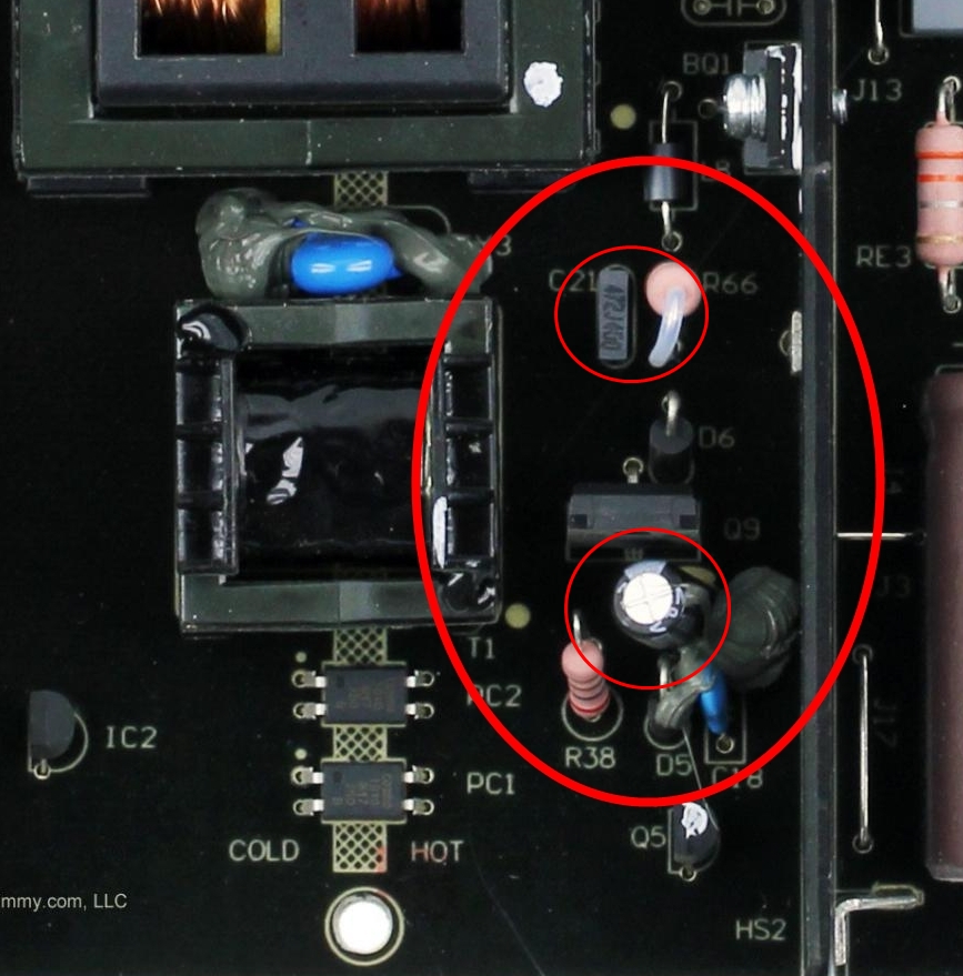

        We need to check the DC voltages right at the two legs of those two start up caps in red circle in that 5VSB section, you must be real careful because you are working in the primary deadly side of the circuits so do not touch any thing with your hands or body.
        After that we may have to check the capacitance and the ESR of those two caps or just replaced them since they will need to be replaced sooner or later any away, actually the set of caps should be replaced.
        You should get the digital meter before going further, but I will wait and see what you can read with your meter.

          OK, Im assuming I pull he board and place on none metallic surface and ground the screw hole closest to the ac. leaving the low voltage wires disconnected. And test ec3, c21 from the back side?.
            Re: Element ELGFT401
            The power supply board can be tested by itself without having another boards connected to it, so yes once you locate the two legs of those two caps, you will be measuring the dc Voltage DIRECTLY AT THE TWO LEGS OF EACH CAPS I mention with bottom side of the board facing you (yes, do put the board on card board or insulator sheet). Notes: You WILL not be using the the chassis as the ground ref. point for DC voltage testing in the primary side of the circuit.

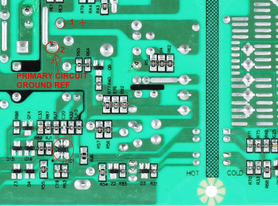

                  OK we need to find out if are gettin B+ feeding the 5STBY circuit. Check the DC Voltage between point 1 (red probe) and point 2 (black probe), it should show around 160~170VDC.
                  I also need the P/N of that IC in red circle.
                    #29
                    Yes there was 160-170 and the part number was ( I think) 62939.
                      #30
                      OK, so the stby is getting the B+ feeding it OK all the way to the SMPS transformer but the MOSFET that drives the transformer is not switching.
                      Please check the resistance of the Source SMD resistor R92, it should show very low Ohms.
                      So far I cannot find any info of that IC.
                        #31
