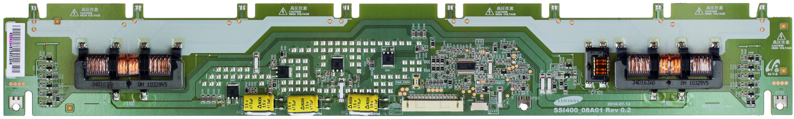

I had posted earlier that my power supply was dead. Repaired that with new 2561a chips. Now I have an issue with the inverter I believe. I get my 24v coming in from the power supply and into the gates but nothing out. There is 4 diodes that are reading shorted. I haven't removed them to see if if they are only shorted in circuit. They are stamped UH. The inverter is an Samsung LJ97-03241A (SSI400_08A01) backlight inverter. I saw another post Budm was working on one. I get audio and no video. Not even a blink of light or voltage at the coils on power up. The diodes shorted in question are D101, D102, D201, and D202. If someone has one of these inverters, could they meter theirs to see if there's is shorted? I hate pulling out those smd diodes. Oh and I am getting around 600 ohms across the coils.

Those diodes are for the MOSFET Gate discharge, the diode is connected in parallel with low Ohm resistor. I.E. D101 is connected in parallel with R101 which are connected to the Gate of Q101.
So did you see the backlights even flash once?
What DC voltage do you get at pin 12 ENA (BACKLIGHTS ENABLE) when TV is OFF and when Power ON?

Power on
Pins 1-5 = 24v
Pins 6-10 = GND
Pin 11 = 0v
Pin 12 = 1.32v
Pin 13 = 0v
Pin 14 = 1.59v
Power off
Pin 1-14 minus 12 = 0v
Pin 12 = .9v for a bit. Now all 0.
Any of them look off?Comment

They look OK, the ENA is on the low side but probably enough, but we can try using 3Vdc from batteries to see if it will work, but you will have to disconnect that ENA wire from the connector so the 3V will feed back to the main board. But did you see lamps flashes for seconds?Never stop learning

Is there a cable connected to connector CN102?Never stop learning

Hmm, I am running out of idea, we need to get the P/N of that PWM IC U1 (20-PIN) to get the pin out so we can check the voltage on the pins.Never stop learning

Yes I tested the fuse and the 4 fet's. There is no shorts in them but it's not passing voltage through to the coils (that's what led me to believe that those 4 diodes could be faulty). Maybe that ic is bad. It's a cheap enough to do a test.Comment

Wasn't the inverter. Should have noticed that when I hit the power button the 3v pins are ok for 2 seconds then it goes to 1.5v. I would assume it's the power supply now but I metered everything and couldn't find a fault.Comment
Re: LC401EM3F Emerson Inverter Issue
So you still have 24V, then I would use external 3V (2 AA batteries) to feed the inverter on if the new inverter is good then the backlights should come on, you will have to make sure the wire connected the inverter on pin which goes back to the main board is disconnected.Never stop learning
