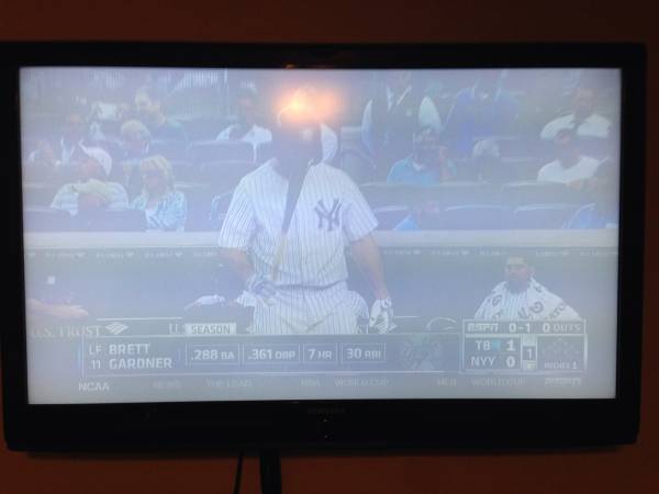

    Samsung LN45A500T1F image very white
    Found this TV on CL and I try to figure out if it's the panel or bad T-Con board?
    What do you think?

    Re: Samsung LN45A500T1F image very white
    Searched for this tv for you to see if it has the FAMOUS gamma chip on the Tcon but cant pull it up,model number is correct?
      my guess its a 46 in
      https://www.badcaps.net/forum/showthread.php?t=36458
        Yep. 46". And almost certainly the T-con in my opinion. I've fixed several with exactly the same symptom.
