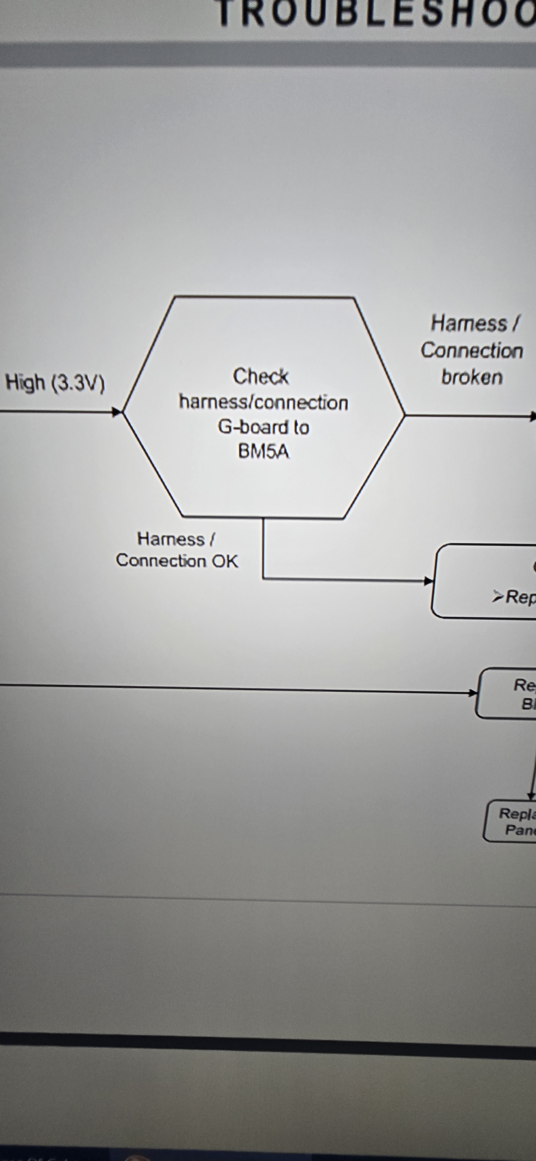

          Well its back to not turning on and giving the 6 blinks, but when it was on yesterday, I didnt notice anything weird on the screen, it was a nice perfect picture during the set up process and even when it went thru the sony set up and showed vibrant pictures.

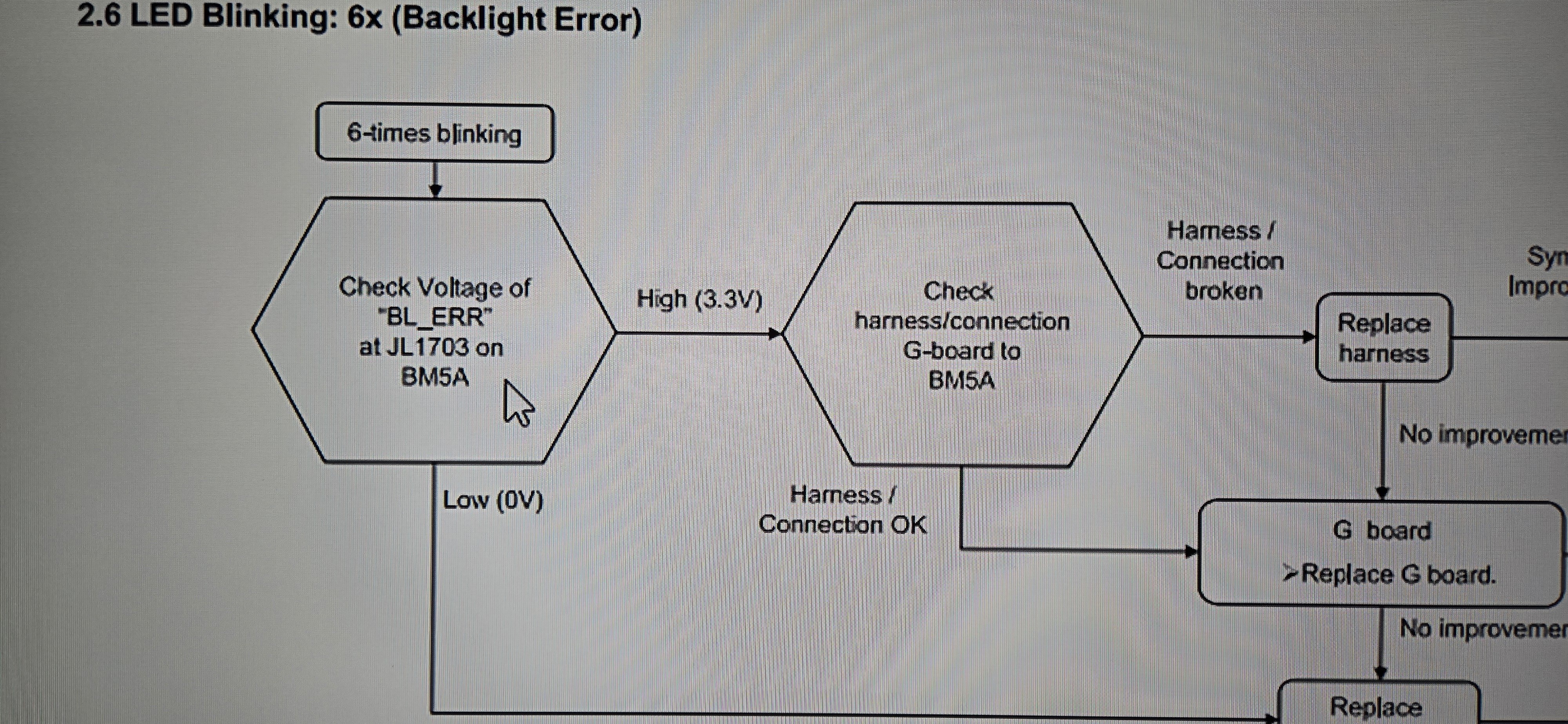

          I did happen to find the service manual for this model tv and a few others. It gives pretty good info about test points and shows with diagrams exactly where to be testing. I know my bubble has burst Ill keep my fingers crossed it turns out to be a faulty PB and do the tests tonight.
          Would you know what is meant by G board ( see photo )?

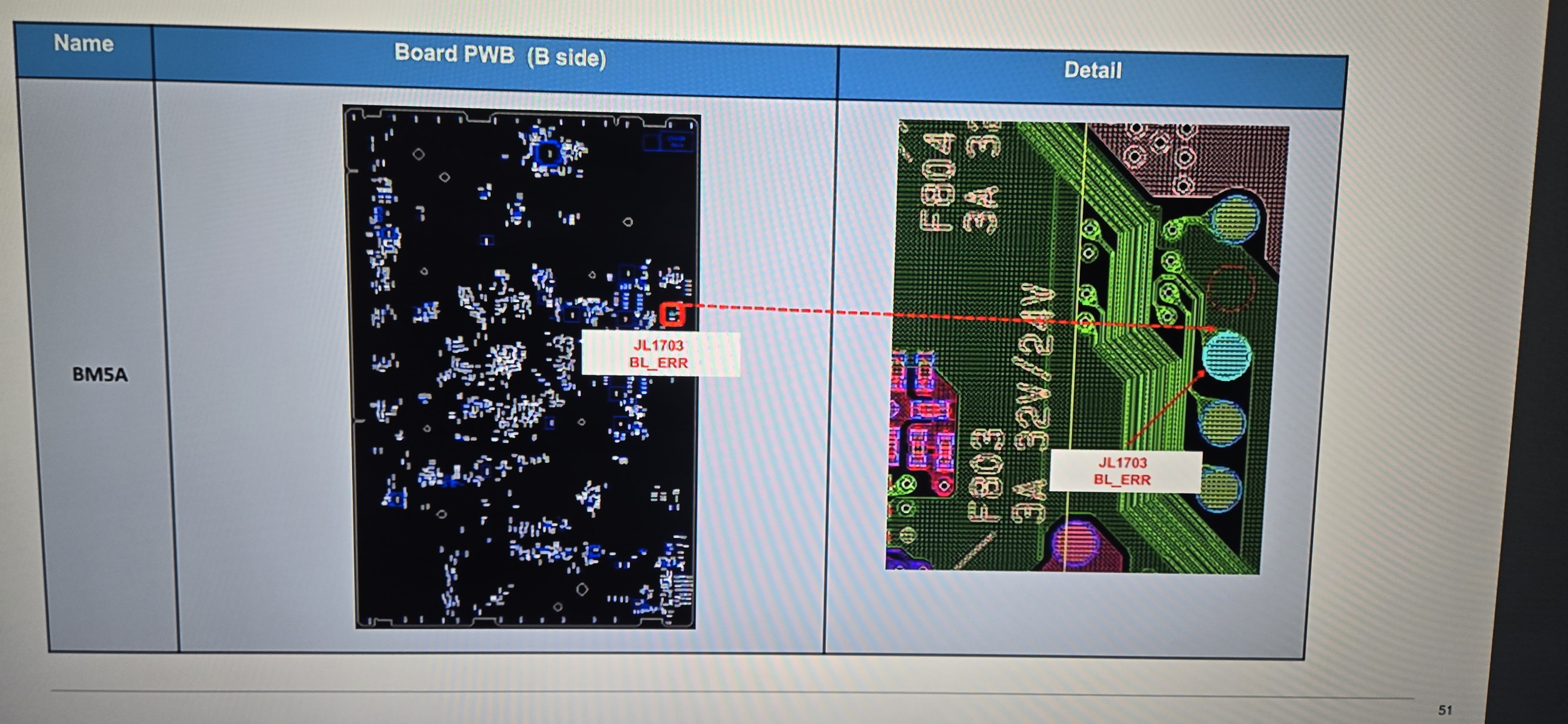

                  Got a question.. In the first photo, you can see its telling me to test for voltage at JL1703 on BM5A, ok no problem right? Well in the second photo, it shows location of JL1703.. Its on the underside of the MB, how am I to get a probe on it? I was always told to never test boards with full power unless they are screwed down in place. Is that wrong? Can I remove the MB and put clamps on it to ground it from board to frame?
                  • lotas
                    • Jan 2016
                    • 4859
                    • Russia
                    #29
                    Doesn't this contact go to the connector?
                    • NolesFan
                      trying to learn
                      • Jul 2024
                      • 94
                      #30
                      Lotas, sorry, Im new to this. When you asked the above question, do you mean does the br_err go to the point on the MB that im testing?

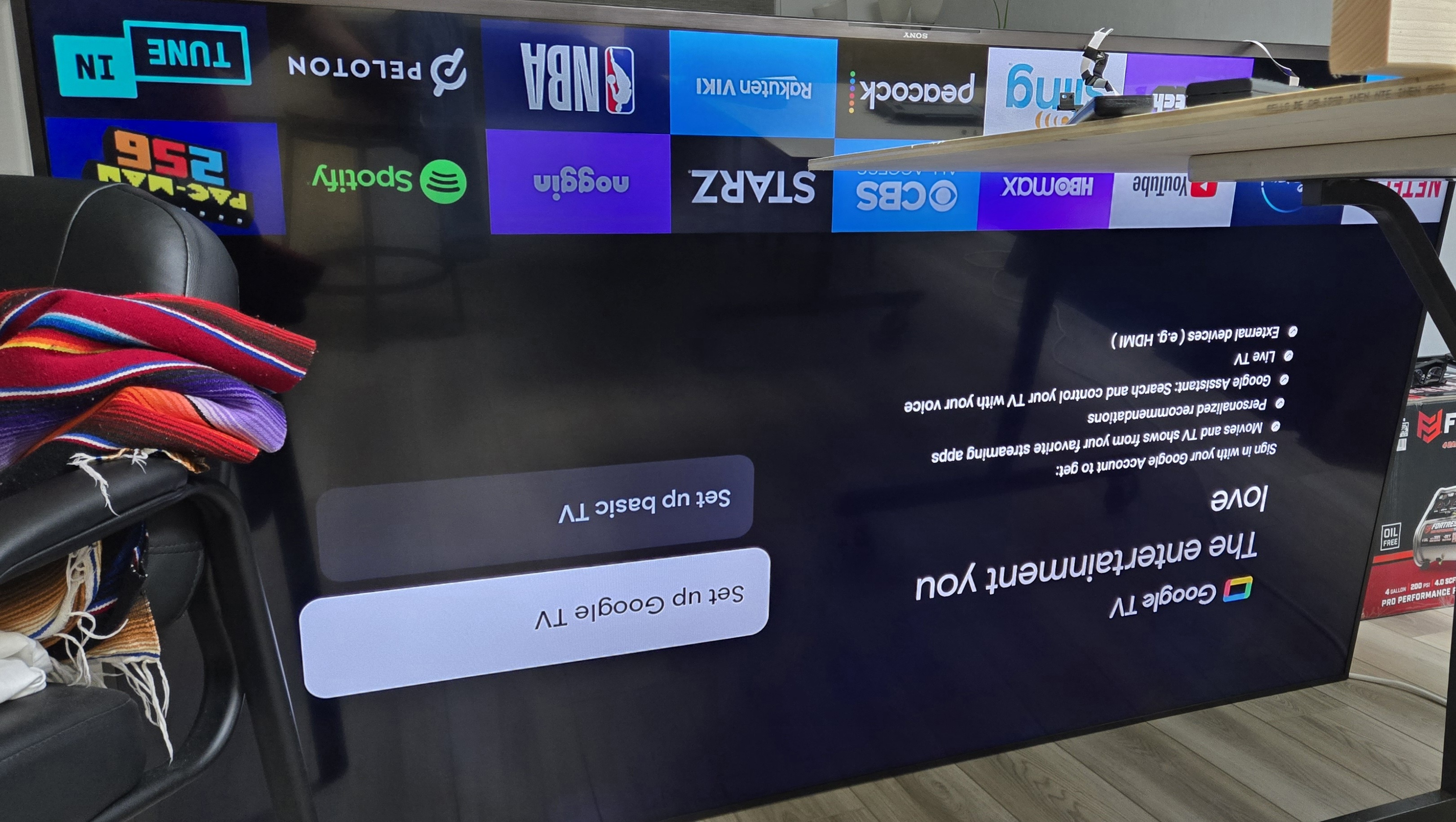

                          Ok, so I went and walked the dog leaving the powerstrip off. Flipped it on, and I was able to recreate the same 3.44 at standby for 2:20 and then it would shut off. I dont know if this means anything, just info.

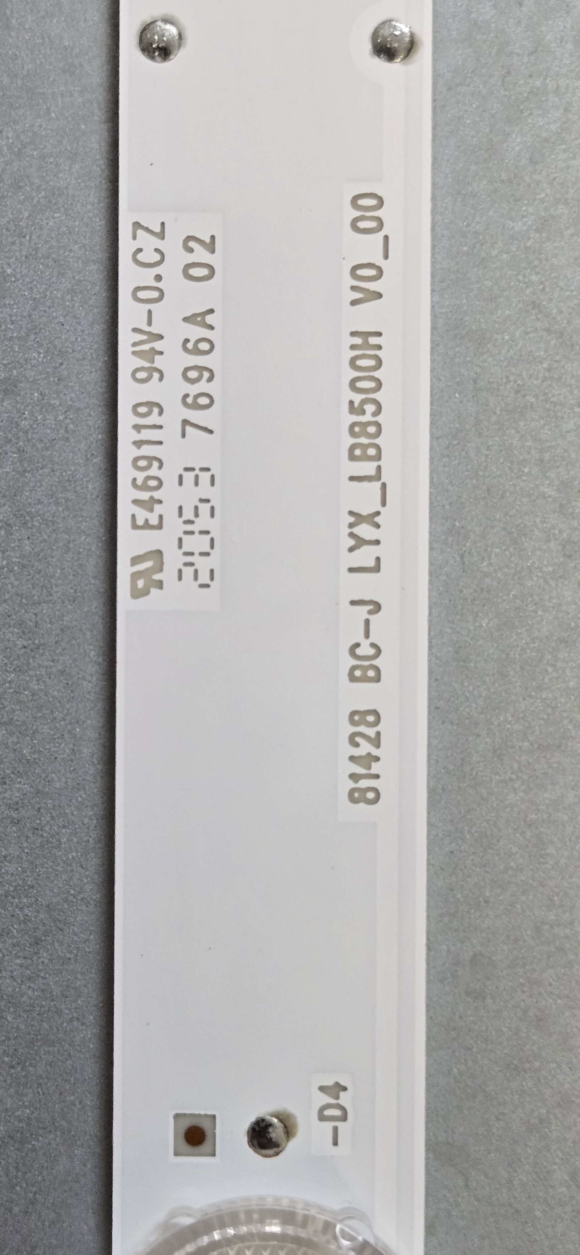

                                    So I started with this today. First thing I did was test the LEDs at the harness, and once again only half lite. I played around with it checking other spots within the LED strip and they were testing fine again. Then once again the set that wasnt lighting, was lighting again. It got me searching for the video the above video was talking about, how he tested the LED strips and it gave it juice to work for a few days, then they would go out, he would test it again and it give juice and so on and so on. Thinking that maybe its possible the same thing was happening here with the set I am trying to fix. Because in the beginning I wasnt getting a lights then after testing I had lights, then the lights went out again. Only set I can available is out of China, so itll be several weeks for delivery.

                                      I understand what your saying, but the YouTube video you showed from bigdogg ended up being the leds after all.
                                      6 blink code is led error code and you can get the tv to start sometimes which indicates the power supply is good.
                                      unless you have a shorted/ broken wire to the leds somewhere it's most likely the leds as I mention.
                                      Do you have a led tester? Are these 12v leds like other Sonys I've had? If so measure each led not each strip and make sure each is getting 12v and not 10 or 9v etc. sometimes the light will work with 9v but still throws error because it's not 12v light it should be.

                                        Yes, I followed his follow up video and saw that. And since he was having same initial result, with the LEDs lighting under tester but failing under TV power, I think I am going to order a set. Its not a bad idea to have a set on hand anyway since at some point the LEDs will go out haha.
                                        Not sure if they are 12v. Ive tested every individual one and they all read same 2.4 off a tester. I know they are not very bright with the tester. When I had them working, they got quite bright.
                                        Also, I noticed if I hold the tester on an individual LED it blinks dim to bright and repeats. The whole strips dont do it though.

                                          This is the markings on it
