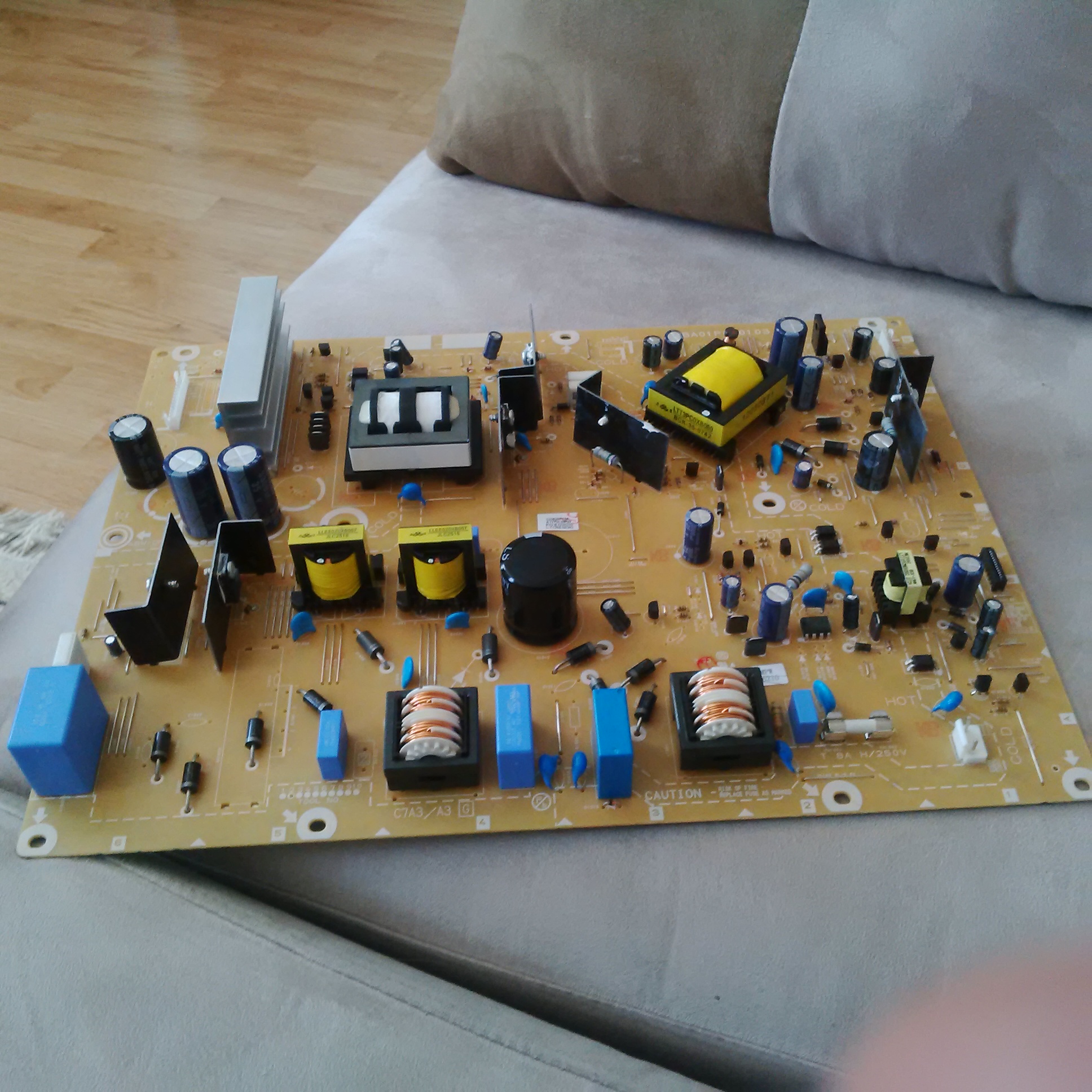

    A17P1MPW LC401EM3F Emerson PS Issue
    Been reading the other posts and downloaded the schematics for this power supply. I studied the repair kits for this power supply. The thing I don't get is I metered all the caps, diodes, fets, and transistors. They all read perfect. Any that didn't read properly I removed and metered again. Proved them to be ok. Now there is some ic's on the repair kit I obviously can't meter. Is it possible that one of these chips has blown but nothing else? I find that odd. The fuse has never blown on the board.
  • dcapper
    • Dec 2013
    • 496
    Re: A17P1MPW LC401EM3F Emerson PS Issue
    Got an update for anyone that has issues with this power supply. There is five 4 pin ic's 2561a is on them. I bought them from Digikey. I got the tv to power up now but I have no picture, just audio. I was metering the inverter board and I am not getting voltages on the fets. I checked the fuse and it's good. Is it common for an inverter to die? I haven't had one on any of my repairs in the past go faulty.

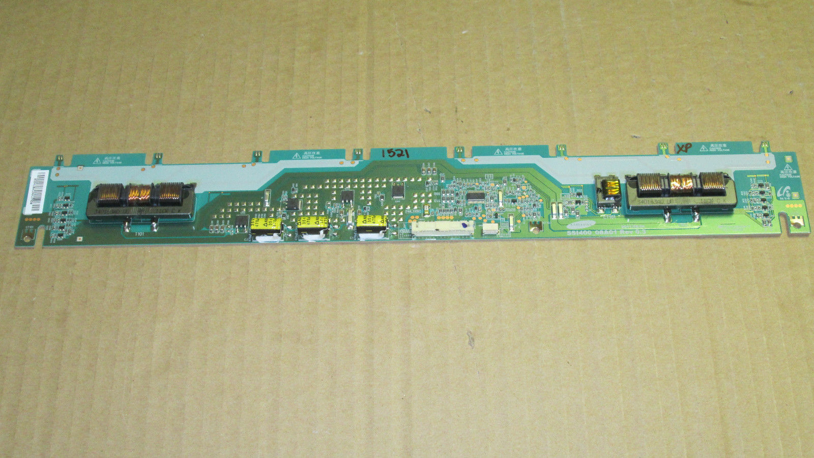

      Hi - do you have back light -or nothing at all on panel?
      Looks to be voltages supplied from top left and top right connectors to the inverter board. Are those voltages ok?
      Please can you post a picture of the inverter board?
      • dcapper
        • Dec 2013
        • 496
        No backlight at all. Black screen with audio. The connectors leaving the power supply are supplying the proper voltages. Once it gets into the inverter board, I lose my voltages at the gates. Voltage goes in and doesn't come out. No short when metering the gates though.
