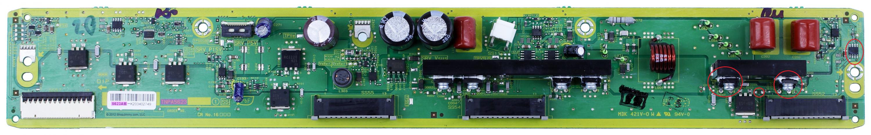

    I'm looking for information regarding a plasma tv Panasonic viera, It's not mine someone I know has asked me to fix. I dont have the tv in my possession only the ss board.
    looking over the board there is some blackness on the furthest right screw mount I read this is electrical arcing which has shorted some components.
    I was going to order a repair kit from shop jimmy $19.99 the postage cost was over twice the cost of the parts to the uk other ebay variants dont offer uk post.
    Can somebody help in identifying the repair kit components, and the location on the ss board.

    Its usually the two FETs near that arcing screw. One small smd resistor and the 8 pin IC. Usually that 8 pin IC is okay though, and trying to source one is difficult.

      Thanks for the picture made things much clearer
      Underneath the pcb of the fets you pointed out is brown discolouration
      I am having some difficulty finding these two. I have paypal or visa debit card
      RF2001 T3D "147"
      DG302 "150r"
      5R6 resistor - (I can aquire easy) btw there was continuity with multimeter does that mean it's ok or not.
      BD86941502 (I'm skipping this ic)
