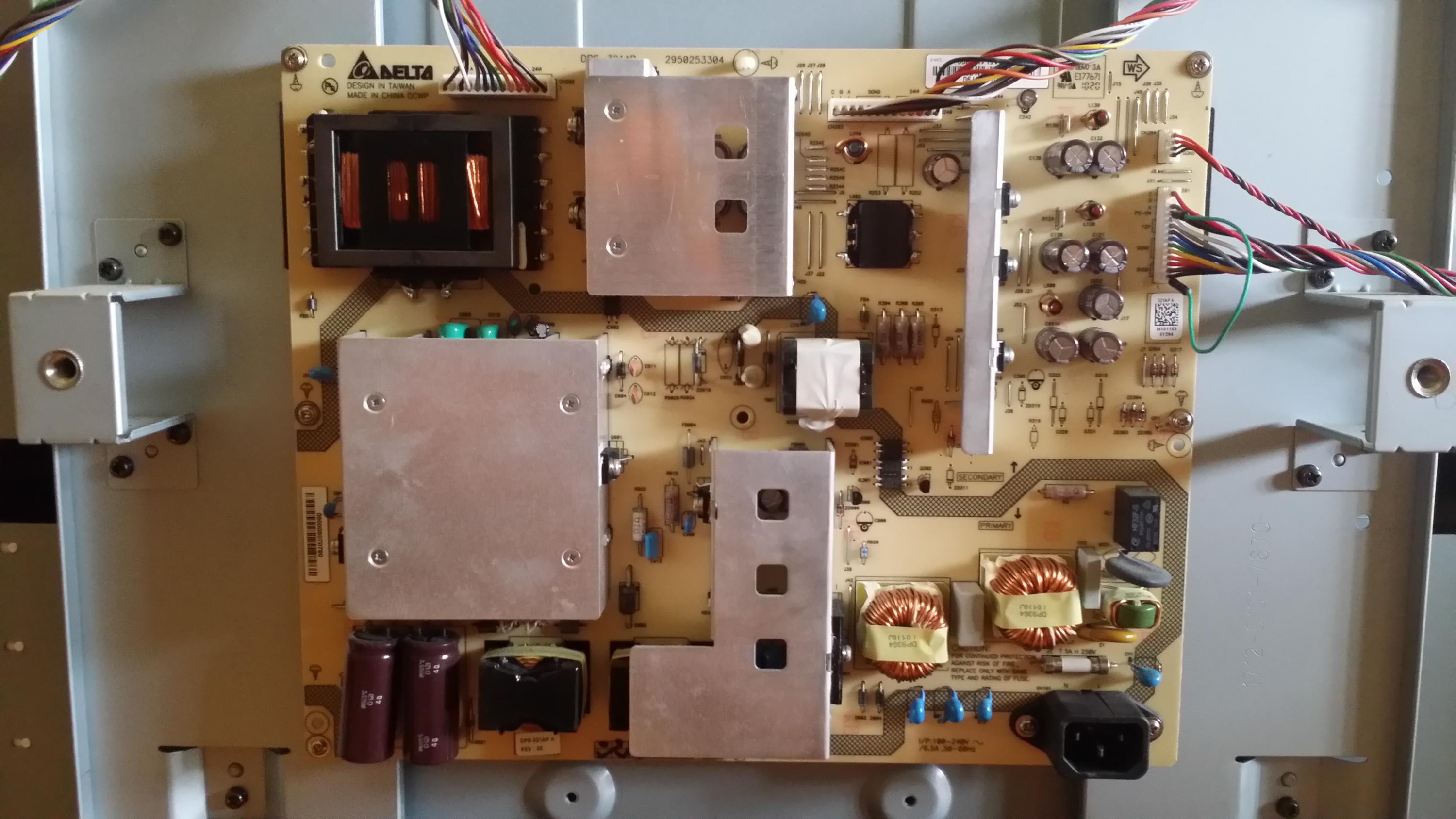

    This TV will not power on. Standby light (orange logo) remains on after AC power is attached, but unresponsive.
    I have visually inspected all of the boards and everything looks perfect.
    The power supply will only power up when the STANDBY and PSON are shorted. All output voltages are correct.
    My guess is a problem with the main board, but I'm not sure what to check from here.

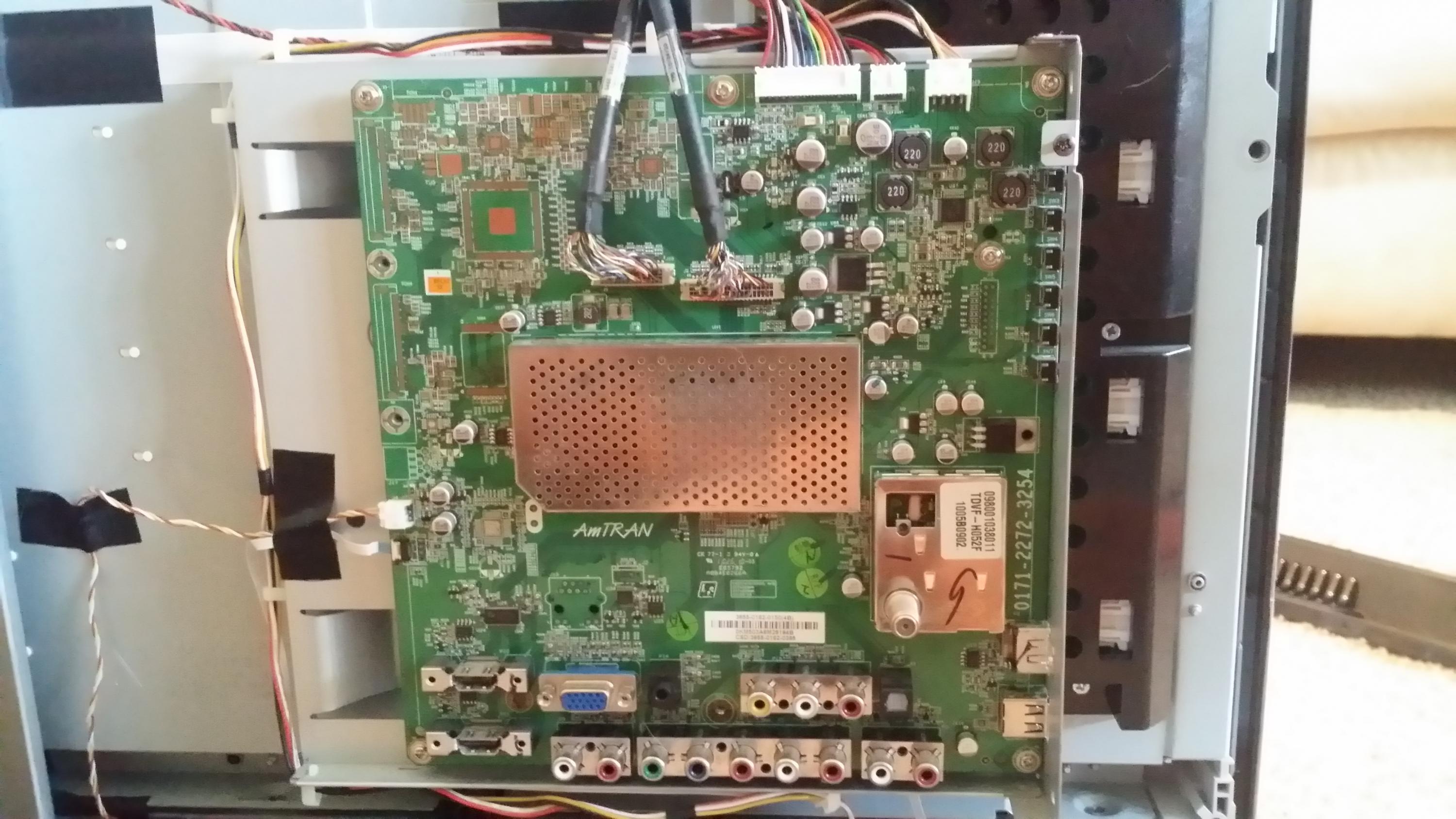

    Re: Vizio E550VL, Standby Only.
    Power supply
    Main board

        Try checking the voltage regulators on the main board. However most likely you have a firmware problem or bad flash IC.
          I will try checking them asap. What are my options for bad firmware or bad flash IC? A new main board?

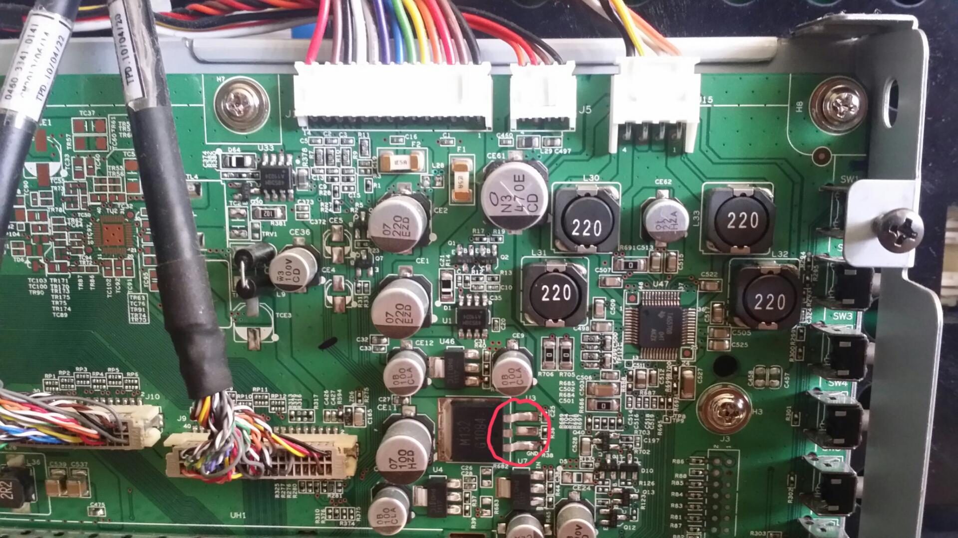

            I found a problem.
            It is a voltage regulator.
            The numbers on it are:
            M132
            G1084
            The middle pin doesn't make a connection anymore but it is still showing 3.3 volts.
            Should I try to reconnect the middle pin or should I wait until I find a replacement?
              Originally posted by jkirch86
              I found a problem.
              M132
              G1084
              The tab is the connecting point. that regulator is ok
                So the middle pin should not be connected?
                  NO, because the tab and pin 2 are the same. look at the trace, or ohm it out with a meter
                    Yep, they are the same.
