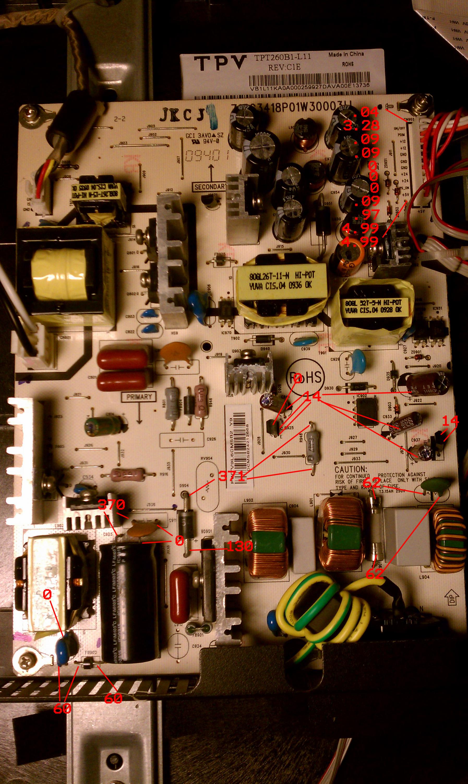

    VIZIO VA26LHDTV10T has white vizio logo before pressing power on. no backlight.
    i picked up this VIZIO VA26LHDTV10T today from the recycling center for 10$ as soon as i plug it in, the vizio logo turns white. i think its supposed to be amber first, in standby until i press power but it just turns on as white, i never see the amber. pressing the power button does nothing. it doesnt turn it off or on. its just "on" immediately as soon as i plug in the power.
    the backlight does not come on, its just a blank unlit screen.
    i took it apart and tested some voltages which i will post.
    i dont see any bad caps or any fried components.
    i thought that ceramic capacitors are non polarized, so why am i getting a zero voltage reading on one side like its a ground? or is that a sign that the capacitor has failed?
    i took all these measurements with the negative lead of the main filter cap as the ground. except the connector measurements which i used chassis screw as ground.
    i can see clearly im not getting the right voltages to the mainboard. if the white light is on it should mean the 12v power is flowing but it isnt..im only getting .09
    so what may be going on here?

    the "primary" and "secondary" markings on this board are pretty ambiguous...

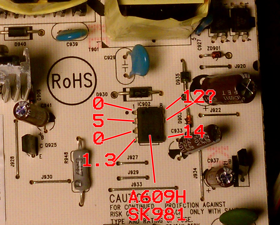

      getting some weird measurements on IC902 which is labeled A6069H SK981
      for one thing the 6th pin seems to be missing.
      and pins 7 and 8 make my voltmeter make some crazy feedback noise and the current alternates between 12v and 1 and then eventually just stays at 1.. or something like that. its weird.
      could it be this chip is bad?

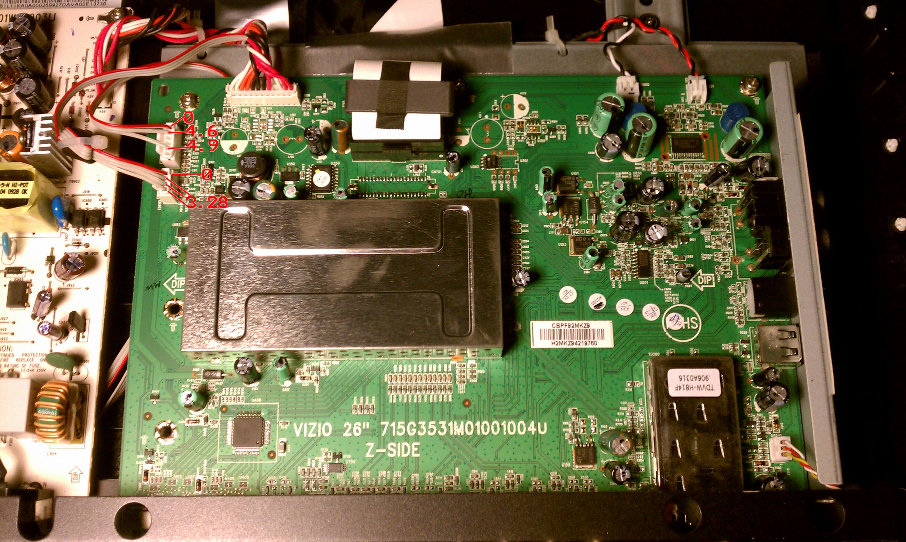

        vizio's are known for having bad voltage regulators on the mainboard. i would check u150-u154 and see what voltage readings you are getting my guess is probably 1 of them is bad. some might be fixed or adjustable. you will have to check the numbers on the regulators to find out what they are. i can't tell from the pics. i don't think that chip is bad or you probably wouldn't have any standby voltage.
        • triplefour
          • May 2014
          • 1747
          Re: VIZIO VA26LHDTV10T has white vizio logo before pressing power on. no backlight.
          ok yeah that logic makes sense.
          its seeming more like a mainboard issue.
          i guess i could jump the power board to really test that...
          so on the voltage regulators all look fine to me but maybe im wrong so heres the measurements i got:

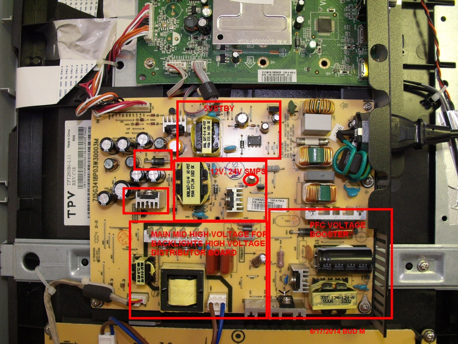

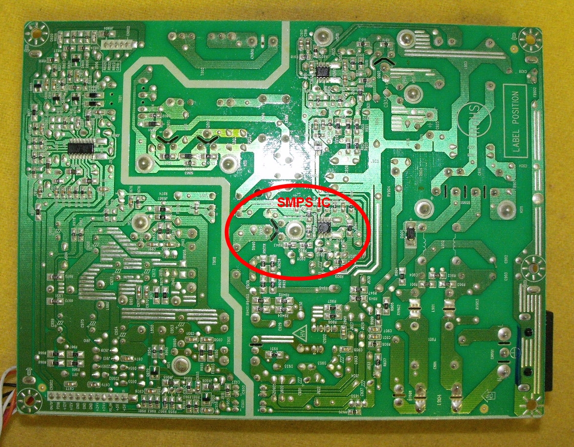

                This section is the standby power supply, it is working otherwise you will not have WHITE VIZIO LOGO. I hope you did not damage the meter, that pin 7-8 are the Drain pin which will have high voltage spike on them.
                  BTW, right now PS_ON is less than a Volt but enough to turn on the PFC Voltage booster to give you 370VDC on the two legs of the MAIN filter cap, no ON/OFF signal to turn on the backlights, no 12V, 24V either. I hope that voltage readings you are showing in the primary side are done using the correct Ground ref point. What did you use for Ground ref point?

                    You can see thick black line for the separation between Primary and the Secondary.
