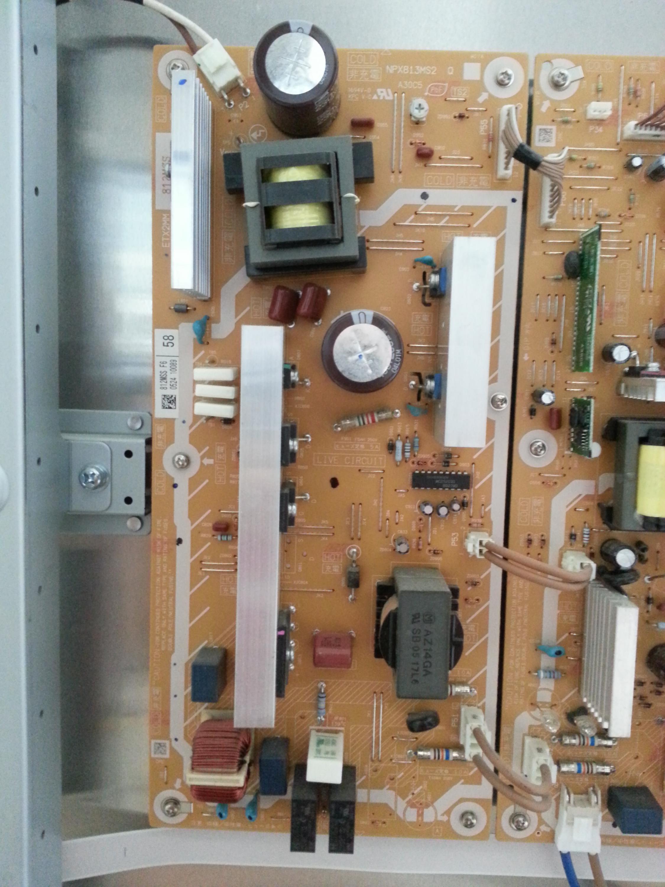

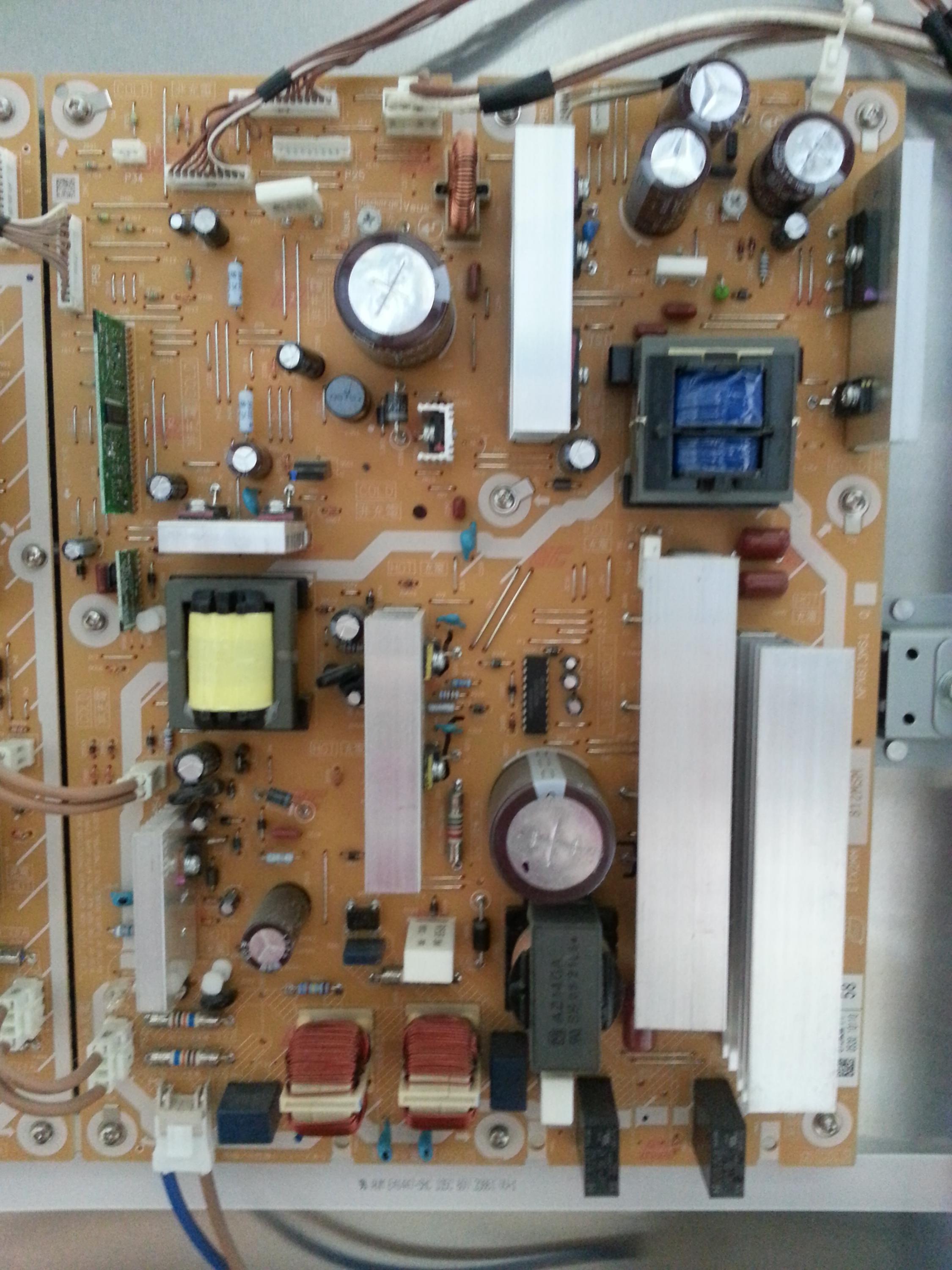

    I've read the other threads about this TV, but my situation is a bit different. There was a power surge, and afterwards there are no signs of life in the TV. AC going into the power supplies is good. Hit the power button, nothing. Same with power button on remote. The diagnostic LEDs on the main power supply do nothing. All six fuses are good (3 on each board).
    I realize that the power button runs through the main board, so I'm hoping to get a little direction as to where to begin troubleshooting.

    Spot checking diodes on the power supplies yields odd results. Some show very low one way, nothing the other (as one would expect). Most show ~500 ohms one direction, ~1800 the other direction. Some are 500-800 ohms in both directions.

      And I found a 4th fuse on the main power supply board, also reads good.
