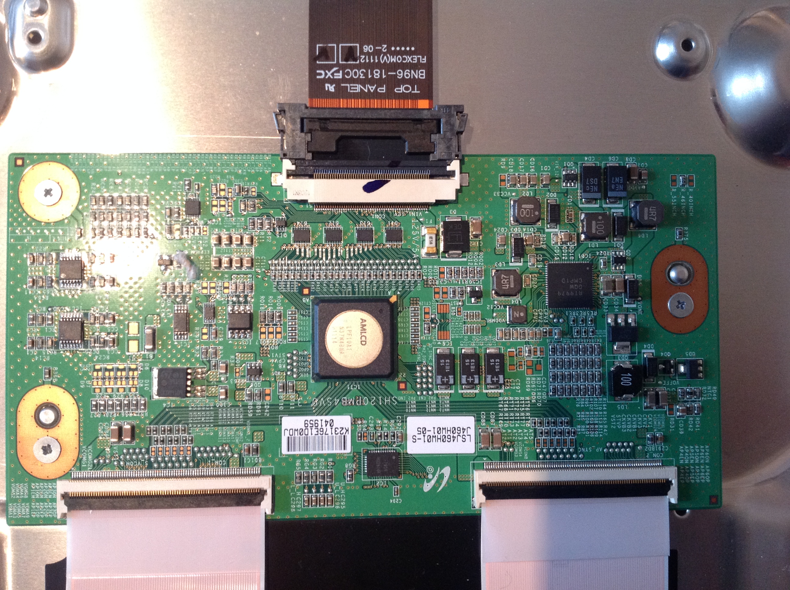

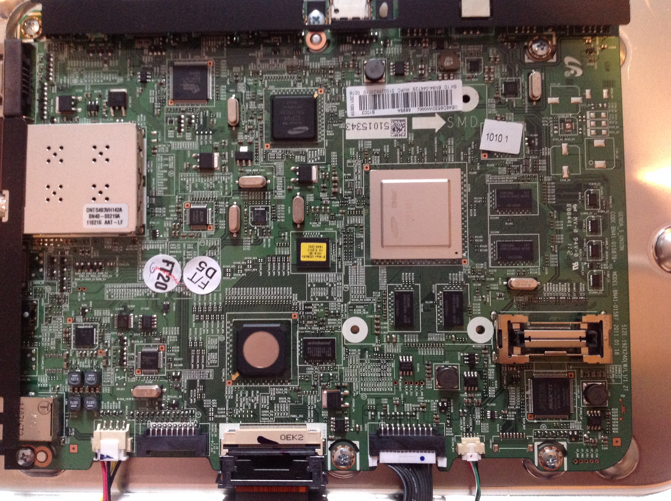

    First post, apologies for any noob errors. My Samsung UE46D6530 gave up the ghost a couple of months back. In the middle of displaying a program, the picture and sound simply cut out. The power still flows through the system - the indicator light responds when the TV is plugged in or you use the remote - but whatever I do there is no picture or sound. Predictably, this happened about 2 weeks out of warranty. Bah, humbug.
    I have delved into these forums and tried a few things:
    1) Checked the caps on the power supply board - no bulging/etc.
    2) Replaced the power supply board (refundable item luckily!) - no dice.
    3) Got myself a multimeter and tested the F1 resistor on the T-CON - reads 0.0Ω
    My hunch says the panel's gone, which would be a kick in the teeth, but I was hoping some of you fine people might have some good suggestions about what to try next.
    Are there more things I can test on the Main Board and T-CON? I have attached pictures of same for reference.
    Many thanks in advance for any bright suggestions.

    I doubt it is the panel - if the panel was faulty you would still get sound.
    My guess would be the main AV board - i had a similar situation with a UE40C6540 recently which turned out to be a bad main board. After i replaced it it worked like a charm!
    I would say if you have already tested another PSU board and you are getting no sound as well then there is a good chance it is the AV board.
    If you can test the backlight system as well (a service manual should tell you how to do this easily) you can then rule out the backlight / Power board which would leave the AV board.

      Thanks so much for the reply, I really appreciate your input. I had thought that a bad panel wouldn't affect the sound, but being new to TV repair I didn't want to give myself false hope!
      I have found a replacement main board, but it's not all that cheap and doesn't come with a returns policy. Are there perchance any tests I could do to confirm/bolster the diagnosis of a faulty main board?
      Talking of which, a backlight test sounds like a good idea. However, I have pestered Samsung for a service manual and scoured the internet for same, but have not had any luck. Is it possible to use the service manual for a similar model (e.g. the UE40C6540 you had or perhaps another D series LED TV) or is it necessary to get the manual for the exact model?

        Try disconnecting the ribbons at the panel(between T-Con and panel) one at at a time.
        If picture shows up, on only one side, then the panel is bad.
        D series, is famous about bad panels(I had a D6420 w/bad panel). C series has bad main boards.

            tibimakai, your diagnostic test confirmed my deepest fears: the panel is dead. Ah well, such is life! Samsung have mentioned the possibility of assisting me with the costs of repair... We shall see... Thank you again for your help.

                  Did you get half a picture ? and if you did was it only one the right or left or did it switch sides when you switched ribbons
                    Re: Samsung UE46D6530 no picture/sound
                    Hmm that's a little odd, because you said both the sound and the picture went out at the same time? The panel wouldn't cause the sound to go out. But did you still have the backlight on?
                    If you unplug each one of the tcon ribbons at a time you should only get half a good picture. But if you unplug one of them showing half a good picture and the other ribbon unplugged shows half a "bad" picture then the panel is bad.
                    Try plugging both in again with a source connected and see. Maybe it was an intermittent problem and the picture came back while you were testing and unplugging the tcon ribbons?

                                Hello guys,
                                Recently I had problems with my UE46D6530 (no picture, sound ok), as some of you adviced here I tried to unplug one of the ribbon (on the left side) between t-con and panel. Now I had picture on half of screen ok-nice progress. When I plugged the ribbon back and switched on the TV - whole picture was gone. This could indicate there could be short-circuit somewhere on the left side of the panel. I took sheet of paper to isolate the ribbons on the left side. After that I tried to turn on the TV and suddenly everything was fine.
                                I cut out strips of paper and isolate all ribbons (those between t-con and panel to prevent same damage on the right side).
                                Thanks for advices, which allow me to fix this problem (because even authorized service of Samsung here refused to fix it)
