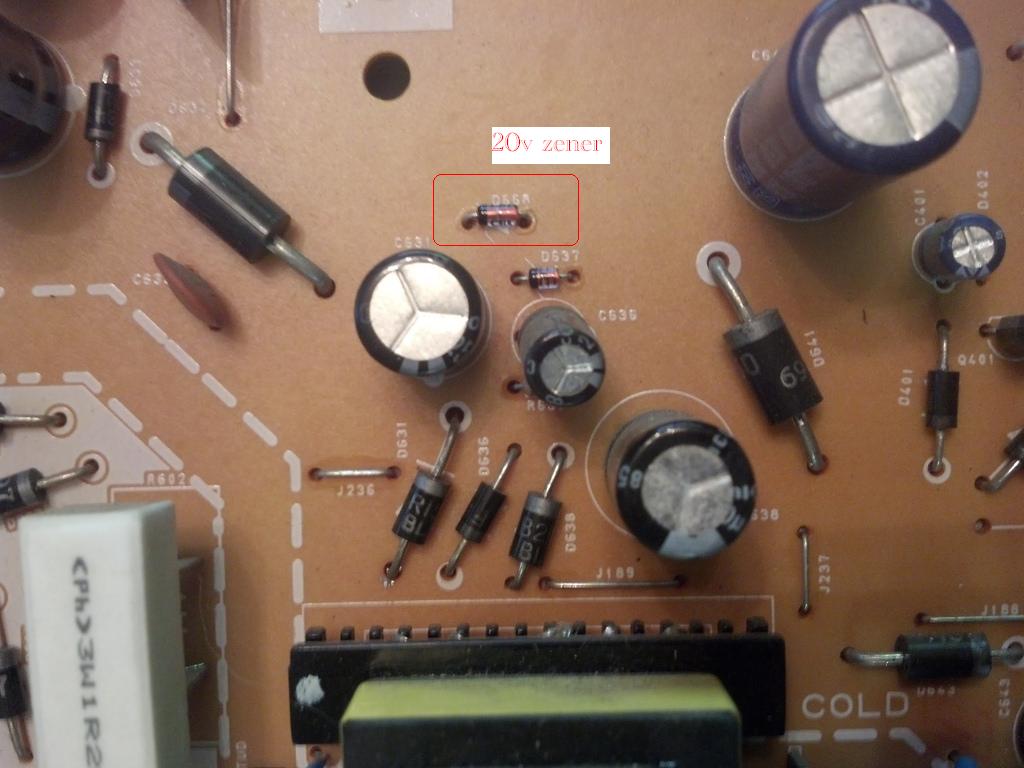

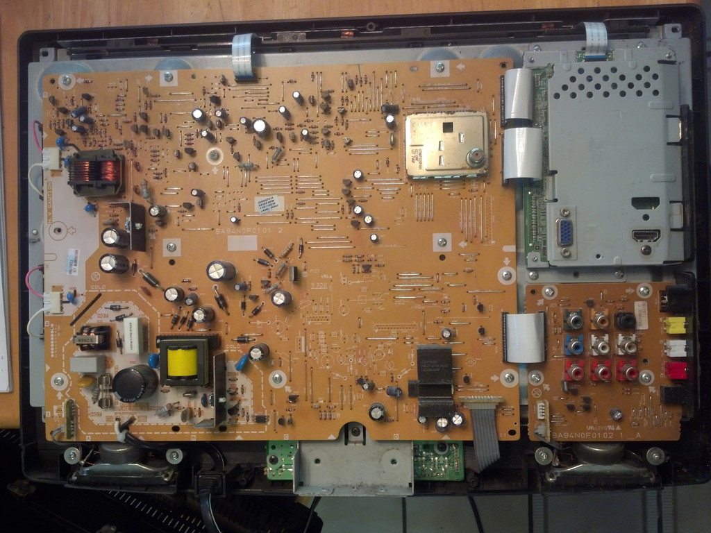

Wife dragged me to the dump tonight, and I spied this little bugger in the electronics bin and snagged it. As it was a funai I thought it would have the common blown components in the power supply. When plugged in there was no standby light, upon opening it I was shocked to find the mosfet, fuse and 2.2 ohm resistor intact. A quick check with the multi meter zeroed me in on a shorted 20B zener in the secondary (D668). After replacing it the set now works as well as a funai set ever will.
Emerson Funai LC195EMX solved
