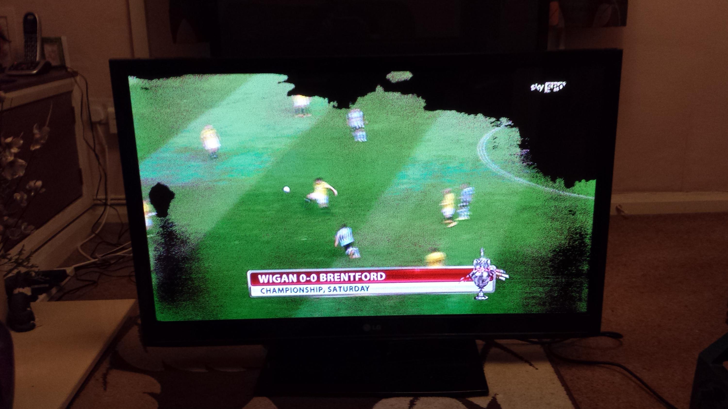

      found 6 components short ysus board, ey712,ey710,ey714,ey752,possible ey736 all fets, 2 diode open d712 d713
      checked the buffer board no shorts. tryed unplugging the buffer turn on still clicked there another way to make sure?
      going to try and order them today do they have to be exact the same hard to see some of the numbers?

            Hi replaced 4 igbts blown ysus board lg42pj350 the tv powers up now the picture, colour not right any one have any idea?
            Cheers
            post pic

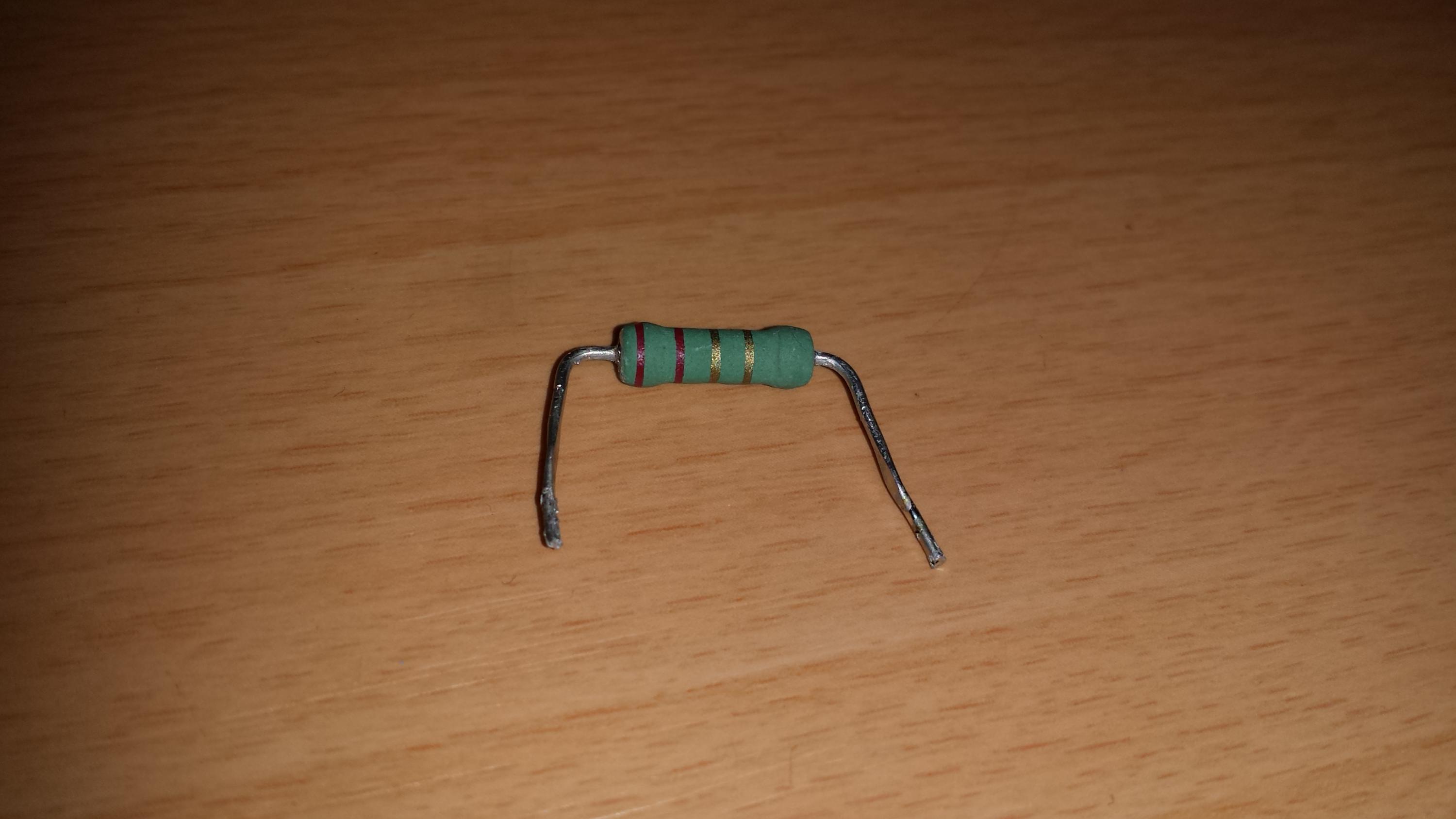

                  does any one know where i can buy these green coated resistors having trouble finding them from the uk
                  cheers

                    #29
                    Re: 42PJ350 clicking noise
                    Hi Where can i find these green coated resistors can only find them with blue coating, still ok to use ?
                    same colour band as the green just want to make sure
                    rgs
                      #30
                      You can use any colour body... the bands are what matters... but why are you replacing them? Resistors rarely fail without obvious marks such as burn marks or discolouration.
                      Your fault looks like Z-sustain fault.

                        2 are short 1 measures to high
                        Definitely ysus board mate.
                        Thank you Tom for your information i will order them now
                          #32
                          I've said it before. Resistors nearly never fail short (they almost always fail open), and you can get low resistance resistors. Yours are 2.2 ohm, so that is fine, for them to show shorted on a simple multimeter.
                          I really doubt they will do anything for your problem...

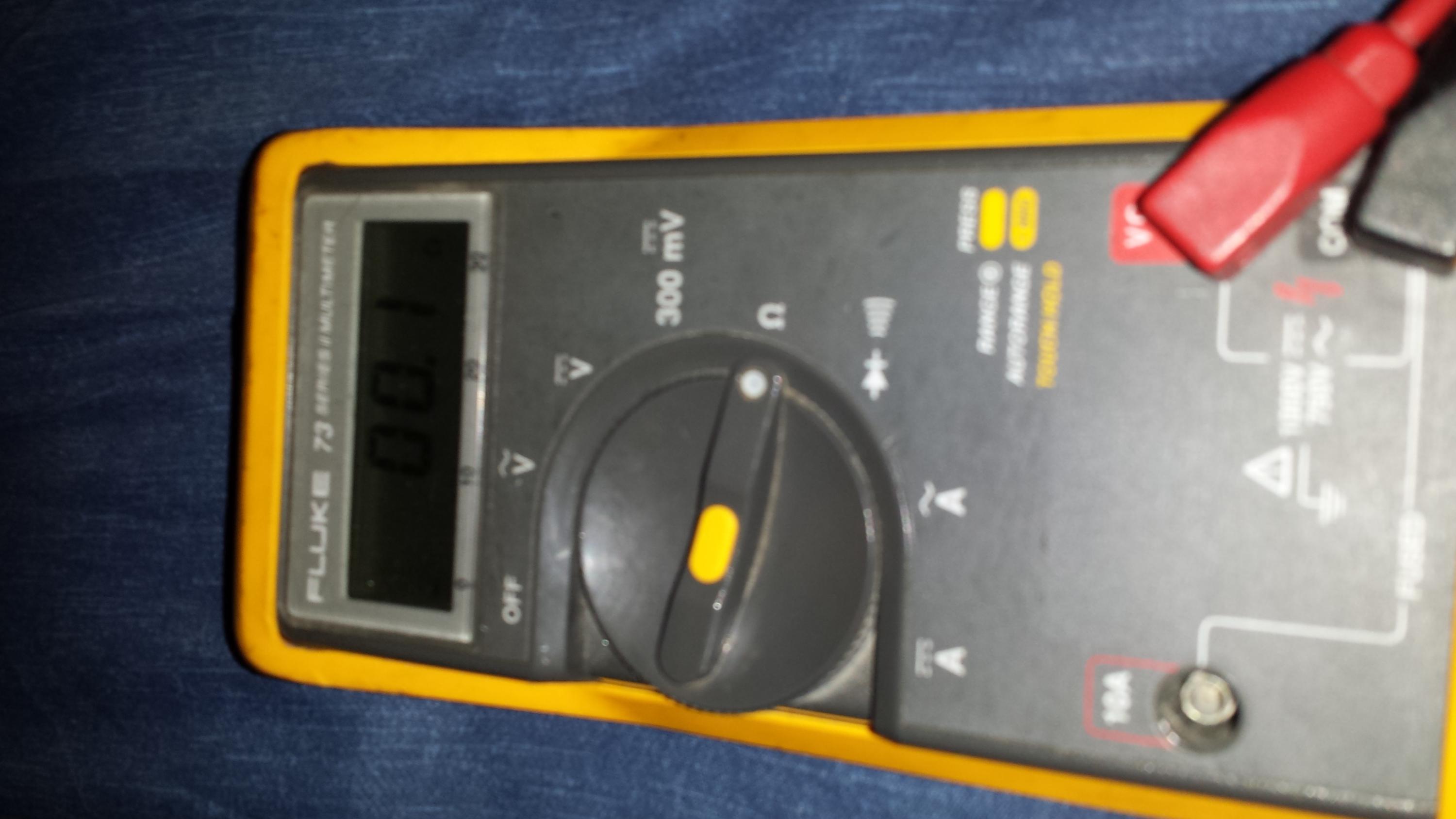

                              What are the colour bands on them and what do they measure each
                              • marty-clubber
                                • Oct 2014
                                • 58
                                • u k
                                #35
                                Red red gold gold
                                04.7
                                04.2
                                3.47
                                cheers
                                  #36
                                  Red-Red-Gol-Gol = They would be expected to measure about 2.2 ohm each.
                                  So... assuming those are all on the 200 ohm range, you are getting 4.7, 4.2 and 3.5 ohm each, but those sound acceptable, considering tolerance of the resistor (5%), meter (2%), and by far the most significant effect, the zero-resistance of your meter.
                                  To measure the zero resistance of your meter, set your meter to the normal ohms range, and touch the leads together, what do you measure? I expect around 1-3 ohms for most cheap meters.

                                    #37
                                    00.1 Fluke 73
                                    just posted pic
                                      #38
                                      Ok, different tact... Try probing across a lead of one of the resistors (so red probe and black probe on same lead just to short them out.)

                                        #39
                                        03.7
                                        03.9
                                        4.85
                                        after shorting them out mate
                                          #40
                                          Eh... Just to be sure, both probes on the SAME lead of the resistor, this is just to test how well your meter probes against a resistor (contact pressure affects resistance, especially at low readings...)
