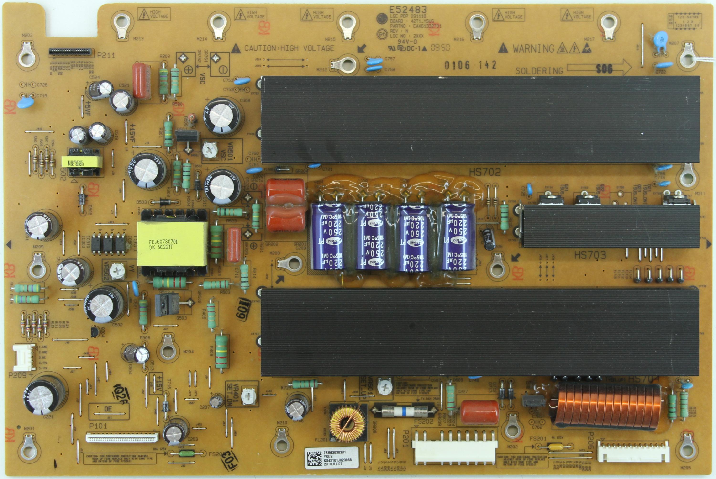

                    Re: 42PJ350 clicking noise
                    Hi Have 42pj350 plasma tv making clicking noise removed power supply fitted new resistors r927, r929 3br1565jf regulator new diode d304.
                    but no joy still clicking.
                    any help would be appreciated new to the site
                      Tried disconnecting the Y-SUS and X-SUS boards from PSU and re-testing?
                      --Whats the voltage on the Vs and Va points of PSU when you do this?
                      TELEFIX
                        Hi disconnect the ysus board tv stopped clicking
                        not sure how you check voltage have multimeter
                            You'll need to check both Y-SUS and X-SUS for shorts......
                              Hi took the y sus and x sus boards off which parts of the boards do i check
                              thanks marty
                                Hi checked for shorts found few blown fets on ysus board
                                diode open near transformer,do you know where i can buy replacement parts?
                                because can not find replacement board all sold out
                                cheers
                                    Charles Hyde and Sons or fleagay, Ohm-supplies, flat-panel TV spares (or summit) just google 'Kit' and the board number.....
                                    Most of the 'fets' will be IGBT's.....
                                        Hi does any on know what the green resistors are on ysus board just posted 42pj350 just found 2 that are shorted any one know where i can buy them
                                        or what they are
