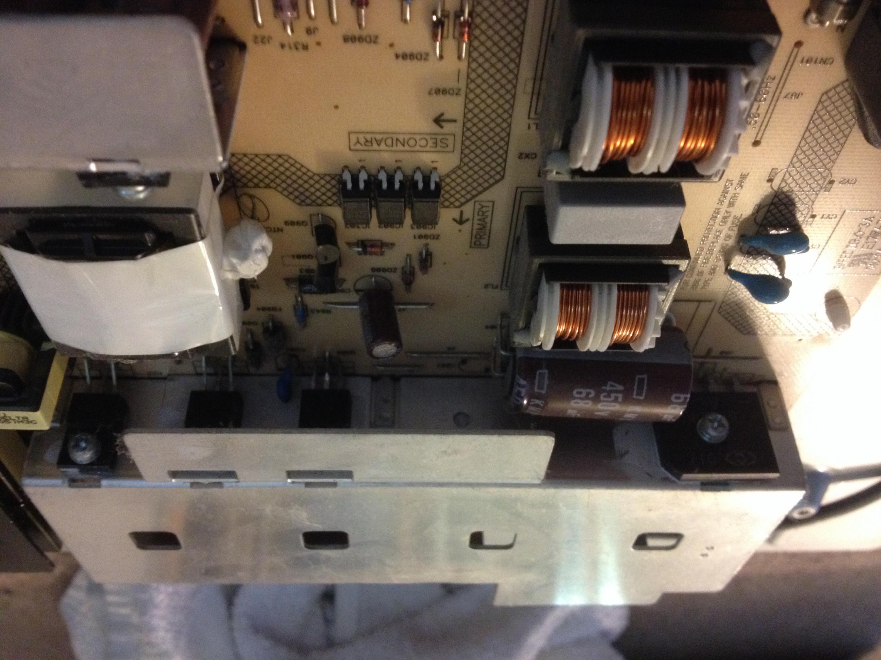

    So I picked this e322vl and you plug it in and as usual the logo flashes orange and white for like 30 sec. Then goes to orange. I can turn the tv on, the splash screen turns on for like 10 sec. Then it goes to the source. Like a regular tv. You can turn it off no problem and turn it back on without the flashing logo. But if you unplug even for a second it repeats the logo flashing. Also when the tv is off there is a whine coming from the power supply. I can't see exactly where cause it seems like it's coming from underneath a big heat shield that has a coil under it and some regulators in there. Any ideas

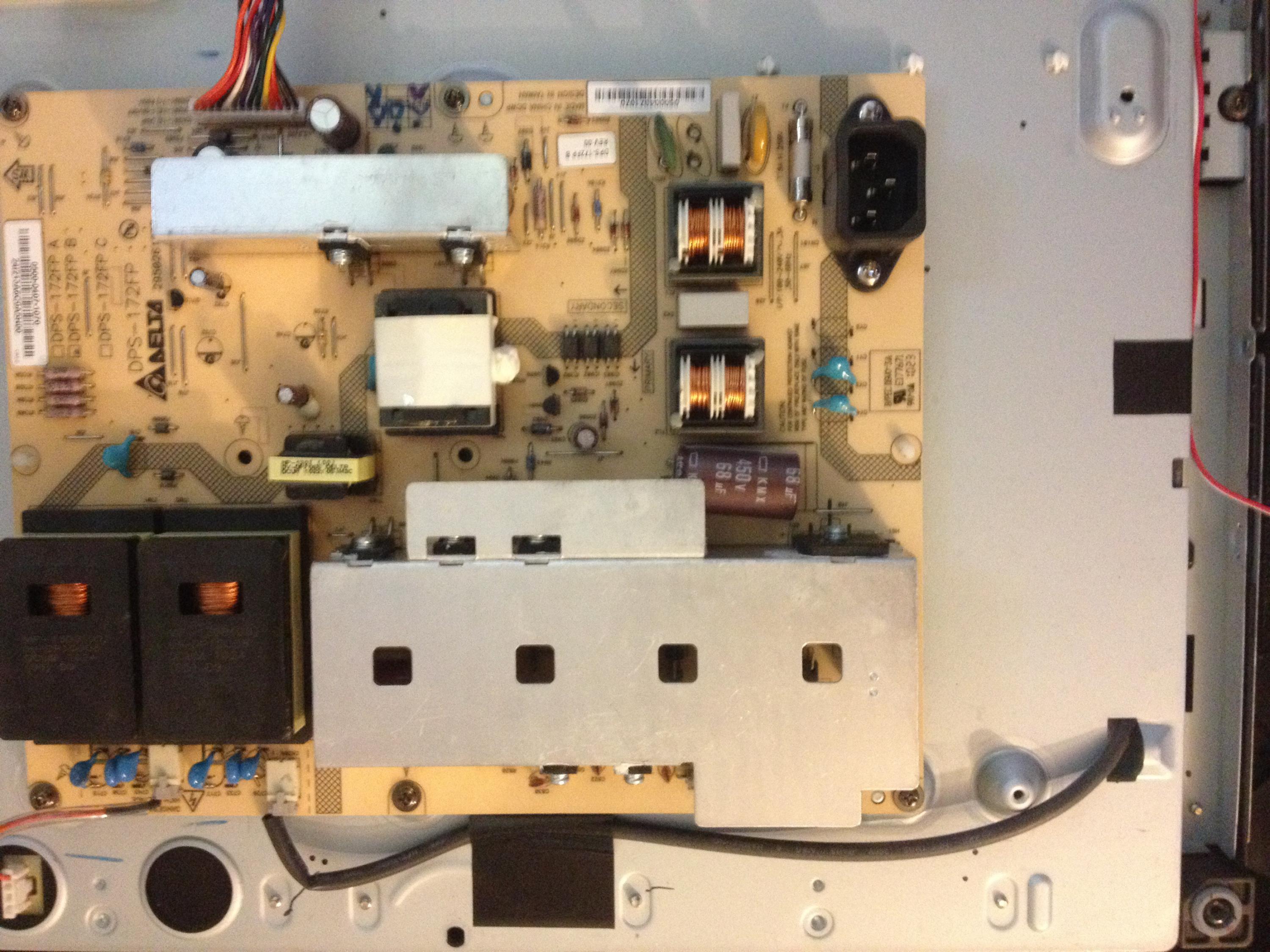

      Top of the power supply. The big metal heat sink to lower left is where the sound comes from
        Re: Vizio e322vl weird kind of issue
        Many TVs save money by having a small flash memory with "compressed" firmware. When the TV is powered on it runs a short bit of code from boot ROM which is not compressed, which then uncompresses the code into the RAM, and executes it. So the initial power on flashing could be it just getting ready to start. And it's not unusual for power supplies to whine under varying load, in this case it would be light load with just an LED and a CPU running but no audio, no T-con, only light CPU usage, etc.
        (This is probably part of the reason Vizio firmware gets corrupt so easily, a single byte corrupt in the compressed F/W and it will not decompress it, and I bet there is zero error redundancy.)

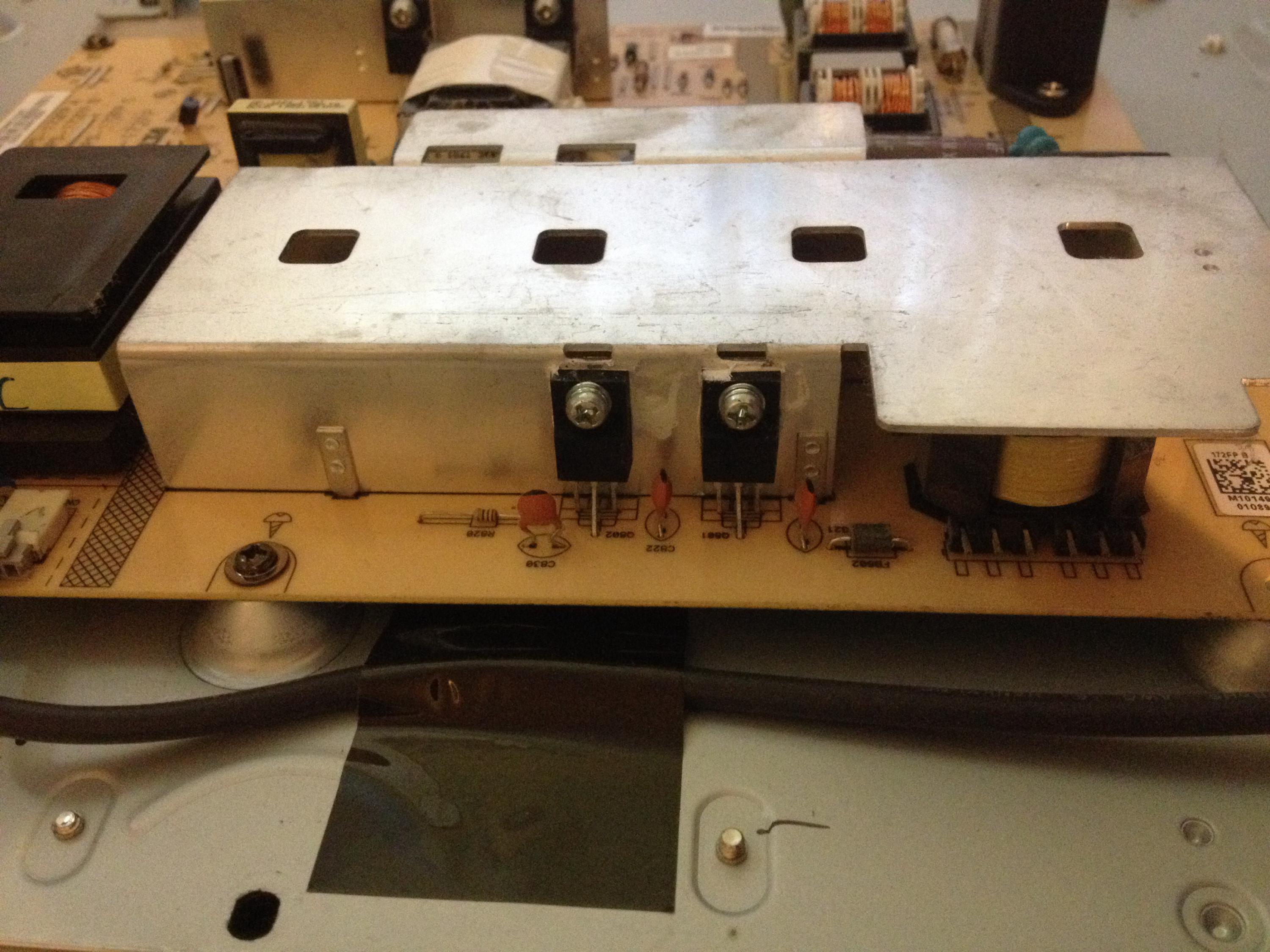

          Regulators
            More regulators
              What do you think I should do to look into the whine. And possible the logo issue.
                The whine is probably normal, I've encountered lots of power supplies with no fault that do that. (If the power supply doesn't work it can indicate a fault, but it doesn't always.) The Sharp 32" in my bedroom takes about 20 seconds to boot if it is unplugged at the wall. But from standby it boots in 2 seconds. So I think it's actually OK. Just my two pence, though.

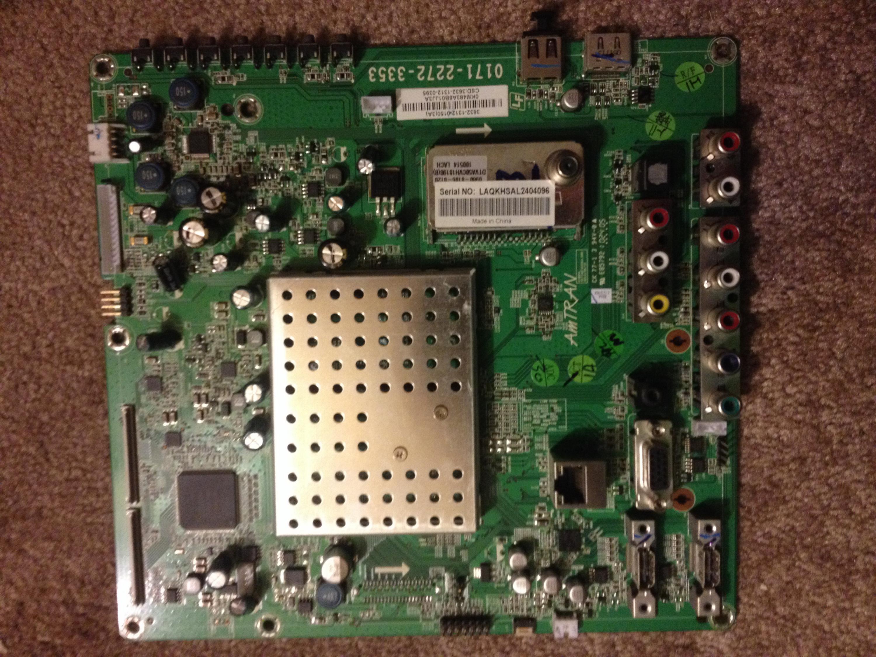

                        Here's a pic of the main board
                          So after doing some research I found that its a common issue with vizios have random rebooting. And what I did is in the time it would turn on go into the settings and reset it back to default which of course this one had parental controls but I found a master reset code on this website that worked. http://www.tvblanket.com/how-to-unlo...trol-password/. So I did the reset and now the tv turns on and stays on. I have had it on now for 10 min now and went through settings and set up the wireless internet and all and picture settings and it hasn't turned off yet. Only thing that does kinda suck is it still makes the whine when off and in standby but not while the tv is on. But so far the tv is fixed. Hopefully it stays that way.
