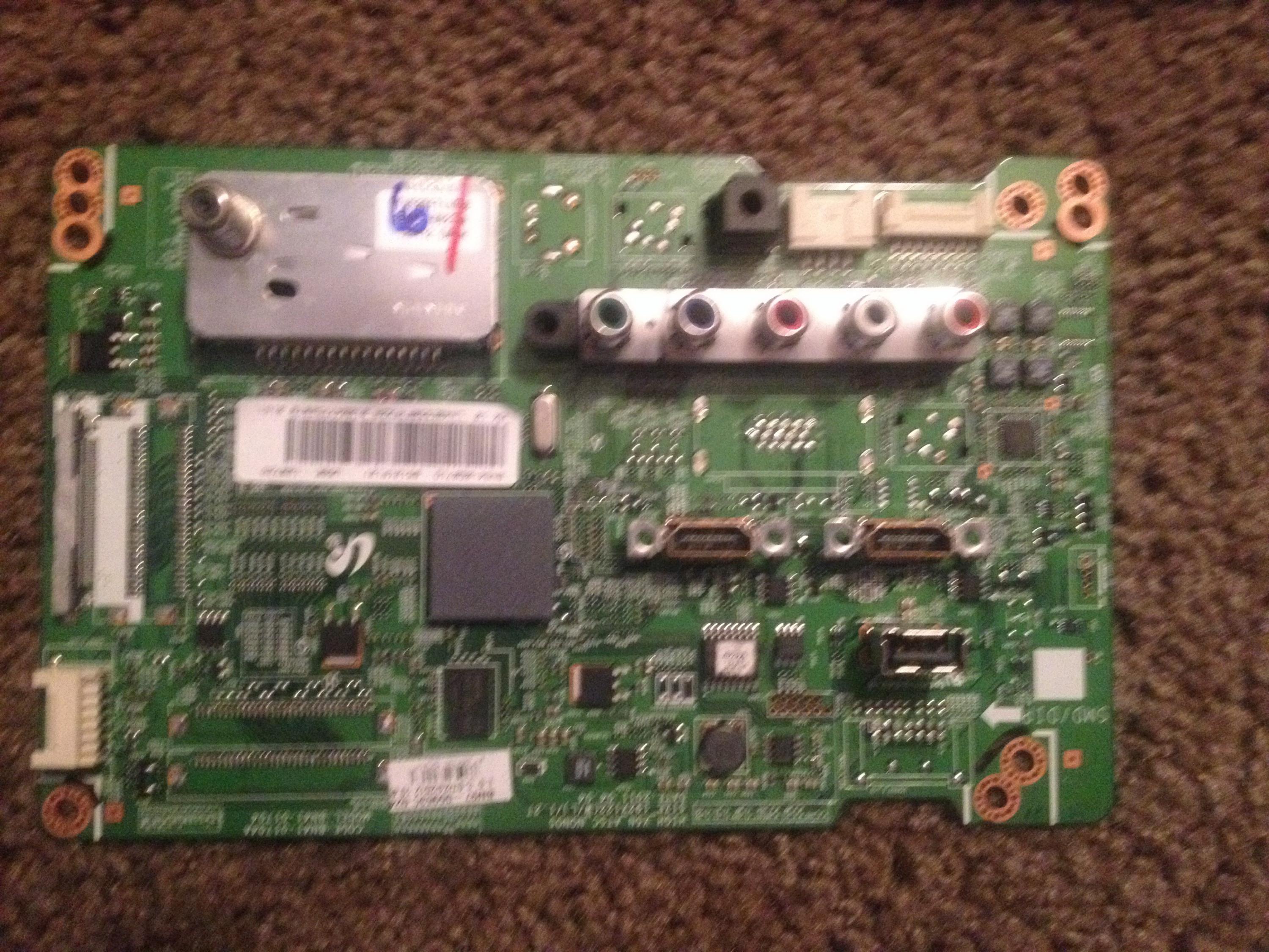

                  • KevinCro
                    • May 2014
                    • 104
                    Re: Samsung LN40E550F7F backlight issue
                    Here is a pic of the main board.
