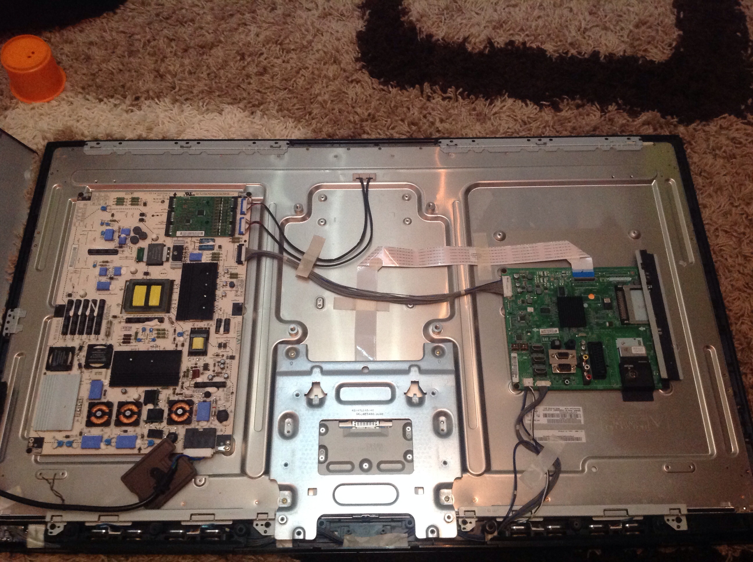

    Hi Guys, I am looking for some real help here. I have LG 42LE4500, from past few days when I start tv it turn on fine but after few minute (10-15) picture goes blank and I can hear only sound.
    I did flash test and I can see dim picture so seem backlight is ok but very dim.
    I checked few forums and seems like its bad inverter but I don't know which one is inverter. I am attaching pics here will appreciate if any one can suggest what component I need to replace
    Kind regards
    Praveen

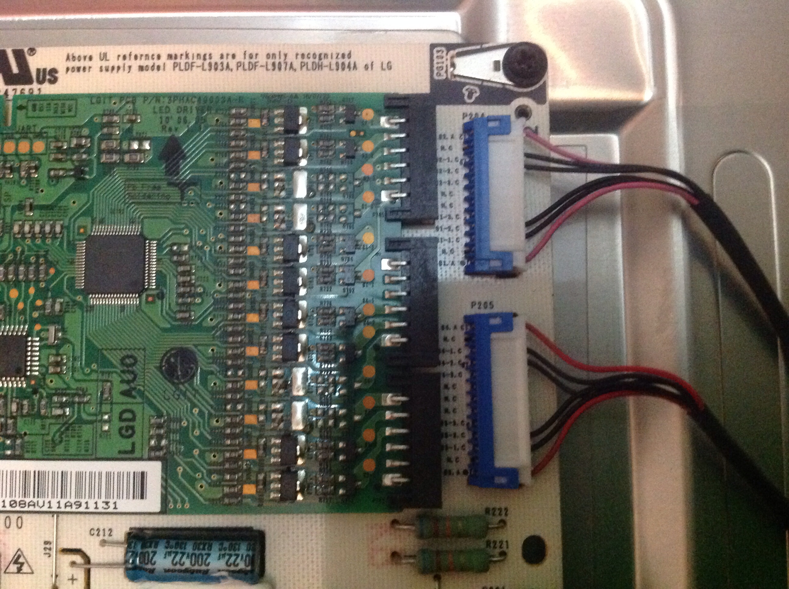

      you dont have an invertor or tubes - it's got LED backlights.
      i suspect they are powered from the 2 cables going through the top-center of the display-shield from the top-right of the power board.

        Do you think it could be problem with main board and it's worth replacing it?
          • 31294
          Re: LG42LE4500 picture goes blank after few second, can only hear sound
          probably not the mainboard.
          some good power boad foto's would be a good next-step

            Yea ur inverter usually is built Into your power board.
                Let me know if this picture of power output pin to led help
