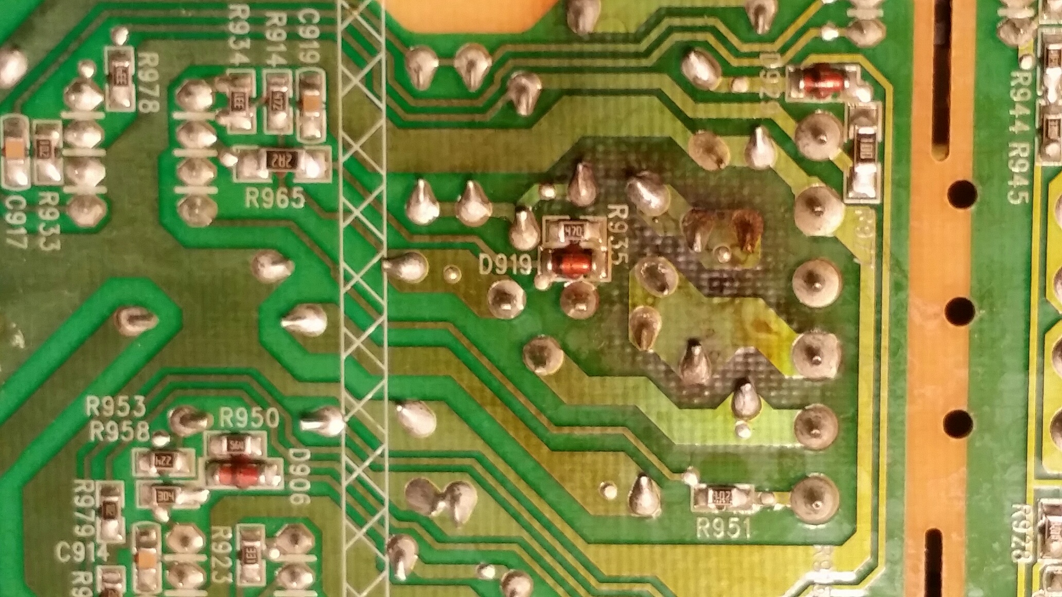

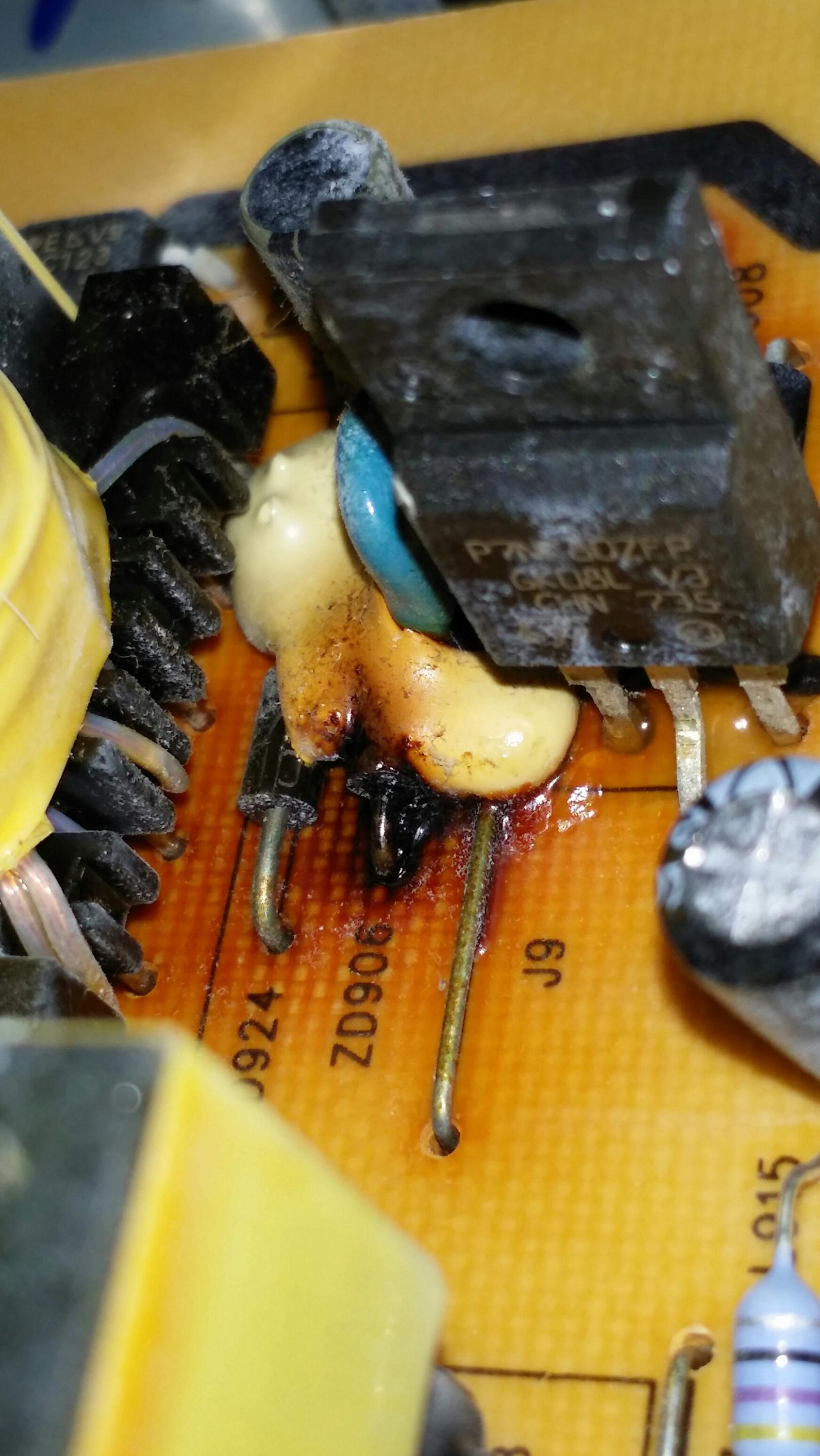

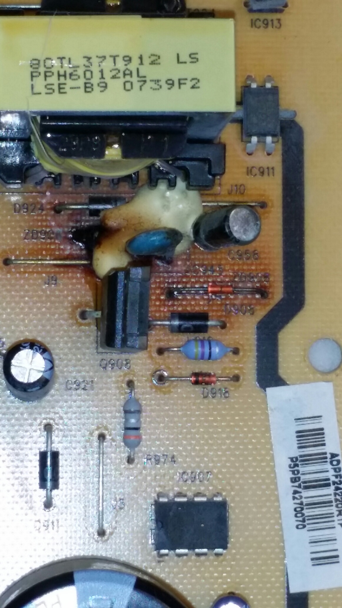

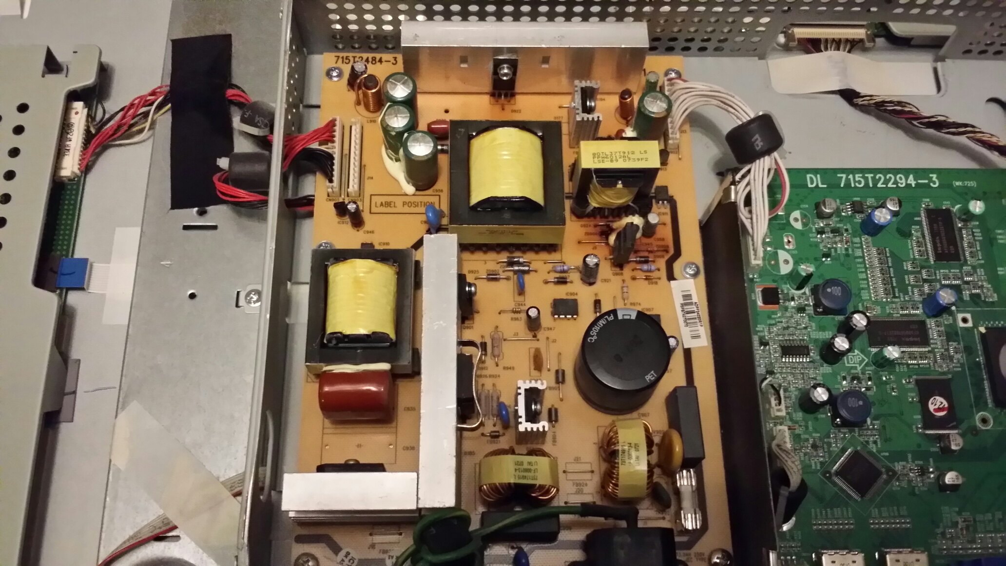

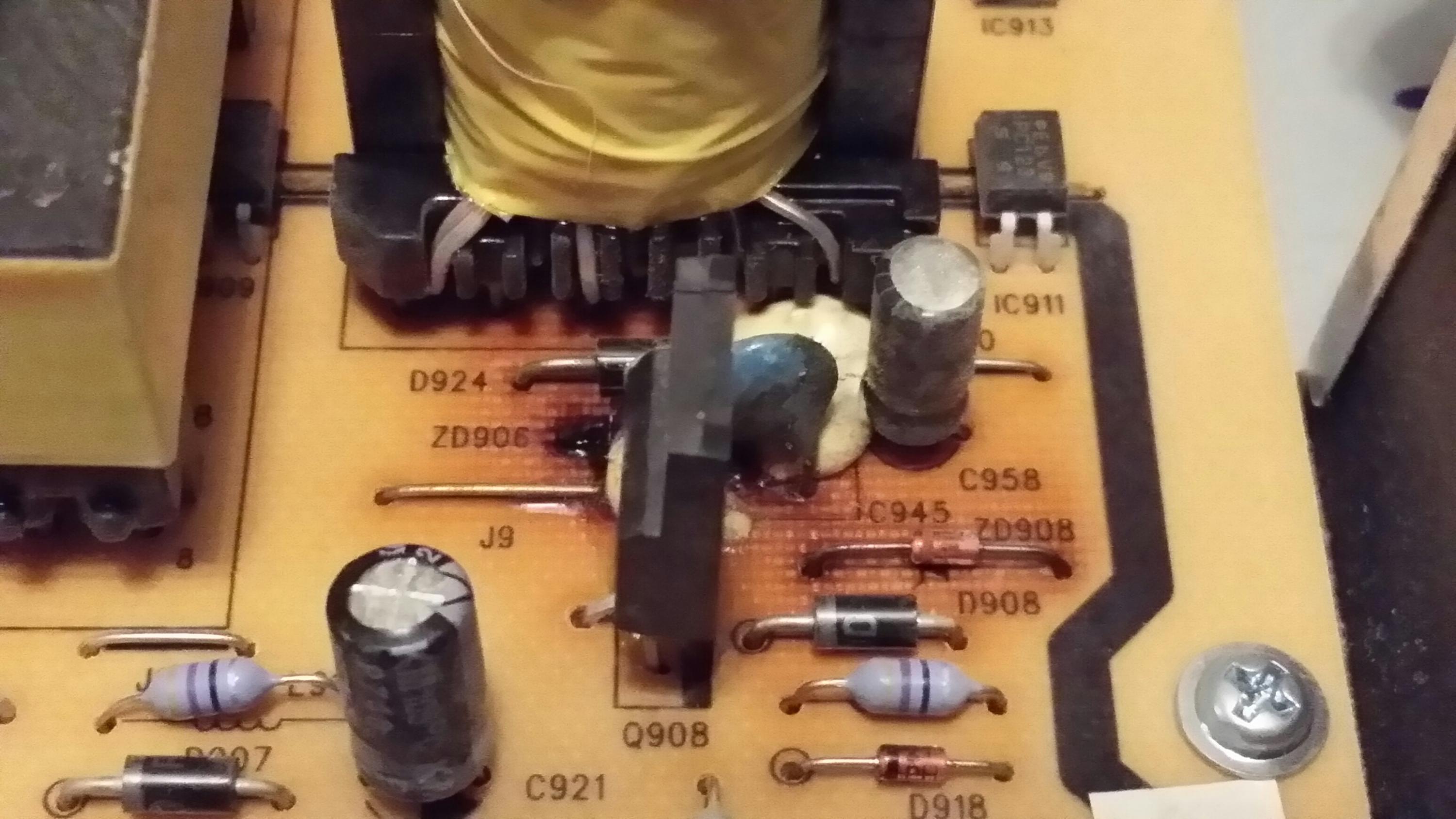

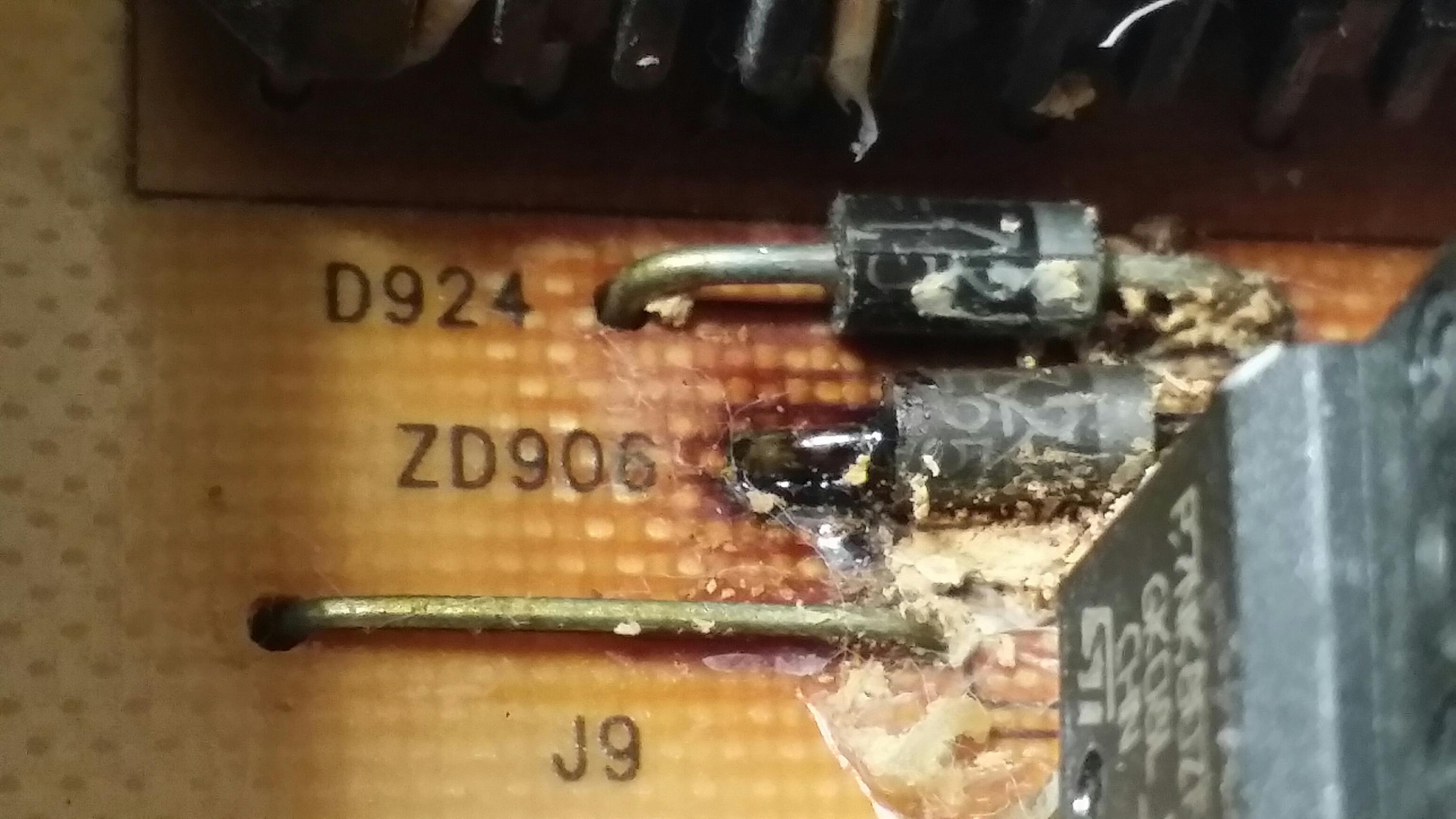

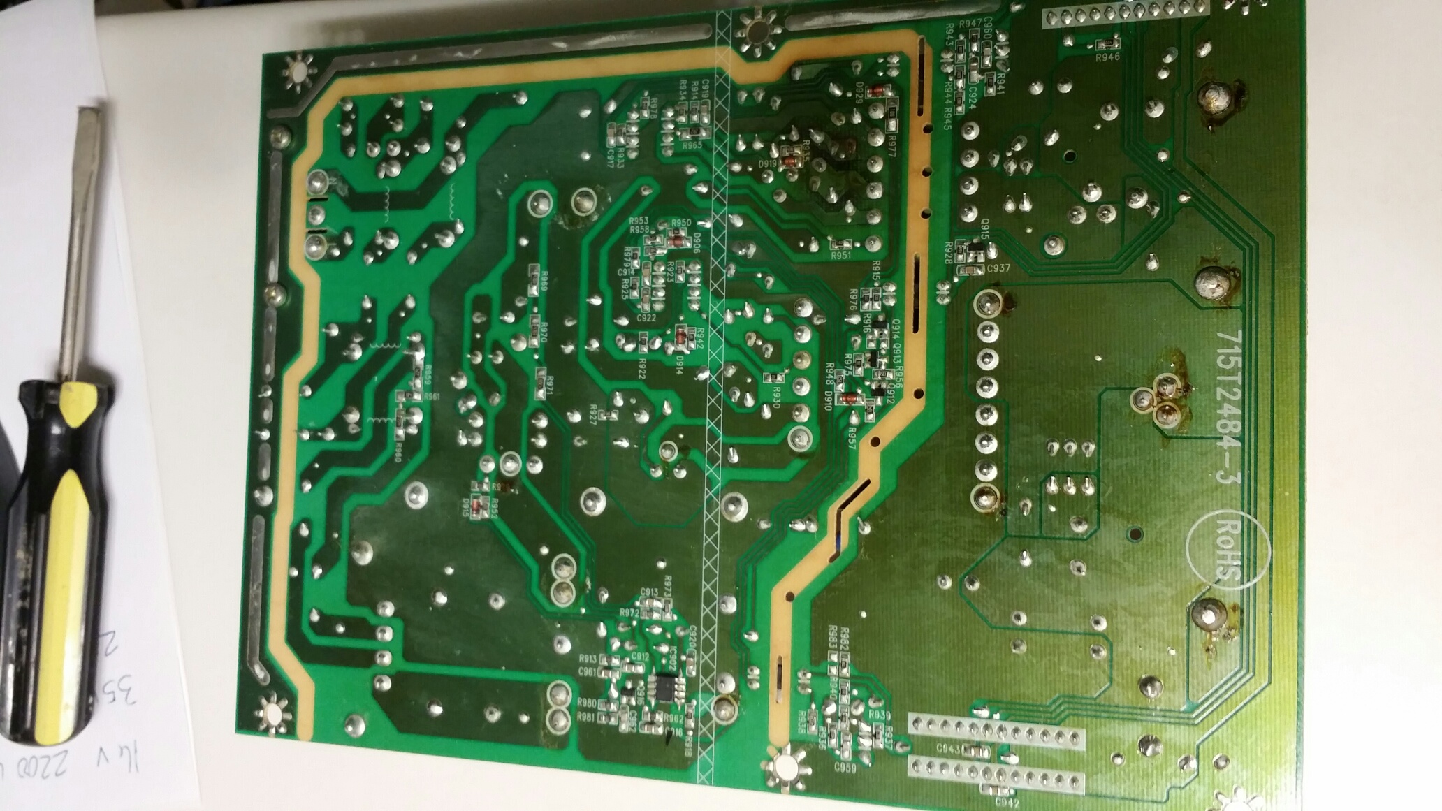

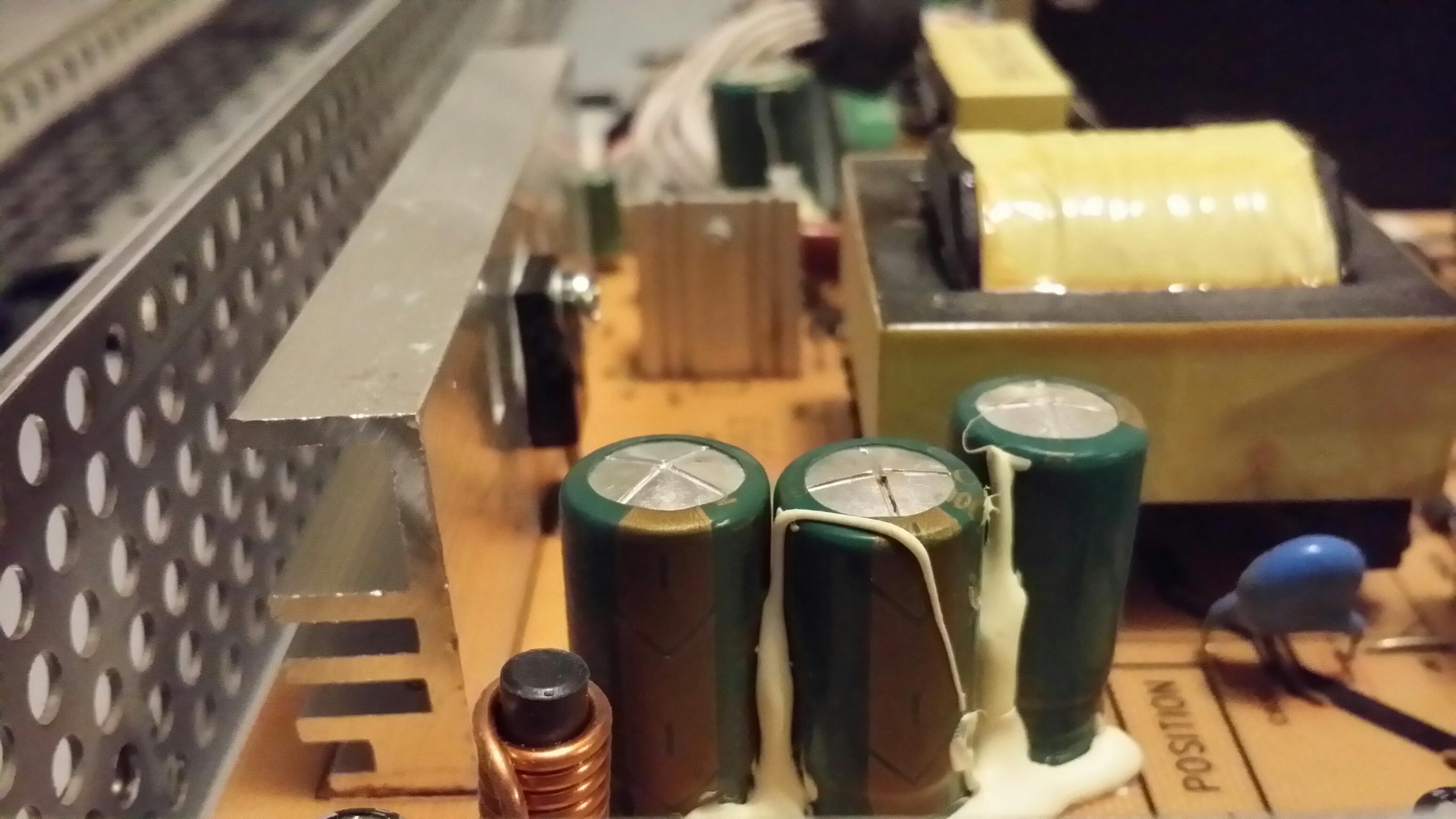

I just got this TV it works but it takes several times of turning the tv on for it to turn on and work. I have taken pictures of the power supply. looks like there is some issues a few burned spots. and several capacitors are bulging. what all would you replace?

Mine were fine, I didn't have any burnt marks like you have. I would replace everything in that was in or around and could be affected by the burnt parts.
I don't think a used power board was spendy at all if you ended up needed to replace it.Comment

The blue cap C945, the Zener ZD906 (typical P6KEXXX around 200V rating), and the Diode D924 are part of the snubber network to reduce the spike to help protect that MOSFET Q908. You need to test them all.Last edited by budm; 05-21-2014, 10:21 AM.Never stop learning

I picked up the TV lastnight. The tv turns on but take several try's before it will actually turn on. so I figured something was wrong. I will test the parts when I get home tonight. I figured I would just replace all in the black area just to be safe.Comment

Since you are still getting the standby voltage, that STBY is still working kind off with those over heated parts, so replace the caps on the power supply board as a set, not just the domed top ones, the large main cap is probably OK.Last edited by budm; 05-21-2014, 04:46 PM.Never stop learning

So what is the P/N of that Zener ZD906?Never stop learning

for ZD906 I used P4KE250A-E3 I tested all the parts as I removed them. all of the diodes even though they were black char tested good. I replaced them anyway. the one 16v 2200uf cap was completely open as well as two 25v 47uf were also completely open. I replaced the three 35v 1000 uf as they were very swollen. The good news is the TV works great now. turns on every time and has a beautiful picture. thanks so much for your help.Comment
