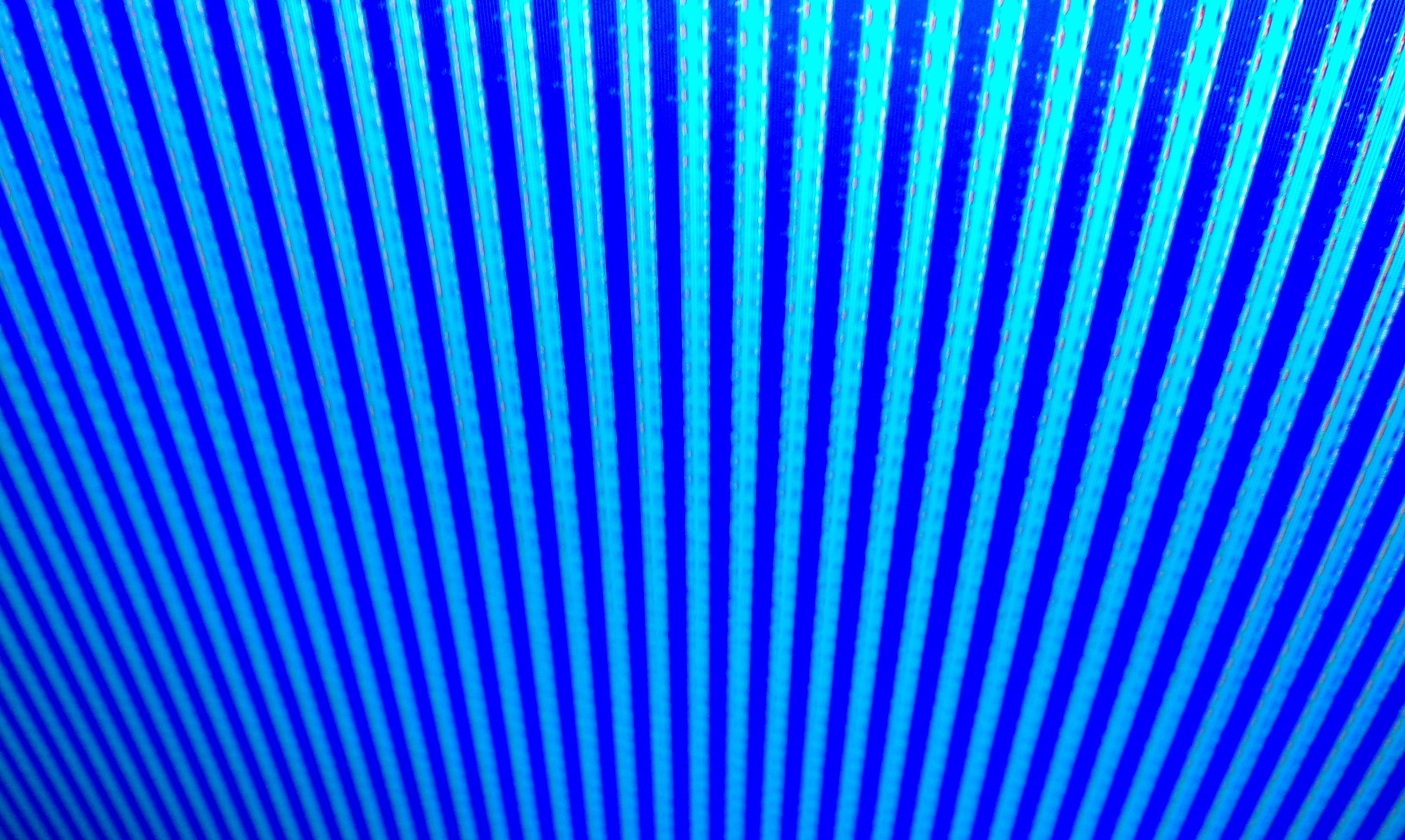

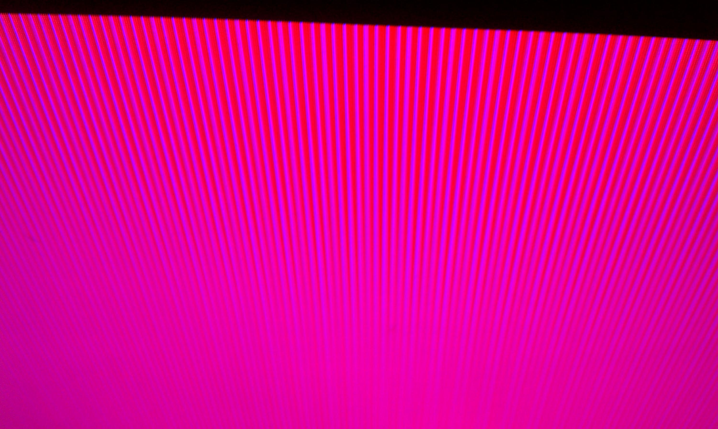

    ugh...now i cant get it to display normal even for a moment...
    heres what im getting on screen:
    please advise!
    Don't fear the repair...
      #62
      Re: MAXENT MX26X3 L2614XW02L no standby light, no power on
      Well, that shows the same display as the one I did not fix, I was able to push on the heatsink to make the problem comes on goes, that is what I found on mine. I did not the hot air work station at that time to experiment with.
        #63
        yeah pressing on my heatsink does nothing...how hard are we talking about pressing here?
          #64
          oh nice...now pressing on the heatsink does work. ok so that is totally the problem, not overheating. but i dont have a reflow station... is there any acceptable "poor man's way" ?

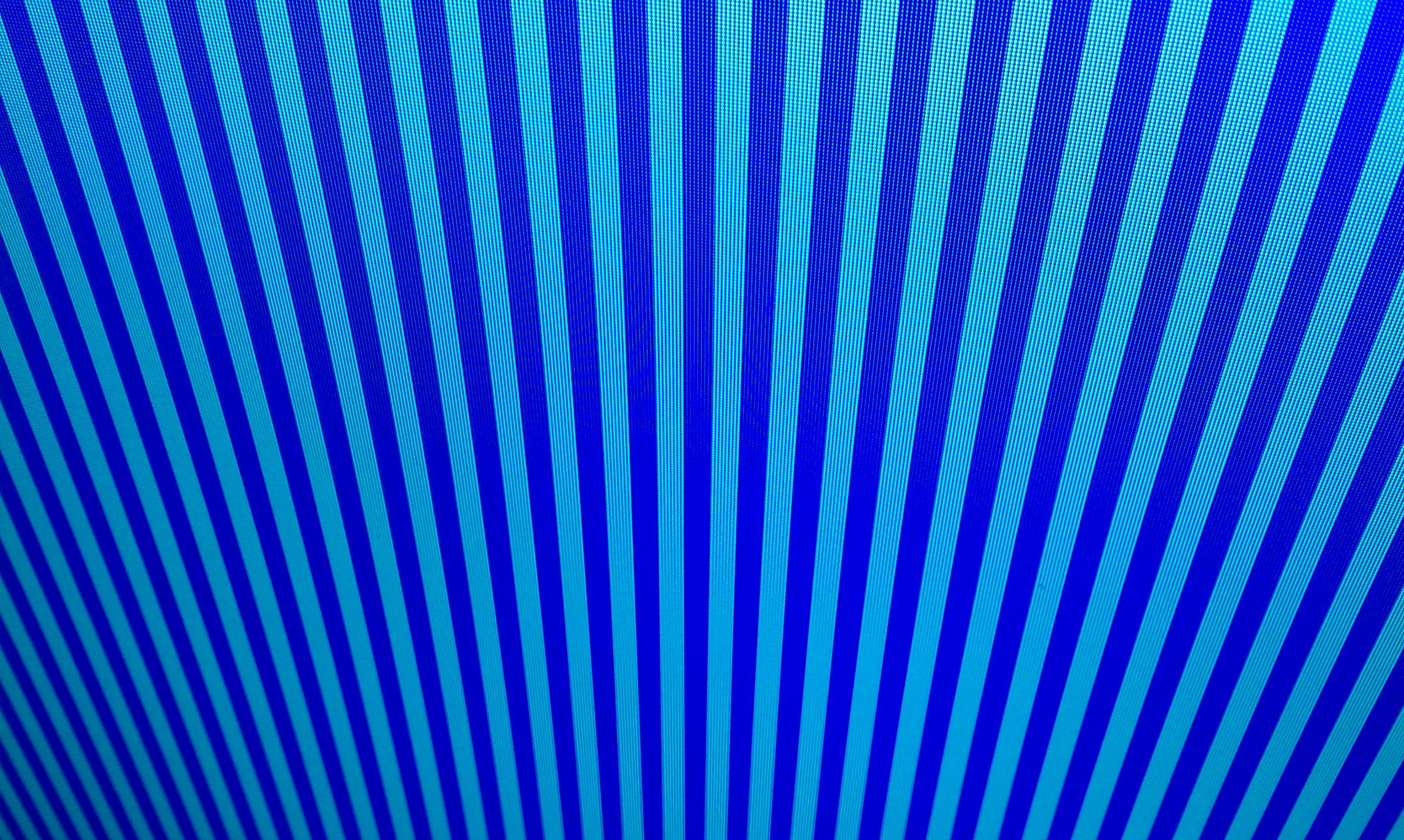

            pressing on the chip only barely works and i think its getting worse from it...when i can get a clear picture theres still a little "snow" dang i have 2 motherboards with different problems.... if only i could combine them somehow then i would have a working motherboard!
