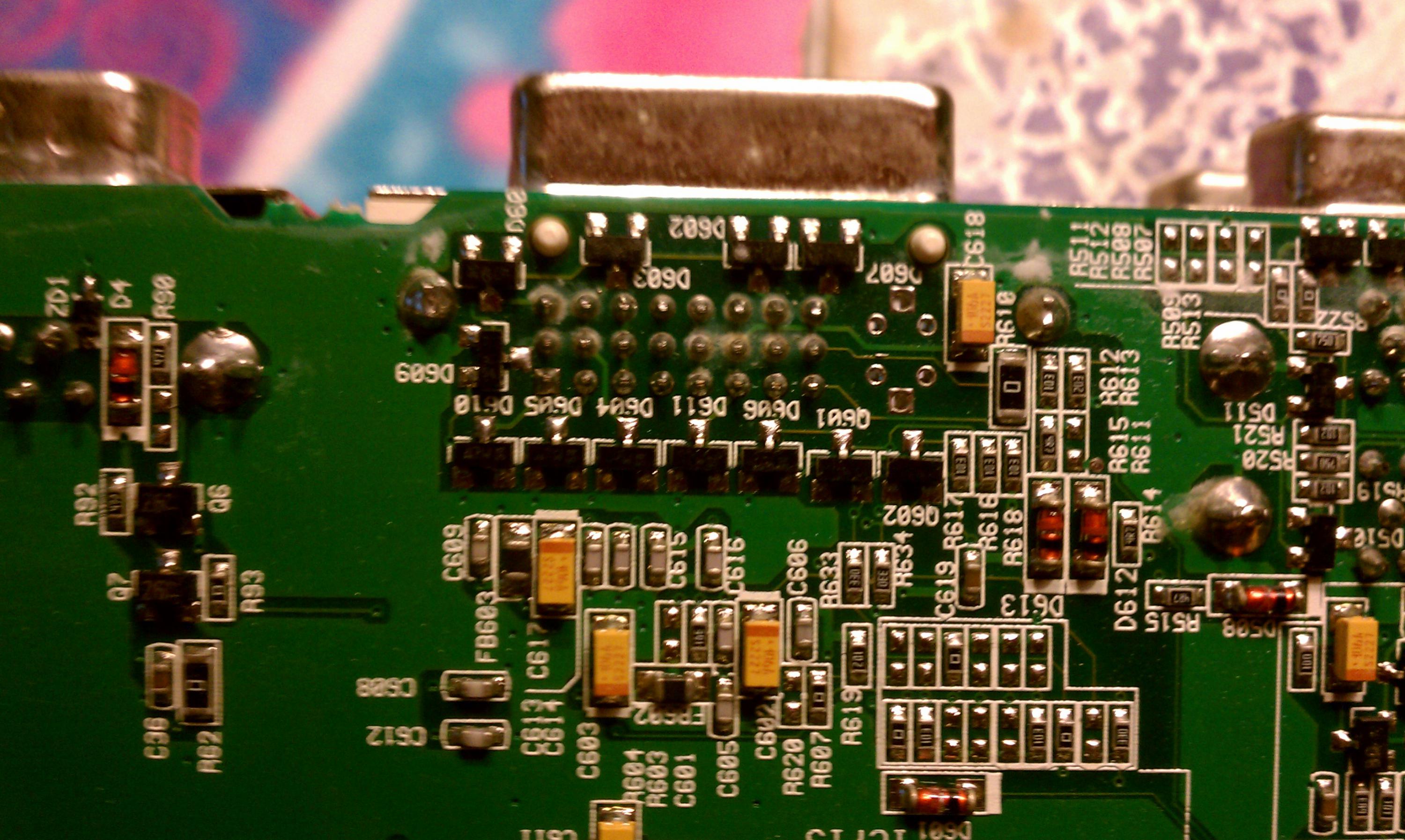

                                    i see some...corrosion? idk even what to call it but the solder looks cloudy on the VGA connectors... what is that and should i try to clean it up?
