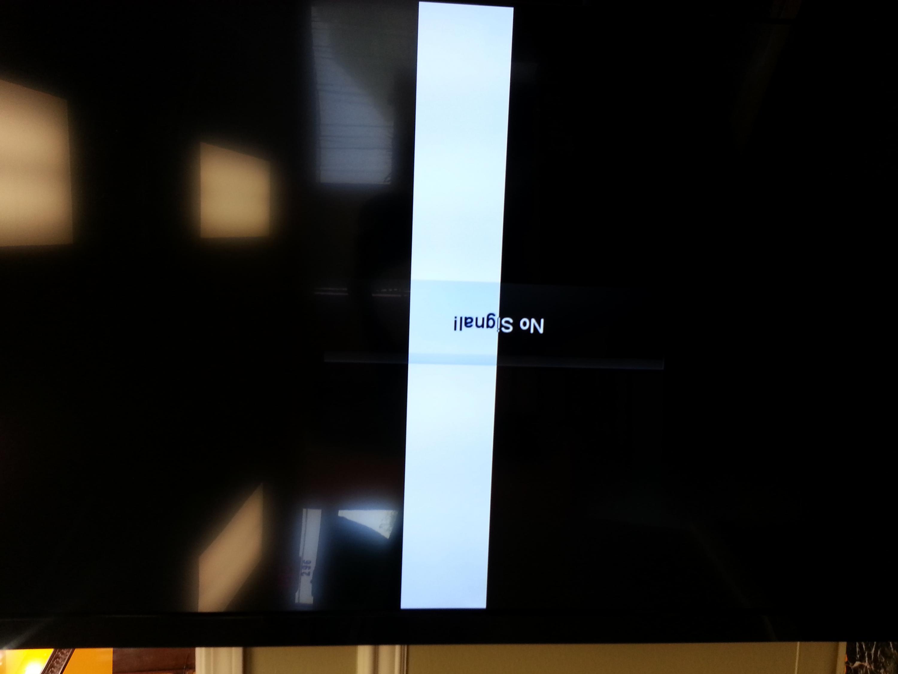

    VIZIO M650VSE Vertical Inverted Band
    First post so I have a Vizio that has a vertical inverted band from the centerline to the right about 4 inches across. By inverted I mean black pixels are white and white pixels are black. I replaced the TCON board and checked the tabs by turning on the TV with the bezel off but the white line never goes away.
  • Glitcher
    • Mar 2013
    • 673
    • USa
    Re: VIZIO M650VSE Vertical Inverted Band
    bad panel
      Agreed looks like a dead panel to me too.
