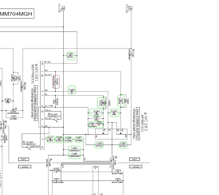

    Panasonic TH-50PZ80U 2/10 blink
    I worked on this set about 8 months ago it had 7 blinks and ended up having a shorted buffer and ysus. It came back a couple days ago with 10 blinks, as I started troubleshooting I switched out the mc module caps thinking that would do the trick. It ended up instead being bad mosfets for the Vsus supply. I confirmed by robbing the 2 16N55G mosfets from another power board, My question is this, is there a compatible replacement for this mosfet? I struck out on datasheet. I found some on ebay but was hoping to get this up and running a bit quicker than the week it normally takes to get parts here. Does anyone have the basic specs for this mosfet or am I condemned to wait a week on shipping?

    Re: Panasonic TH-50PZ80U 2/10 blink
    generally the first figure is current, 2nd is volts. So something => 16amp, => 550v, N channel
      Well thats extremely good to know, however I dont have any 16 amp mosfets in my parts bin. So I guess I will have to wait anyhow. Has anyone tried replacing these before? they seem to be epoxied to the heatsink plate. I guess I will tap some threads in and drill out a hole on the big plate to fit.
        Well, I got my new replacement mosfets in and they lasted less than a minute. Not sure if they were defective I tried a pair of 12 amp mosfets off a samsung power board. they lasted about two minutes. According to the schematic the mc301 module drives these is it possible the tea1611t chip is defective and killing my mosfets?
        BTW those originals are very well epoxied to the heatsink, I had to use a grinder to get them off.
              I was having a look at SJ and noticed in their PSU kit for these they have the 2 FETS, the TEA1611T chips and the tiny caps.
              You may have a point about the modules killing the FETs.
                Well I finally got my new TEA1611T chips in yesterday, soldered them in along with a new set of mosfets and fuse and it worked...for less than a minute. I even added extra heatsinking to the tab of the ic thinking it may have been getting too hot. Apparently Ive got something else majorly wrong in the power supply. Anyone have any ideas, I guess Im to the point I will have to test every single component in that section to see if I can find one out of spec.
                    It stayed on no signal then promptly died when I switched input and snow appeared. Yes all heatsinks were attached and all screws in place.
                    I was thinking maybe one of those electrolytic is breaking down under voltage and shorting the circuit out. Not much else in the secondary side capable of taking that much juice into a short without smoking.
                            Worth checking all the components in the voltage supply to the MC board, and in the gate circuits of both fets..
                            IF the main 15v? supply to that board is low--the MOSFETS wont switch on hard and can overheat/destroy themselves pretty quick...
                              Well we might have a culprit... in testing all the components again tonight I found a leaky zener diode (zd201) connected between drain of one fet and gate of secondary fet, reading at 150 ohms both directions, However I cannot seem to find a datasheet for this little diode (MA4270NMTA) Im guessing its a 27v 1/6 watt but would like to have confirmation before I blow another 7$ in fets. I pulled and tested all the polycaps and they are within spec. I also replaced r204 and r203 as the corners were chipped up a bit both were very close to the 330k spec. Adding in a schematic below, all green circles testing good with red around bad zener. Do you guys think this could be the only fault or do I need to keep searching before I try it again?
                                Tw2005 gave me a link with a possible correlation with that zener as being a 27v, I've fitted one but thought I would ask one more time before I hit the switch and possibly blow my last set of FETs.
                                      I would say 20V would be reasonable for that zener. The TEA driver IC operates 12V and drives the FETs with about 12V, so 20V should be ok for a protection device.
