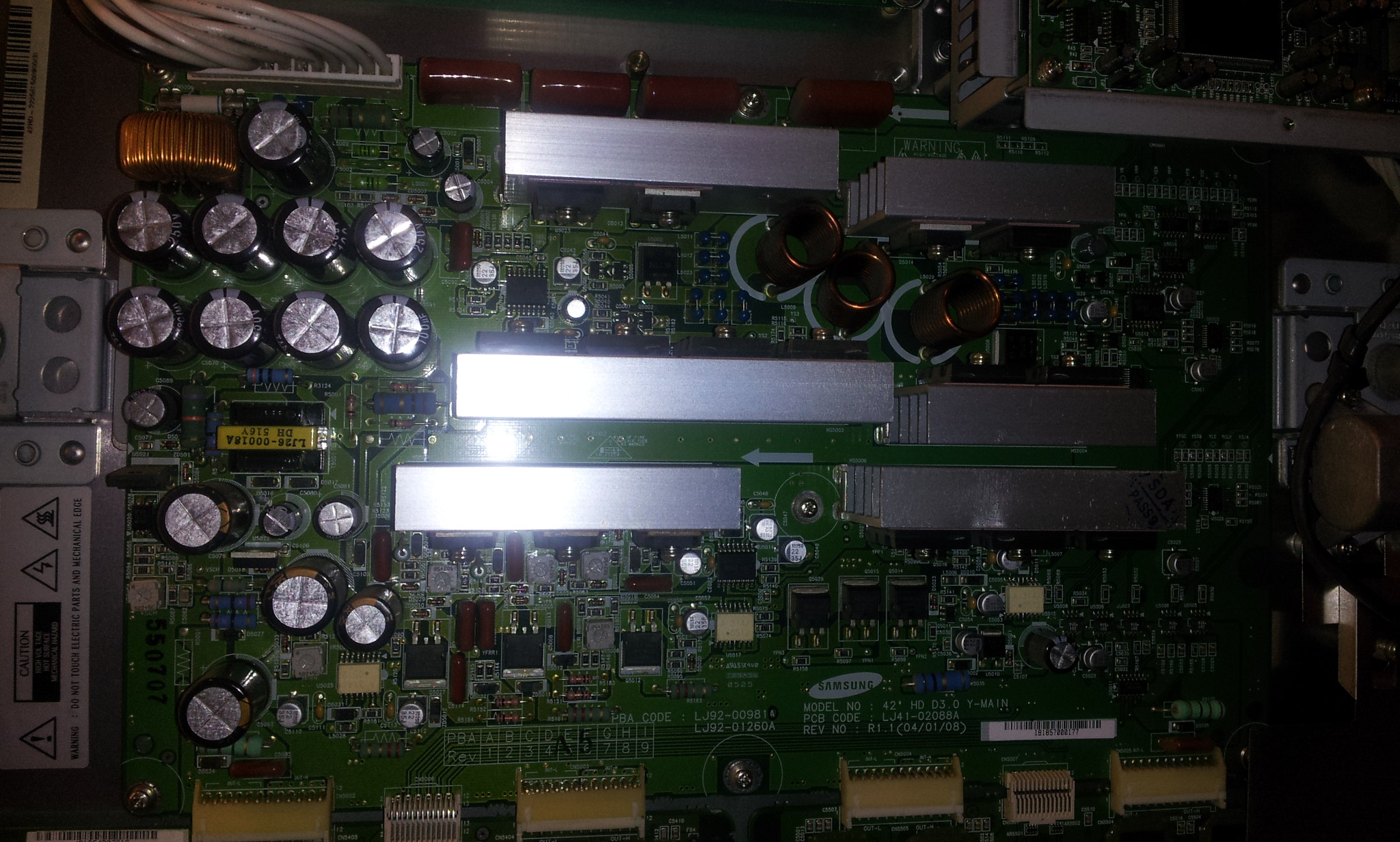

    Dell W4200HD
    Set has a good picture and sound but there is a occasional flicker in the piture. I measuredthe Ysus and it is steady. Everything looks good. I can not find any kind if a schematic or service manual. The blink is fast don't know if it has to do with the scan boards or power or main board. I hate to return it to them with it not solved. Do I give it back to them and tell them to wait untill it just dies? Advice? Help?

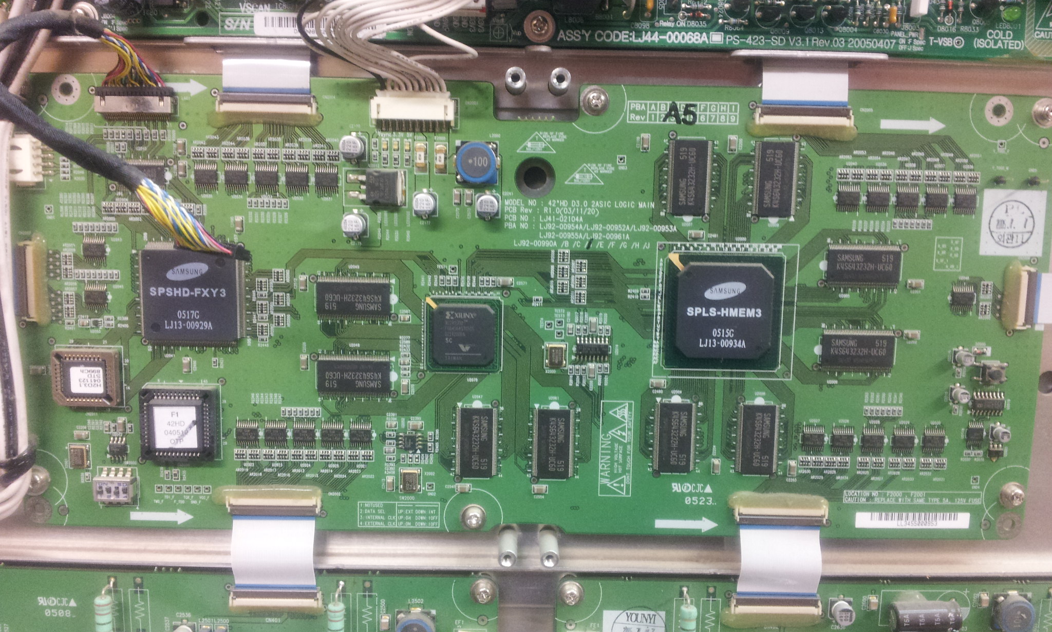

            Re: Dell W4200HD
            Tested all voltages while flickering was visable on screen using Fluke 87 meter
            Va, Vcc, Ve, Vs and Vset were stable with .4vdc with slight variations.
            The Control board LJ92-00990A did have a Led blinking for the Vsync. was on steady on. Shop Jimmy does not have it they have a later version
            LJ92-00990D would it work in its place?
            With a Vsync led blinking, what would be the cause? Sync coming in? Sync going out? Sync in the board?
            Thanks Guys

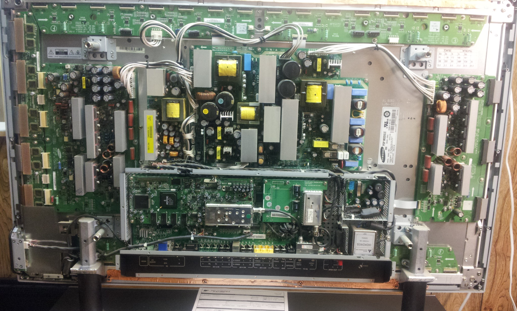

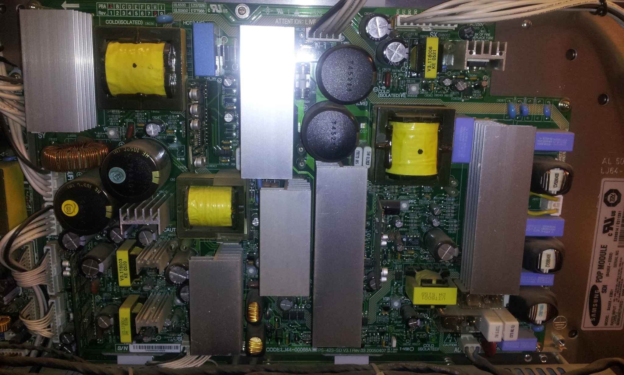

              Re: Dell W4200HD
              Pic of Board
                • 31094
                Re: Dell W4200HD
                omfg!
                that thing was designed by a crack addict!
                i hope it has some fans on the case!!!
                • Ltank
                  • Jun 2013
                  • 776
                  Re: Dell W4200HD
                  Not a single fan, only heat sinks!
