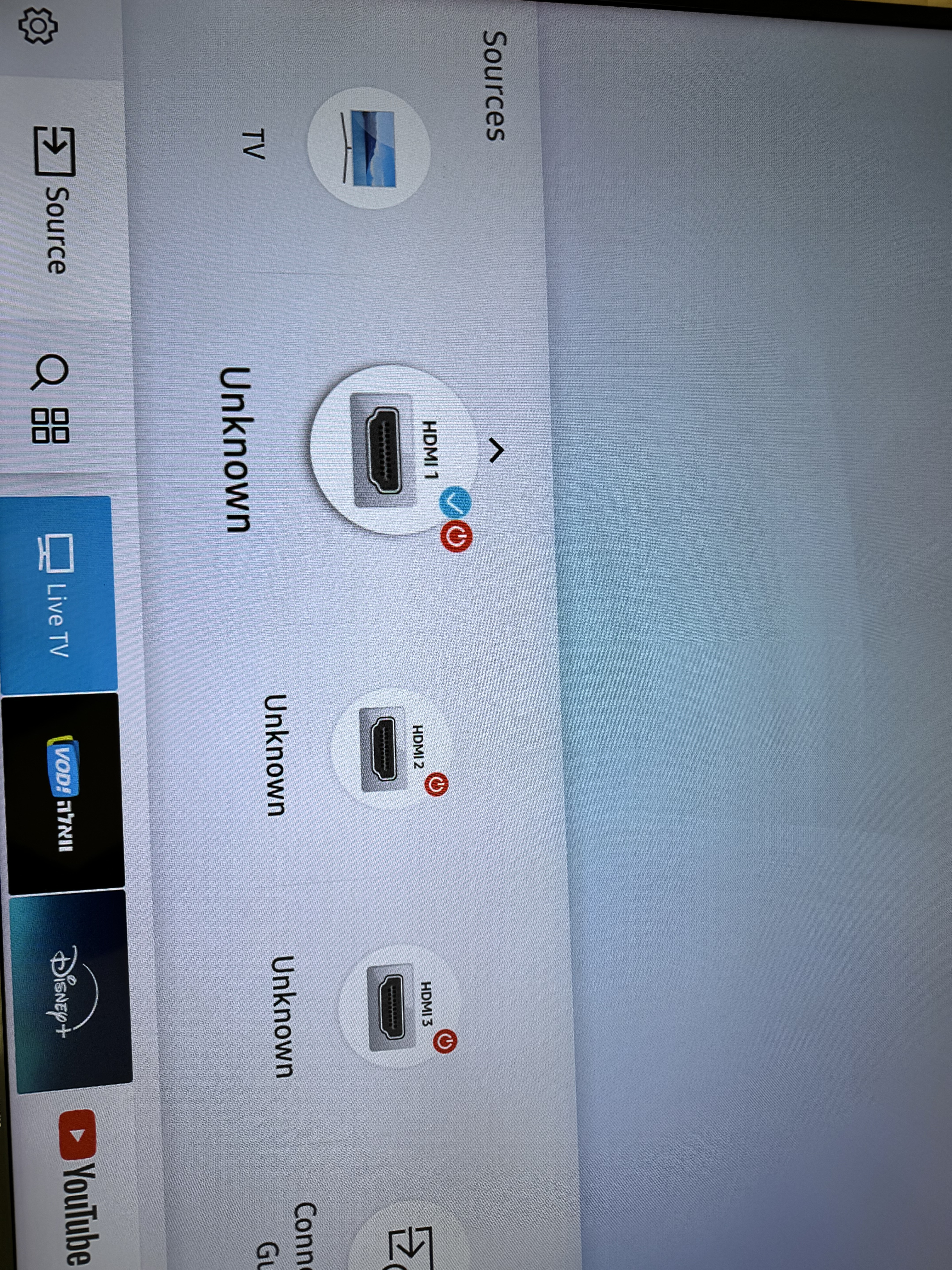

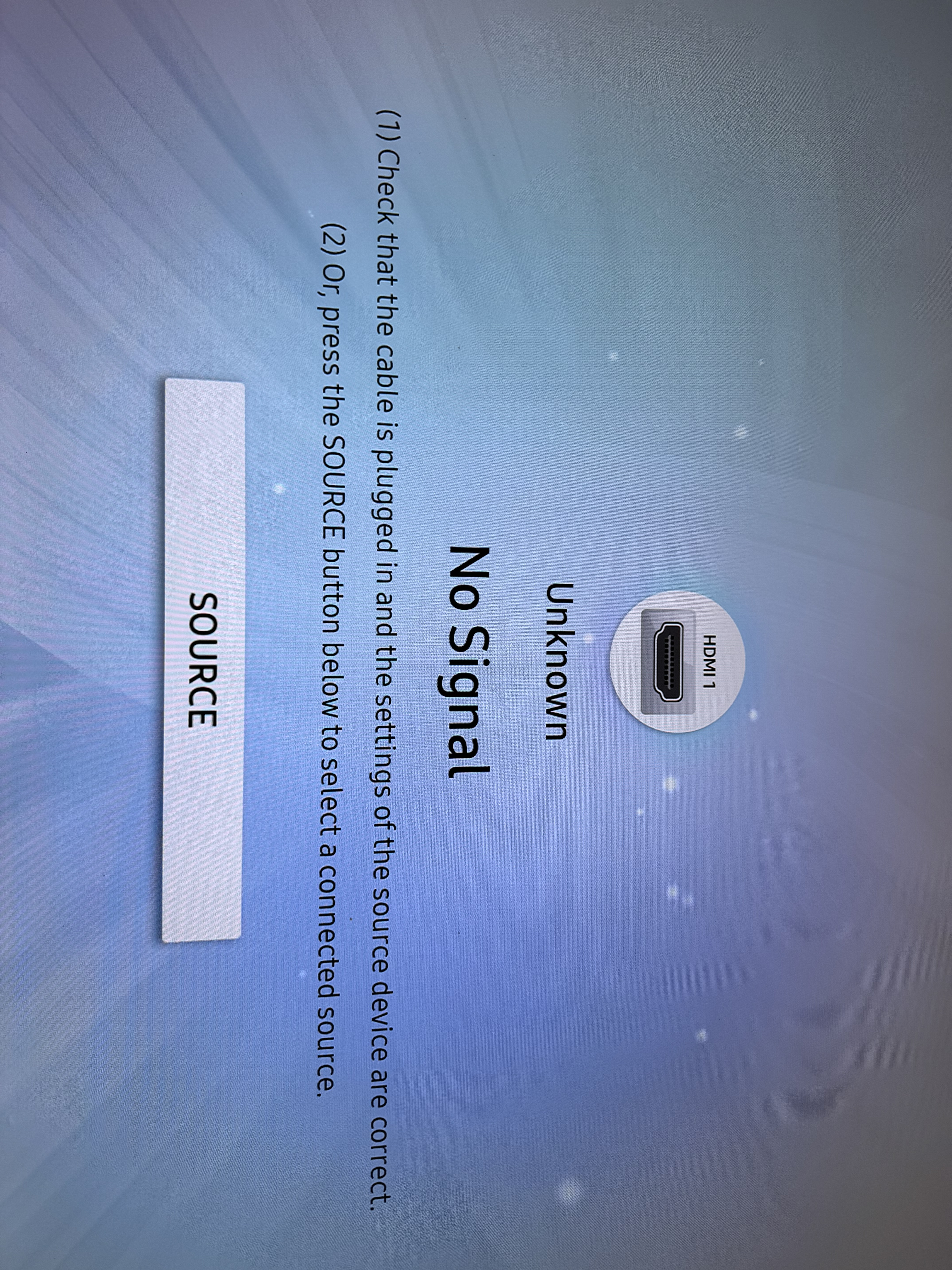

    Yes the same behavior on the new board.
    To clarify the issue, this is how it looks, no matter the port (1,2,3), the tv does not recognize a device is connected.

        Do you get to another similar screen "Device Detected" and want's you to do a manual setup?
        I would definitely try a different HDMI cable like a 4k cable. Depending what you use as an HDMI source, change the picture format, like size and frequency (Hz).

          Davi.p Yes I tried removed the "fail count" pin from the connector, it didn't help. I also tried disconnecting the backlight from the psu, didn't help as well (checked with a flashlight).
          The power surge was due a lightning. It fried a sat/dvb-t receiver that was connected.
          CapLeaker I tried a couple of them, they all fail on this TV. They work on others of course. I don't get any other screen - its not detecting any thing.

                    To close the loop here - I did try everything on the two boards that I had (factory reset, etc.).
                    Got a new power supply from ebay - still no signal on HDMI with two of the boards.
                    After getting a new board from Aliexpress (together with the new PSU, didn't bother to check the old one) - HDMI works as expected
                    Thanks all.
