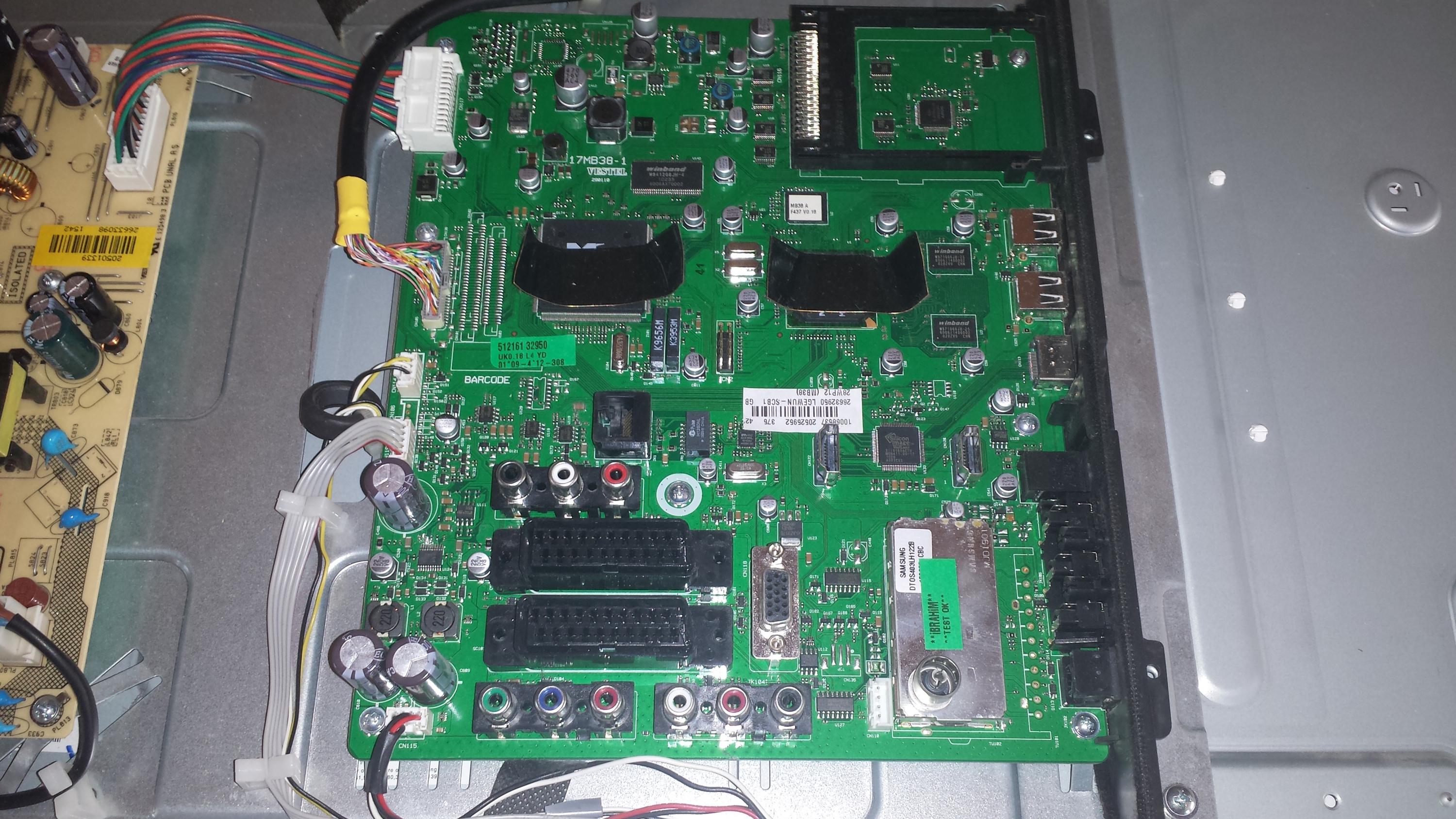

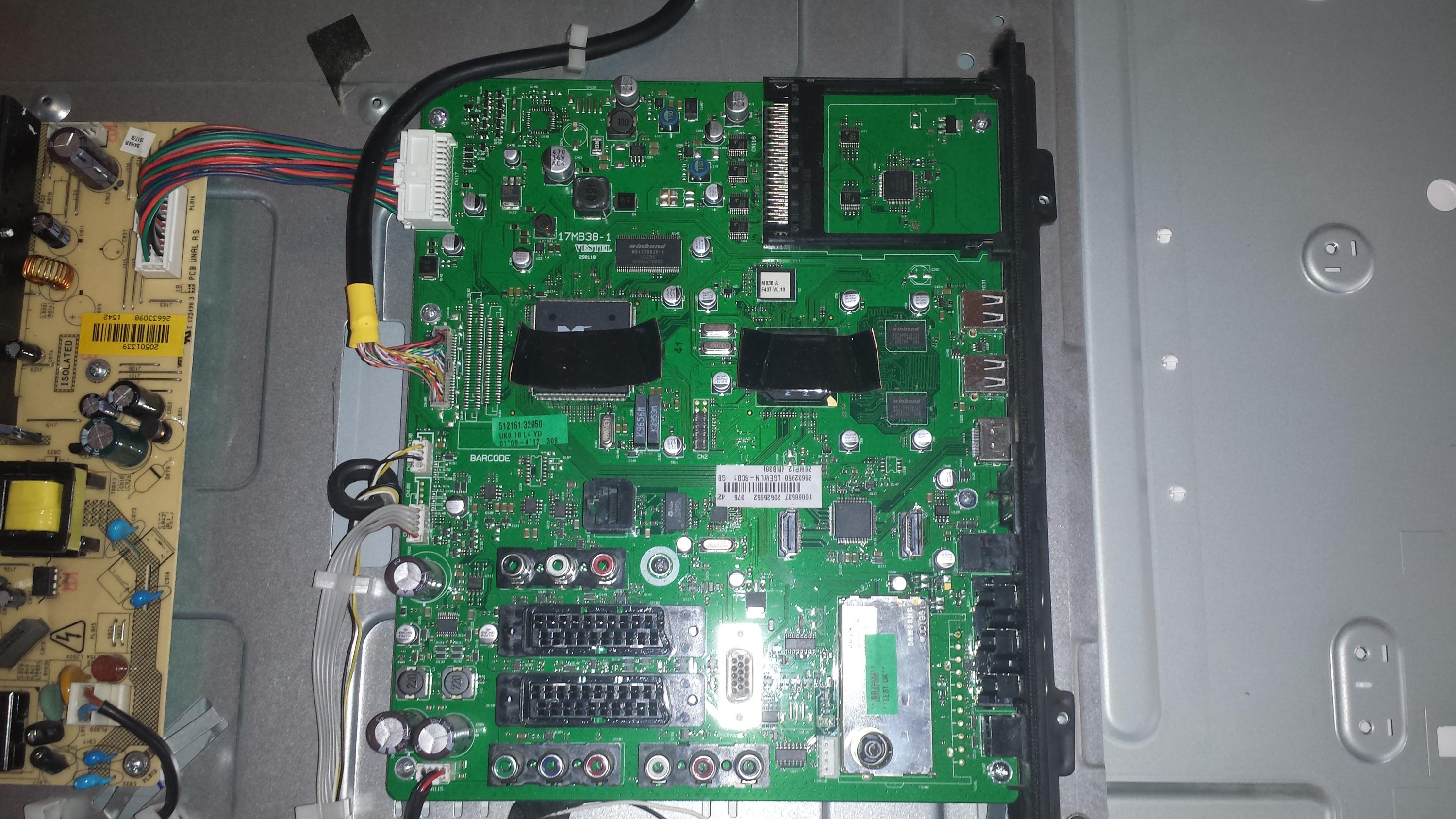

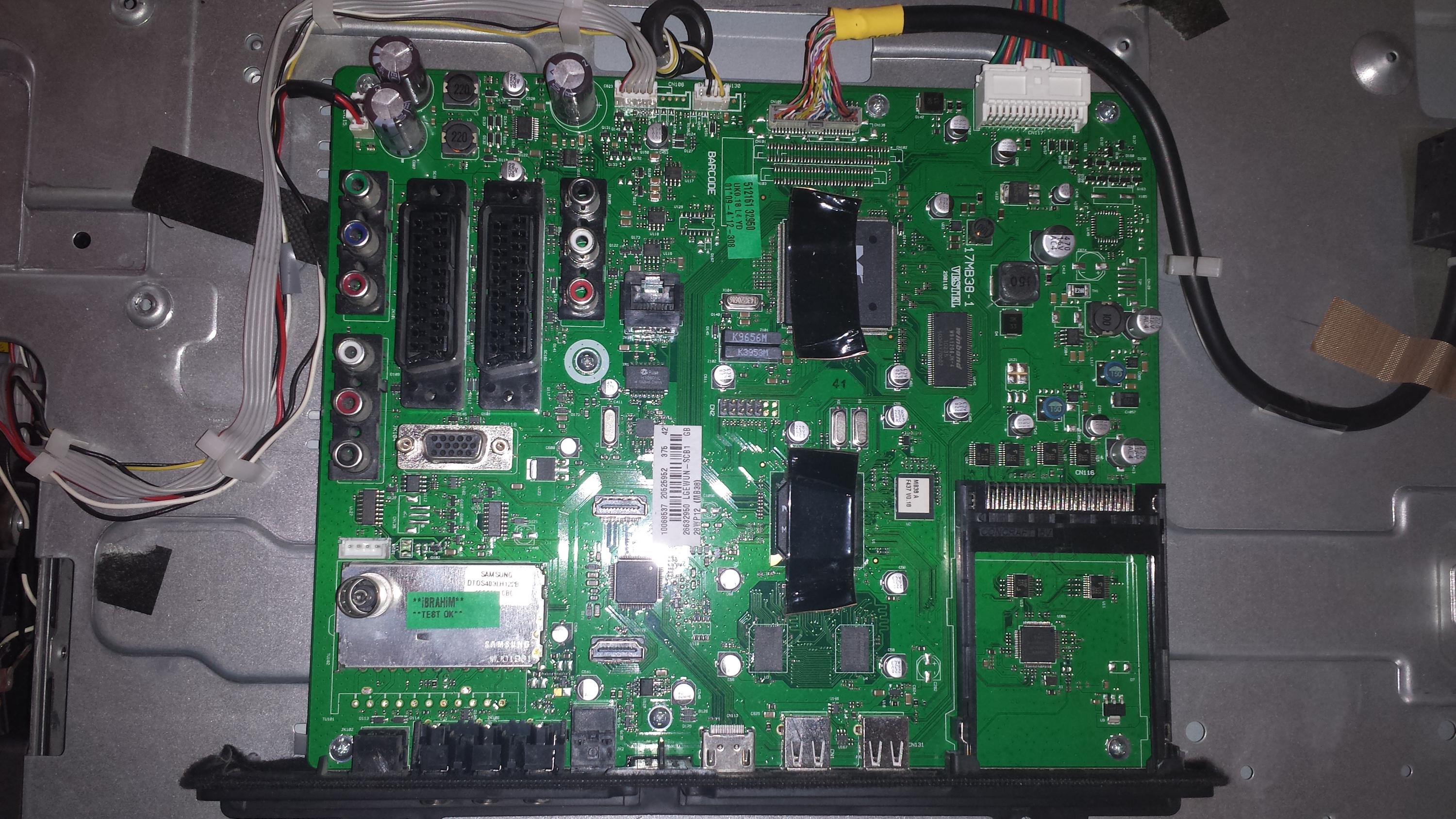

                        Can you supply a picture of it? I'm a little busy now will be free for a detailed look, after about 5pm.
                          #52
                          Re: technika 42-2030
                          pictures attached main board number 17MB38-1 and thanks tom

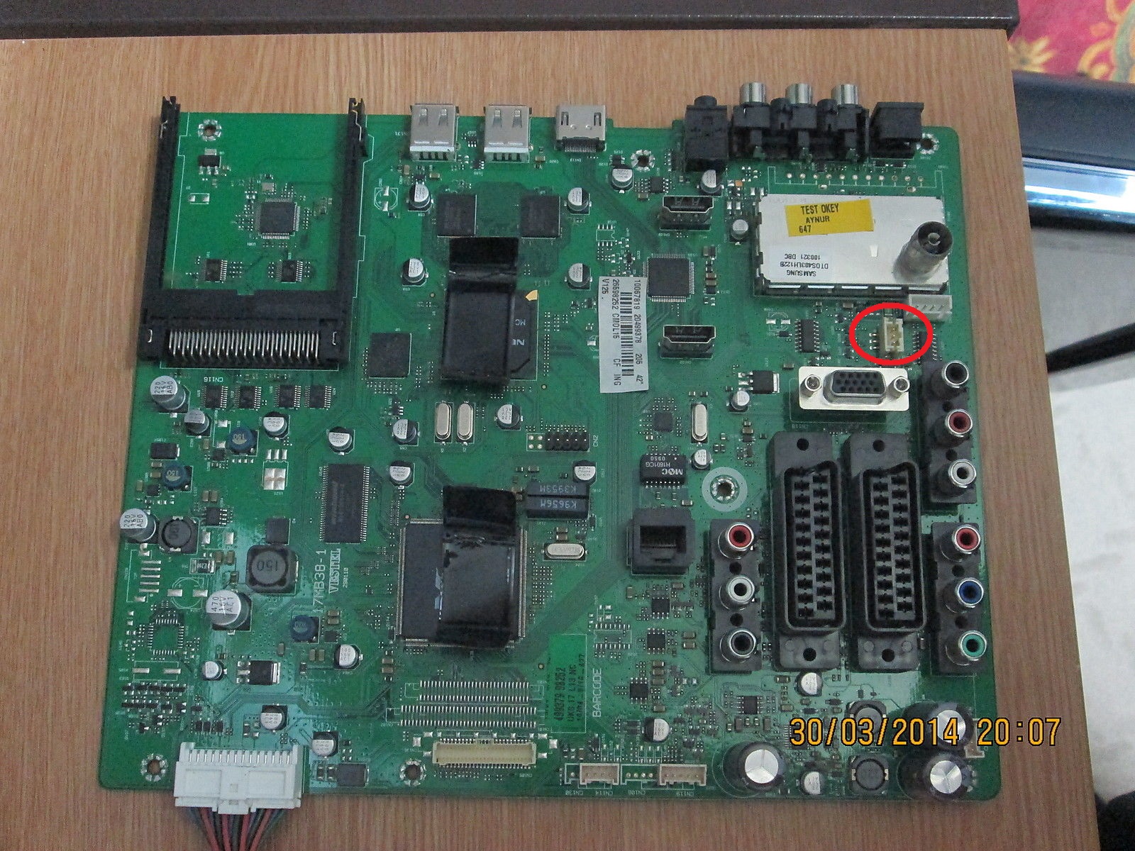

                            #53
                            ive found a board i can order if i need it Sharp LC-42CT2E main board the only thing different is the red circle ive highlighted in the picture all other connections match up im hoping it will work if i order it
                              #54
                              Hi tom I've found another board for the same tv ill let u know how I get on

                                    #57
                                    Ok just updating the thread replacement board arrived working ok now ...... fingers crossed
