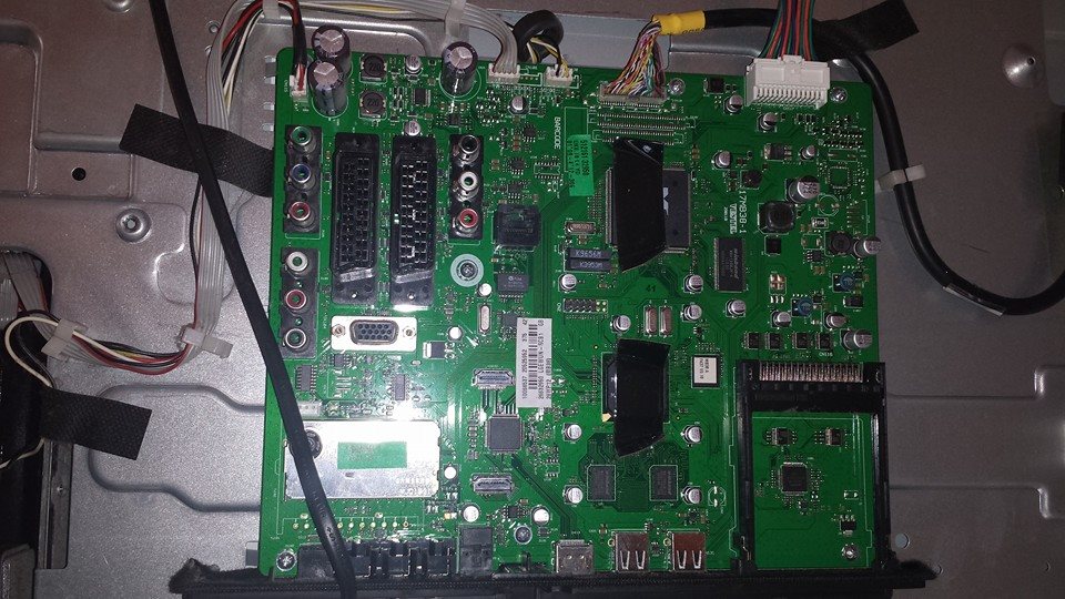

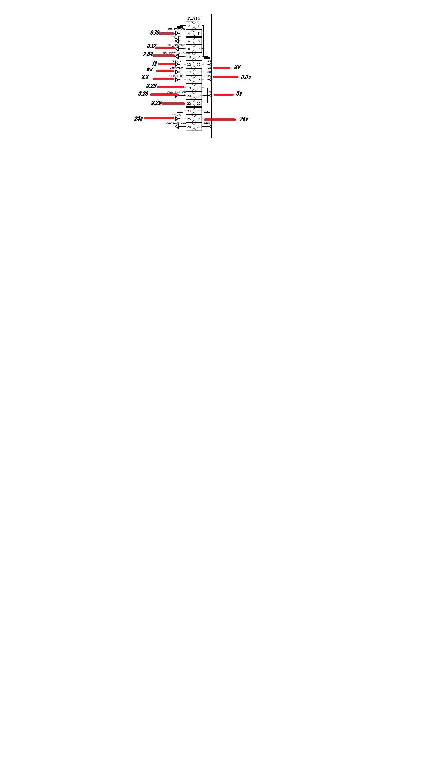

      ok i now have backlight after removing tcon to check fuse but now have a orange standby light but still no picture ive attached the voltages im getting
      thanks for the reply flocko the main board is 17MB38-1 290110

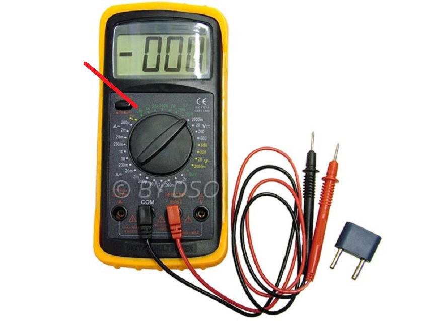

            im not sure if i have 2000ohms on my meter ?
              Re: technika 42-2030
              What range do you use to test fuses with power off? Use that.
                i used the 200 ohm range to test the fuse unless i done this wrong
                    OK, looks like on yours it is marked 2K, so use that.
