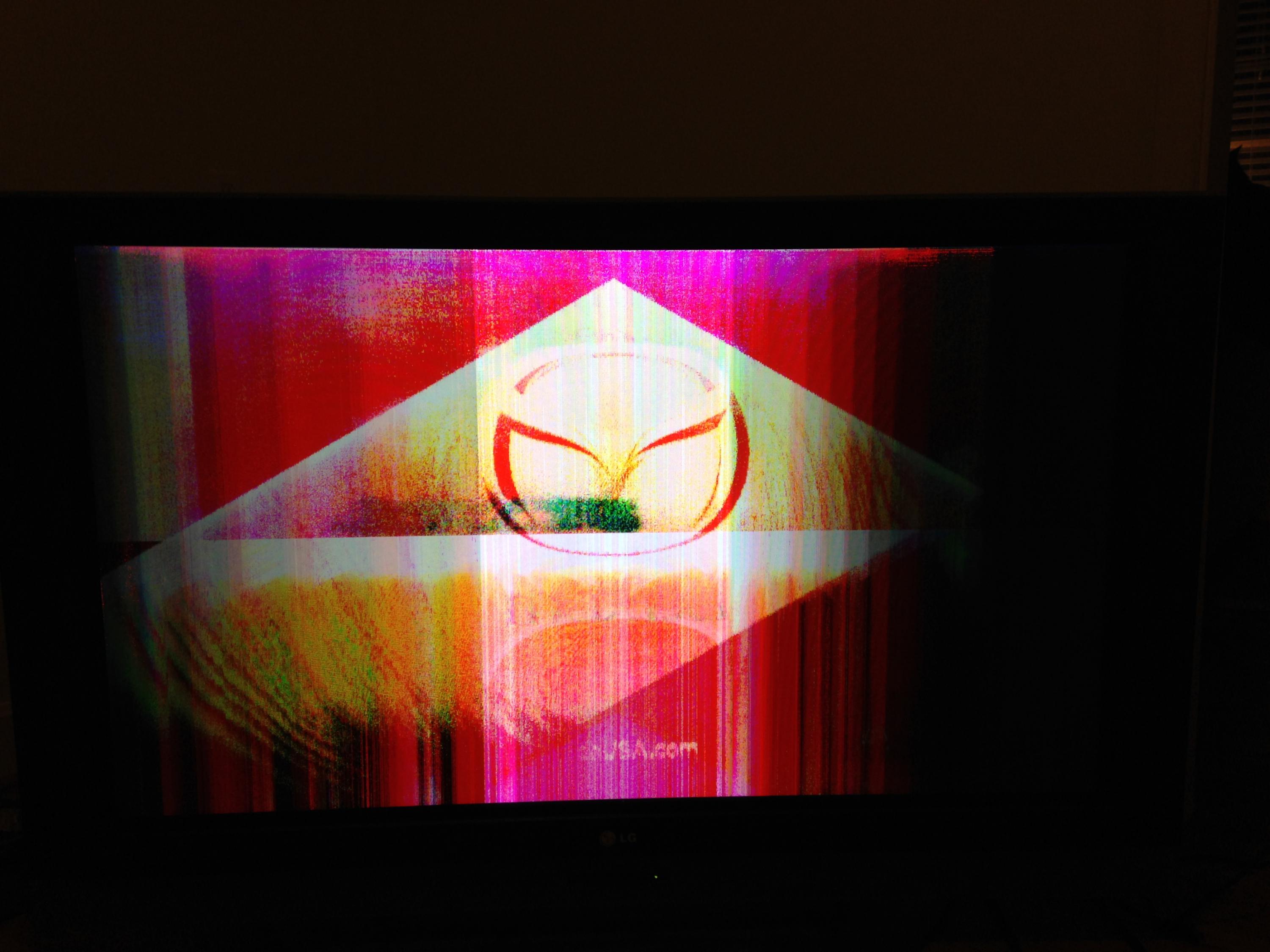

    Hello! I recently came across this TV and decided to get my hands dirty and see what it takes to fix it while learning more about plasma tv's in the process.
    So far I've learned a ton and mostly from these forums, so thanks in advance!
    It's an LG 50pc3d UD
    I have replaced the YSUS and both YDRV / Y-buffers.
    Was a bit bummed out when I replaced the buffers, there was no change at all. They were only $21 a piece so I'm not too burnt.
    Attached is where I'm currently at, and I'm pretty baffled at this point. Pink lines, split screen.
    There is audio and clearly a picture behind it. I've tested antenna and hdmi with the same results.
    Inspected all caps etc, no visible damage or issues there.
    I'm wondering if it's loose or bad connections?
    Everything else seems to be functioning but as my username states, I am not a pro in this field.
    Any ideas? I appreciate any help I can get!

    I'd say logic board but let Tom66 chime in,he's the pro at plasmas.....

      I was thinking the same thing.

        Well if it's only a $30 part, I might just try that board as well. I'll see if anyone else agrees or has other ideas and order it Monday probably. THanks!

              Y-sus Vsc voltage bad would be a guess; have you tried checking the Vsc and -Vy compared to panel rating? I think the control/logic is OK for now.

                I have not, but I just replaced the YSUS last week. I got it off ebay.
                Could you give me any more info on how to test this?

                      OK in your case Vscan tested across top and middle metal plates where the buffers connect - should be around 150V.

                          The metal plates sticking out of the Y-sus connecting to the buffers, do you see them?

                            Yup, there are 3 of them correct?
                            The "top" referring to when its installed I assume?
                            Sorry, my electrical experience is very little. I do have a buddy who is pretty knowledgable about these things though.
                            If you could give me an idea of what tool I need and basic steps to test it I would appreciate it!

                                    What's your -vy voltage doing. Fluctuating perhaps?
