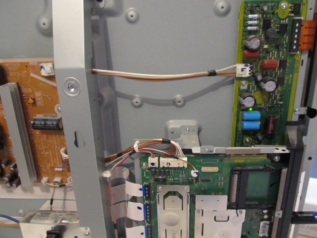

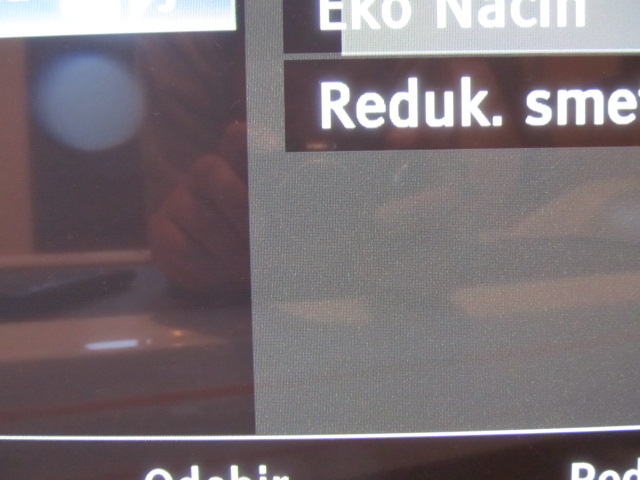

    Hi
    Bought this set, it had 7 blinks, SN board shorted. Replaced 4 30F131 (altough just 3 were dead) and that removed short from SN2. Powered it on and it came on for a second or two, dark/gray picture with some black horizontal stripes appeared. That changed SOS to 6 (discharging). Investigated a bit more and found Q441 (DG302) that measures around 400 ohms between 2 legs. I assumed that isn't quite normal, and it seems that was correct, because i replaced it and tv works now. It does turn on, no SOS, almost everything is fine .

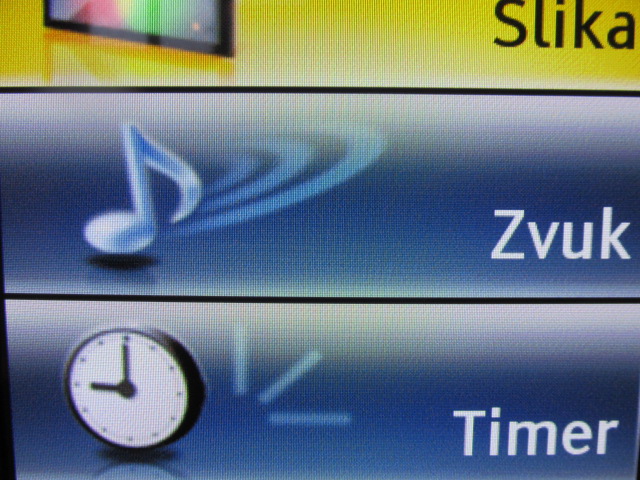

    I noticed that picture isn't quite as it should be, it has red/green sparkles, best noticeable on gray background. On black background i can't see none. And it looks like there is some ghosting, or bad discharge, because when i enter menu, then turn it off (menu, not tv) i can still see some menu.
    When tv is on, led on both SS and SN are green.
    Vsus is 215V, and Vda is 58V. There are trimpots on PS for Vsus and Vda, but didn't mess with them, waiting for some ideas first
    I really don't know if someone was changing some boards before i bought it, but it doesn't look like it is.

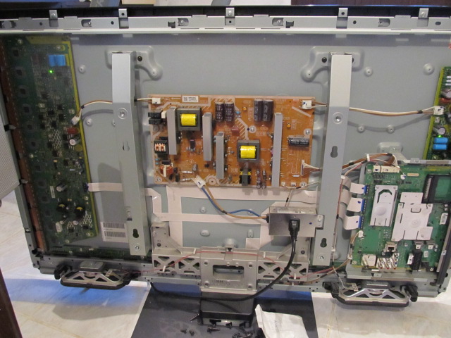

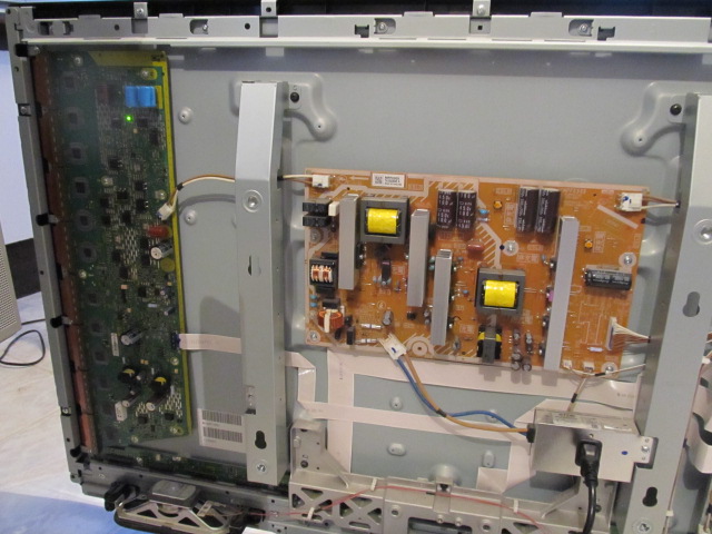

    I don't want to open new thread so i'll post here.
    I have another 42S30, SN board shorted. Changed 4 igbt's (q401, q402, q421, q422 - all 30f131), and it gone short again.
    With sn2 and sn20 disconnected - 8 blink sos.
    Checked SS board for shorts, and it is ok as far as i can tell. I think that i read somwhere that disconnected sn2 and sn20 can also give 8 blink sos, any chance that someone can confirm it.
    I changed again those 4 mosfets altough one of them was ok (q402) plus ic502 and q531, based on repair kits sold on ebay.
    So before i plug it in i want to be sure that ss isn't the one that is killing my sn board. But as long as there isn't short on ss Vsus line i think it could not affect on SN board? Am i right?
    thx!

        Re: Panasonic TX-P42S30 green/red sparkles
        What you are seeing is called plasma dithering and is completely normal. It is due to how the panel is driven. Plasma panels can struggle with low-intensity variations so to compensate they rapidly dither between levels which when viewing from a distance of more than a few feet is hidden and blends into the picture properly.

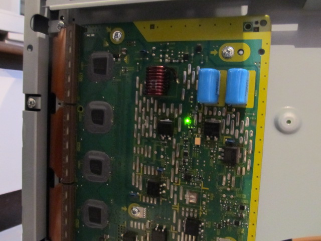

          Well, pluged it in, green blinking light and when panel is about to turn on, pop, shorted q401, q402 and q422. Interestingly, q421 survived - again.

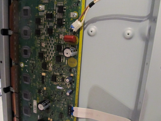

                    Any ideas what can cause this q401 q402 q421 q422 go short to ground? I am trying to debug it, but everything seems ok, altough something obviously isn't.
                    Originally posted by tw2005
                    Also these are the group of parts in cct where it blew those transitors.
                    R522,IC521,R525,R506,C505,Q521,R517,R421,R422,Q421,Q422,D421
                    R501,IC501,C502,R503,C503,Q501,R512,R401,R402,Q401,Q402,D401
                    Tested all of this, once i remove those shorted igbt everything listed looks ok. Anything else can make mess?
                    It's always the same pattern - q401, q402, q422 (or q421 - i am not sure which but one always survive that failure) go short - other stuff looks ok - no obvious shorts.
                    If panel is shorted, is it possible that none of the buffer ic's fail, how to test shorted panel, don't know what else to look

                        OK, to close this one too
                        Replaced blown Q401 Q402 Q421 Q422 (all 30F131). Since i tested all resistors, diodes next logic step to me was to change those drivers for these blown IGBTs. So changed IC501 Q501 and IC521 Q521.
                        Installed SN board, connected buffers and SN20, plugged it in, 7 blinks. Waited for a few minutes so caps can discharge and then plugged SN2. Fingers crossed, pluged it in and it came on
                        Everything works great, and btw i installed those safety washers (don't know how it is said in english ) on all bolts, because there were some arcing marks on few places due to loose bolts.
