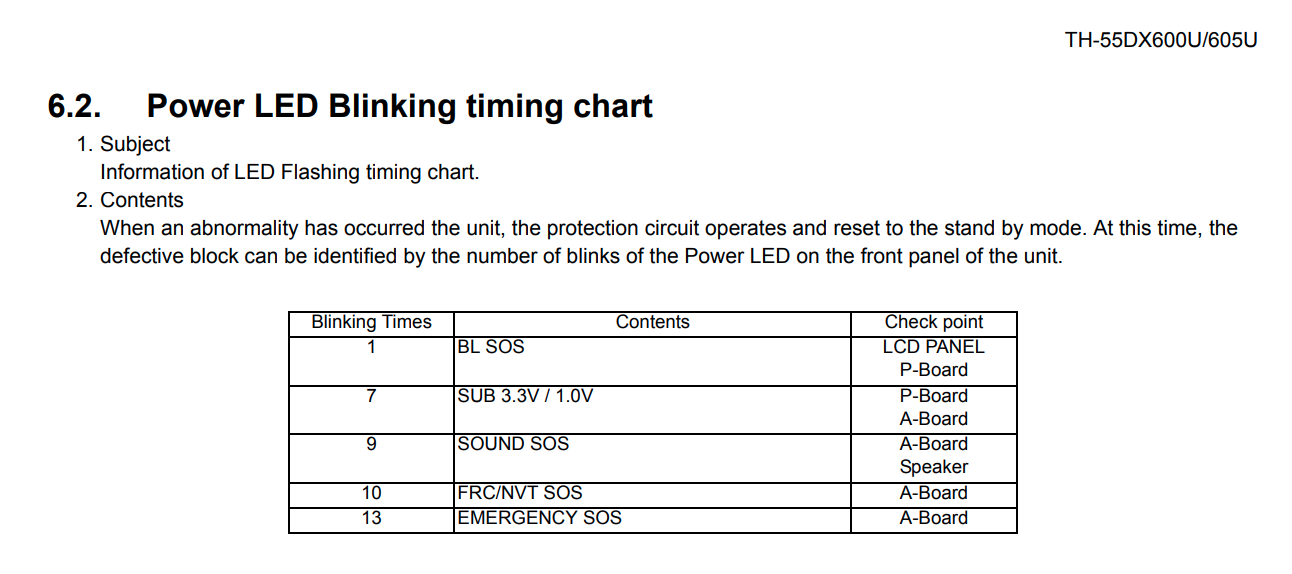

          Re: Panasonic 55DX600u repair help - no display fast green then slow red led flash
          Power LED Blinking timing chart

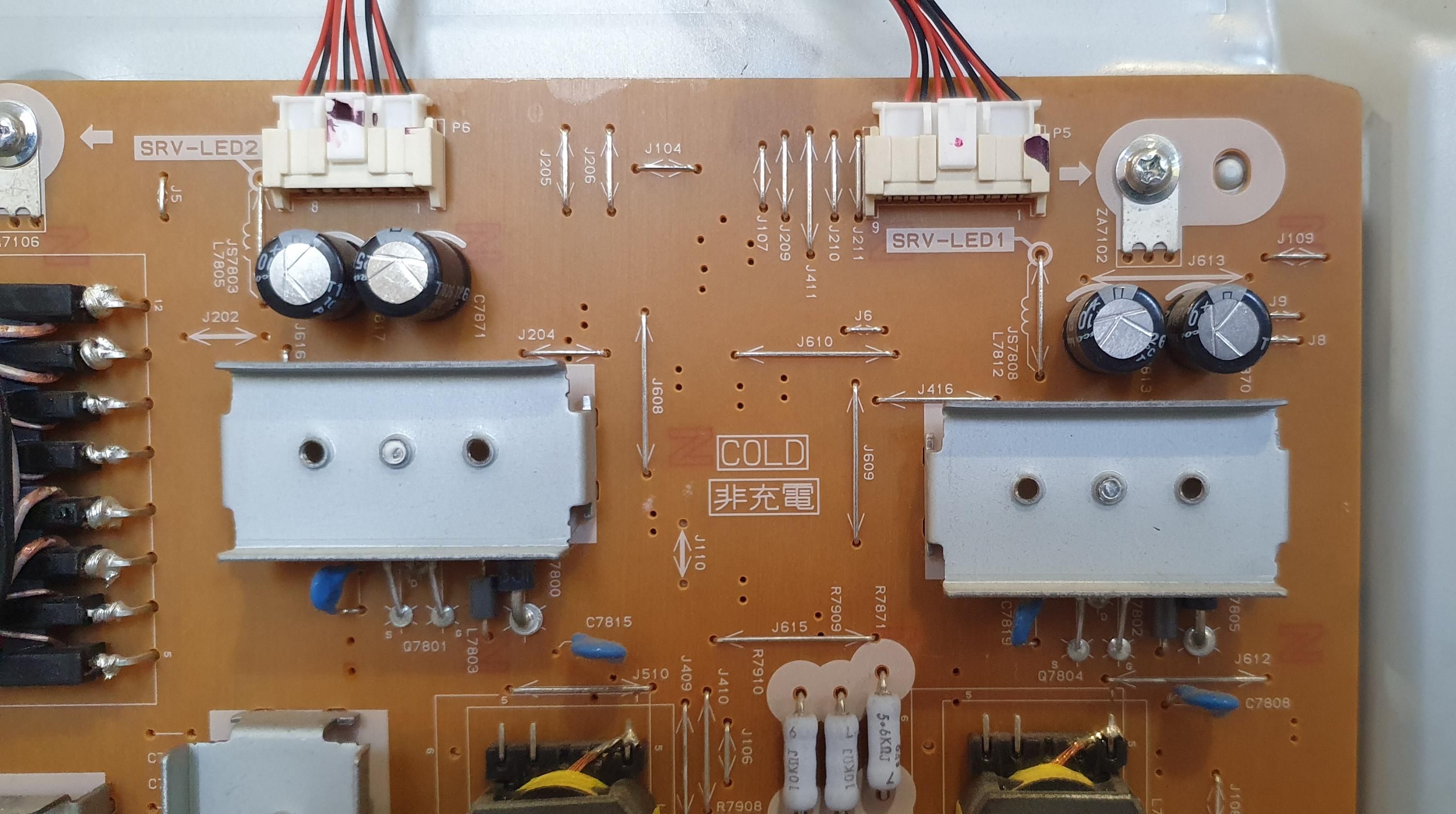

                          internal connectors fail or short.
                          show us the BL socket on PWB clear and focused photo please
                            Originally posted by fixxy88
                            Thanks Diah. Can you explain the BL issue and how to confirm?
                            I just tried counting LED flashes again and it just keeps slowly flashing, at around 3 sec each flash, I stopped counting at 30 flashes.
                            You get the error "1" - BL SOS (blink once - pause 3 seconds, blink once again - pause, ...)

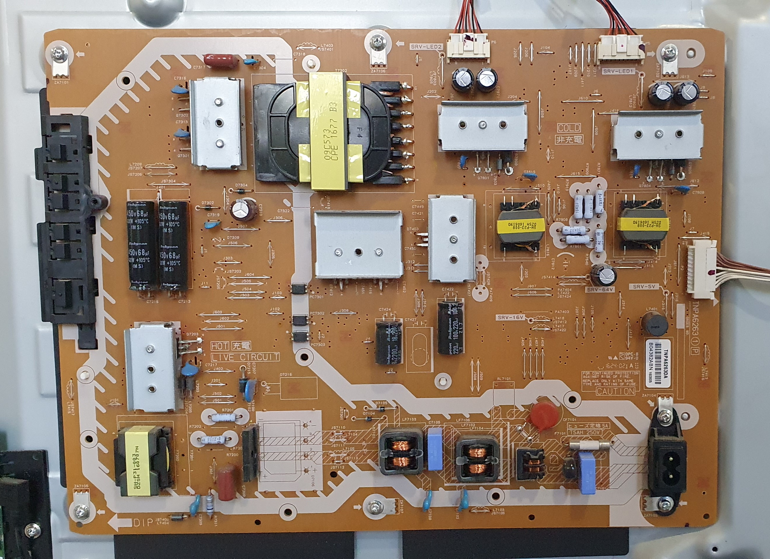

                                    • fixxy88
                                      • Feb 2023
                                      • 27
                                      Here are some photos:
