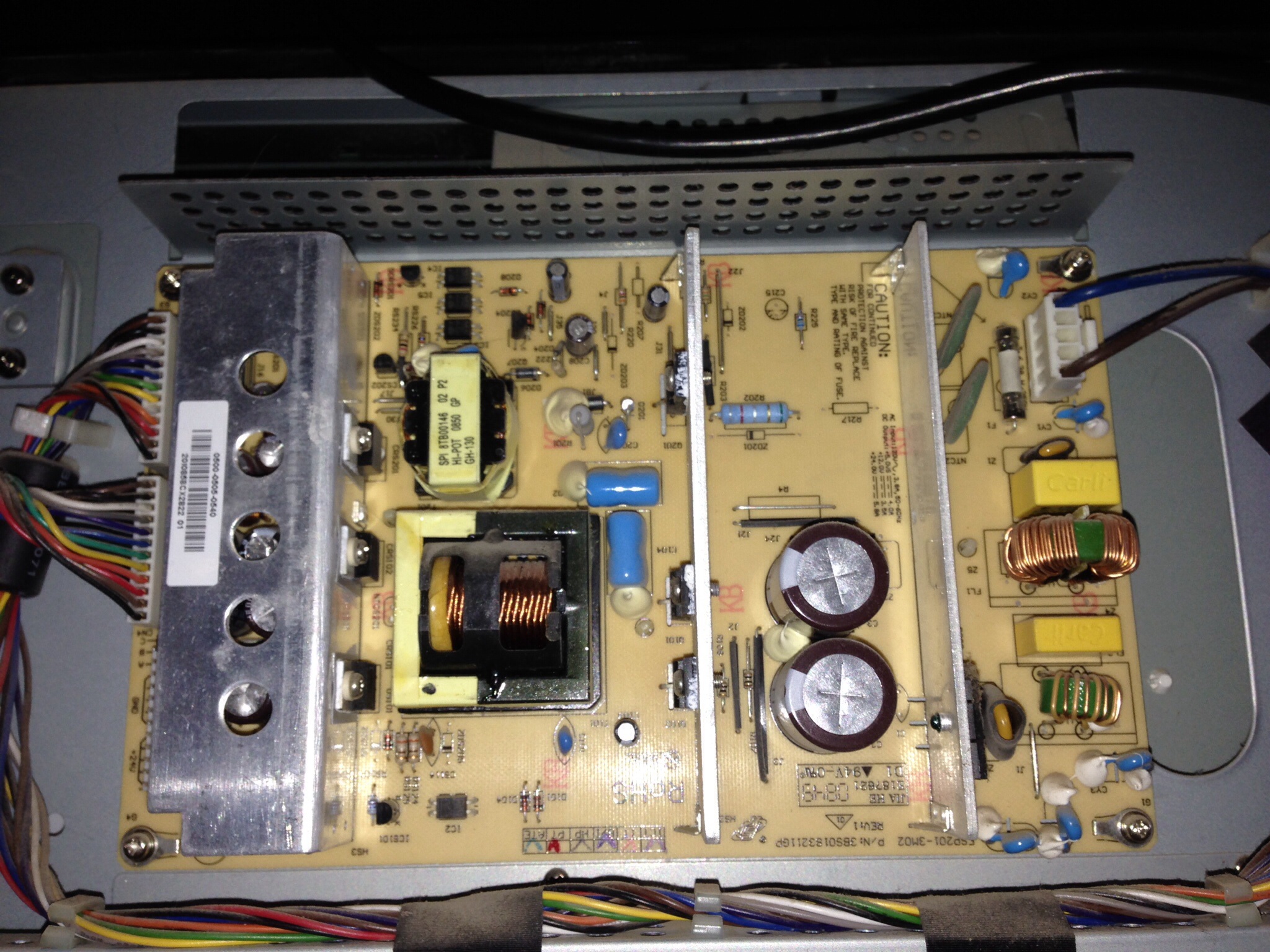

            Re: No power on Vizio voj320f1a 32" led tv
            Well, the power board outputs power to run the set HOWEVER, the main board is responsible for the switching from standby to the ON state. What are the output voltages from the power supply? Can you post any pictures of the boards in question? We really can't go any further without either of these.
                Ok here is the power board...
                I do have a multimeter but my probes are to big to get into wire and connector.
                I think I can stick a small gauge wire into the end of the wire connector to
                check voltages but which wires should I check?? maybe by color?? red and black??

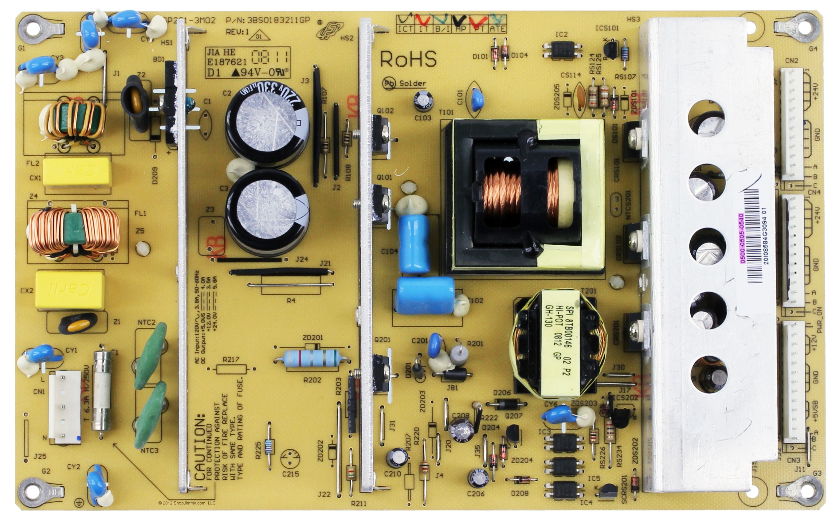

                    OK, those two white connectors on the left, there are labels printed on the board, can you remove the connector and take the pictures so we can see what the labels are?
                    Never mind about the pictures, shopjimmy has good clear pictures.
                    Black probe on the CN3 GND, RED probe on 5VSB.
                    http://www.shopjimmy.com/media/catal...5-0540-top.jpg
                    Picture provided by SJ.
                          Ok so, I checked the power board while it was plugged in.. I was getting 5 volts on the 5 volt leads but nothing on the 12 volt leads... Then I went back to check the 5 volts again and found nothing??? I contacted the ebayer who sold it to me and he offered an exchange ... hope the power board is once again bad that way an actually good working one will fix this set.... I'll ask more questions if the replacement board doesn't work.
                            OK, the 12v and the 24v power supplies are turn on when it gets the PS_ON signal from the main board, the 5VSB is always on power supply that should be present the minute you apply 120VAC to the power supply board.
