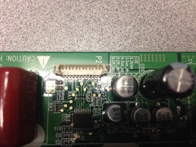

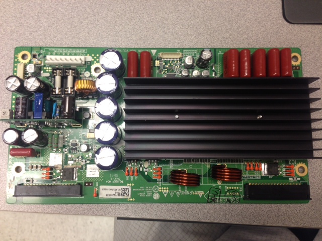

    Re: Vizio P42HDTV10 no picture
    Attached are pictures on Z-sustain and P2 connector. I am missing 2 Mosfets on picture, they are on order. Don't think they are problem. They are FQB27N25.
      Does anyone has any clue what voltages should be on P2 connector out of control board?
        High speed digital signals - measurement with a meter will not provide sensible results unfortunately.
          Is it normal to get 15v on the wire labeled 15v from control board when unplugged, and only 1.5v when plugged to Z sustain
              There could be a short on the Z-sustain dragging the 15V down.
              With Z-sustain completely disconnected from set (except orange panel ribbons), you should get a dim/purple image. Not very good quality, but it will be there.

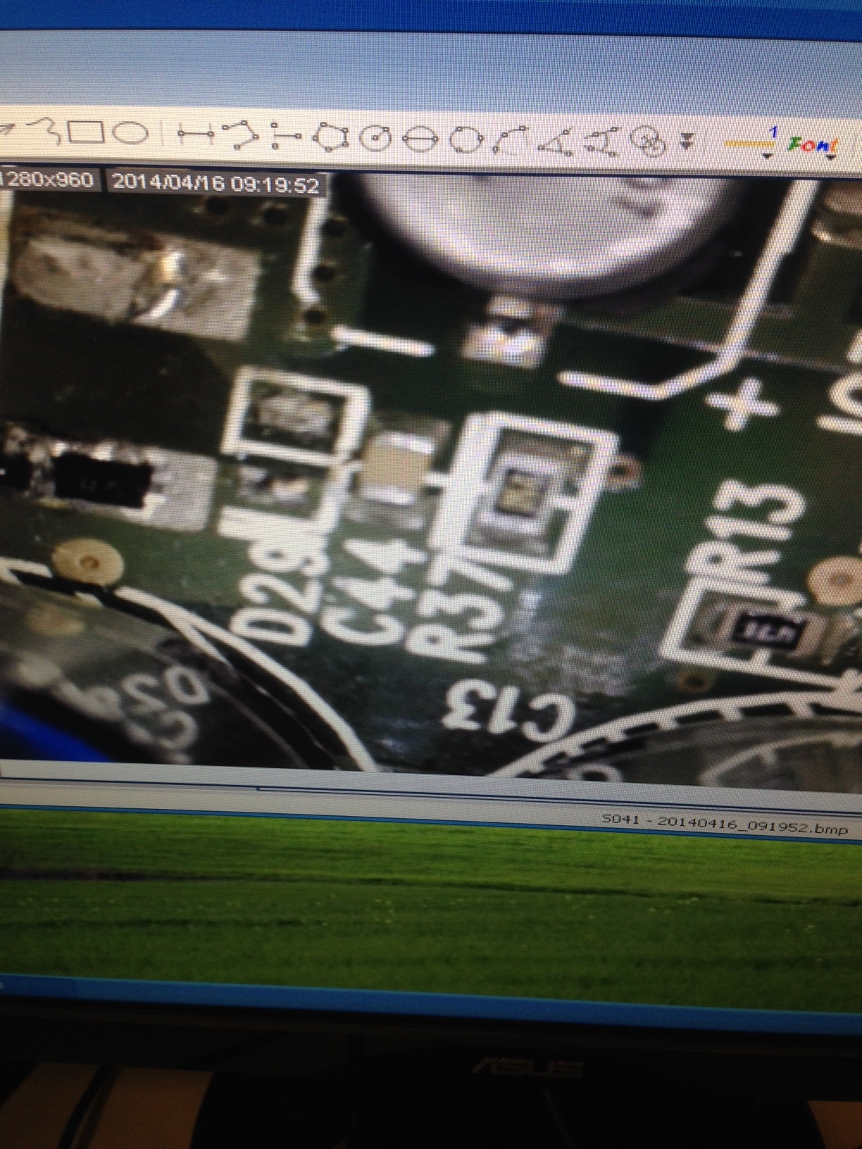

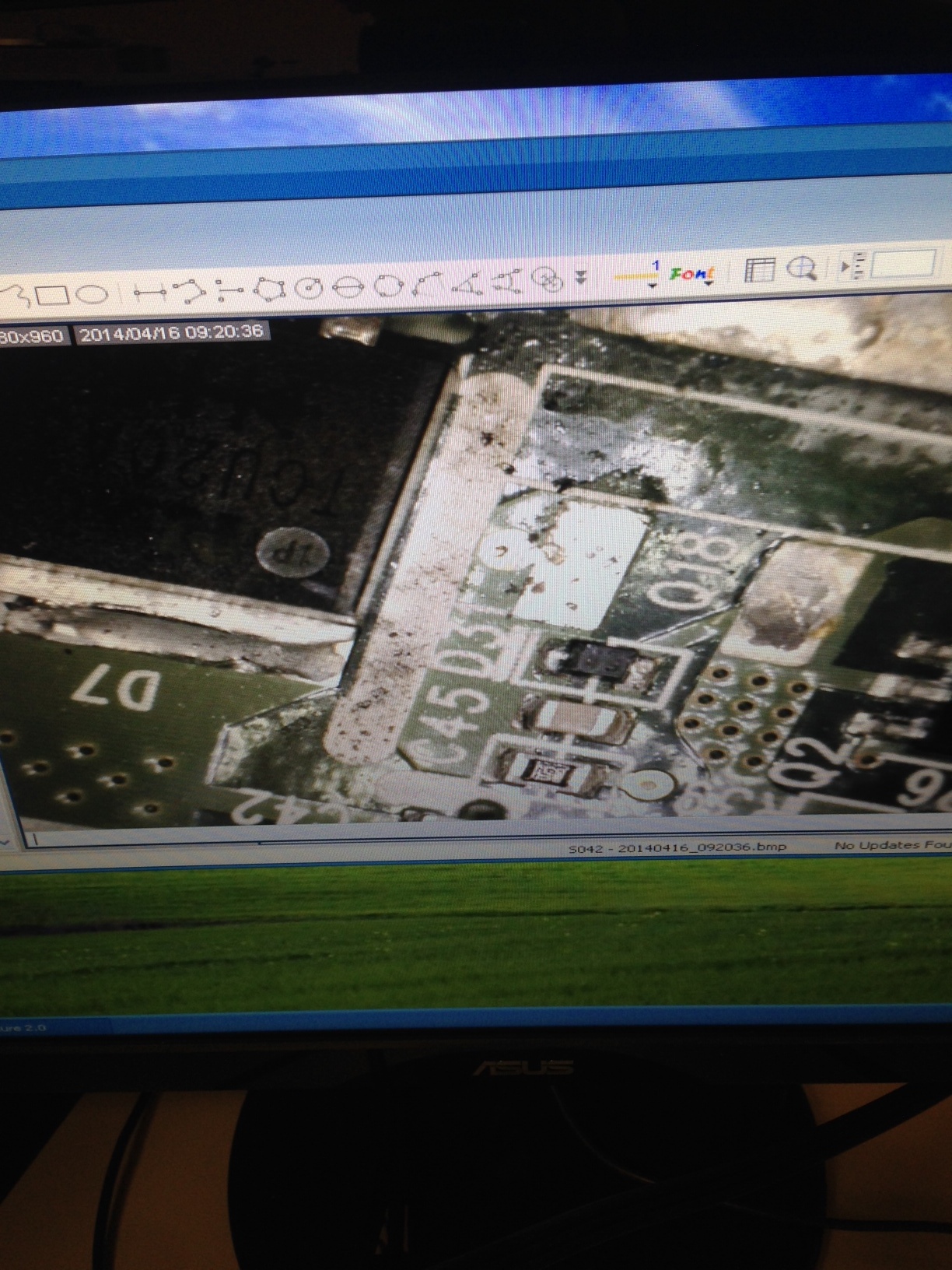

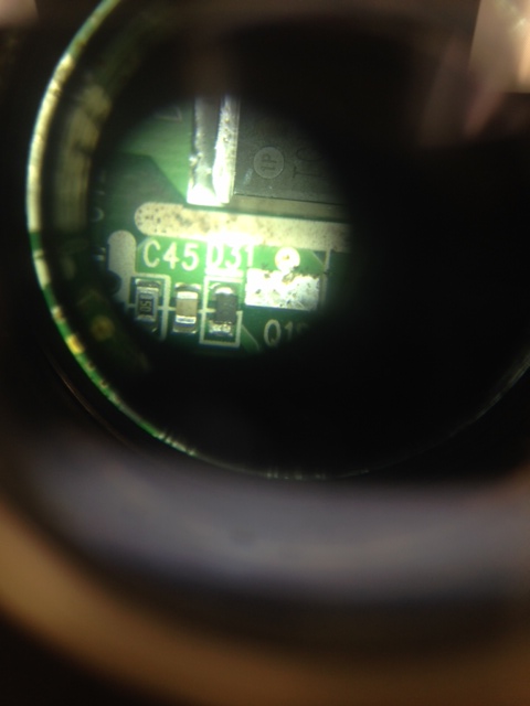

                  What is the part number of this diode. Location on Z sustain board is D29 and it is short both ways.
                    You sure that is a diode.... doesn't look like any diode I've ever seen.
                    • ned1
                      • Feb 2014
                      • 139
                      • usa
                      Me either, but there is a picture of same one on the location D31 and this one actually testing as a diode.
                        I think that's referring to the device above.

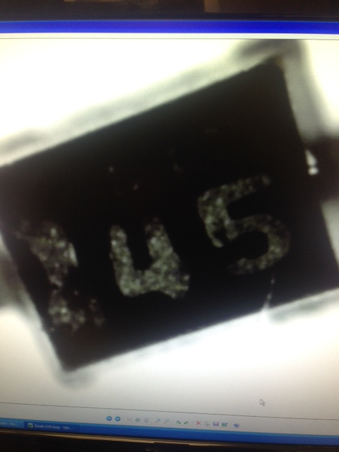

                          Here are better pictures. Those are miniature parts, and actual picture of the part is zoomed to read writing on the part. D29 is short and I removed it and soldered on the bigger pad above so I don't loose it.
                            Did some research, the diode mention above is a zener part number UDZSTE-1715BCT-ND. I have new Z sustain in order and will do some comparison with old when received. Hopefully new sustain board will get picture on this TV. Also have zener coming too.

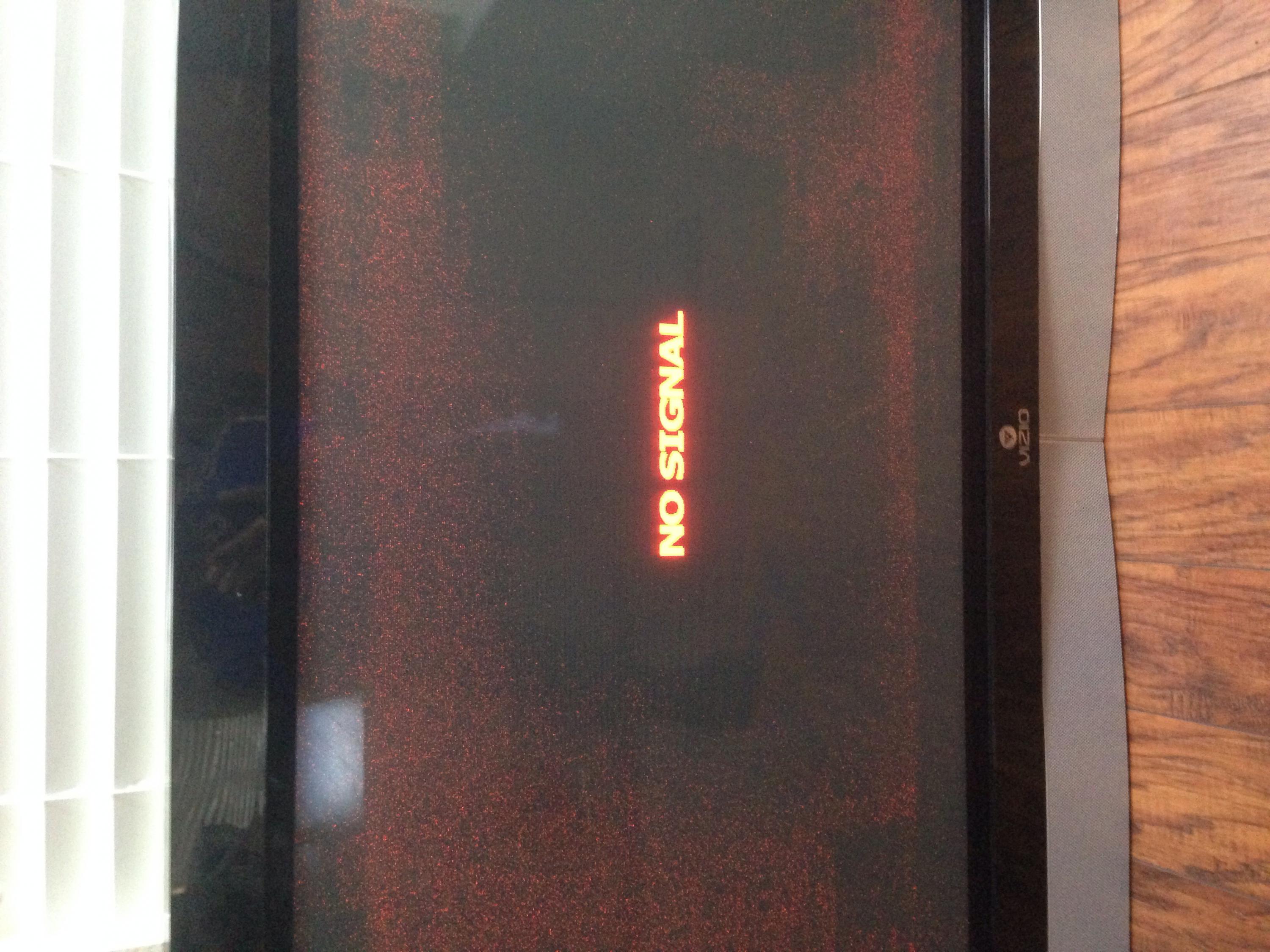

                              Received new Z sustain, and got it to work. Only issue I have is need picture adjustment. When powered on without source I can see bunch if red pixels around screen. Is there any adjustment for this. All voltages are per panel sticker.
                                See the pictures
                                  Some people say you can adjust the voltages on the y sus. I think its vas and vac or something like that. I had that problem and I couldn't get rid of it completely. I actually have 3 of these units I got off Craigslist.
                                    But check those voltages to see if they line up with what it says on the panel.
                                      This is called a maldischarge fault and to fix it the control board must be flashed with updated software.
                                        All voltages are exactly as on panel sticker. I may fool with some of them to see if it gets better .
